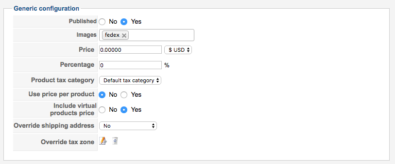

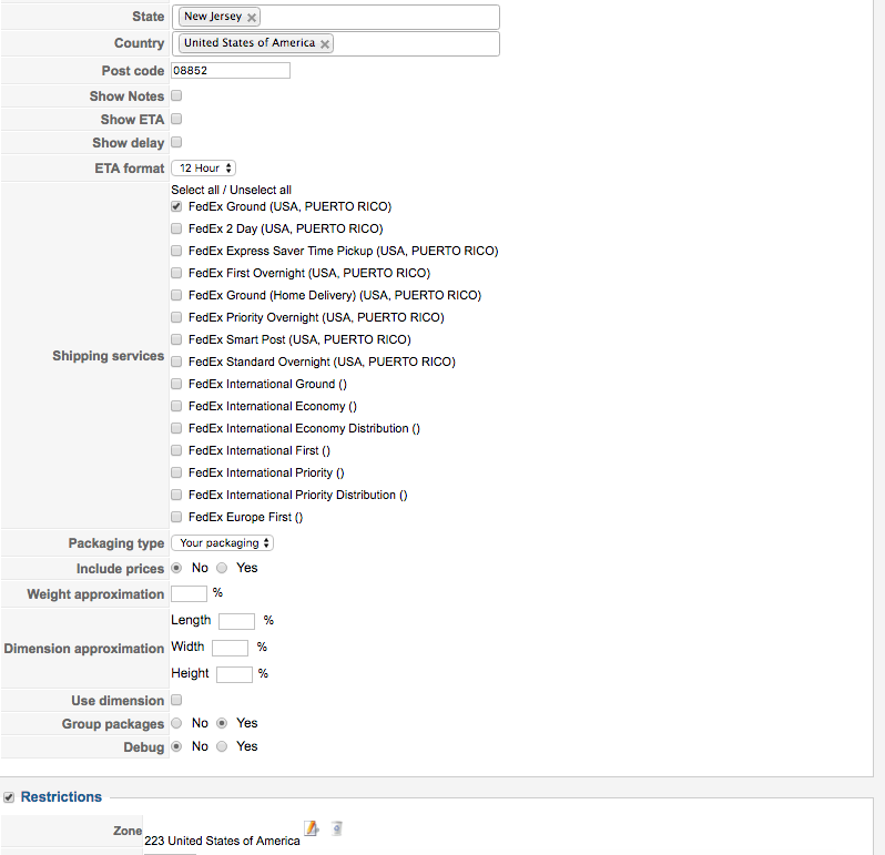

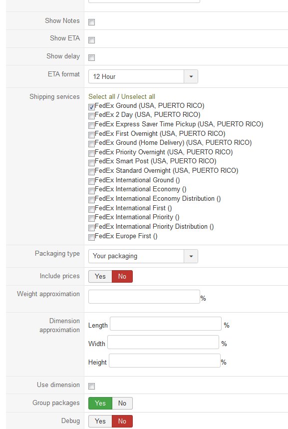

Is there a separate update to Fedex Shipping plugin?
Attached are screenshots of configuration.
Thank you for any help with this! I tried different settings and nothing works.

Yes, I tested with grouped packages and that does not change anything. Is the origination postcode in fedex plugin conf. Supposed to be our postcode from which we send out packages or a destination post code. It looks like the prices are kind of right if we send within NJ but if it goes to another state the prices are way too low in comparison to what FedEx actually charges.

Yes, both ways. Set to No and set to yes. Of course if it's set to No it gives a slightly higher price, so for example if I add two items instead of one and they are not grouped into 1 package, the shipping for two items is $14, where for 1 is $13. That doesn't make any sense and FedEX of course is charging $95 for the shipment of that one item that weighs 3.5lb and is 24" by 12" by 12."
