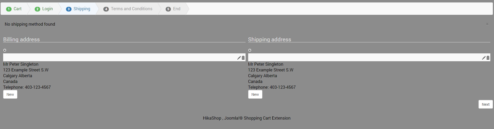

I followed all instructions using the documentation. but it still doesn't work.

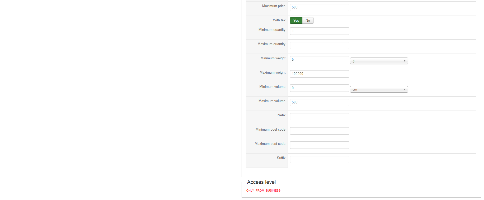

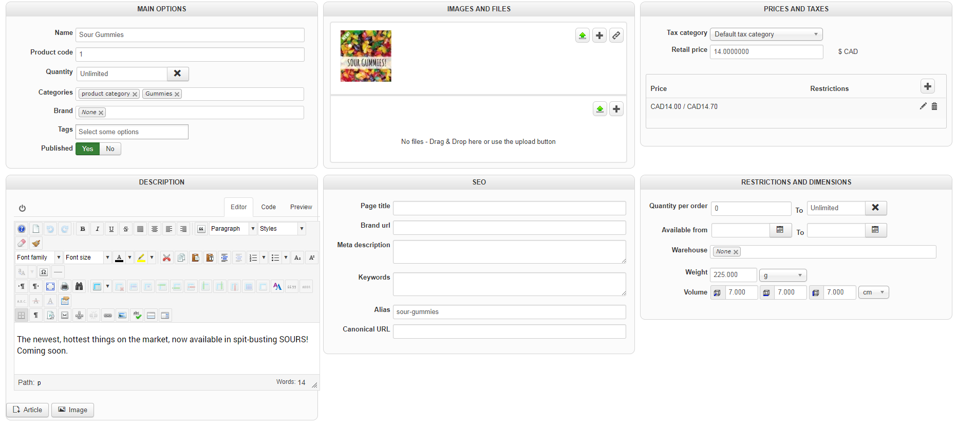

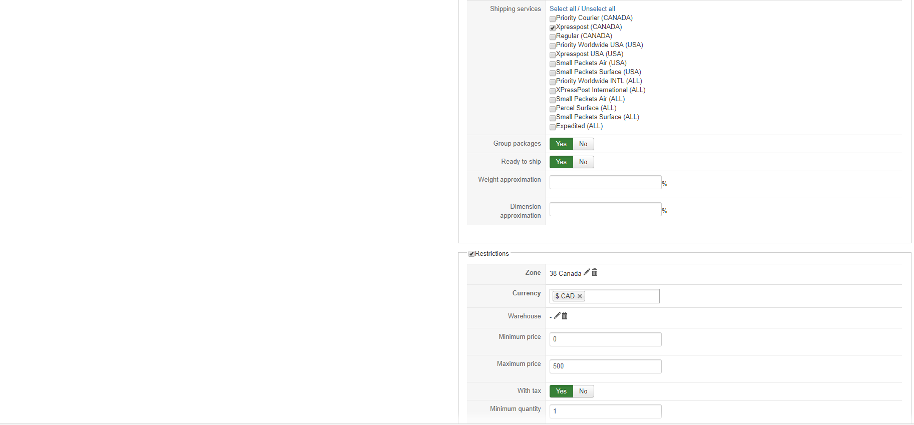

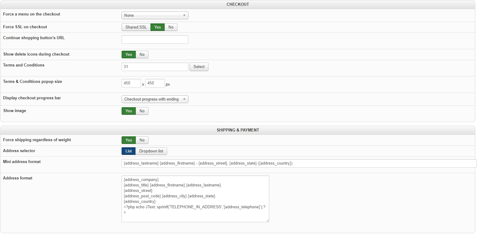

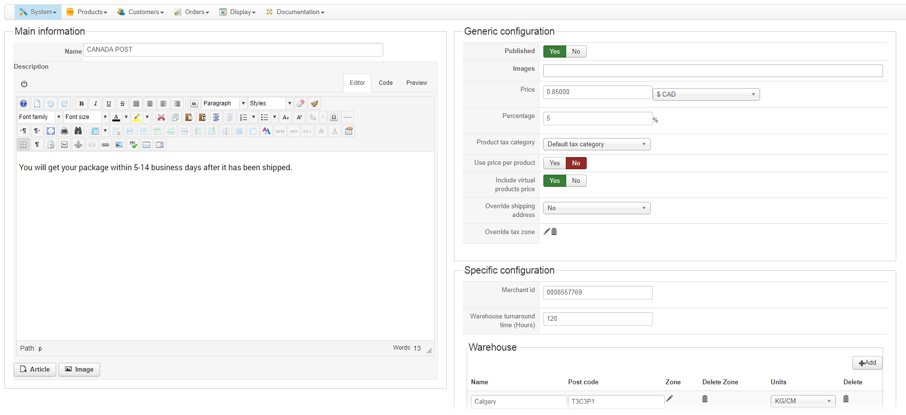

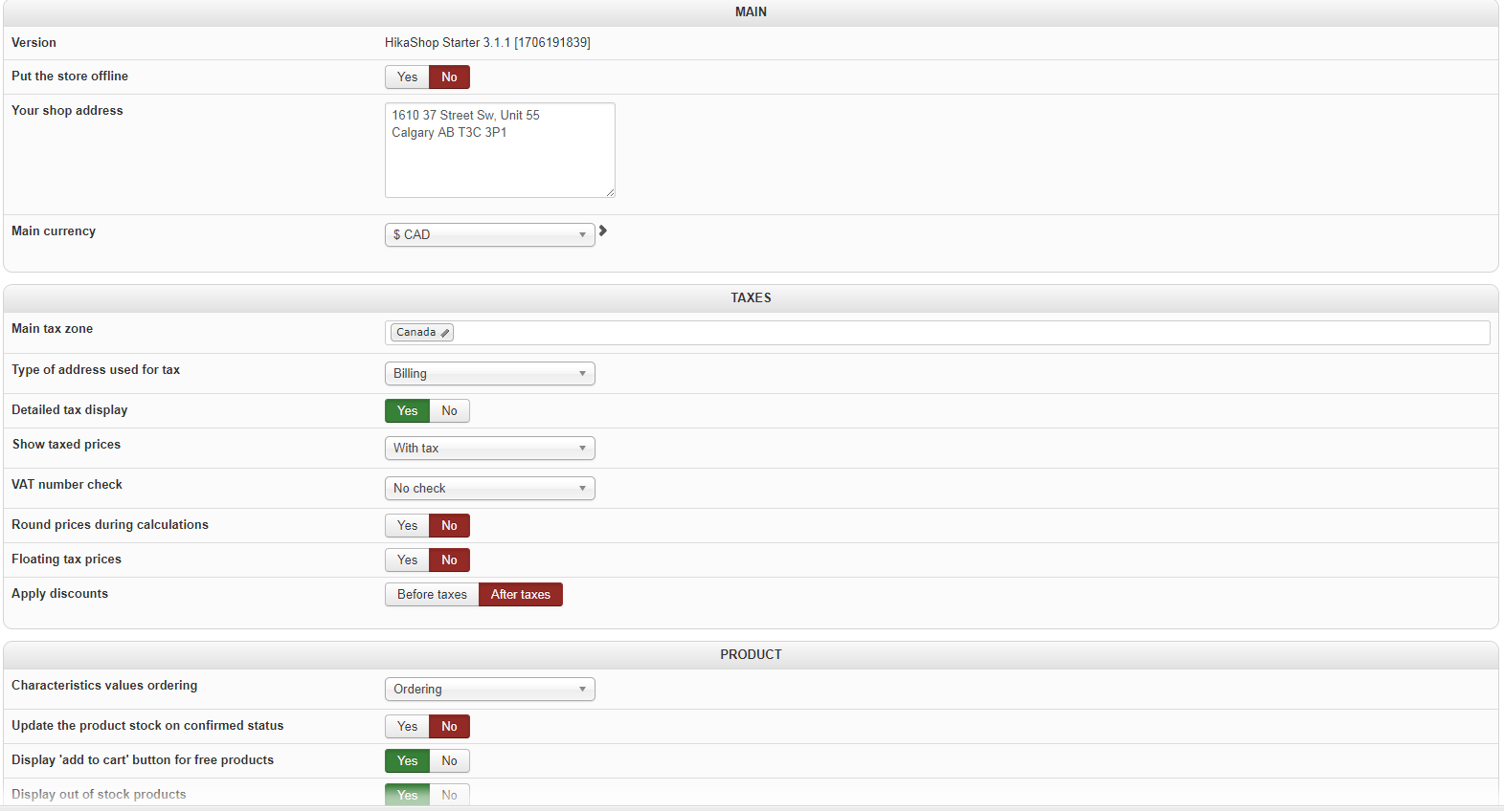

  • Posts: 13
9 years 2 months ago #274357
Please see attached photos for exact configuration. I have followed all the instructions and reviewed the list here www.hikashop.com/support/faq#ship
It seems like everything is set up properly so I am not sure what the problem could be
9 years 1 month ago #274358
Your shipping method seems to be correctly configured, can you also test it with all Canada Post shipping services enabled ? The problem is maybe coming from the fact that the "Xpresspost (CANADA)" service isn't available for that order or shipping location.

9 years 1 month ago #274884
Before checking your backend I just wanted to perform a little test thanks to the account you gave us.
I entered an address for my user and I got that :
pasteboard.co/GCVxGN0.png
You should contact the Canada Post support in order to get more information about your credentials.
Please note that the Canada Post plugin in HikaShop is using the old Canada Post API and not the new REST API one (which requires another plugin than the one in the HikaShop packages) ; that could be an important information to gave to their support.

  • Posts: 13
9 years 1 month ago #275066
I have the API information. Where do I put this in the HikaShop plugin? I don't see a field for it anywhere.
  • Posts: 86183
9 years 1 month ago #275071
The CanadaPost plugin in HikaShop only needs a "merchant CPC id" (or "merchant id" as labeled in the settings of the plugin). So if you've got other kind of credentials, they probably aren't for the plugin.
Again, please check with CanadaPost support that the merchant id you're trying to use is the one you're supposed to use because apparently, the one you entered in the plugin is being refused by CanadaPost's server.
