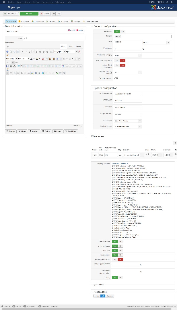

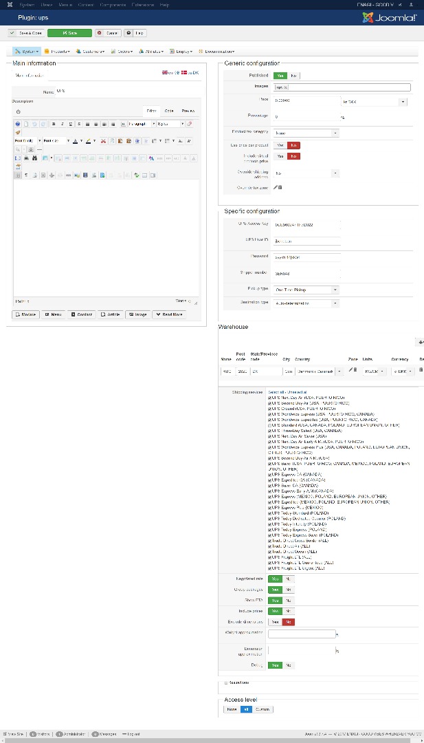

Can you show us some screenshots of :
- How you configured your UPS shipping method
- The product that you have added in your cart when you have tested it
Thank you.

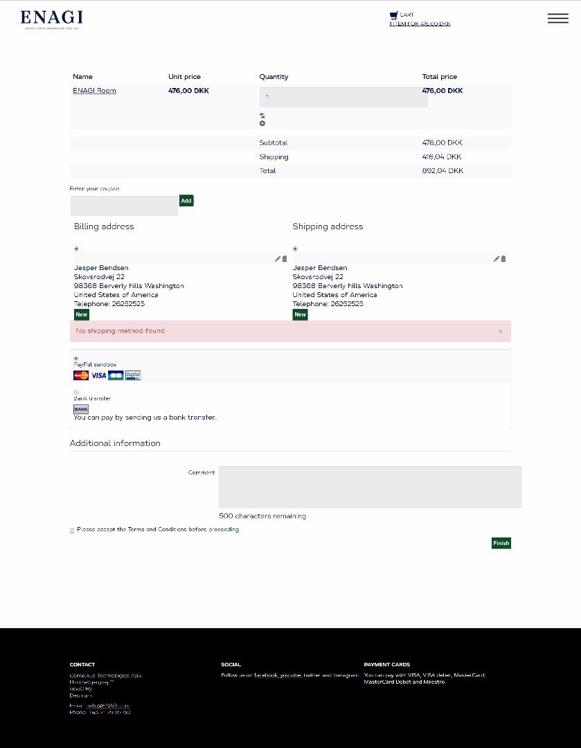

  • Posts: 31
8 years 11 months ago #275789
See the two attachments..... the FedEx is working as you can see, but not the ups, not even the debug..
Please help get the ups debug to work
Jesper

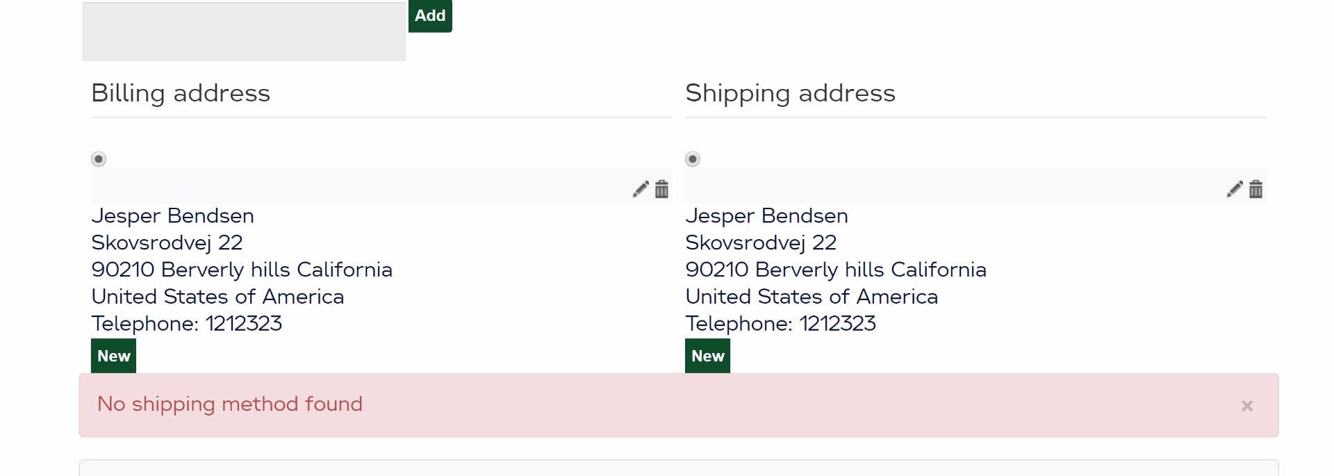

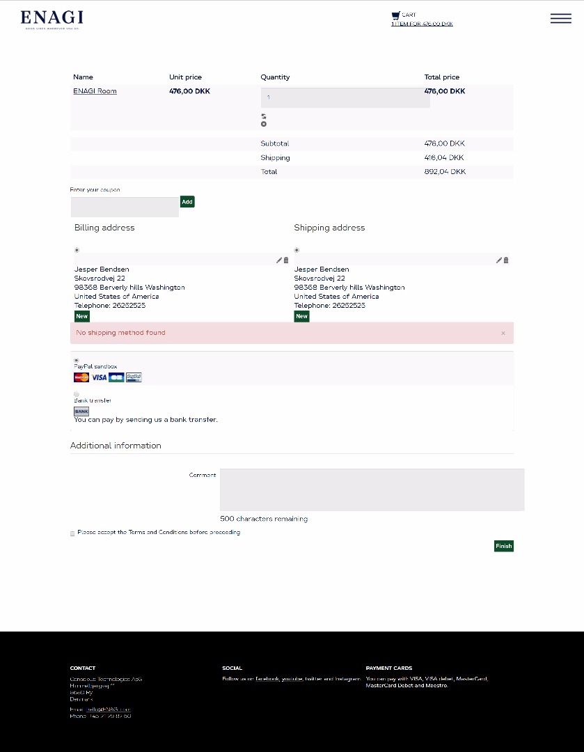

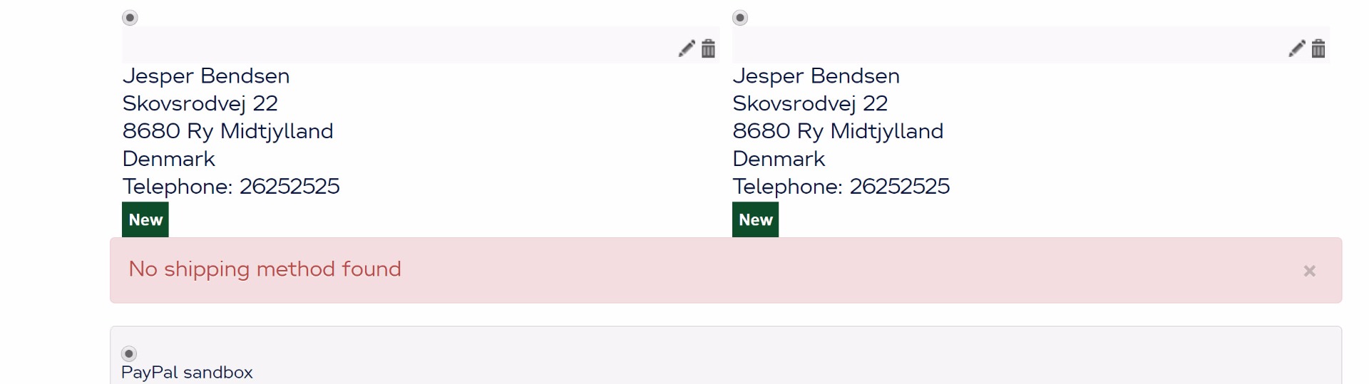

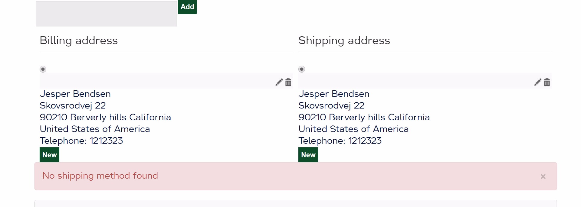

  • Posts: 31
8 years 11 months ago #275824
hi Nicolas
It just says 'no shipping method found' still no debug info?
see attach
Jesper

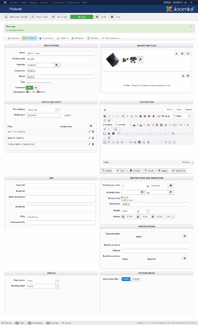

Also, I'll need some screenshots of how you configured the product that you have added on your cart so that I can reproduce it on my end.
Thank you.

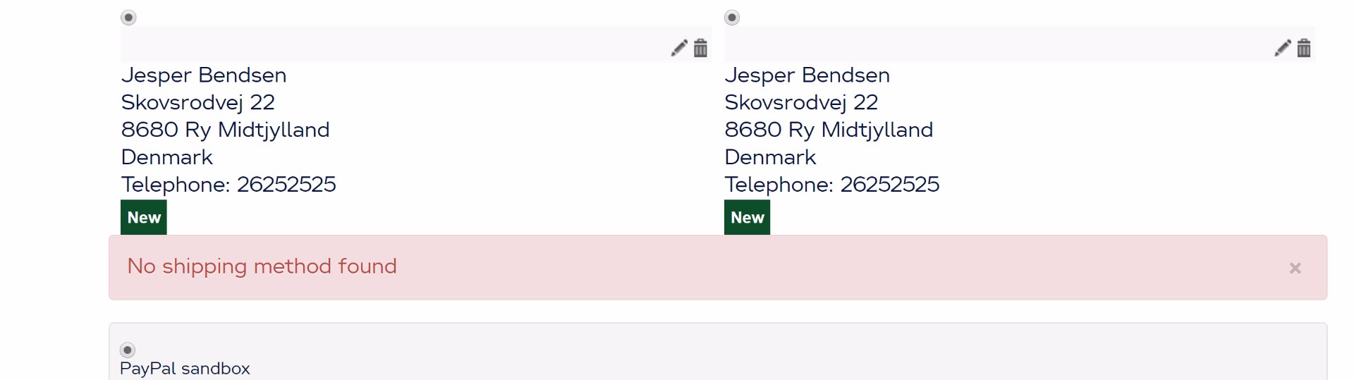

  • Posts: 31
8 years 11 months ago #275925

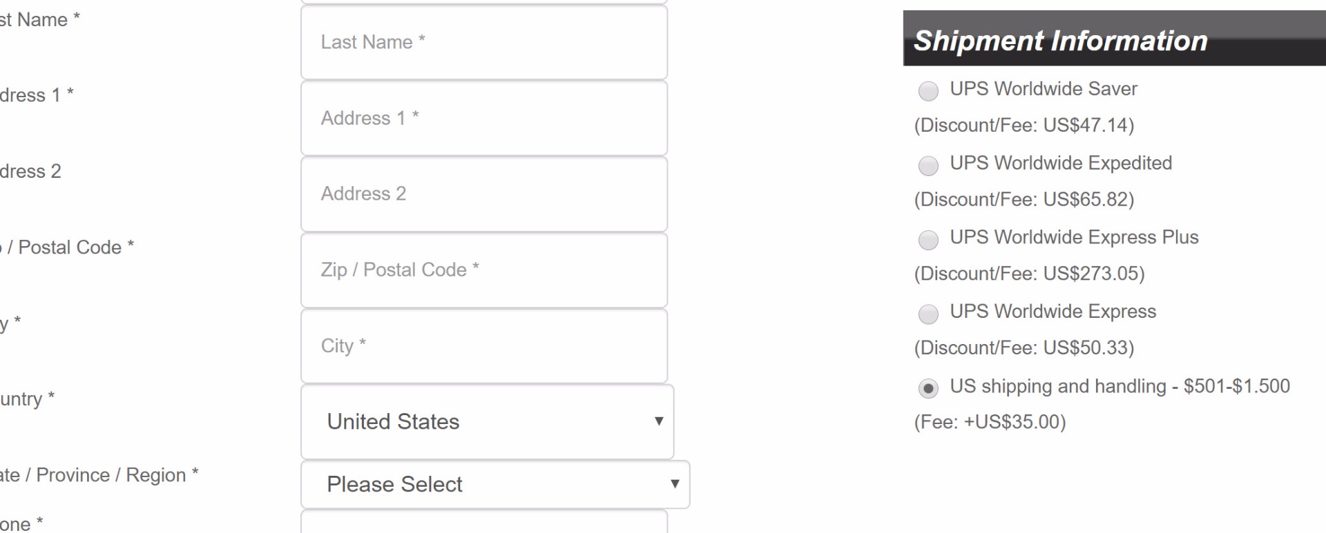

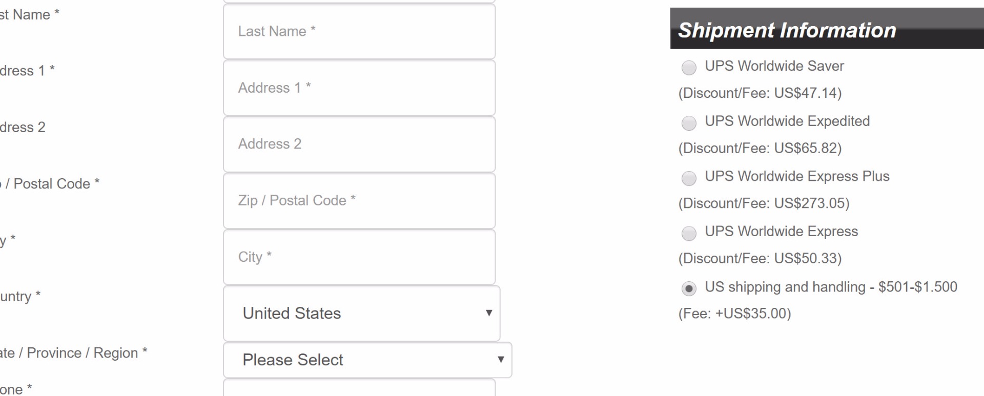

I changed both the address and the phone number, but still no ups shipping rates....
See attach..

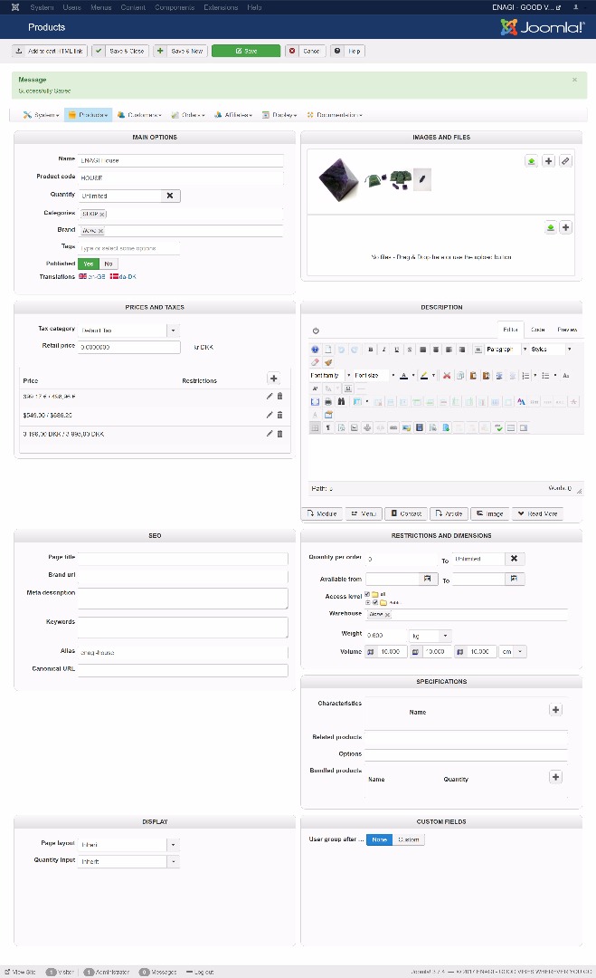

HS product attached

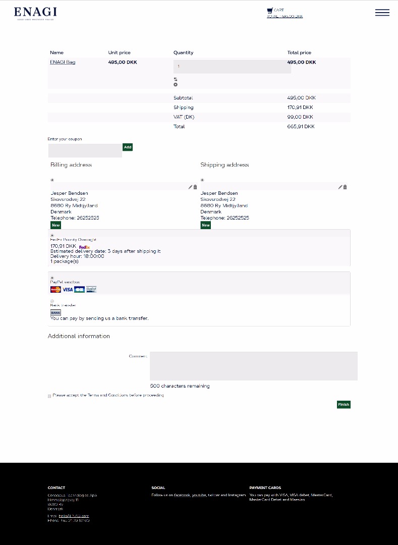

Also I use the same US credentials on my virtuemart install, and here I get a rate back from UPS,..
See attach...
Please fix so I can get rid of virtuemart...
Jesper

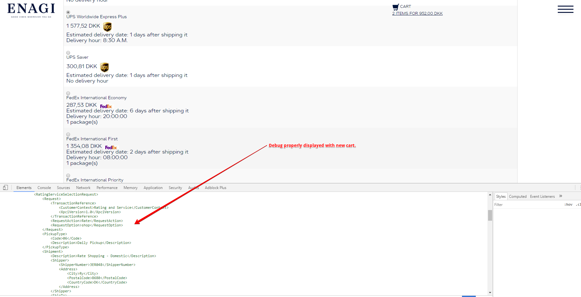

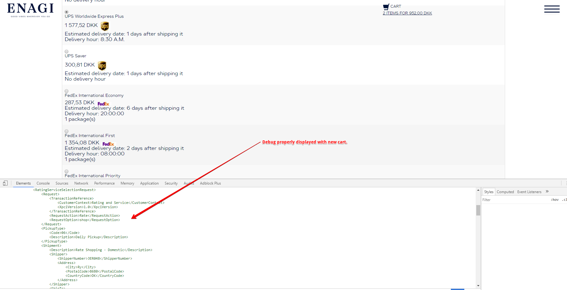

8 years 11 months ago #276153
Hi Jesper,
I tried to reproduce it on your end, but also on my end using your credentials, so you'll find attached the request that was made to the UPS platform and also their reply.
You can show them these request/response to have more information about your issue.
This message has attachments files.

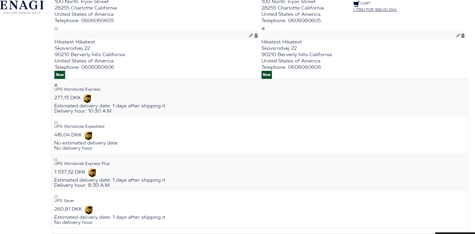

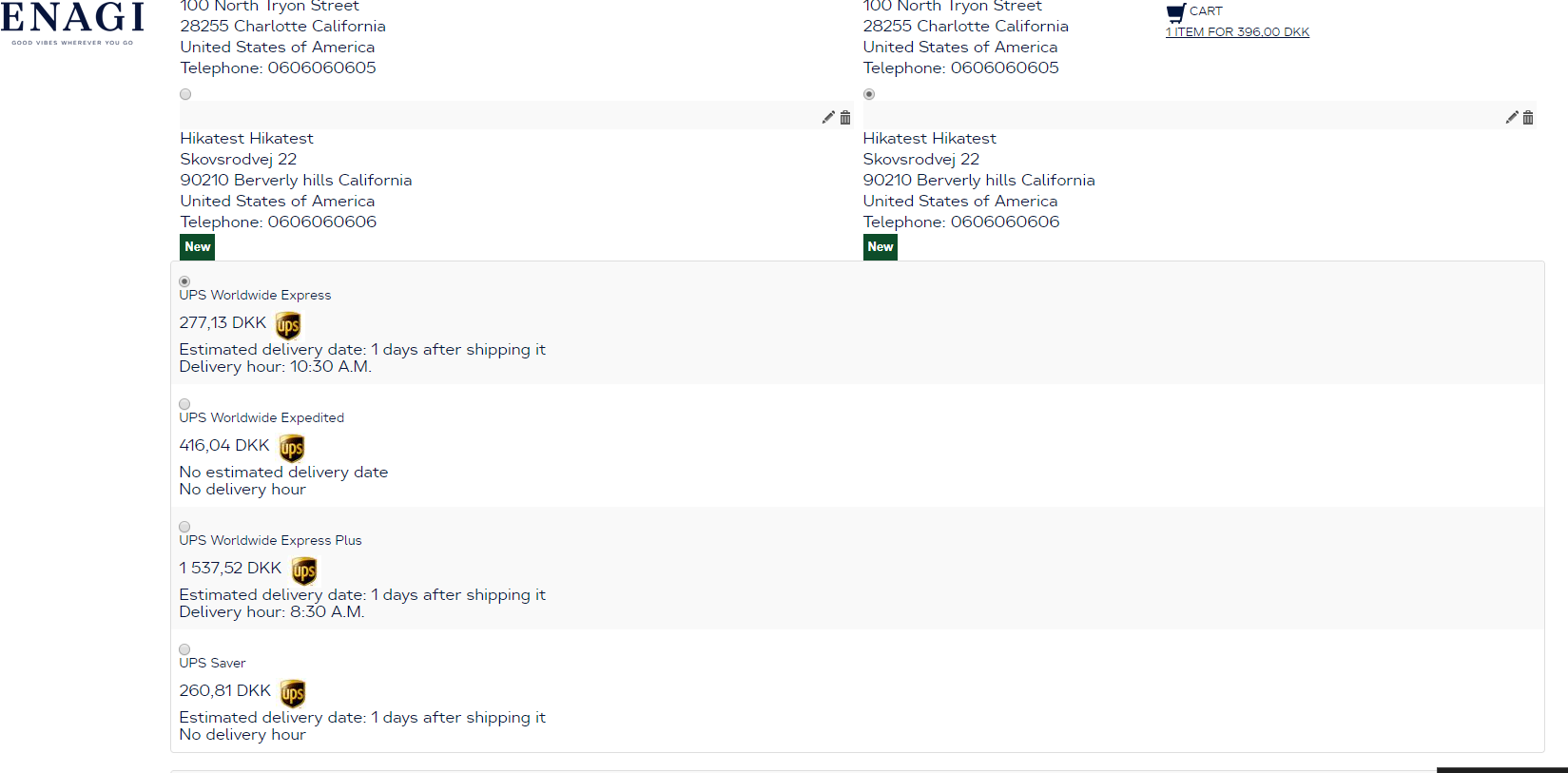

  • Posts: 31
8 years 11 months ago #276581

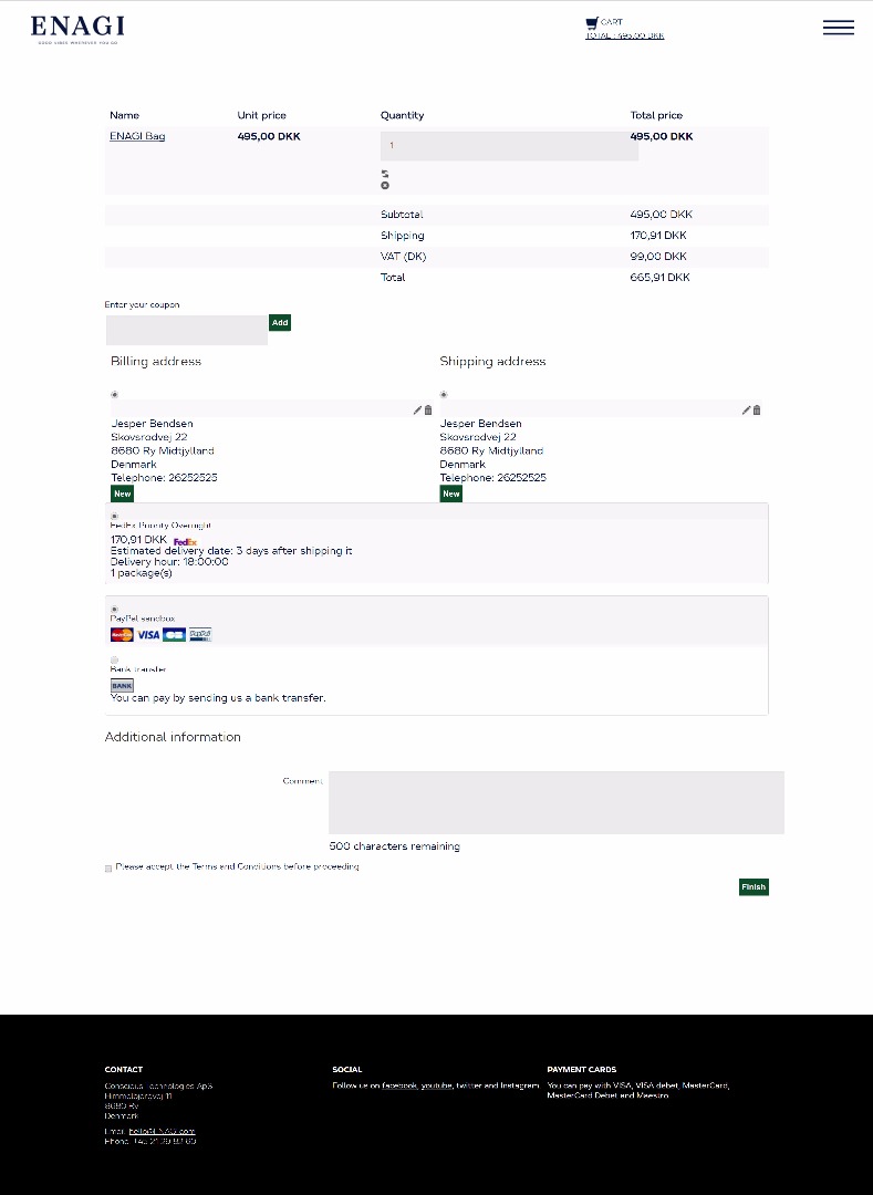

I just went to the site and, put a product in the cart, went to checkout and there was no debug info and no shipping method, so either does not work, can you please look into it?
see attach.
Jesper

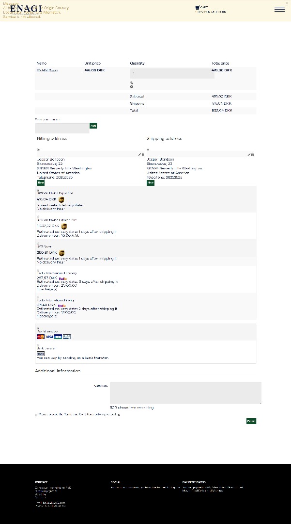

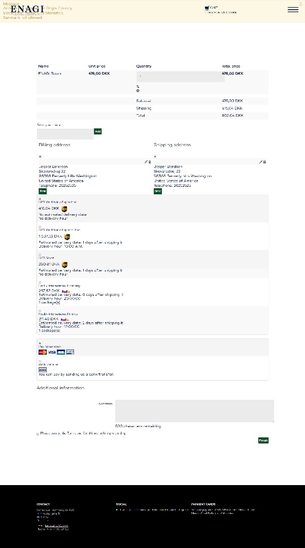

  • Posts: 31
8 years 11 months ago #276585
Then I did a refresh and the screen showed the shipping methods, I would very much like the shipping method to be shown without my customers having to do the refresh... see attach

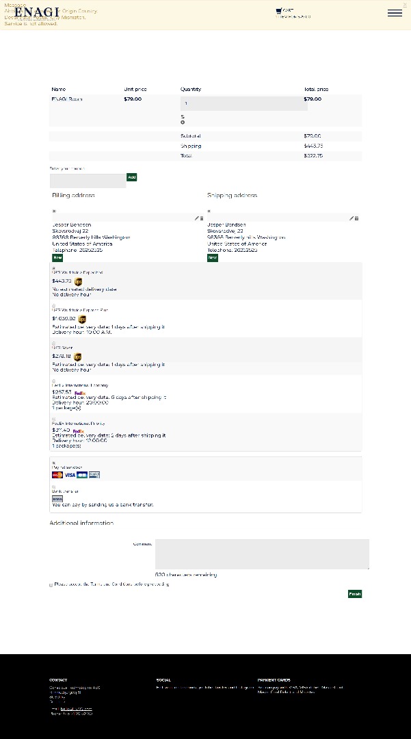

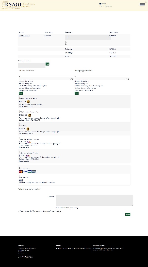

  • Posts: 31
8 years 11 months ago #276586
Then I changed from currency DKK to US$ and there was no conversion, please fix, see attach...
8 years 11 months ago #276606
You probably had to refresh because you still had in cache the old shipping methods for your current cart, so your customers won't face that issue.
I again, just installed the last UPS shipping version through your website and the shipping amount was being updated when the currency was changed.
Can you download the last Hikashop version through our website, install it and test it again ?
Thank you for your feedback.
