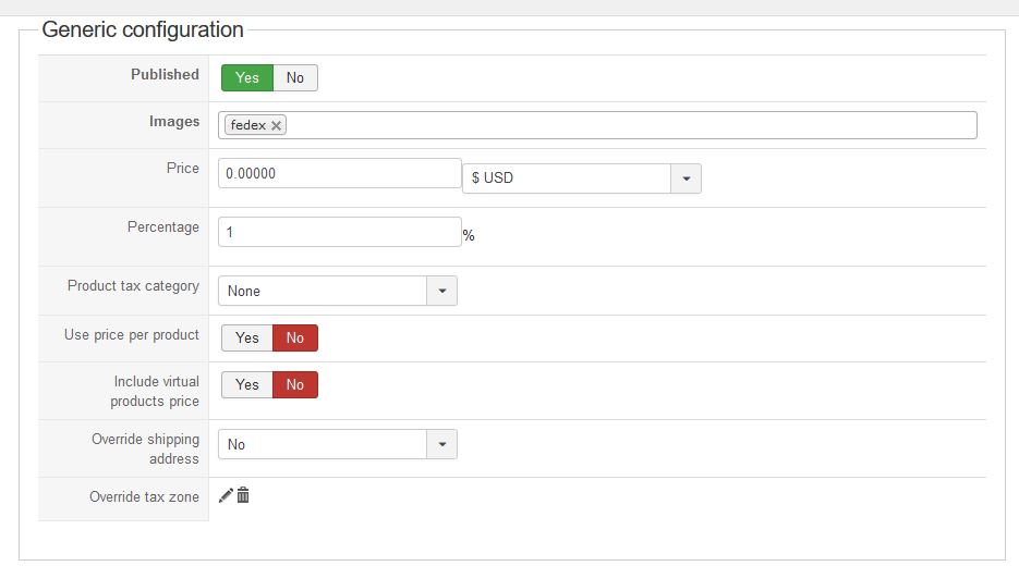

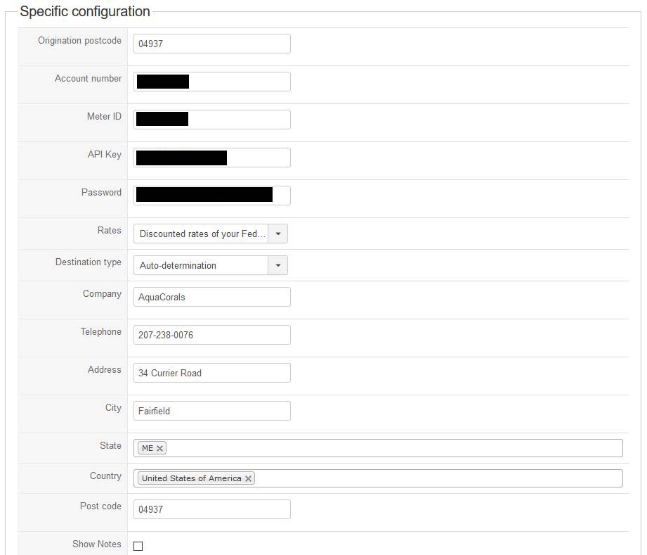

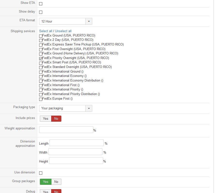

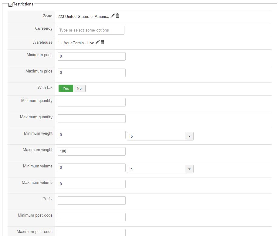

Do you have more information than just "Could not connect to host" in the debug ? How did you configure your Fedex shipping method ? Could you provide a screenshot ?

I've attached screenshots of the shipping configuration and the debug report with the account numbers etc removed.
