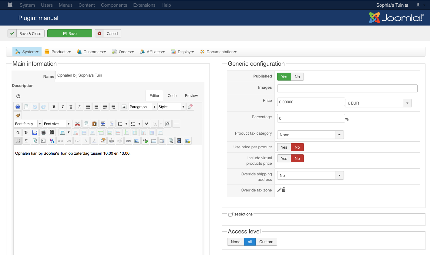

I was talking about the text you can write under 'Main information' in the manual shipping plugin, see attached screenshot. I want to add some info (it is actually instructions for clients who are picking up their order at the chosen place). So I need this instructions to show up in the order confirmation email. I have the business edition.

In that case, the best solution will probably be to directly edit the code of your Email via "Hikashop->System->Emails", which will require development skills.
www.hikashop.com/support/documentation/i...25-hikashop/#content
