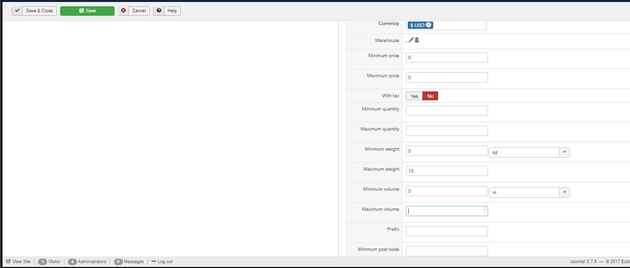

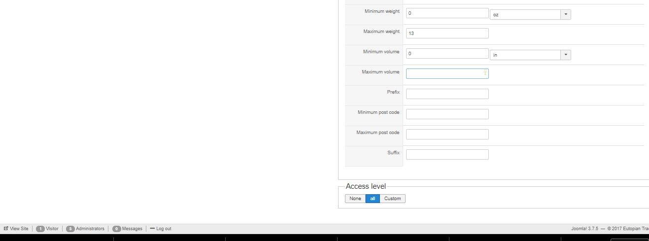

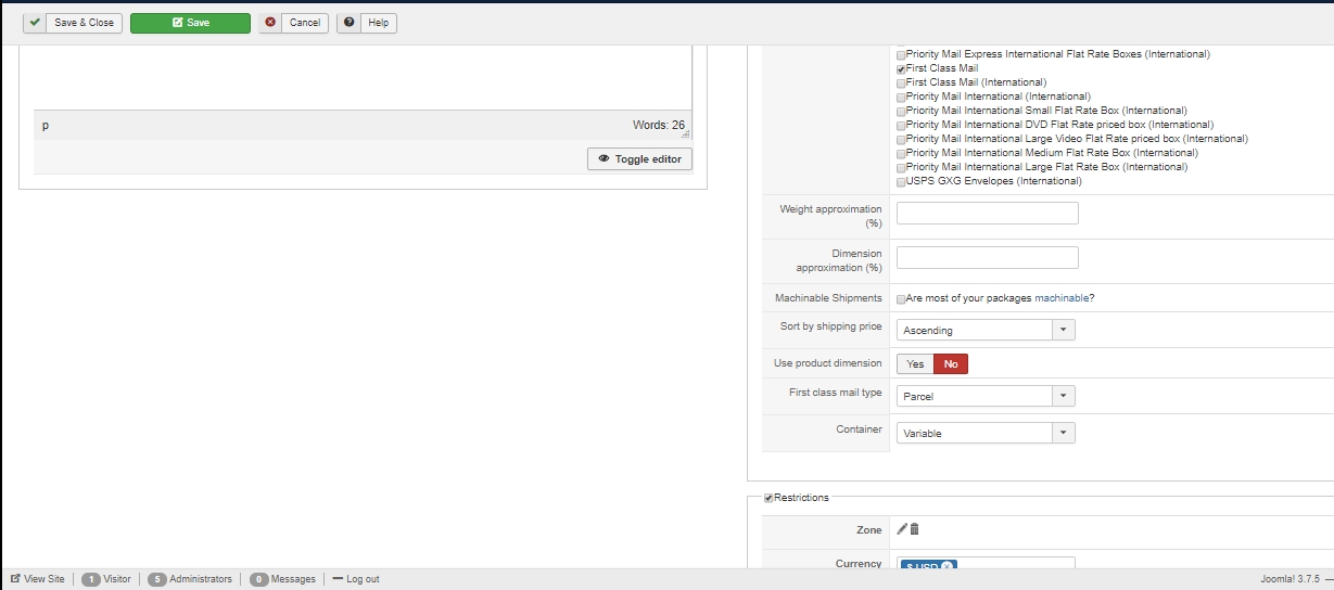

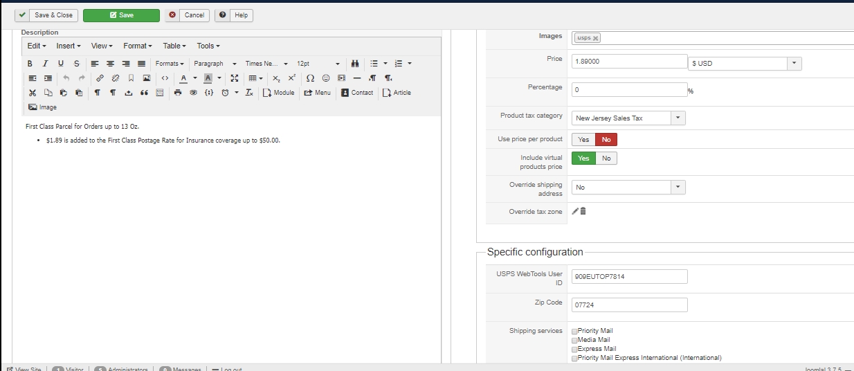

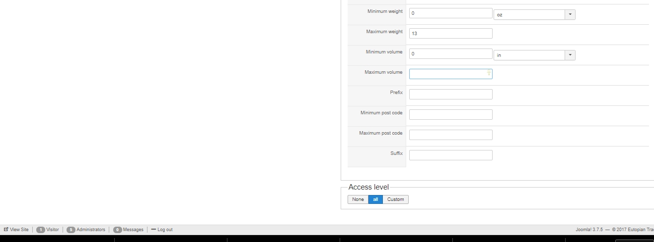

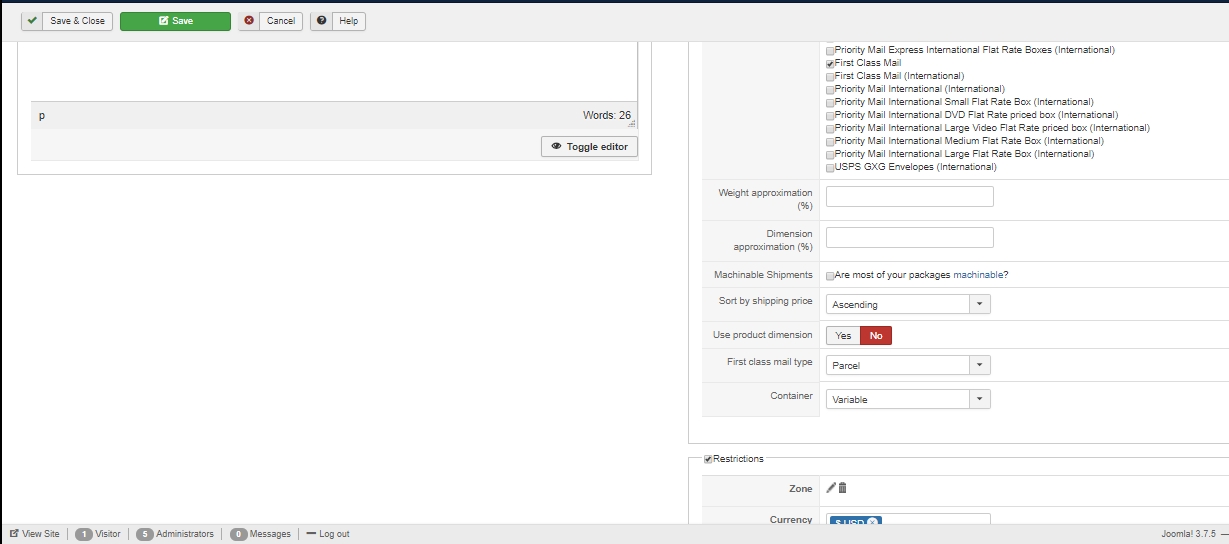

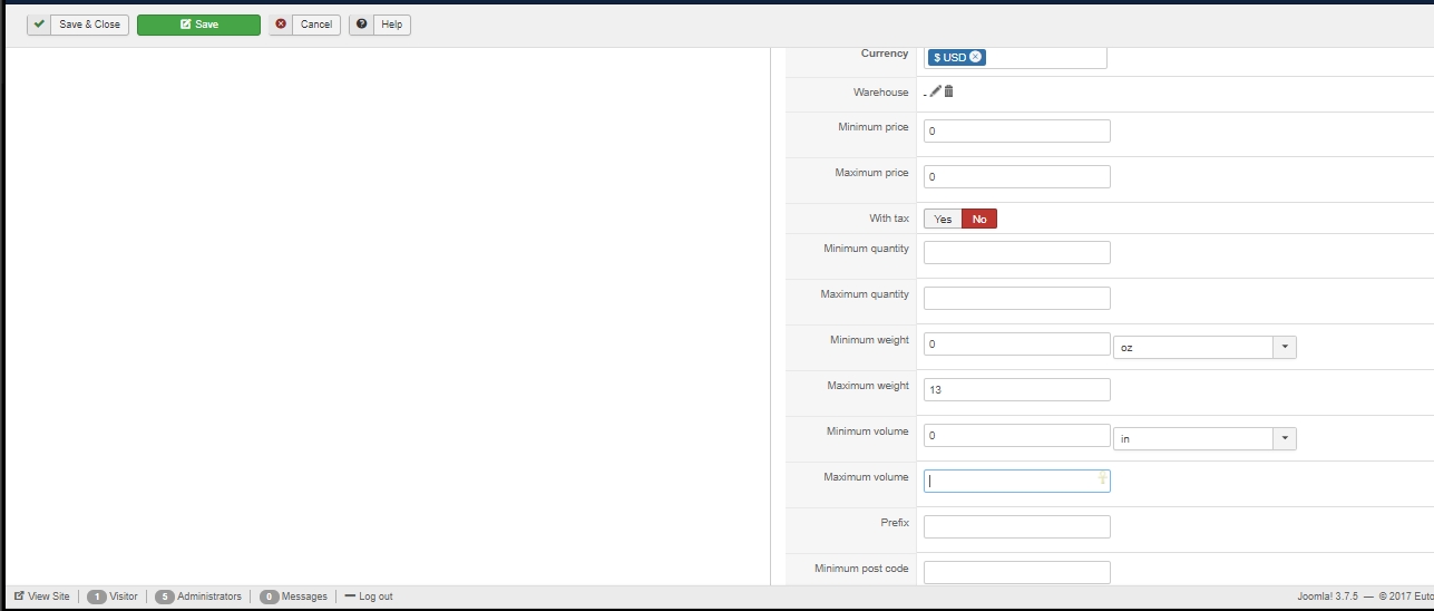

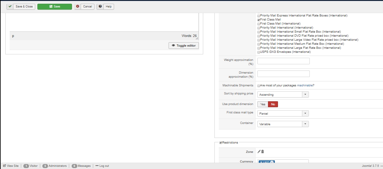

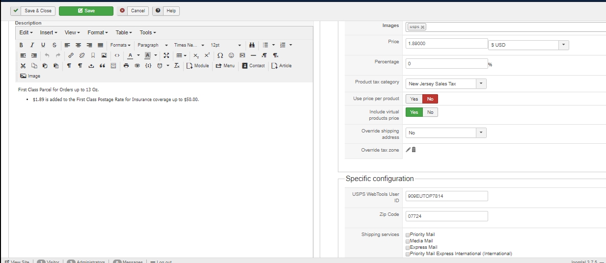

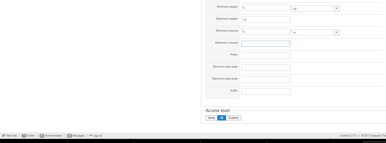

PS - if anyone needs to see the configuration they are both identical for the 2 first class setups only one sets a price to add $1.89 to the price returned from USPS the other does not. Here are the screenshots. My apologies for not providing these earlier.
Thanks!
