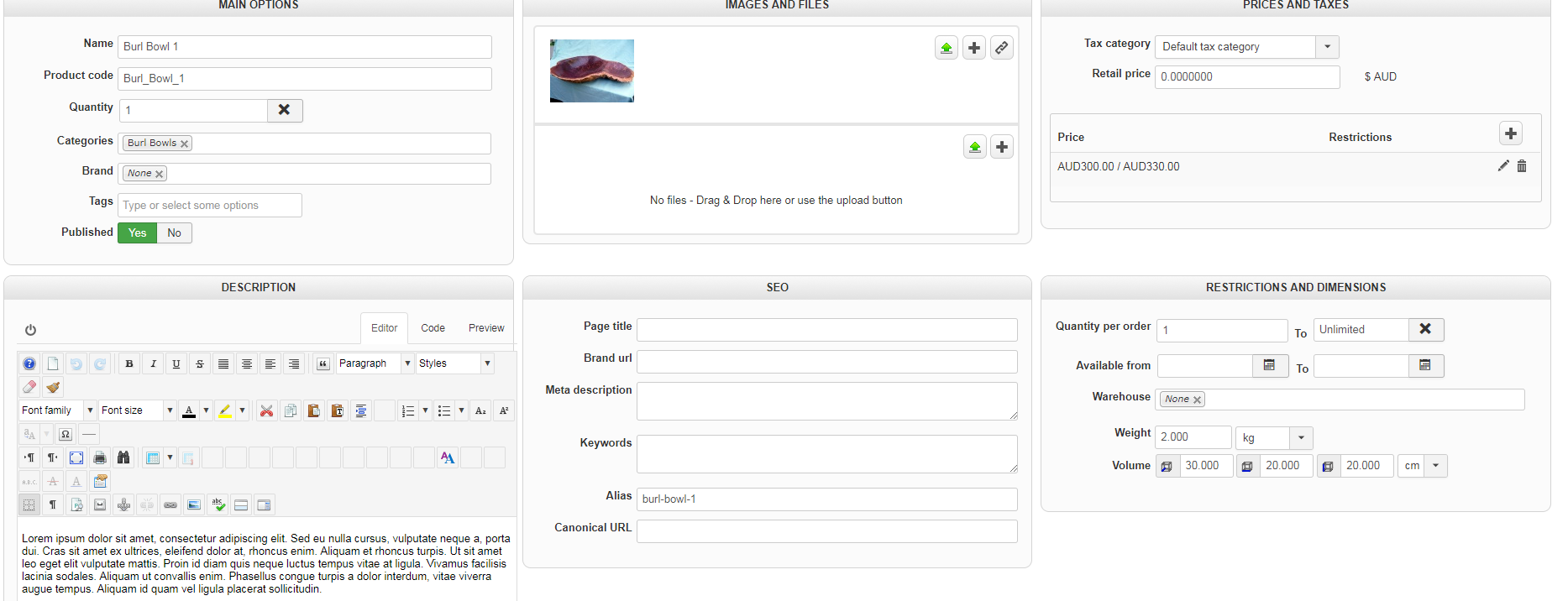

    Does your products have correctly set-up values for their weight and dimensions ?

    I have configured 1 product with dimensions and weight for testing purposes.
    Product is
    www.niagaraparkit.com/oztimber/index.php...roduct/1-burl-bowl-1
    This is the one I am testing on and on which I only see the manual shipping option.
    I am going to add weight and dimension to the others I have up there as well now - just to see if it triggers the shipping plugin.

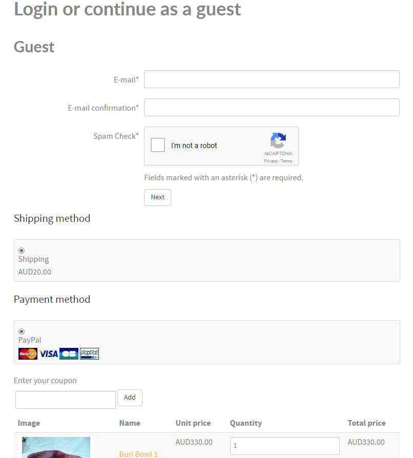

    My steps are:
    go to product page > add to cart > go to checkout > login or continue as guest.
    There I only see the manual shipping.

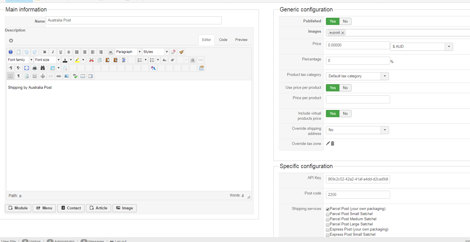

    Attached is a screenshot of the product page - backend
    Australia Post shipping - backend.
    Thanks,
    Thomas
    8 years 10 months ago #281712
    Hello Thomas,
    I just tested it on your website and the Australia Post shipping was correctly displayed after I entered my shipping address. Did you fix your issue ?

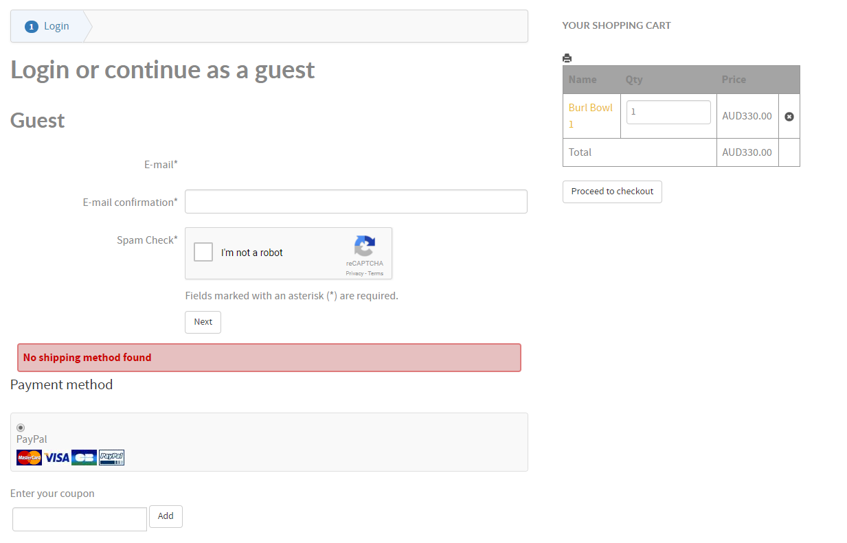

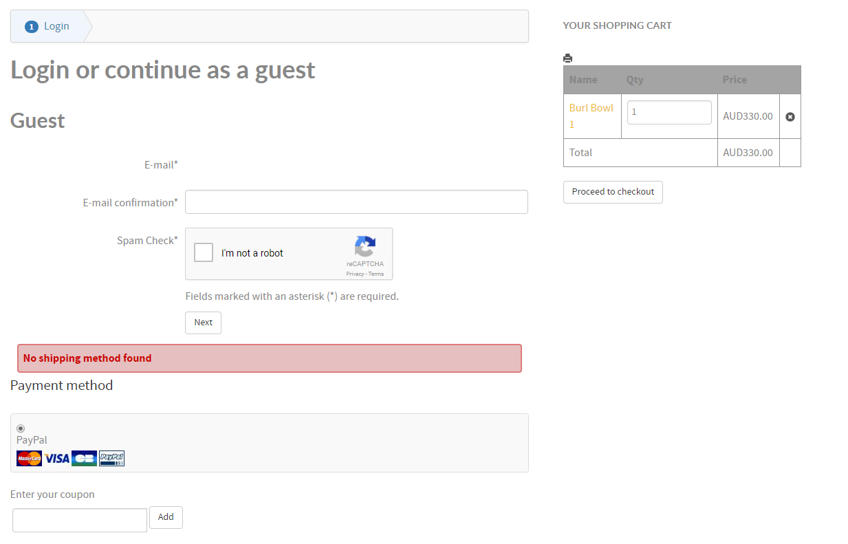

    Only one small issue left - with the manual shipping unpublished the system now displays an error message on login ( screenshot attached), stating 'no shipping method found.
    While I guess this is technically correct since Australia Post has not been triggered yet it still is confusing to the user.
    How do I get rid of the error message?
    Last edit: 8 years 10 months ago by thomas.boepple. Reason: spello
    8 years 10 months ago #281835
    Your issue is coming from the fact that you have the login/address actions on the same step that the shipping action is in.
    The solution will just be to make sur tat these actions are not in the same step (login&address before shipping).
