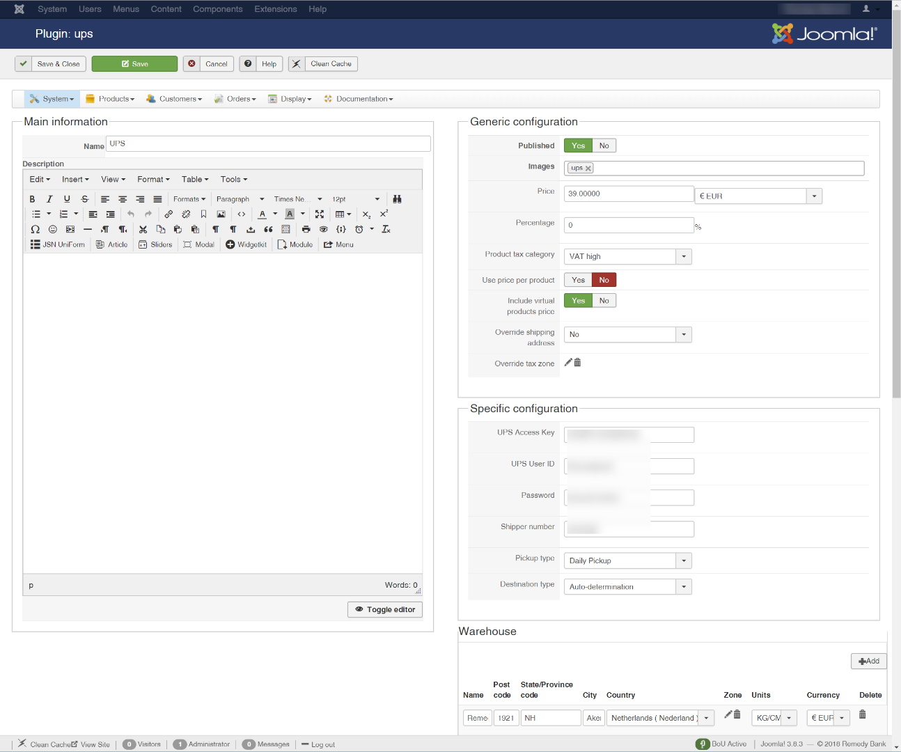

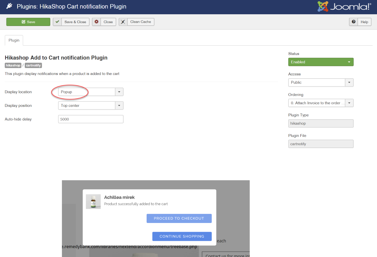

I have an issue with the UPS Shipping plugin in combination with Hikashop Add to Cart notification Plugin.
The UPS Shipping Plugin is working fine.
But when UPS Shipping plugin is enabled then there is no more pop-up from the Hikashop Add to Cart notification Plugin.
We have to refresh the page by our-self to see what's in the shopping cart.
Our UPS configuration looks like this:
Hope you can find out what causes this issue.

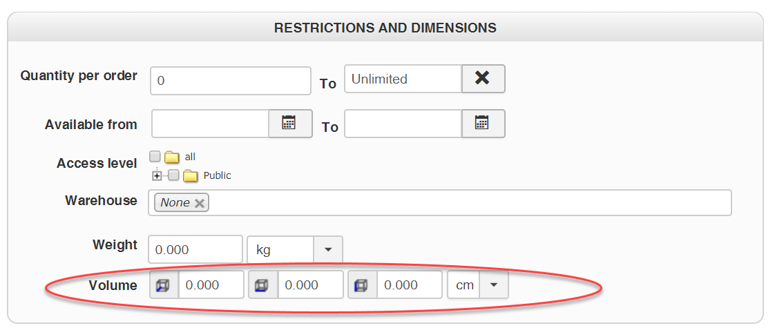

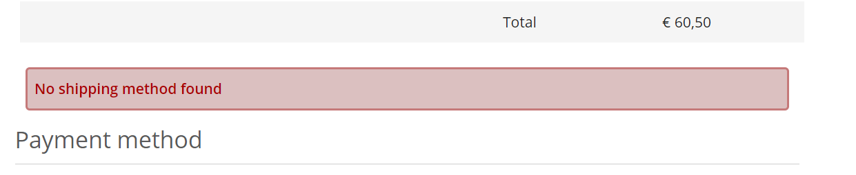

UPDATE:
I find out that it has something to with the Volume.
When you add the dimensions the pop-up won't show-up anymore.
But when there are no dimensions (for virtual products for example) you will get the massage that there is no shipping methode found.

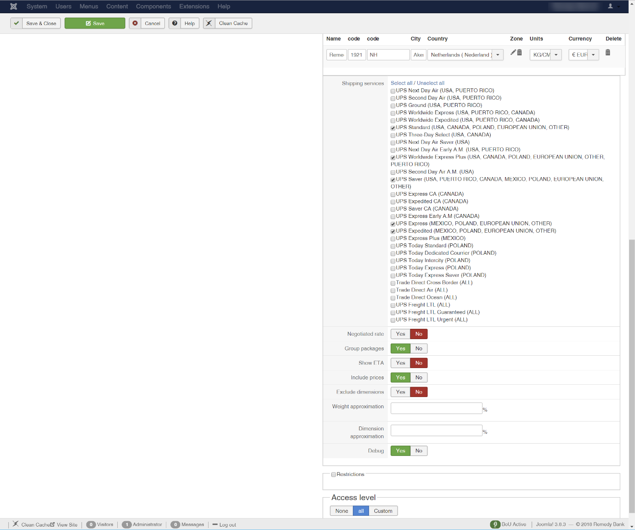

8 years 7 months ago #286894
Hello Lumiga,
Can you disable the "Debug" option through your UPS shipping method configuration page and test it again ?
Thank you.
  • Posts: 637
  • Thank you received: 26
8 years 7 months ago #286962
Hi Mohamed,
I think that solved the issue ;-)
I did some test and in all cases the popup shows up.
Thanks!
Kind regards,
Lumiga
