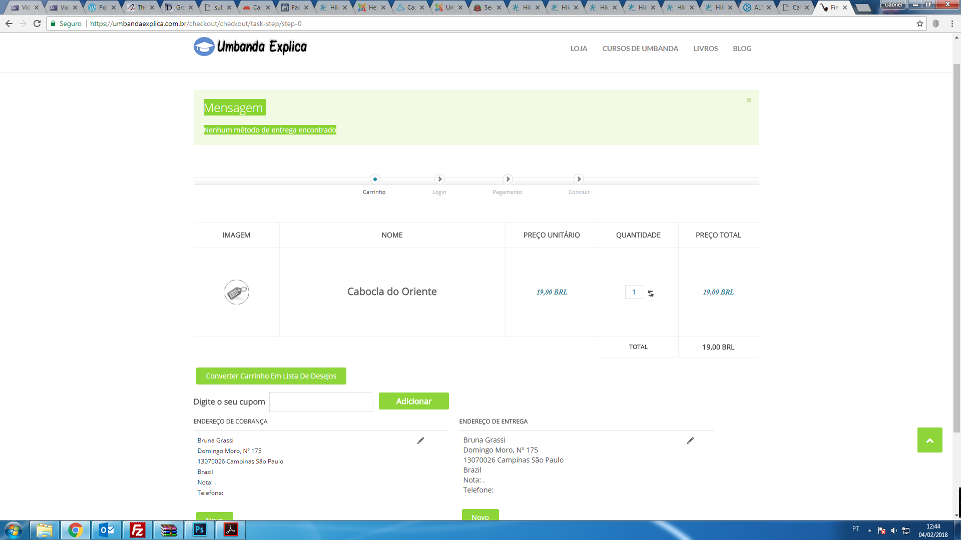

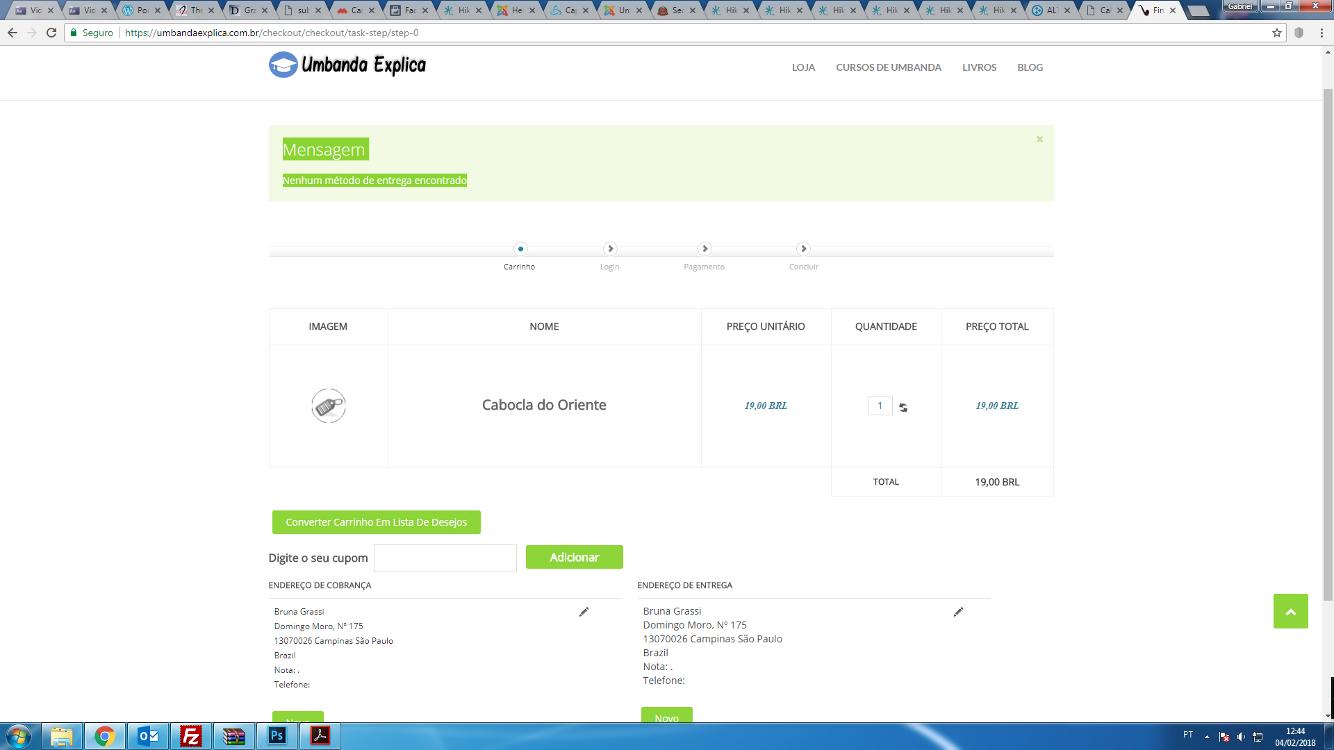

I'm trying to implement the "Correios (Brazil)" plugin - shipping method - but it does not appear in the cart (checkout).
Only "No shipping method available" appears. Both the plugin and the product are unrestricted and have a defined weight.
I would like help from you.
Edit: I have already followed the FAQ with problems with the upload plugin and did not work the possibilities.

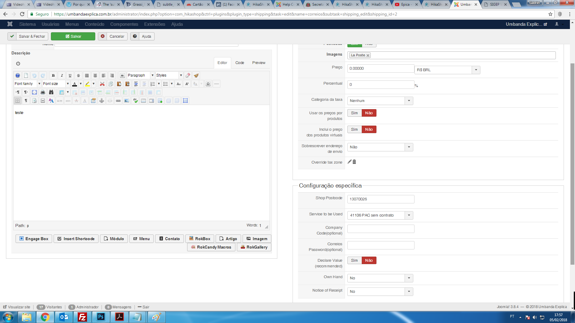

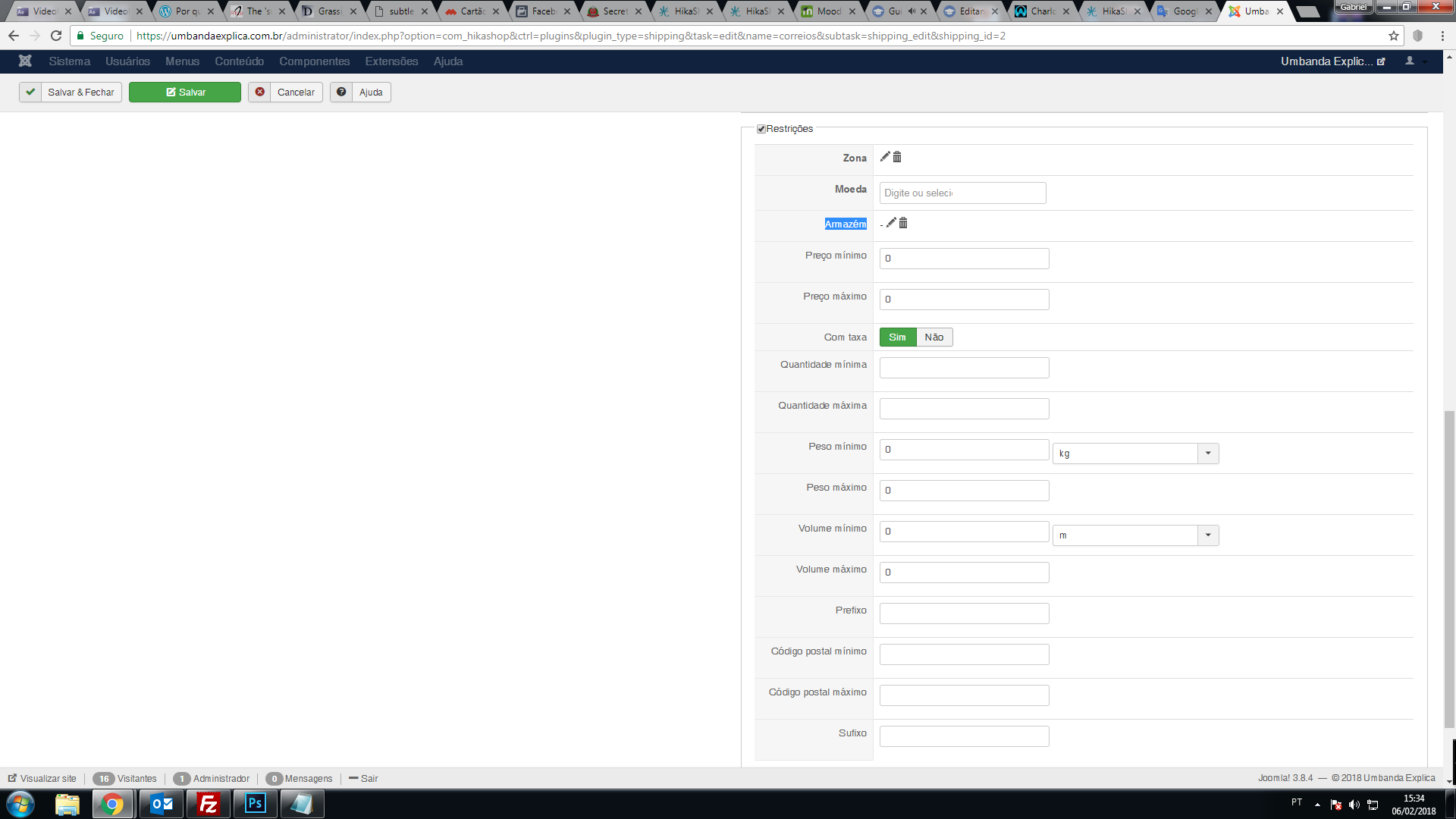

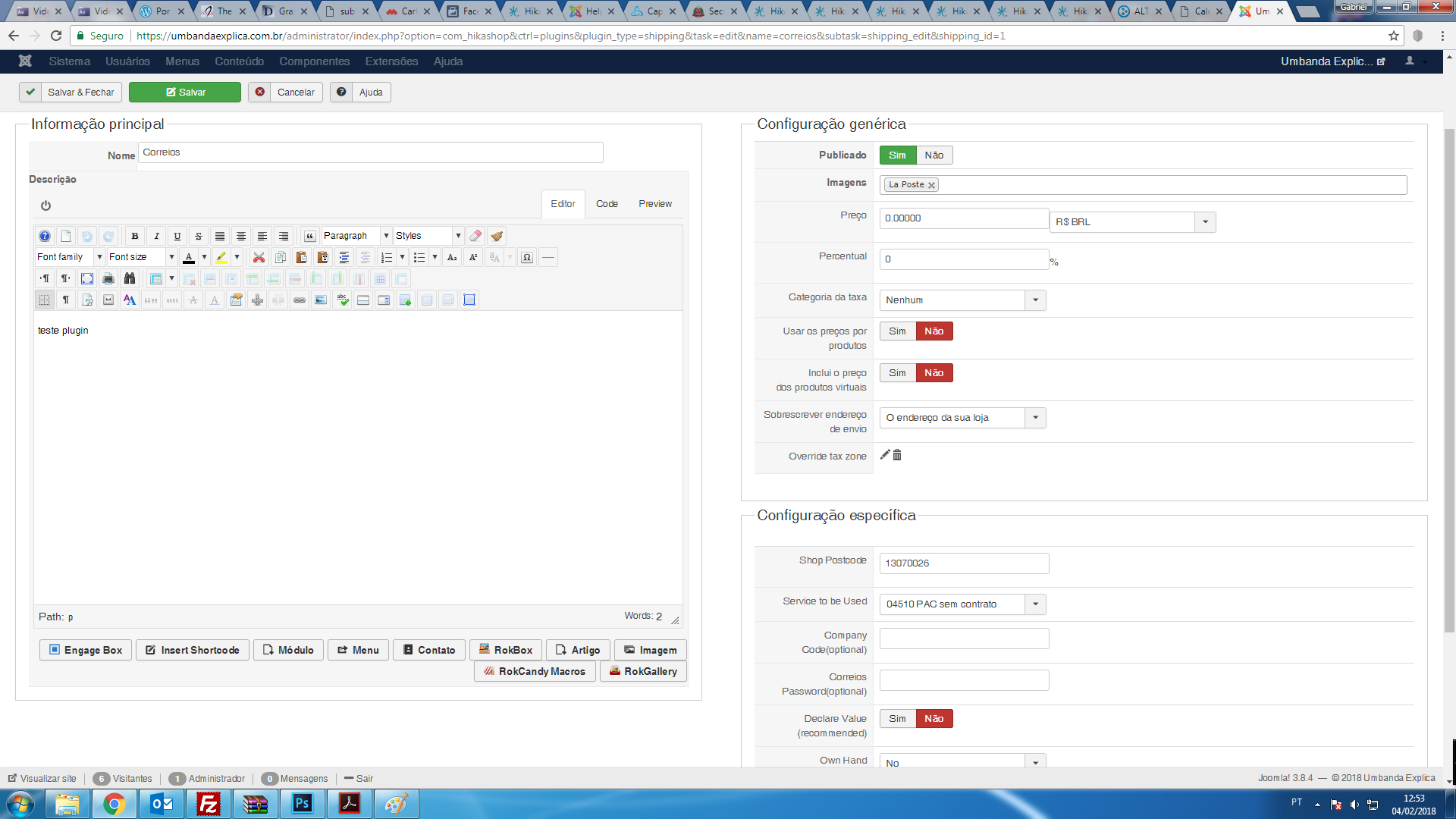

Can you show us the full configuration of your Correios shipping method so that we can check your shipping "Warehouse" option ?
Thank you.

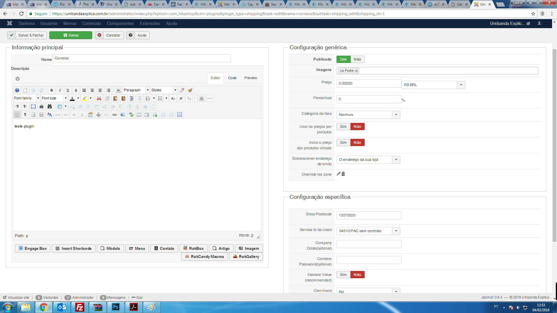

Thank you.
  • Posts: 29
8 years 7 months ago #287397
Added
Warehouse = Armazém
Last edit: 8 years 7 months ago by mazin07.

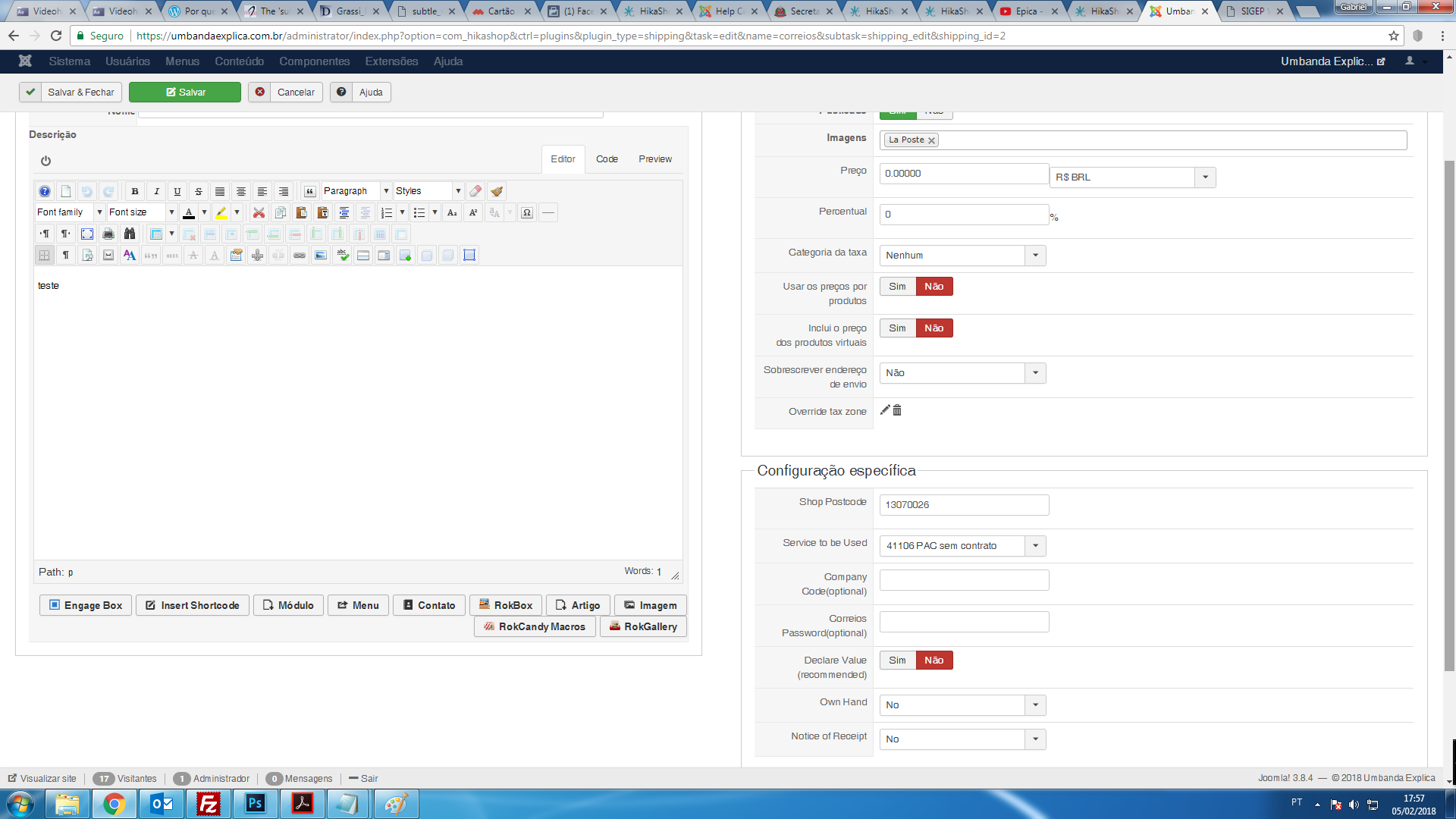

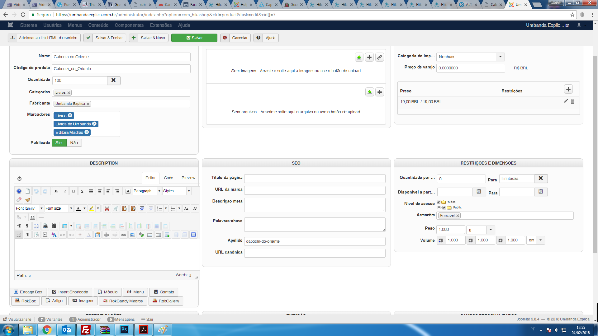

8 years 7 months ago #287432

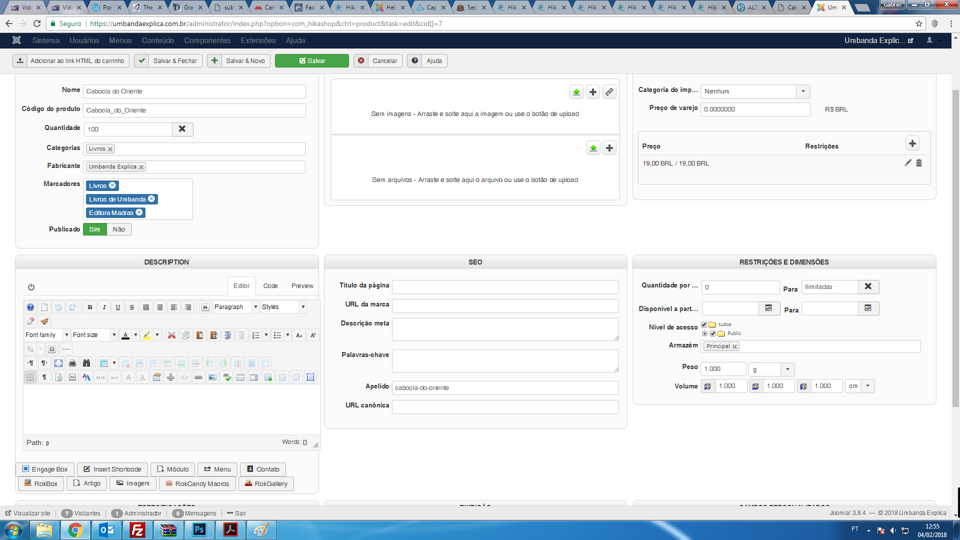

In that case, I think that your issue is coming from the fact that you have different warehouses set on your product configuration page and your shipping configuration page.
You should try it with the same value.

8 years 7 months ago #287520
I configured the warehouse in the product (it was already set up) and the shipping plugin, but it does not appear. As I said, it is missing to insert this information into the plugin.
