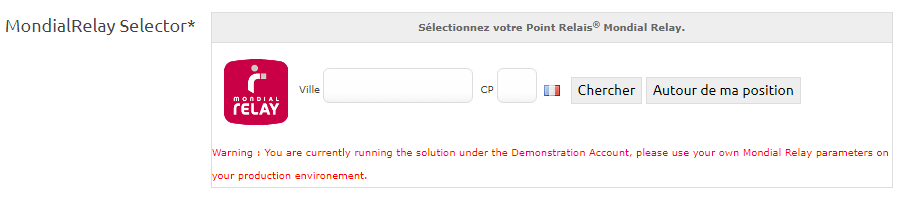

  • Posts: 8
8 years 5 months ago #291100
So this is the only thing the plugin wants to display:

  • Posts: 10
8 years 5 months ago #291107
Hello
The answer must be in the message in red... is the field set up with the right information from the global Relay customer account?
Last edit: 8 years 5 months ago by apweb.
  • Posts: 8
8 years 5 months ago #291109
Sadly the message in red is present in the tutorial, it's simply because I filled the input field with a test code instead of the actual customer number.
So what the message means is that I'm developing and this will not work as a stable version of my website, but it's cool for developing it :(

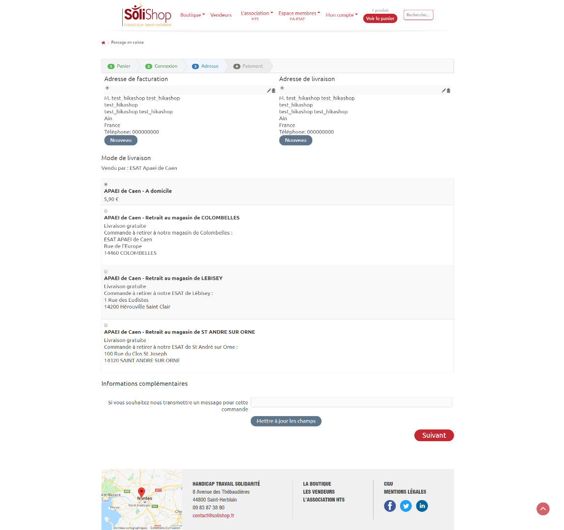

  • Posts: 86183
8 years 5 months ago #291098
I've tried to look at the issue on the link you gave but I can't see the mondial relay custom field on your checkout:
Could you provide instructions to reproduce the issue ?

  • Posts: 8
8 years 5 months ago #291140
I kept doing some tests to check how I could've gotten it wrong,
So I put the plugin back up for you to try it, you actually did everything right so reproduce the purchase process as you just did and it should display "Fields" (or "Champs" in french) right after "Adress".
Thanks SOOO much for helping, you're lovely :)
