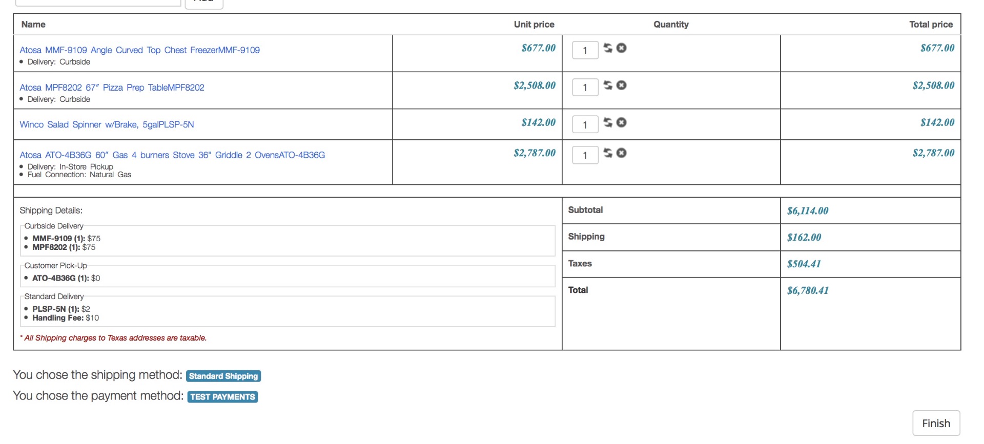

8 years 2 months ago #294202
Success!
But first, you've got an error in the sample code you provided. It looks like there's a missing function call (and opening parenthesis) in the third line.
However, I suspect that the missing method is $currencyClass->getUntaxedPrice(), since I find similar nearly identical code in the "AuPost2" shipping plugin. There, code which is very similar to yours can be found within the addRate() method, which is used to build rates from a CURL call to the AU Postal service provider. Since I don't need that method, I placed your code within the onShippingDisplay() method's foreach loop which parses through the $rates object.
You speak of 'the "Product tax category" option of your shipping plugin', and it took me a while to find it. It isn't displayed unless the "Automatic Taxes" control is set to "no". I think that's a recent change, which you might need to remember when you're covering a topic like this.
Once I dug through those challenges, your code worked beautifully. My cart is now displaying my shipping details, calculating shipping costs properly, AND calculating the tax properly on the shipping charge.
I think this covers everything.
