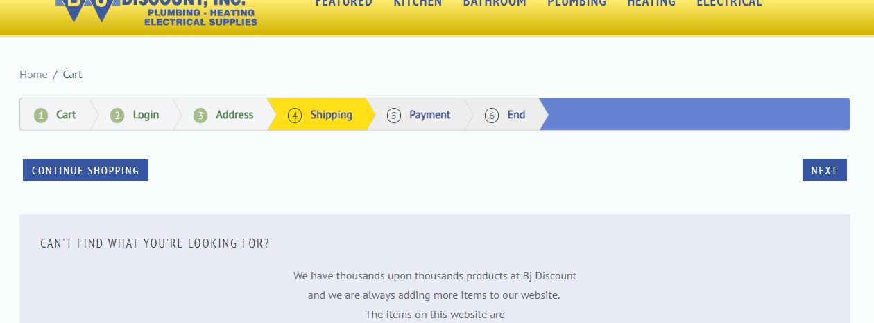

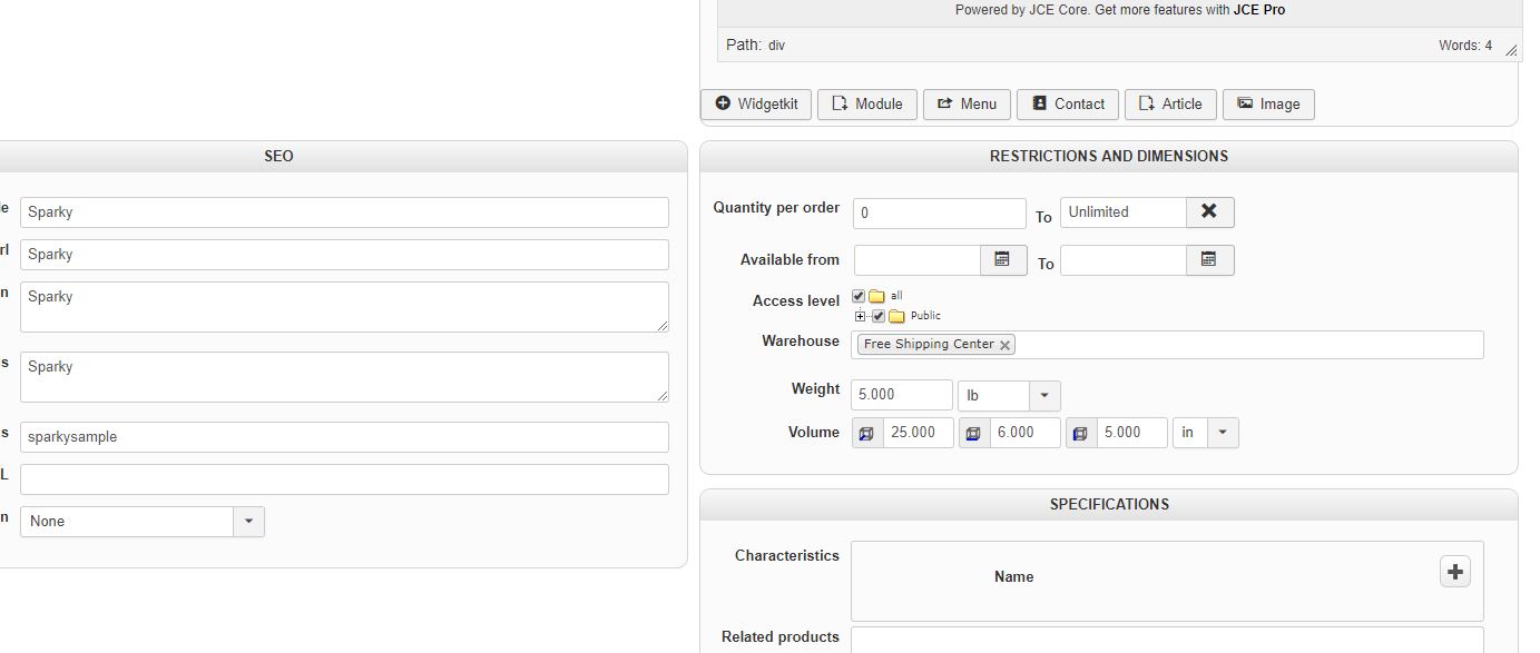

i created a new warehouse, added some products to that warehouse for free shipping. those products are working, but now the UPS shipping has stopped working. It was working but now on other products it does not show any shipping. it doesn't show any options, just Next. please advise.

7 years 11 months ago #296834

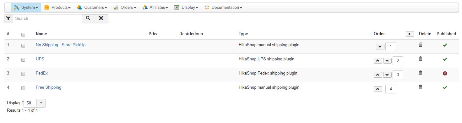

here are some screen shots...
^jasonhoblin
7 years 11 months ago #296847

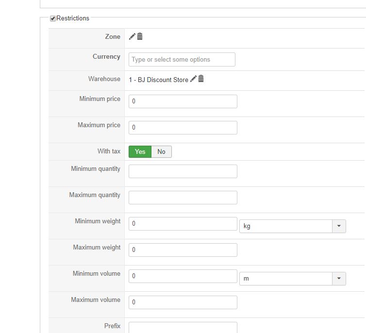

We're sorry but we'll need more information about it to properly reproduce it on our end, so can you please show us :
- How you configured the products dimensions/weight that you used during your tests ?
- The Shipping address used during your test ?
- "Restrictions" option of your shipping method ?
Kind regards,
Mohamed Thelji.

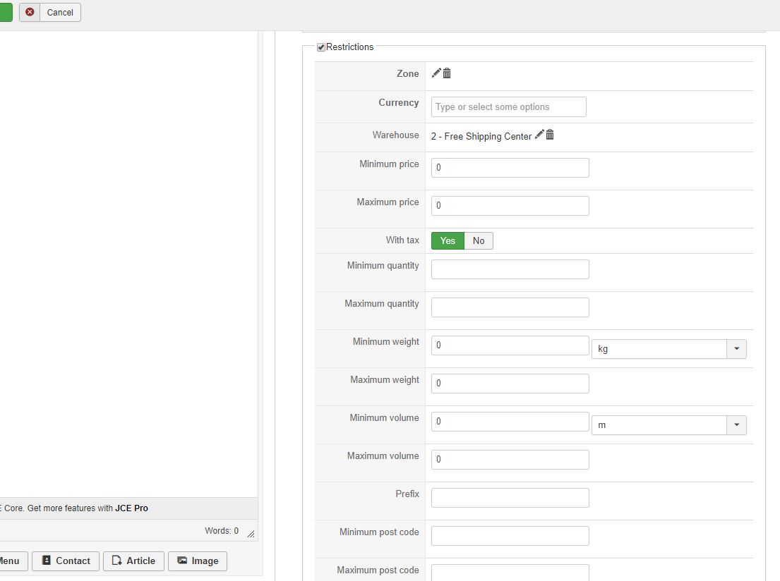

  • Posts: 31
7 years 11 months ago #296951
images for your requests....
^jasonhoblin
7 years 11 months ago #296976
Your issue is probably coming from the fact that you have restricted your UPS shipping method to a defined warehouse but not products that you have added on your cart.
The solution will be to check that your products have the same warehouse restriction as your UPS shipping method or directly unset the "warehouse" option of your UPS shipping configuration page.
Best regards,
Mohamed Thelji.
Last edit: 7 years 11 months ago by Mohamed Thelji.

7 years 11 months ago #297251
The two Normal products should calculate UPS or allow local pickup
Do you mean that both of these product should be usable with both "UPS" and "No Shipping - Store PickUp" ? If that's the case you'll have to set the "Warehouse" option of both of these shipping methods to "BJ Discount Store", because without this, shipping methods will be available for every product if you don't set any warehouse to these shipping methods.
the third featured product should not offer shipping options
Which shipping methods should be used with that product ? Because without shipping methods assigned to that product warehouse you'll have a "no shipping methods found" error message as your product have a weight / dimension.
Kind regards,
Mohamed Thelji

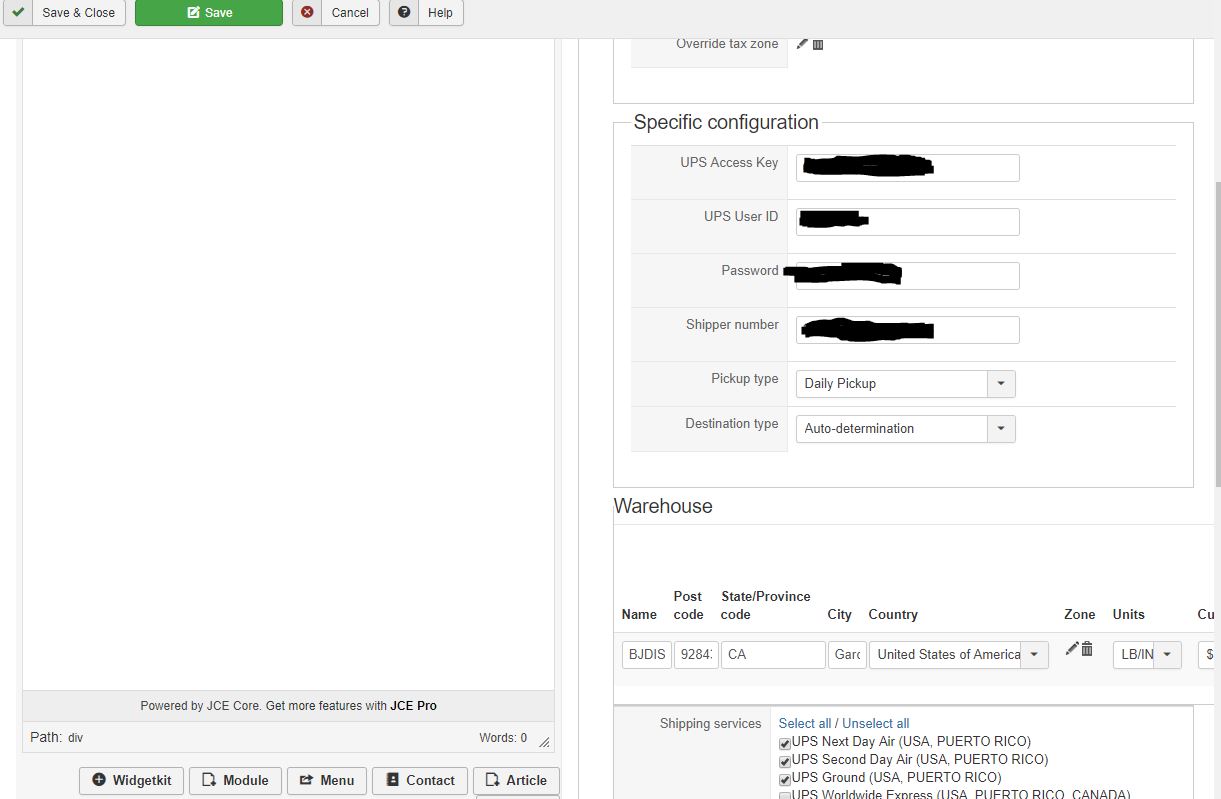

  • Posts: 31
7 years 11 months ago #297533
Ok, I set the warehouse for normal "UPS" shipping and "No Shipping - LocalPickUp" to the BJ Discount warehouse, under restrictions.
I verified the products I'm testing have 1) weight, 2) dimensions, and 3) are in the BJ Discount Store warehouse.
Now the UPS is not showing at all. for normal products that should charge shipping.
For the featured products, with free shipping, I assigned to the products free shipping warehouse, AND just added the restriction of the free shippng warehouse to the free shipping method and now that seems to be working ok. good.
Why did UPS stop working for normal products after I added the warehouse restriction?
(again, I verified the products I'm testing have 1) weight, 2) dimensions, and 3) are in the BJ Discount Store warehouse. )

7 years 11 months ago #297563
Your shipping methods and products seem to be correctly configured.
I also tested it on my end with the same configuration and UPS services were correctly returned, can you test it with the "Checkout legacy" option set to NO via "Hikashop->System->Configuration->Advanced" and your website / browse cache cleared ?

  • Posts: 31
7 years 8 months ago #300707
Well, now its not working...
Customer just ordered a products and it completed the sale without charging shipping.
CUSTOMER IS VERY ANGRY!
1) The product has weight and dimensions.
2) The product is in the correct warehouse.
3) The UPS shipping methods is enabled.
4) The shipping method has the same warehouse.
5) There are no custom restrictions.
6) The checkout process, on the Shipping tab, just says Continue.

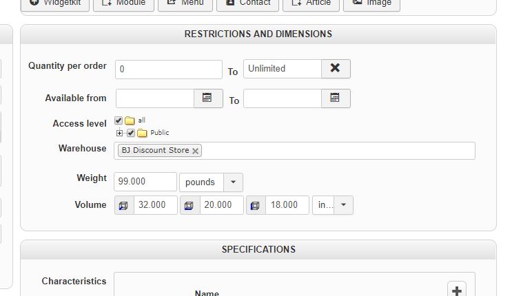

Images of the issue are attached.
Testing this product (MS604114CEFG-01):
www.bjdiscount.com/products/product/404-...toilet-1-28-gpf.html
Please advise.
^jasonhoblin
Last edit: 7 years 8 months ago by jasonhoblin.

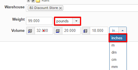

7 years 8 months ago #300723
Your issue is coming from Weight/Dimensions Units used through your product configuration page as you can see through the attached screenshot, this product was probably imported using an invalid CSV file or SQL request to your database may have caused this.
Weight/Dimensions Units used are not defined through "Weight / Dimensions symbols" option via "Hikashop->System->Configuration->Advanced" which is causing that issue as Hikashop doesn't "recognize" these units.
The solution will just be to replace "Pounds" by "lb" and "Inches" by "in" through your product configuration page, and test it again after having cleared your cache.
Kind regards,
Mohamed Thelji
