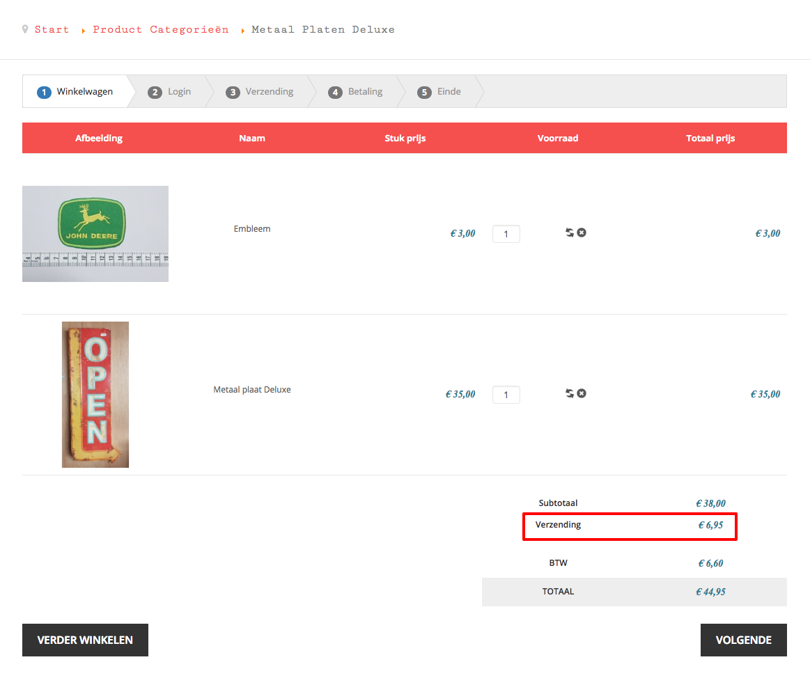

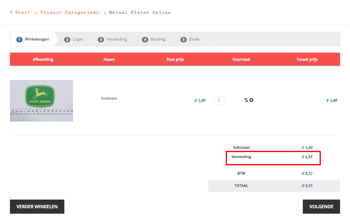

  • Posts: 23
7 years 11 months ago #297042
Hello Jerome,
This is how I got the wrong shipping cost ('verzending' in dutch)
1) I selected from the category "Strijkemblemen" -> Tractor merken -> the John Deere embleem and put it into the cart.
2) I go to the cart with the button "Verder naar kassa" -> the shipping cost are €0,83 (see picture cart 1)
3) I selected from the category "Metaal Platen Deluxe" the "Open" plaat and put it into the cart.
4) I go to the cart with the button "Verder naar kassa" -> the shipping cost are €6,95 (see picture cart 2)
5) Then I remove the Metaal Plaat Deluxe from the cart and the shipping cost are still €6,95 (see picture cart 3)
The shipping cost should go back to €0,83, but it doesn't??
I've done this test over 20 times and every time I got the issue.
Kind regards,
Frits
  • Posts: 26380
7 years 11 months ago #297069
Okay ; so it's a misconfiguration issue.
You have several available shipping methods in the same time.
When you add your second product, the first shipping method is not more available and it's another which is pick-up.
But when you remove that product, the selected shipping method is still available ; so it stayed selected.
So I suppose you didn't put weight restrictions for that one.
