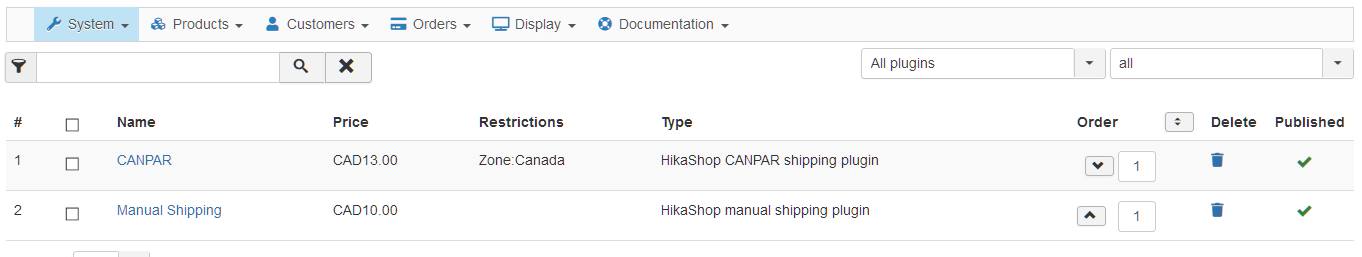

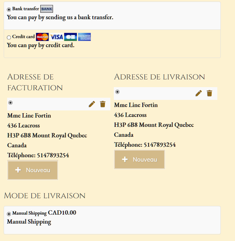

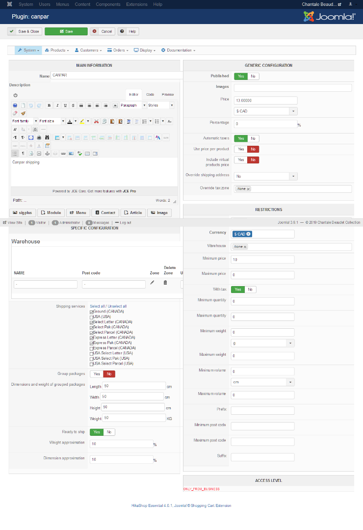

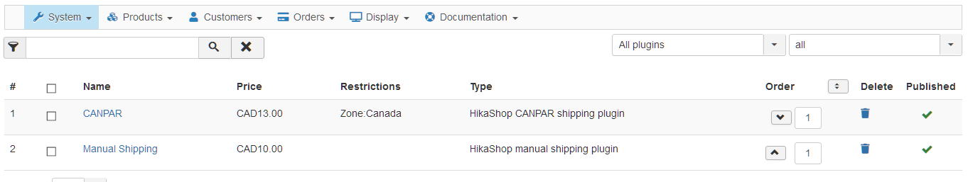

I am trying to implement the CANPAR shipping method without success. I have 2 shipping methods, Manual and CANPAR; the CANPAR does not show on the checkout.
I left message in checkout section of Forum, got an answer from Mohamed and responded. Here it is again.

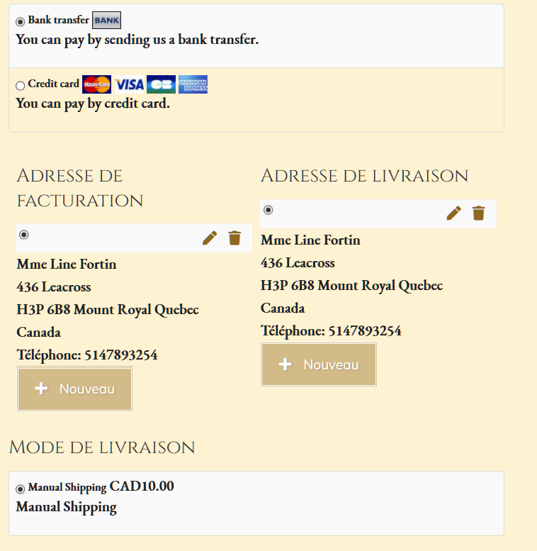

I have read the Shipping document in the FAQ and I can tell you that the manual shipping method works, it shows on the checkout (see screenshot attached).

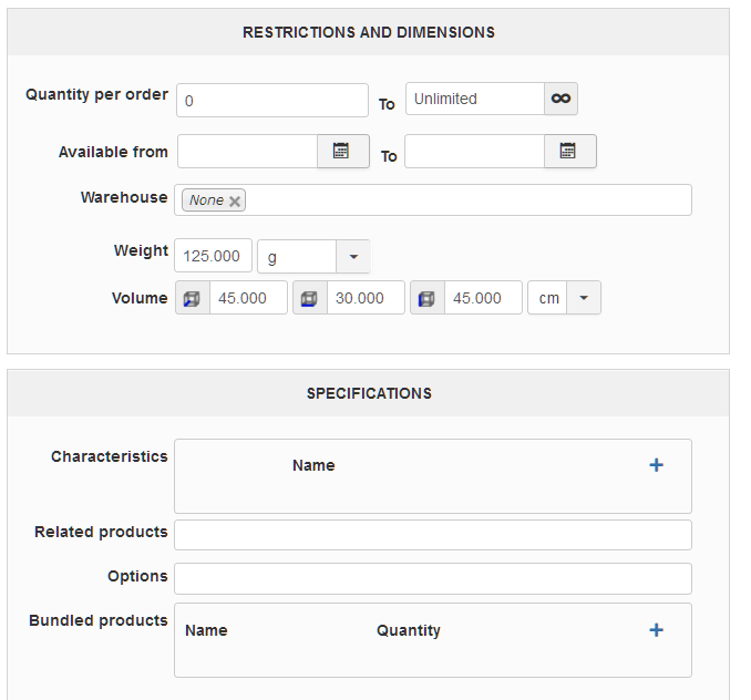

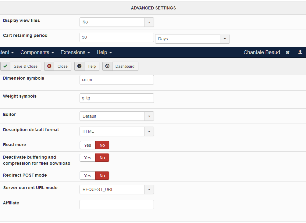

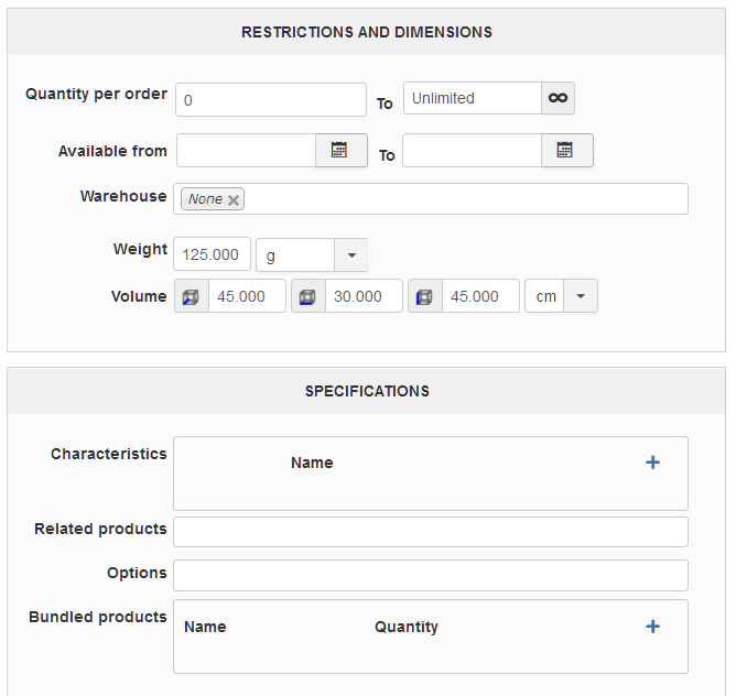

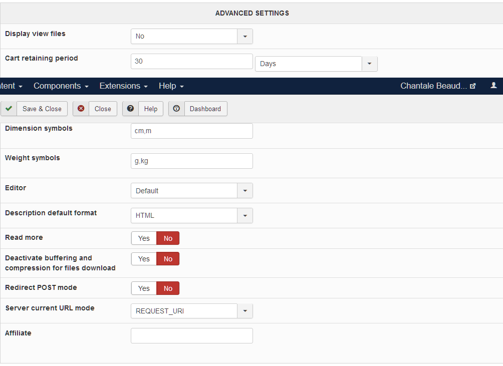

All products have weight (gm or kg) and dimensions (cm or m), These are defined in the display configuration and show in the CANPAR configuration.

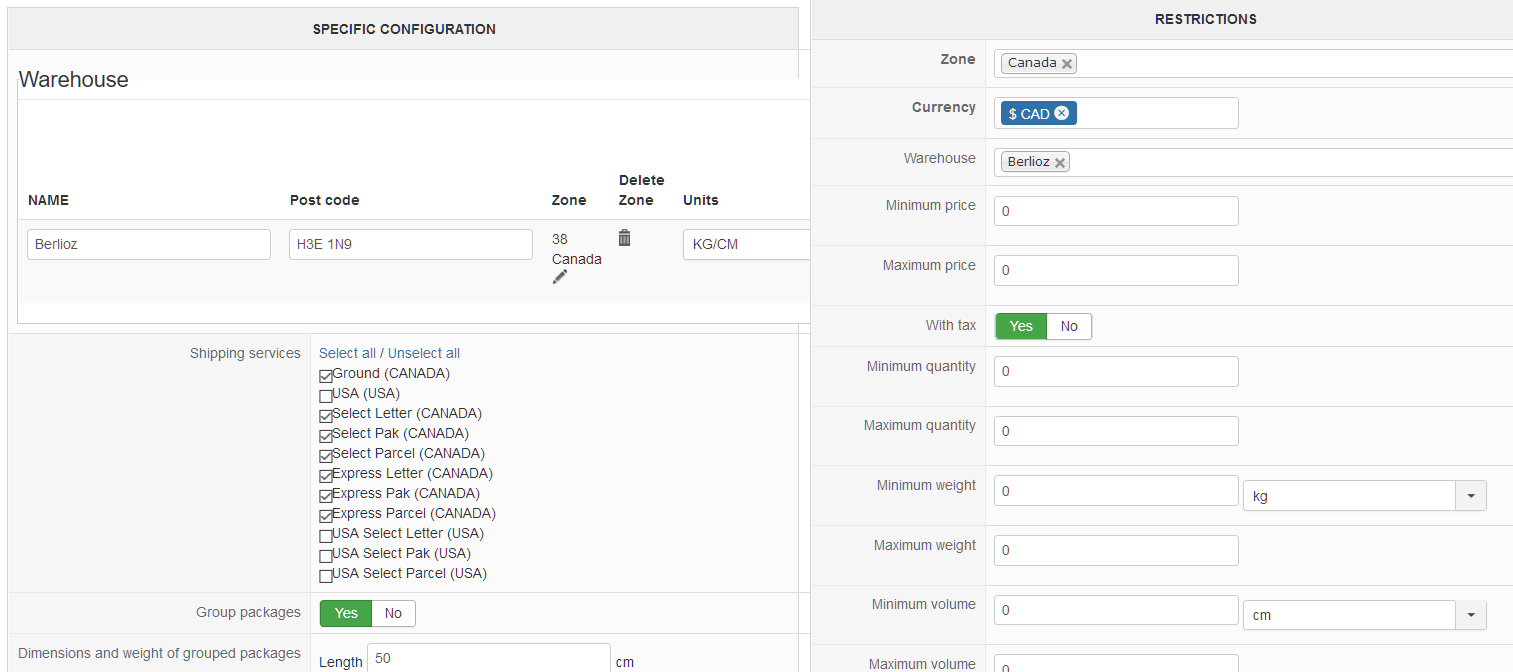

I have NO RESTRICTIONS. ( I tried all sort of permutations with or without warehouse, with or without zone
The min and max quantities are set to 0
I am attaching the current CANPAR configuration as well as a partial view of a product and the advanced configuration showing the measurements I use
Are you aware of anybody that has used this plugin successfully?
If anybody has implemented this successfully please let me know how. My customer is using CANPAR and if I cannot get this to work it will probably be a show stopper!

The Canpar plugin has not been developed by the HikaShop team but it has been given freely by its original developer.
CF : github.com/HikaShop/hikashopshipping-canpar
For what I can see in your screenshot, there is no warehouse configured. So it is one blocking element to let the plugin do its job.

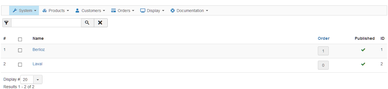

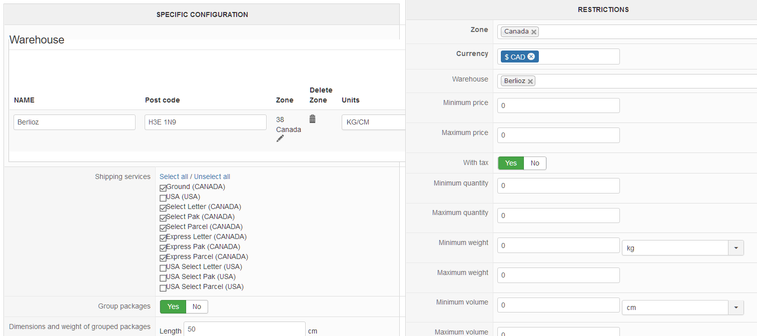

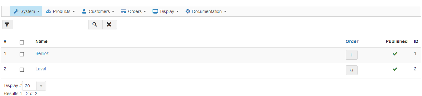

As you can see in theses snapshots I have created 2 warehouses and used one in the specific configuration of the CANPAR Plugin
Still not working.
I noticed that in the specific configuration I can enter anything, it does not seem go be linked to the warehouse I created is this normal?
Also the Units in the plugin are in Capital letter, Can you tell me if this is case sensitive? I'd hate to have to change this in all the products,

I'm afraid that your mixing CANPAR configuration (warehouse) and HikaShop warehouses.
Please remove all HikaShop warehouses since it is not useful in your case.
You just need to configure the CANPAR warehouse so the Shipping plugin would have the "sender" information that it will give to the shipping API to get quotes.

I created the Hikashop warehouses because I was trying to get warehouse under the restriction.
The warehouse info I entered in the specific configuration does not seem to do anything and I cannot enter more than one.
Anyway I removed the Hikashop warehouses and it does not change anything.
