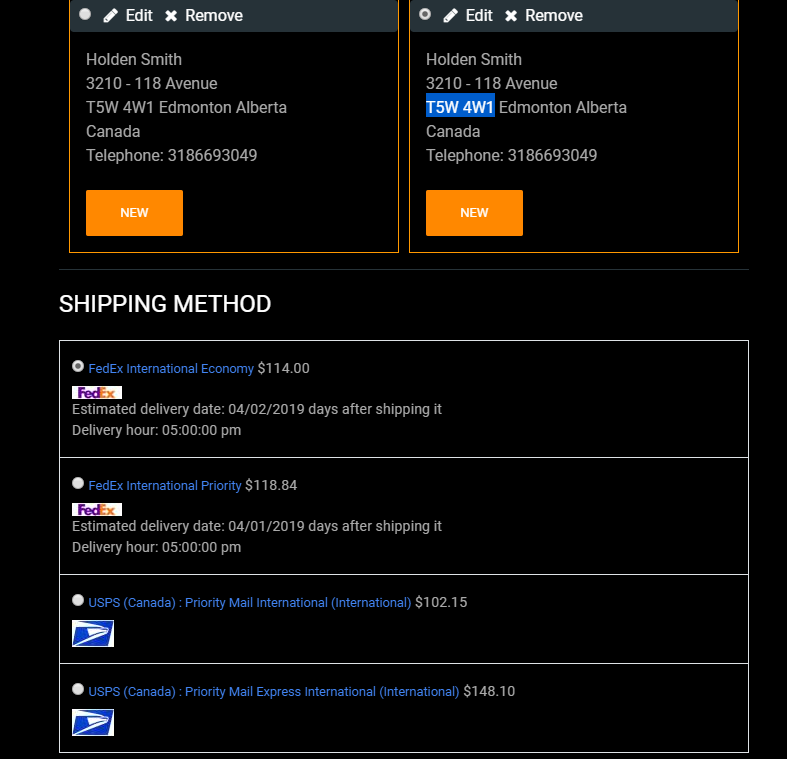

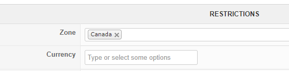

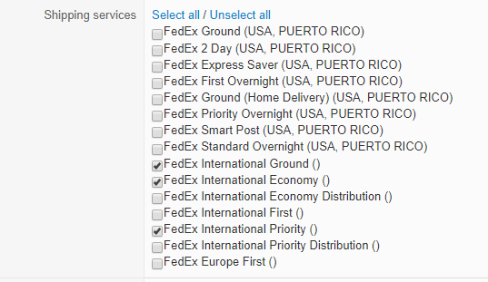

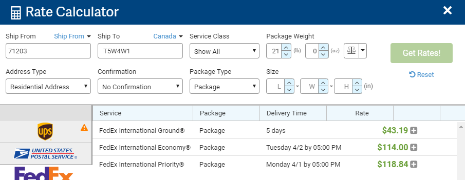

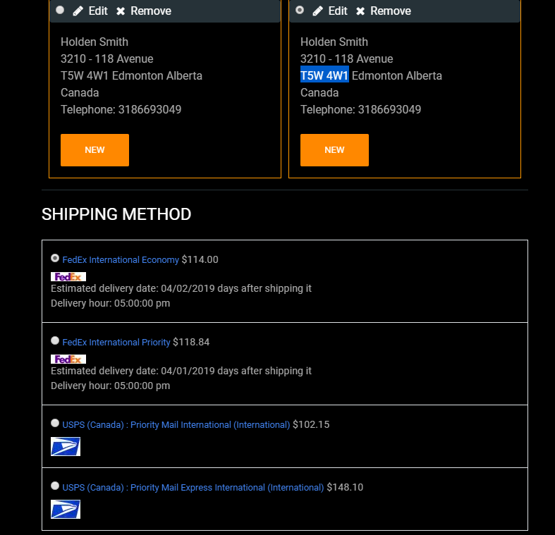

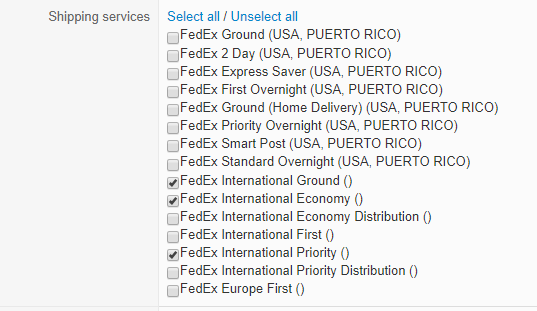

The Fedex shipping plugin seems to work flawlessly for all shipping services except Fedex International Ground shipping. I have two of the Fedex shipping methods -- one for US and one for Canada, as the international options will show on US destinations otherwise.
With that being said, here is my config for the Canada version with the results. Again, the international ground is missing:
Let me know what you think or if I am missing something.

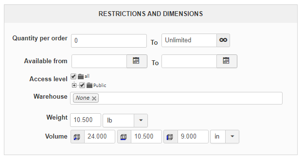

Can you also show us some screenshots of your products dimensions / weight so that we can directly reproduce, test and debug it on our end ? Thank you.
Kind regards,
Mohamed Thelji.
  • Posts: 303
  • Thank you received: 18
7 years 5 months ago #305345
Sure thing! Screenshot of product dimensions/weight is below:

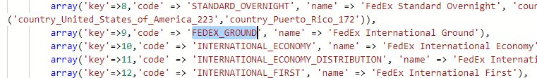

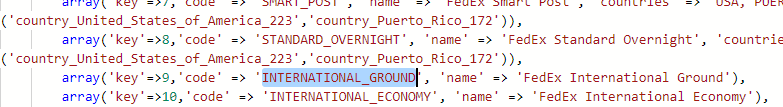

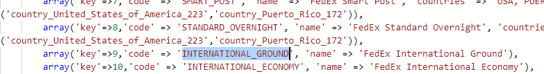

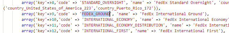

I found the error in the shipping plugin...
in plugins/hikashopshipping/fedex/fedex.php, line 26 uses
array('key'=>9,'code' => 'FEDEX_INTERNATIONAL_GROUND', 'name' => 'FedEx International Ground'),

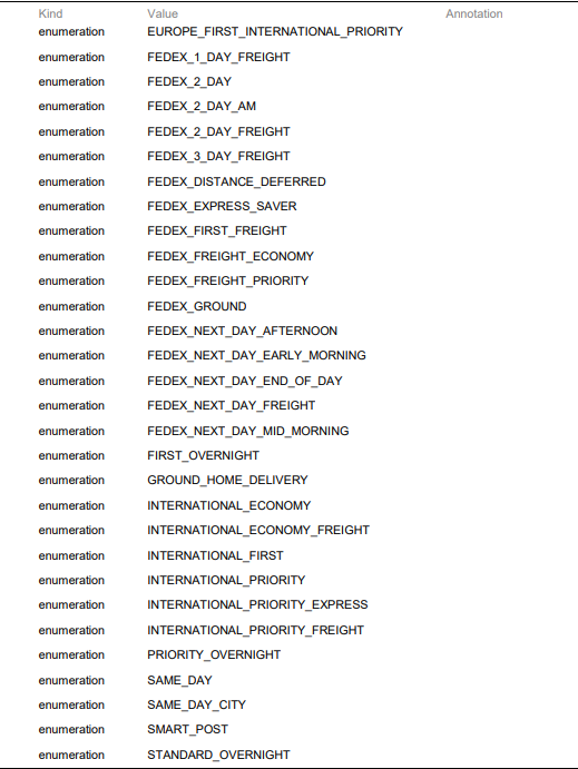

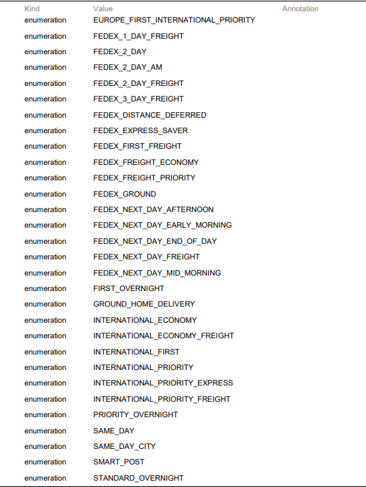

However, according to the Fedex Web services documentation, the possible shipping methods/names are:
Therefore, line 26 of the fedex.php file should either be removed or change to:
array('key'=>9,'code' => 'FEDEX_GROUND', 'name' => 'FedEx International Ground'),
I'm not sure what the best method is, but after changing it to FEDEX_Ground, the Fedex Ground display with proper rates to countries outside of the US. Maybe you know of a better way to fix it? Also noticed that it still shows "Fedex Ground" on the frontend in checkout, instead of Fedex International Ground.
7 years 5 months ago #305620
They probably changed it through their last release, we just applied that patch through the last FedEx shipping plugin. Now you'll just have to enable the "FedEx Ground" shipping service and it will work fine.
Thank you for your feedback !
