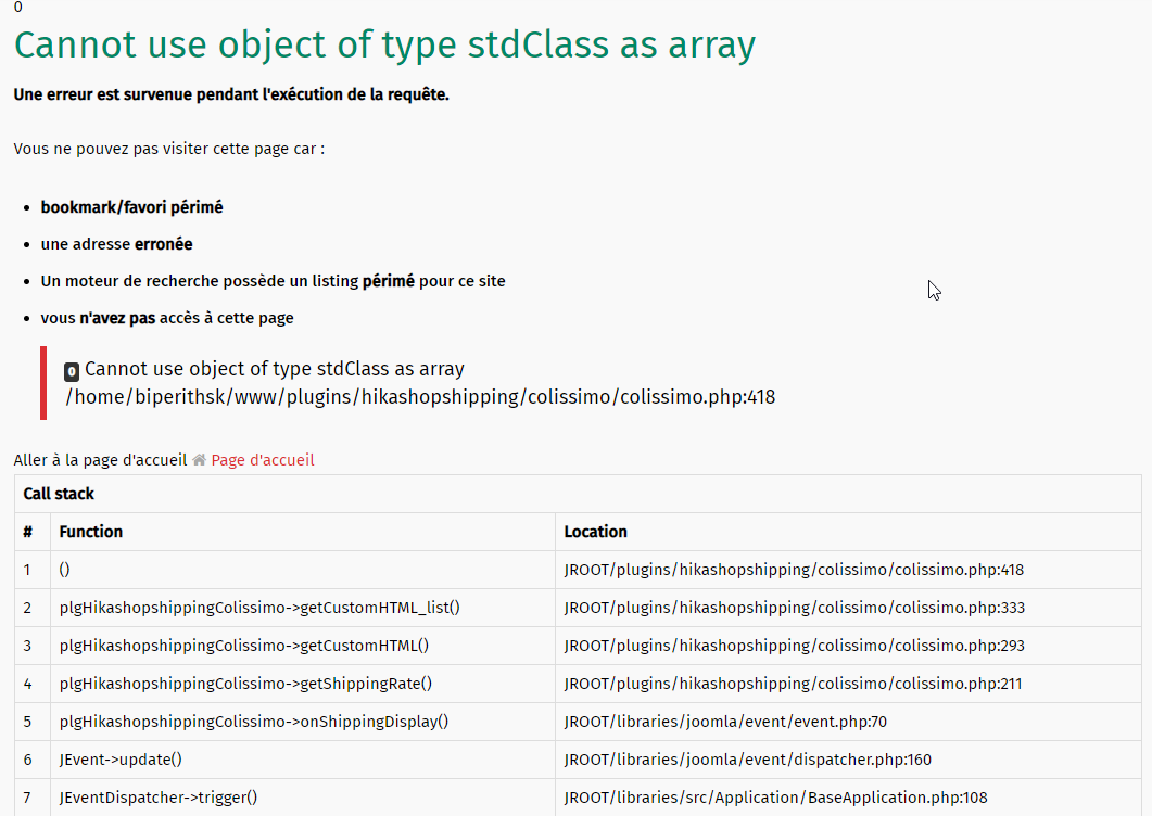

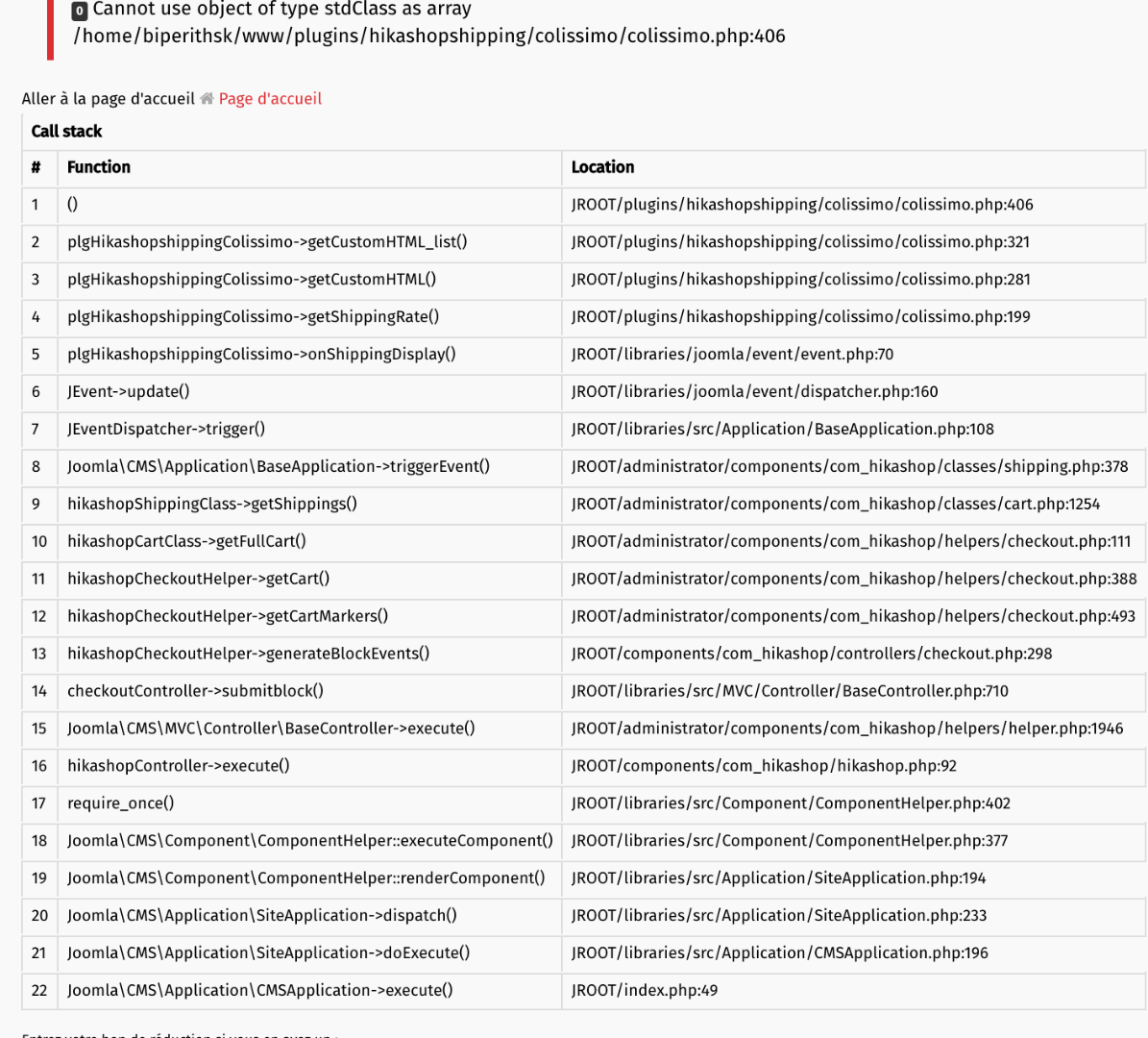

Thank you for your quick answer.
The error with reporting turned on (see attacheg image).

  • Posts: 6
6 years 11 months ago #311820
Hi Jerome,
I downloaded the plugin last saturday, the 5th !
I already checked the file, and in my side, the line 406 is blank ! (see attached...)...the reason why i'm here trying to find an explication with your precious help !

  • Posts: 26386
  • Thank you received: 4078
6 years 11 months ago #311859
I still don't understand why you have the line 406 but I have uploaded a new package with a fix which could be the one you have.

Thank you Jerome,
The new package still doesn't work, same error as previously (Cannot use object...), but the line has changed !
It's not 406 but 418 ! See attached...

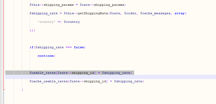

  • Posts: 26386
6 years 11 months ago #311905
Now you have the same line number than mines, I was able to see the error an add a patch for that.
