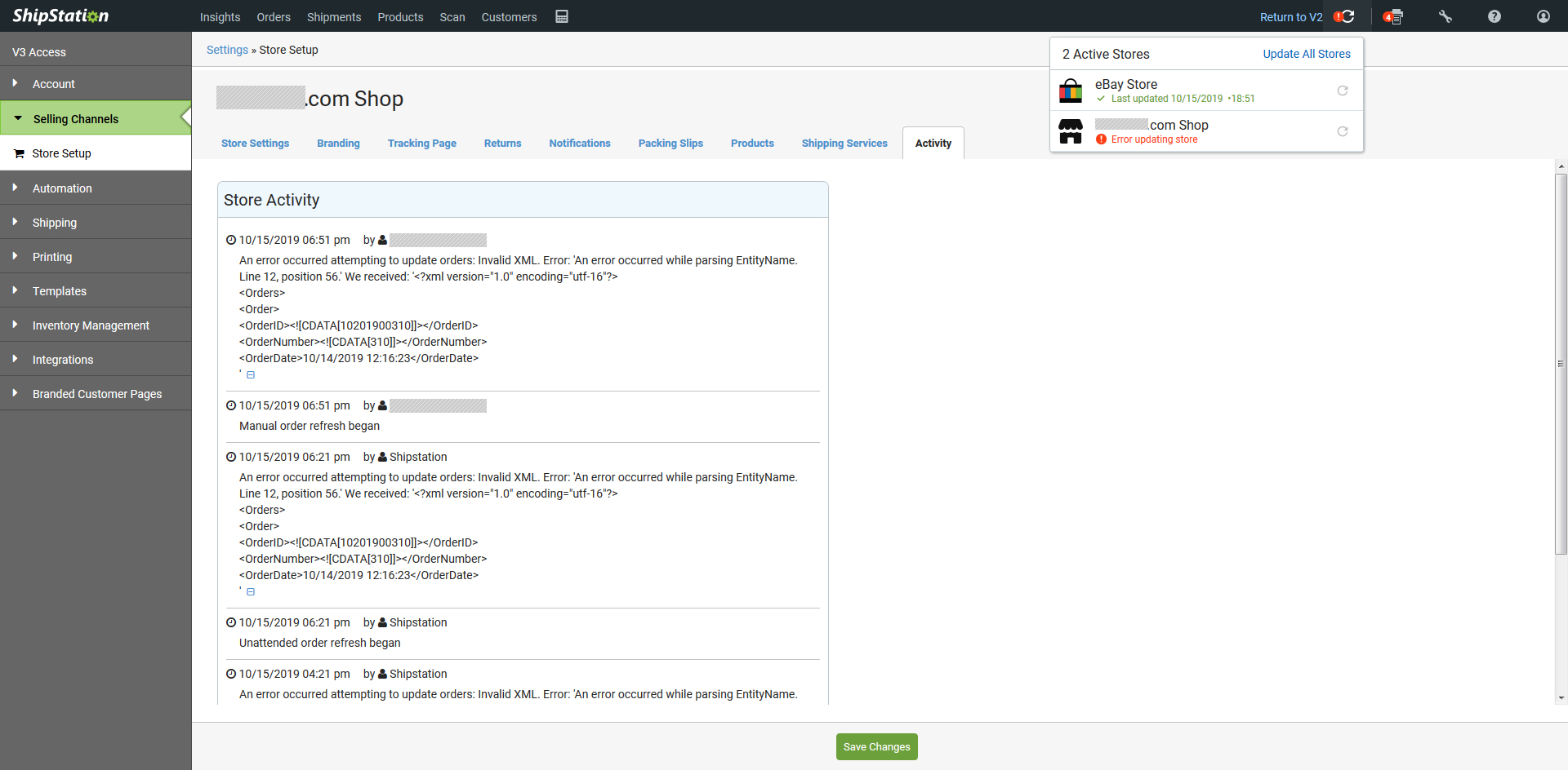

6 years 11 months ago #312095
- What do you mean by "I deleted 295" from backend or from Sql ?"
A: From the backend, not the SQL.
- Can you describe more precisely where you can read this error (screenshot)
A: Attached screenshot. You can see the error message near the top right where you can refresh it and you can see the log.
