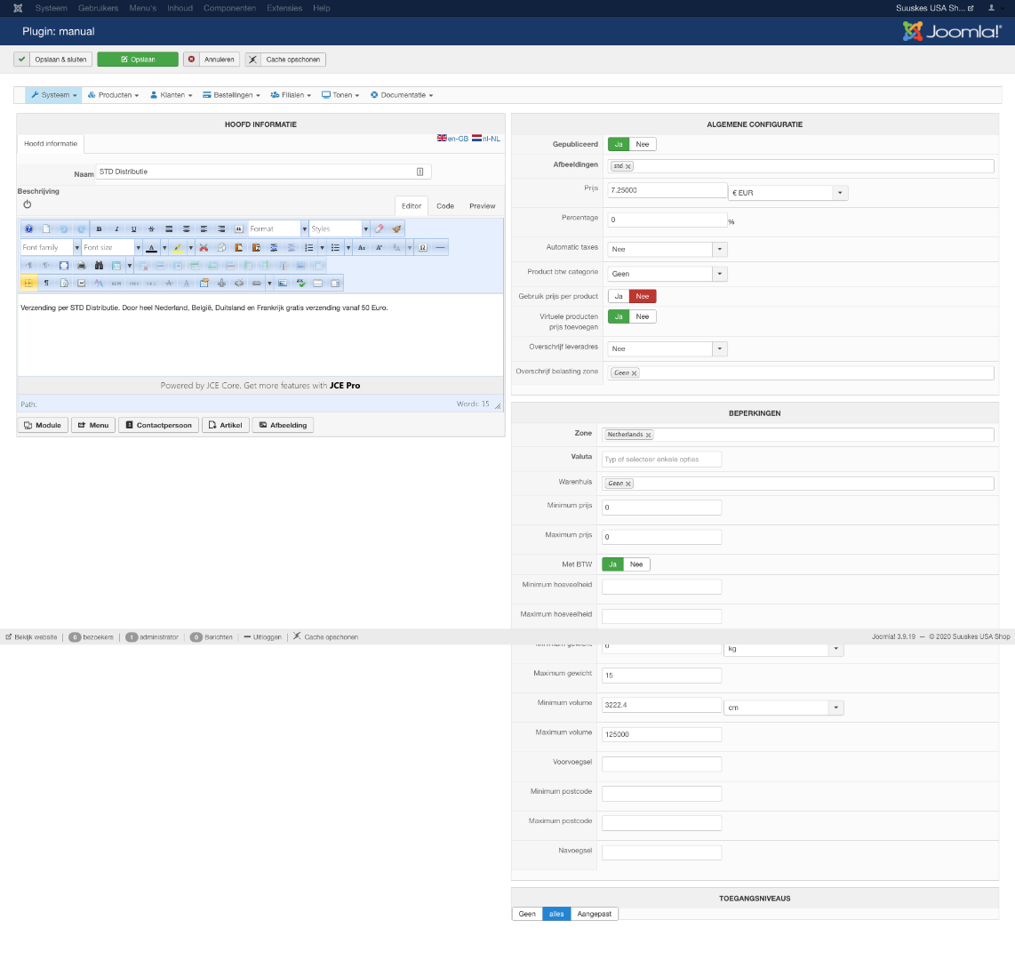

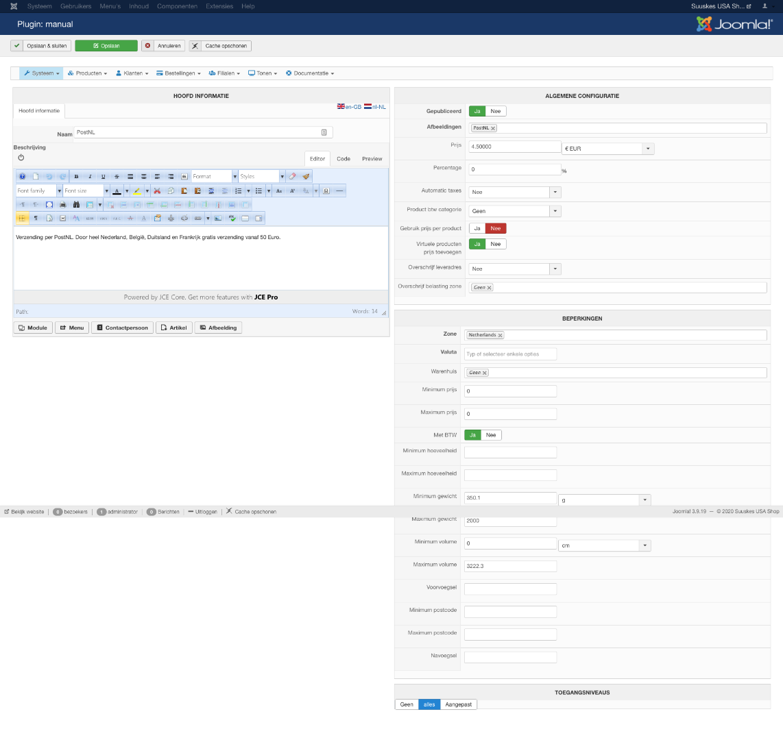

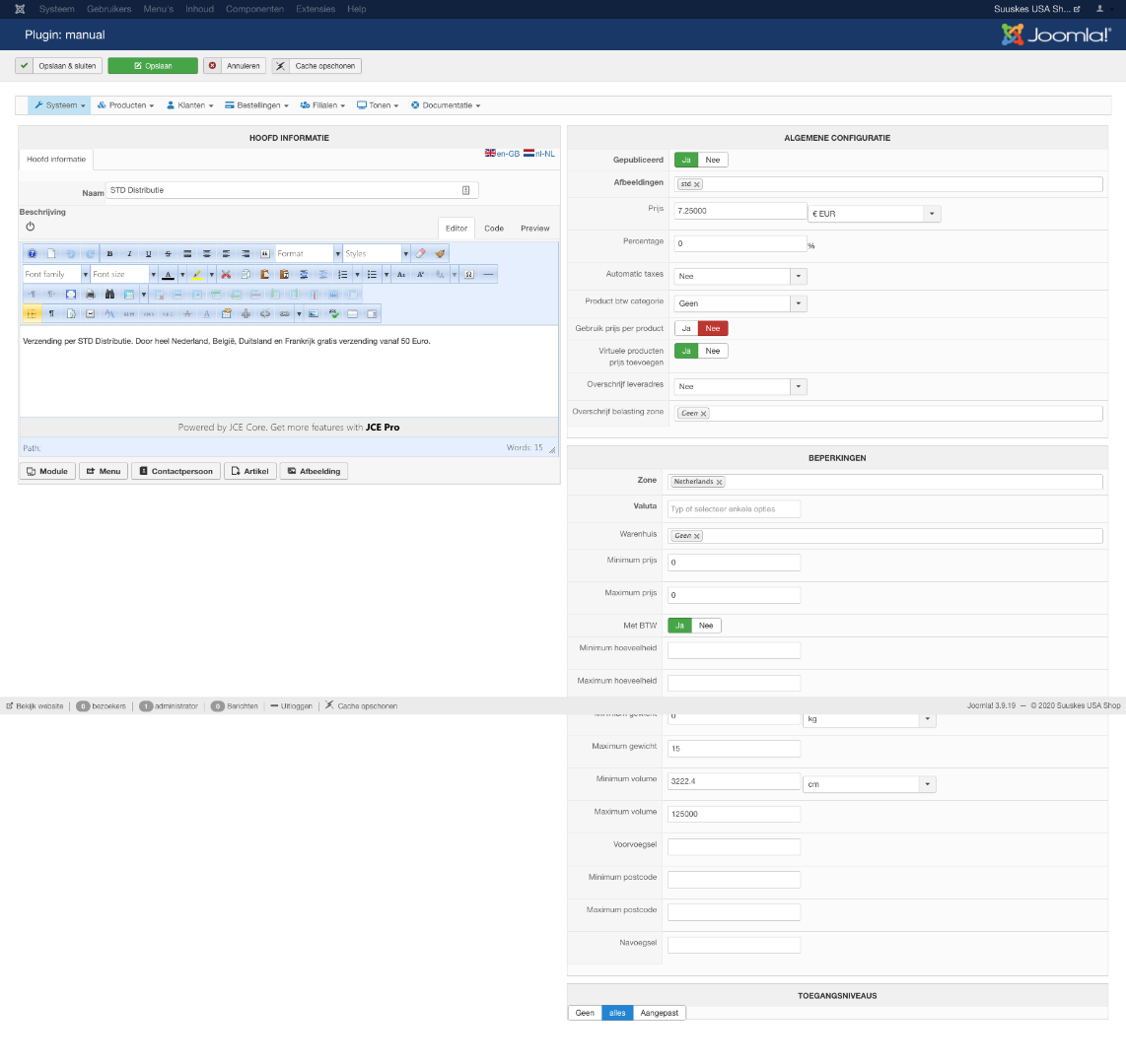

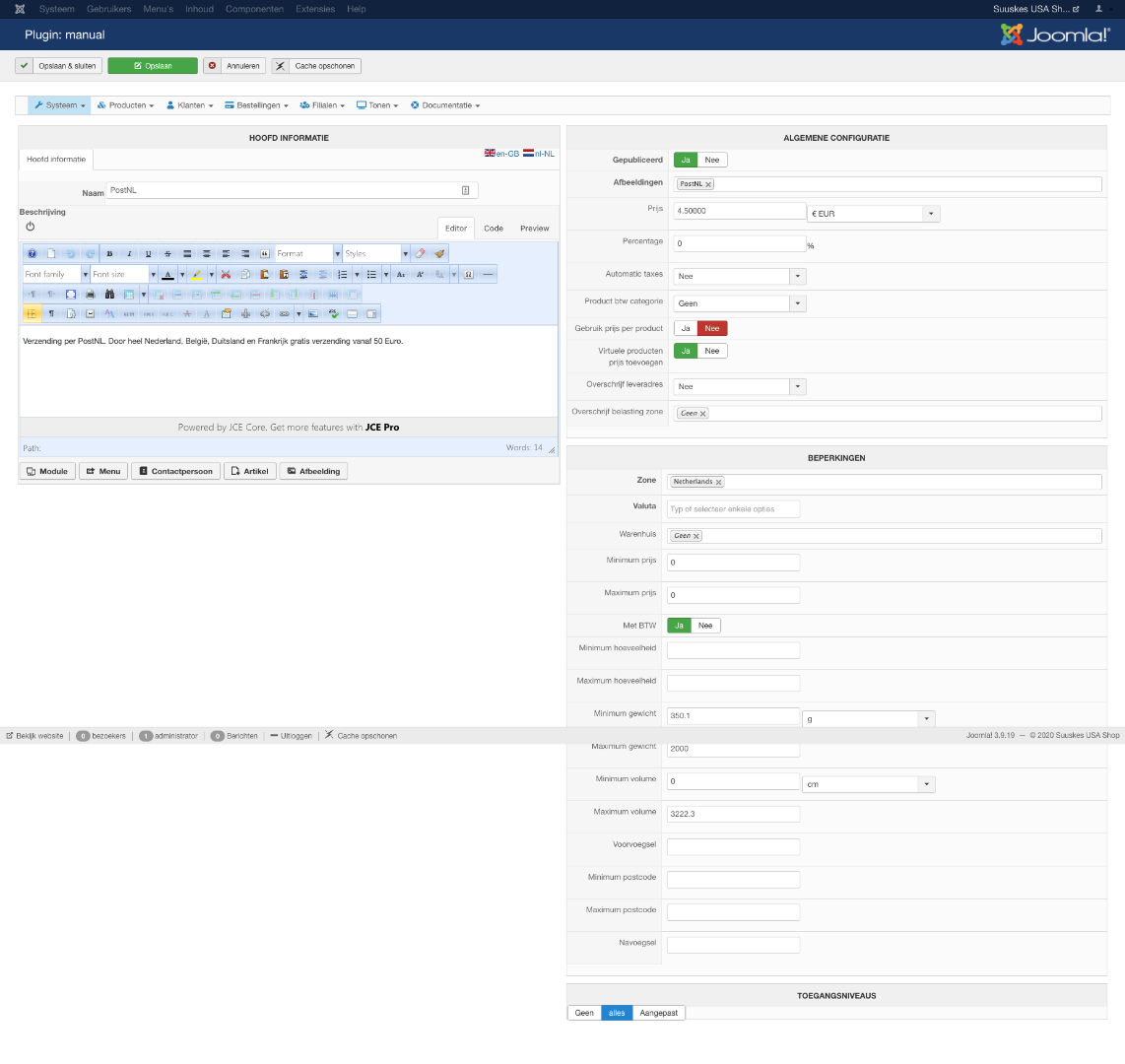

I have 2 shipping methodes on my webshop:
1. PostNL € 4,50
Maximum volume: 3222.3cm
Minimum gewicht: 350.1g
Maximum gewicht: 2000g
Zone: Netherlands
2. STD Distributie € 7,25
Minimum volume: 3222.4cm
Maximum volume: 125000cm
Maximum gewicht: 15kg
Zone: Netherlands

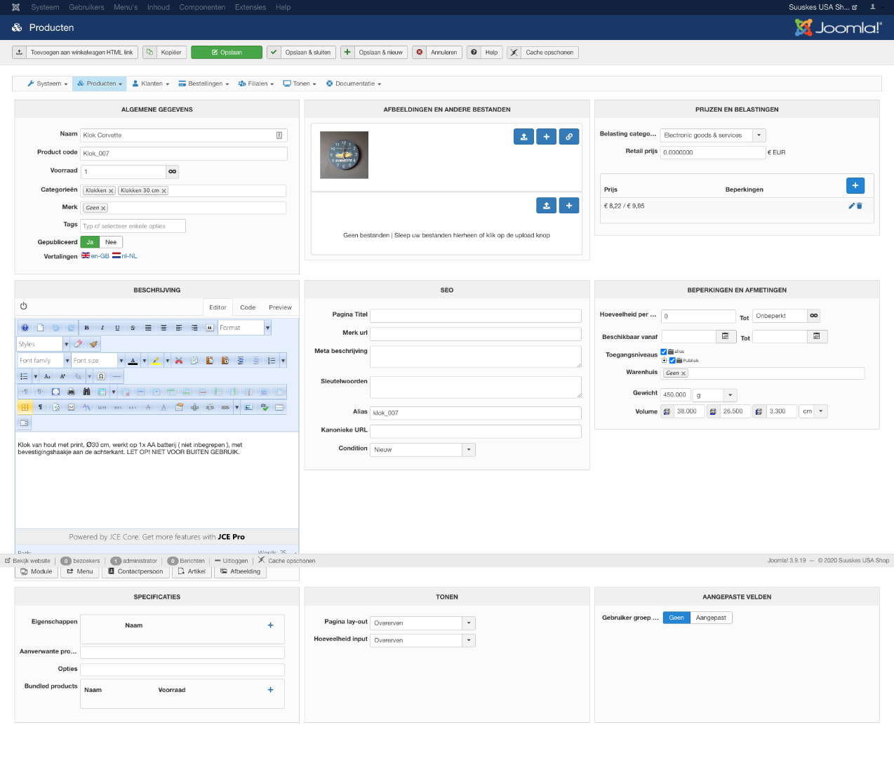

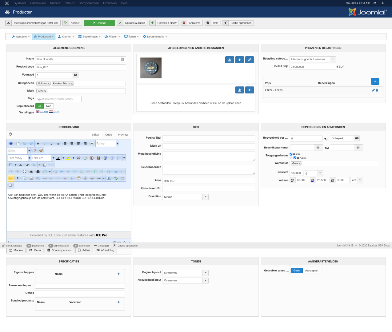

And I have a product: 450 gr and 3323,1 cm volume.
It should get shipping methode 2 because it's volume is to big for shipping methode 1.
But it gets shipping methode 1 and I have no clue why it does that???
I would like to know what is causing this problem.
Thanks for the support!

6 years 2 months ago #321743
Sure, can you show us screenshots of how you configured your products weight / dimension and also your shipping method restrictions ? So that we can understand and reproduce your issue ? Thank you.

  • Posts: 23
6 years 2 months ago #321760
Hello Mohamed,
Here the screenshots you asked for.
Kind regards,
Frits Strijbos

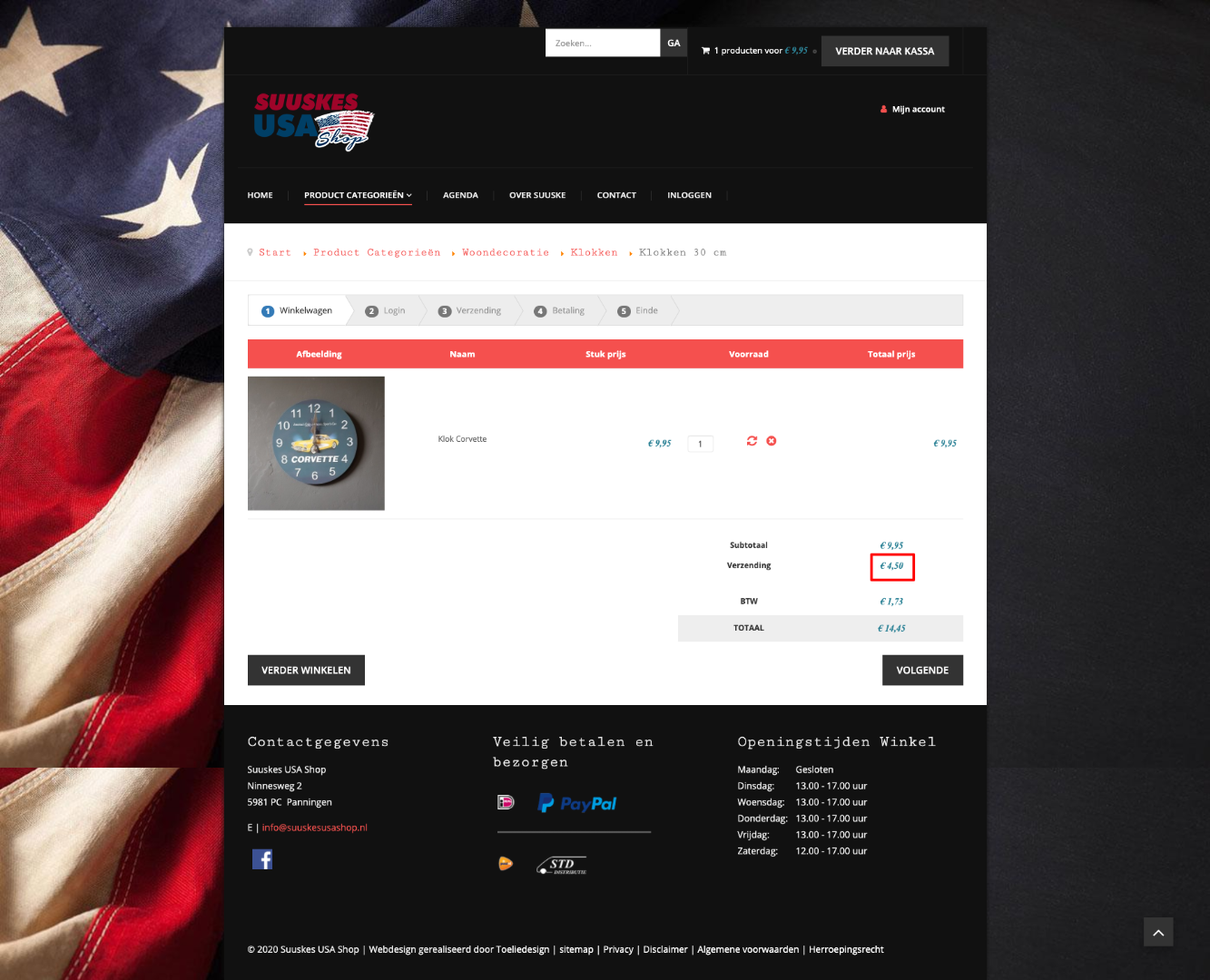

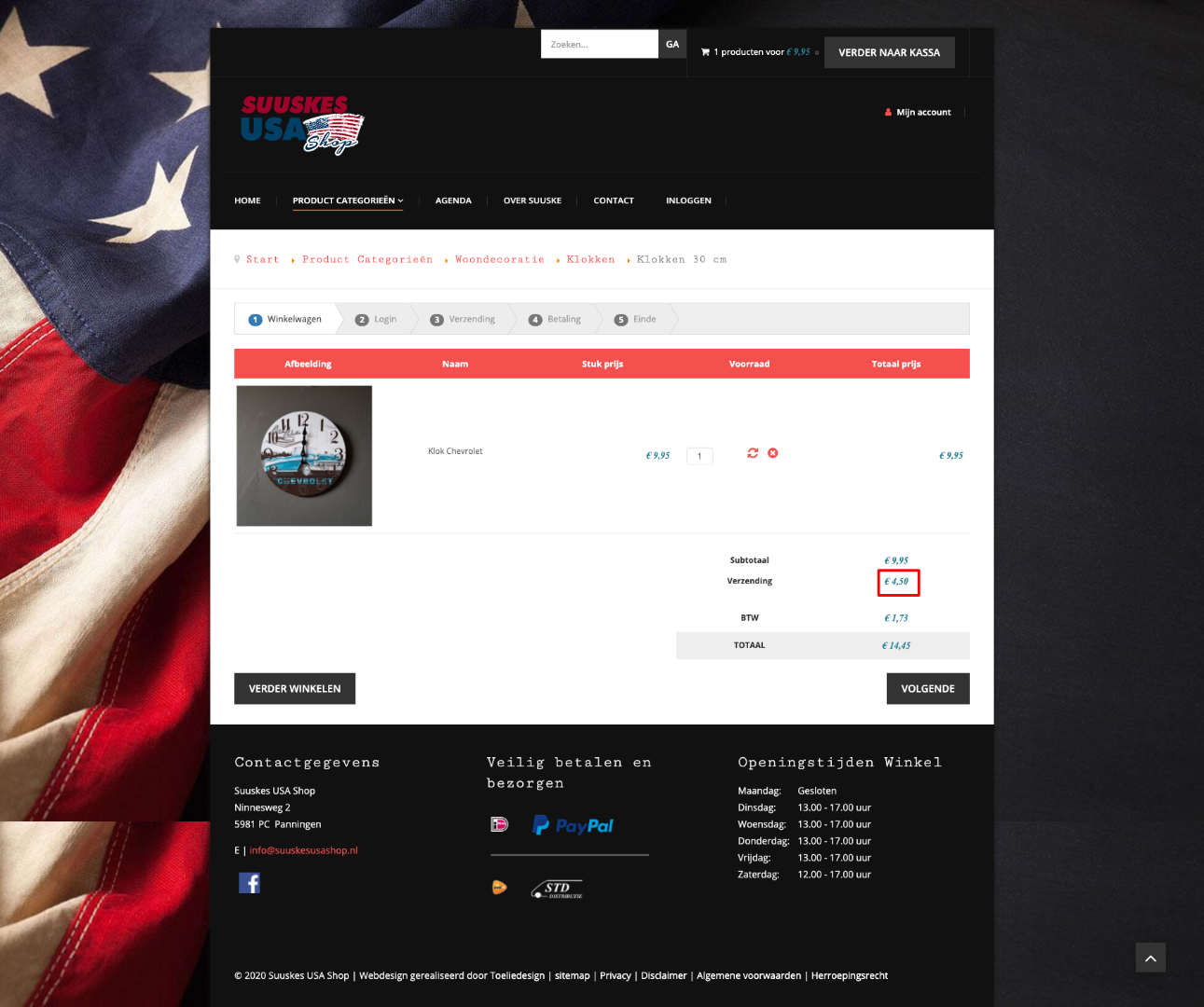

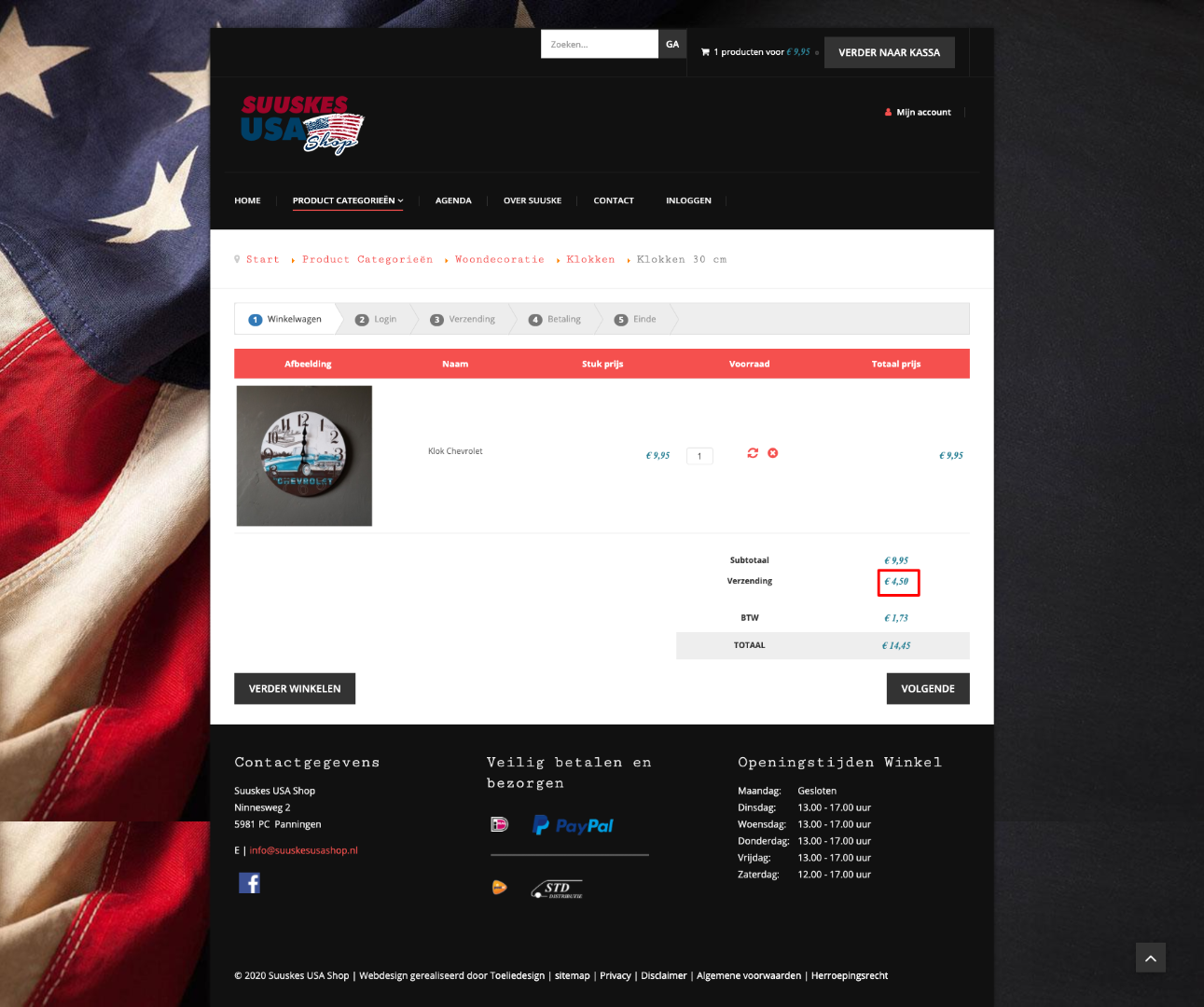

6 years 2 months ago #321794
Hello Mohamed,
I've installed the last Hikashop version.
I'm sorry to say but the fix didn't solve the problem. I'm still getting the wrong shipping methode. I've attached a screenshot from a clock in the basket. It has 4,50 shipping cost instead of 7,25.
Best regards,
Frits Strijbos
