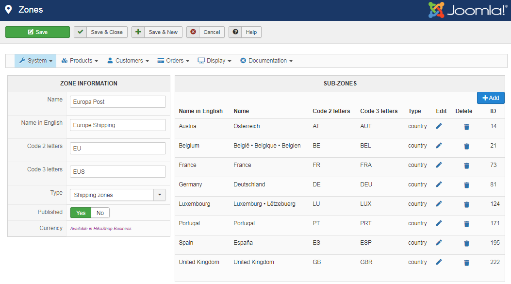

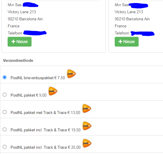

At first I had two batches of shipping setup, one for NL and one for Belgium.

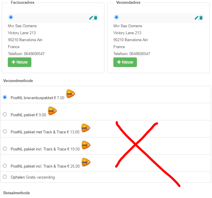

Later on I found out about the shipping zones and I created a zone for Europe including the countries Belgium, France, Spain, Germany and a few others as they cost the same. Ever since doing that, all shipping options for those coded Europe show up instead of just the correct one.
For this particular order, the PostNL brievenbuspakket would have been the only choice.
What's going wrong, worked fine when it only had Belgium

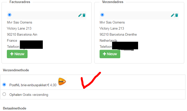

I'll explain what I did.
First, I created some shipping methodes for the NL only and tested them with an NL address. Once I got all the dimensions, weight and all correct, I made a copy and changed Netherlands to Belgium and changed the price accordingly. That worked too. I was happy.

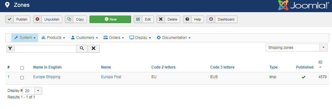

Then I realized that there might be some interest from Germany and Spain as well, but I didn't want to copy them to two more countries and found out about the Shipping zones. So I created a shipping zone called Europe Shipping and included Belgium, Spain, France, Germany and some others in that zone.

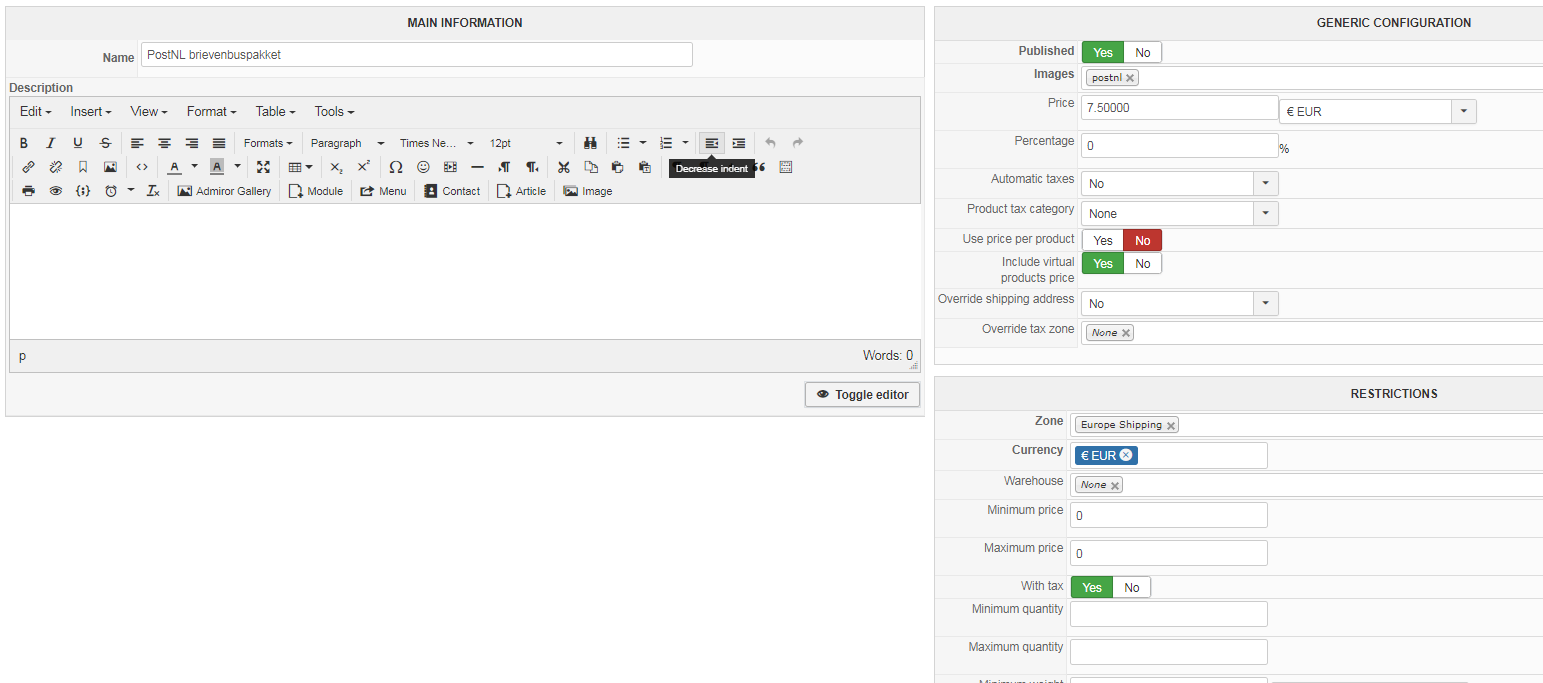

Then I changed the zone restrictions on the Shipment Methode to "Europe Shipping" and then this happened.
Sending to NL is ok:

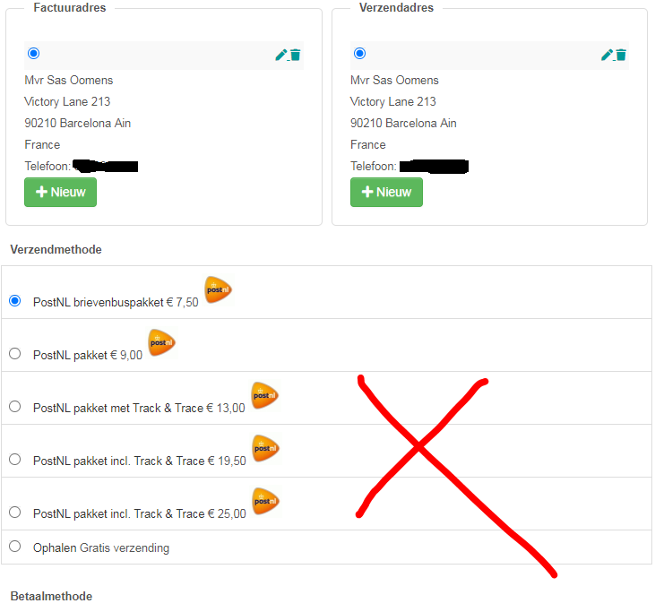

Changed shipping addres to France (same happens for all Countries in zone):

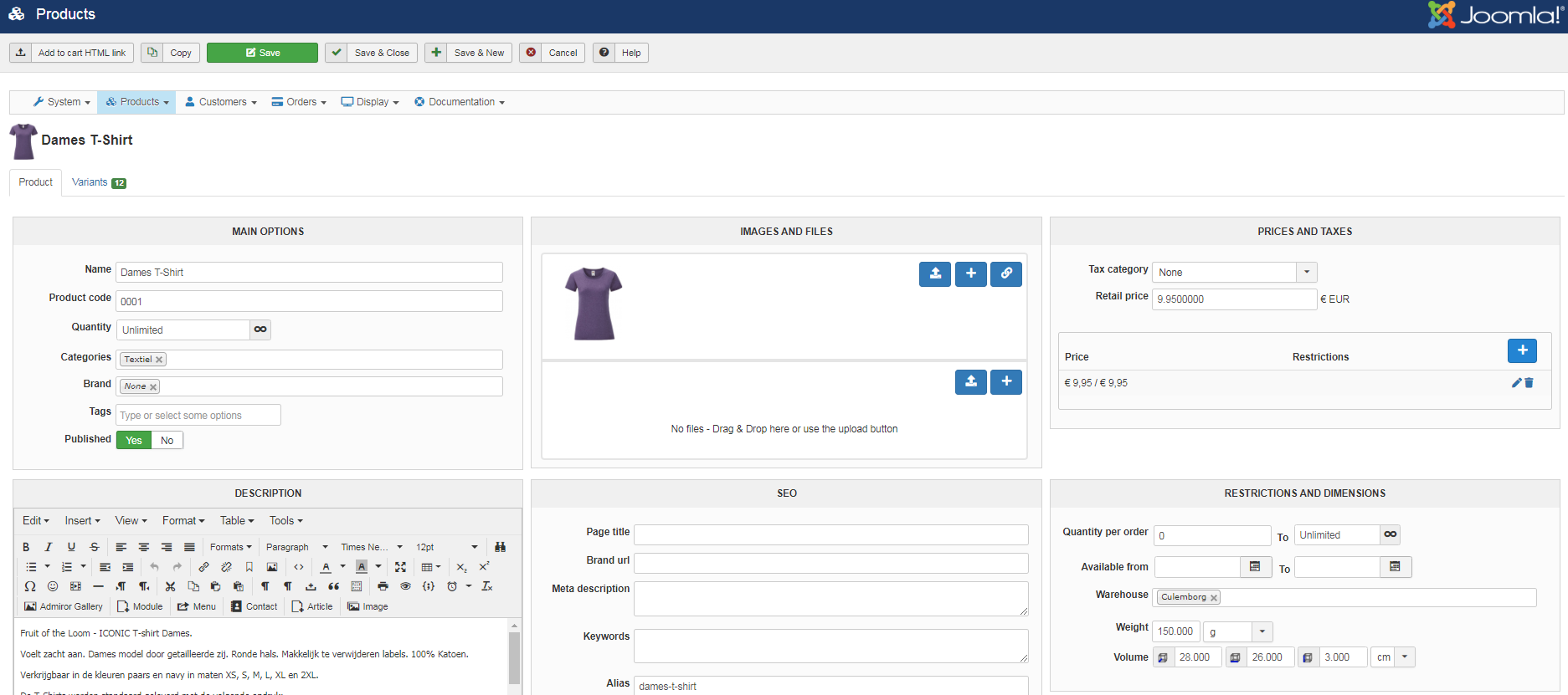

Product setting (one T-Shirt). For NL if I buy 3 of them, it changes shipment.

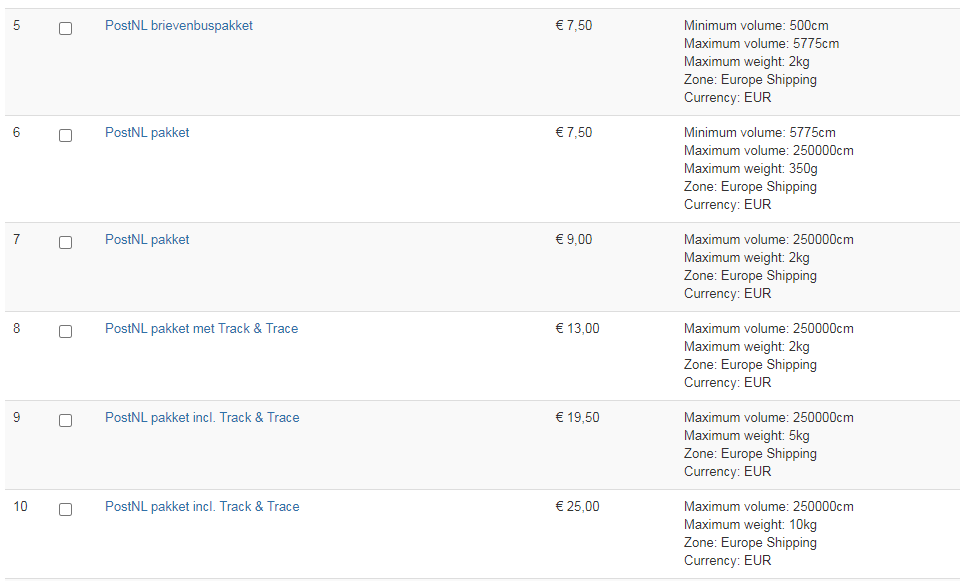

5 years 11 months ago #322425
Oh darn, while closely looking at my screenshots, I notices no minimum volume on the EU Shipping (which is strange as it were copies).
Adding them changed the outcome to the correct outcome.
Sorry to bother you with this :unsure: :unsure:
