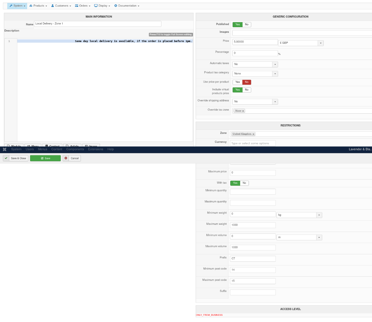

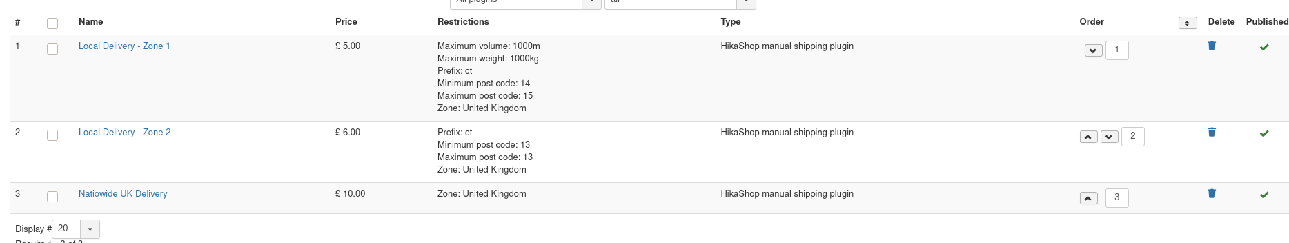

5 years 11 months ago #323273
Hello, please find attached images,
I'm just not sure how UK post codes work with this shipping configuration. Take the format: CT153EF
Is this prefix: CT
Minimum post code="15"
Or
Minimum post code="151"
(I've tried both)
Will it work with UK post codes, as the format has letters at the end? I cannot find any documentation how this works with UK post codes. Do yo have any examples?
I have given my products weight and given the shipping methods a min and max weight limit - as the general documentation suggested.
Hoping you have some suggestions, thanks
Marcus

5 years 11 months ago #323297
With a minimum post code of 15 or 151 it shouldt work as CT153EF 153 > 151 >15.
Can you show us how you configured your shipping address during checkout and the product dimensions and weight that were on your cart ? So that we can reproduce it on our end thank you.
