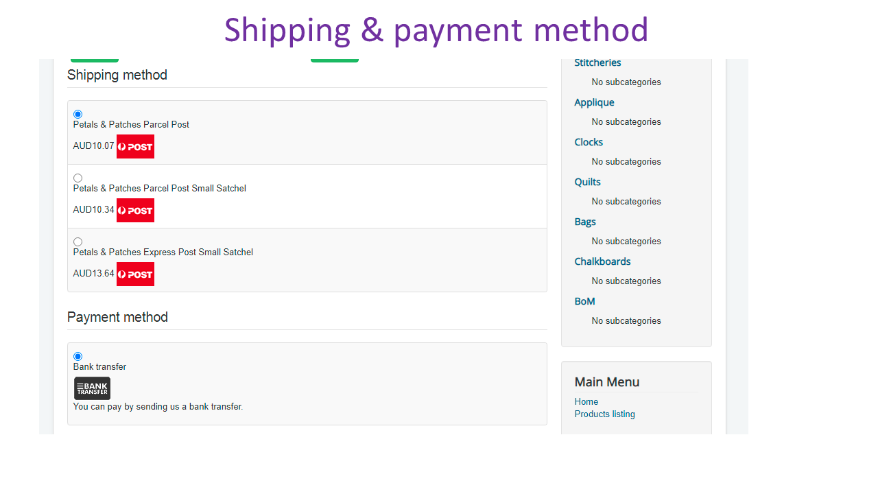

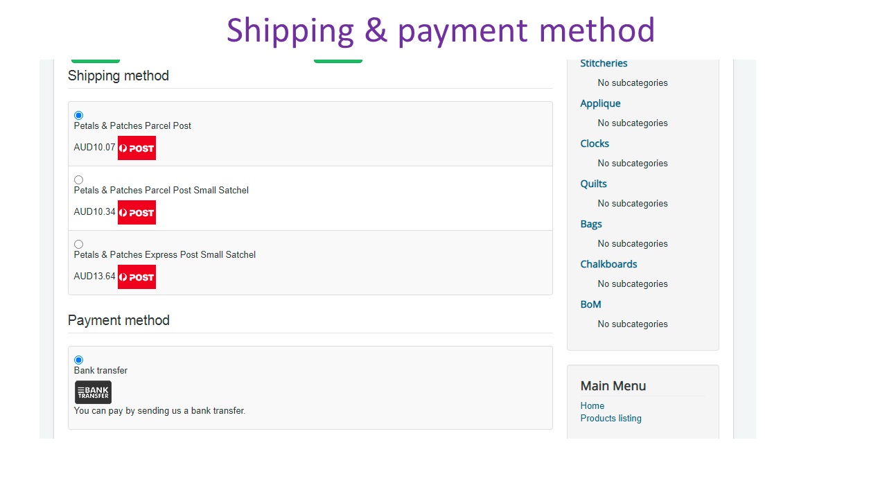

When I leave the default Aust Post shipping method I can see the payment method (bank transfer).

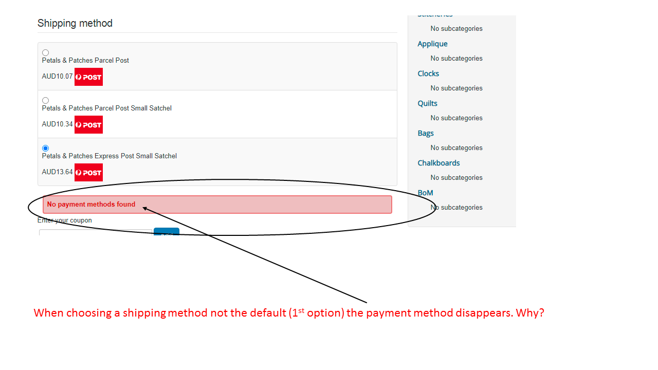

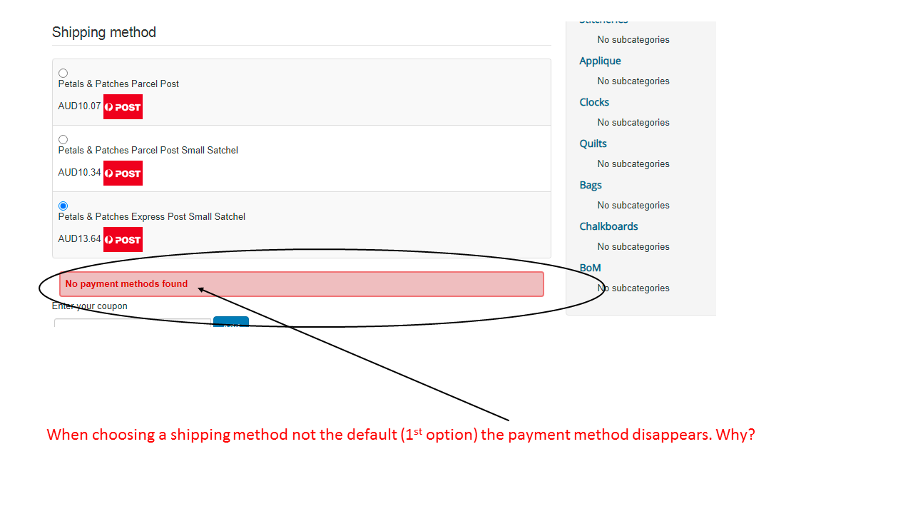

However if I choose another Aust. post shipping method I lose the payment method and get an error message No payment methods found".
This is most curious.

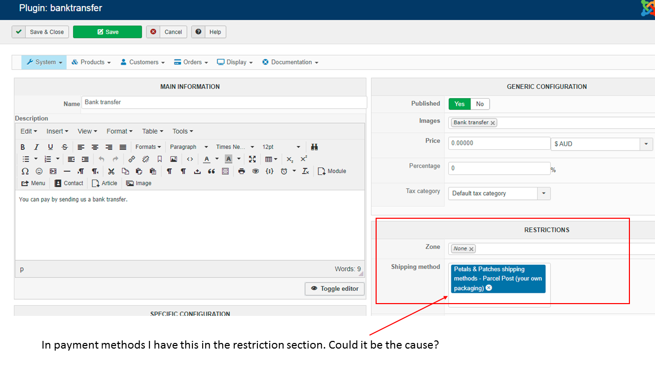

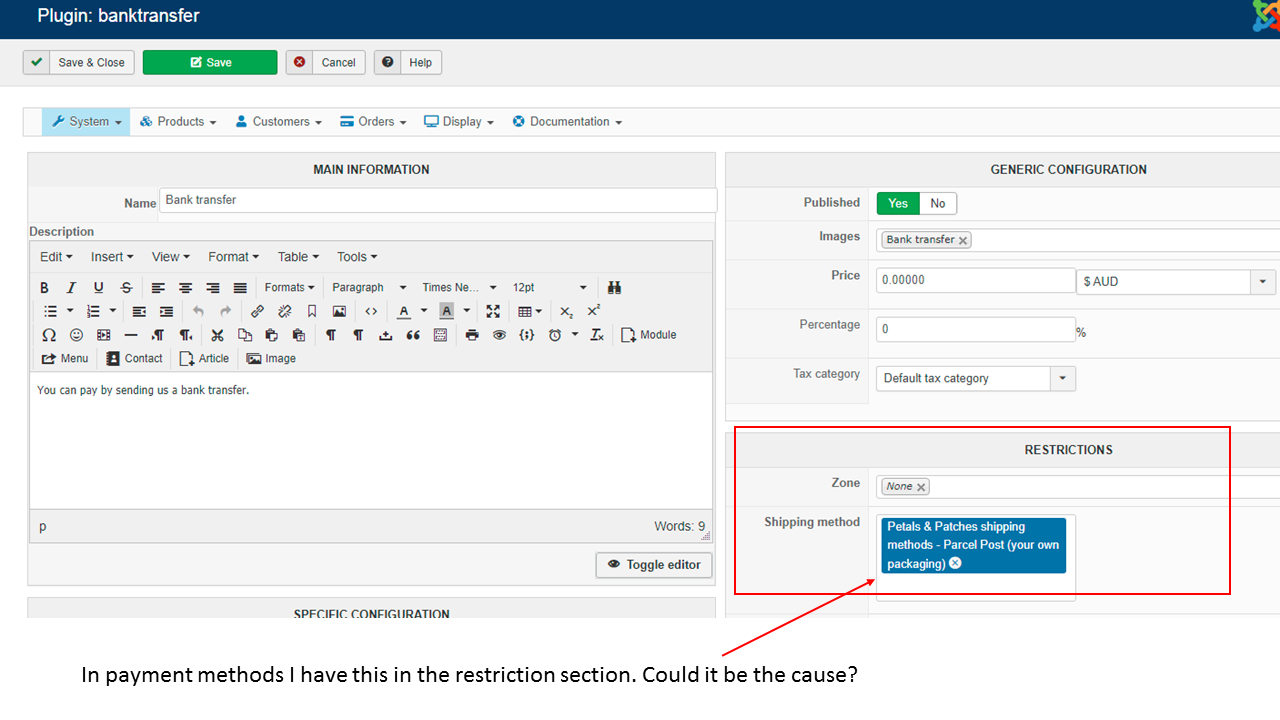

I do have some text in the restrictions section of my payment within Hika Shop. See attachment.
I do not remember added that text but must have at some time.

5 years 4 months ago #332245
Your issue is coming from the fact that you have restricted your payment method for the "Petals & Patches shipping methods - Parce Post (your own packaging)" shipping method.
If you want your payment method to be used regardless of the shipping methods selected during the checkout workflow, you should unset that option through your payment configuration page.
