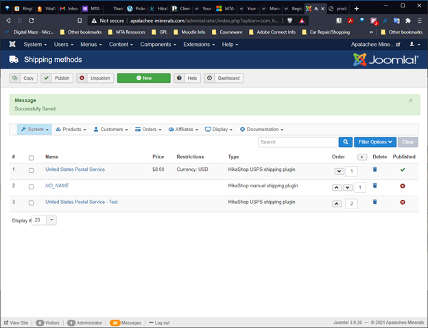

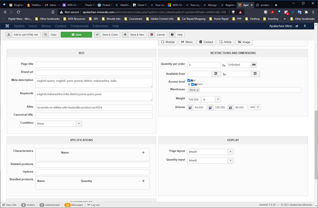

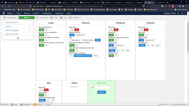

As per your response, here is additional information. I'm attaching screen shots for each.
First image: our only published shipping method uses the USPS plugin.
Second Image: product dimensions are in millimeters(mm), the weight is in grams (g). Screen shot of a product is attached.

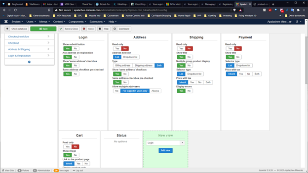

Third image: this is our checkout flow, showing the shipping selection.

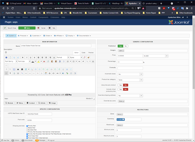

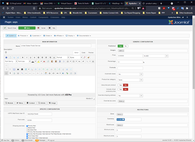

5 years 3 months ago #333094
Here is a screenshot of our settings in the USPS shipping plugin. We use USD exclusively for products and for shipping.

I only see the error message "no shipping method found" before I enter my shipping address, and that's normal since the USPS plugin needs the shipping address to calculate the shipping fee and you don't have any other shipping methods enabled.
Until last week, I would have recommended you to configure your checkout workflow in the HikaShop configuration as a two step checkout so that the shipping view is only visible after the address has been entered.
However, with the current version of HikaShop (you can update to the 4.4.3 by manually downloading it on our website and installing it on yours), you have an extra setting in the "shipping" view of the checkout workflow allowing you to turn off the display of error messages from that view so that it won't display that error message before the address is entered.
  • Posts: 13
5 years 3 months ago #333321
This fixed it! I also took an extra step of separating the shipping to another view. I genuinely appreciate all of the assistance you have given.
