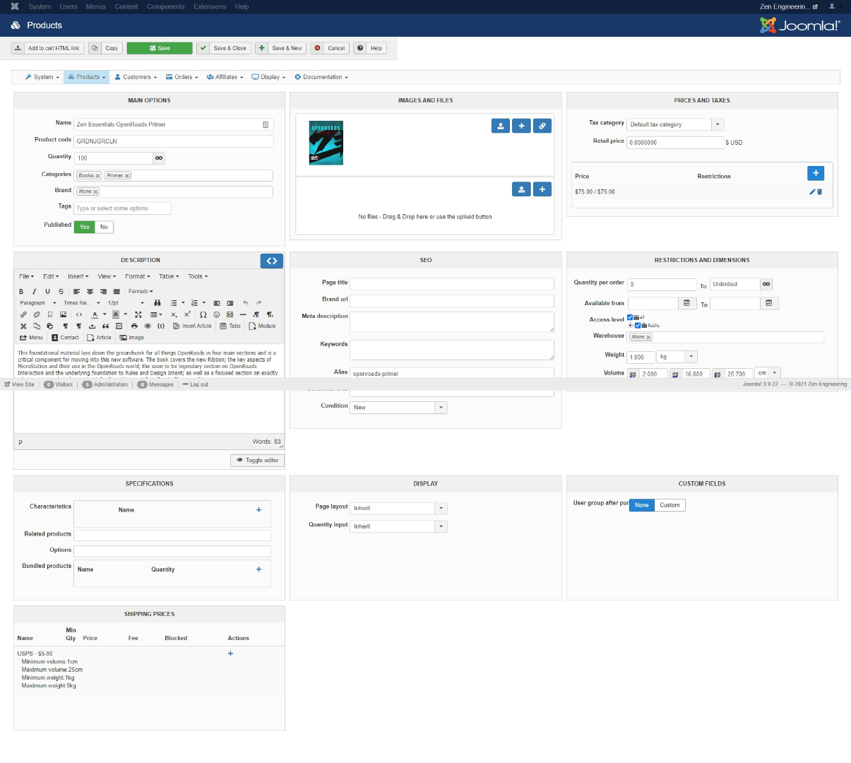

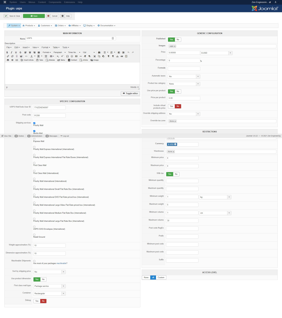

I'm trying to use USPS for the shipping method but it is not working. I added the USPS webtools user id and added other required fields but it is not working. Here is the product and shipping
Attachment not found
method configuration.

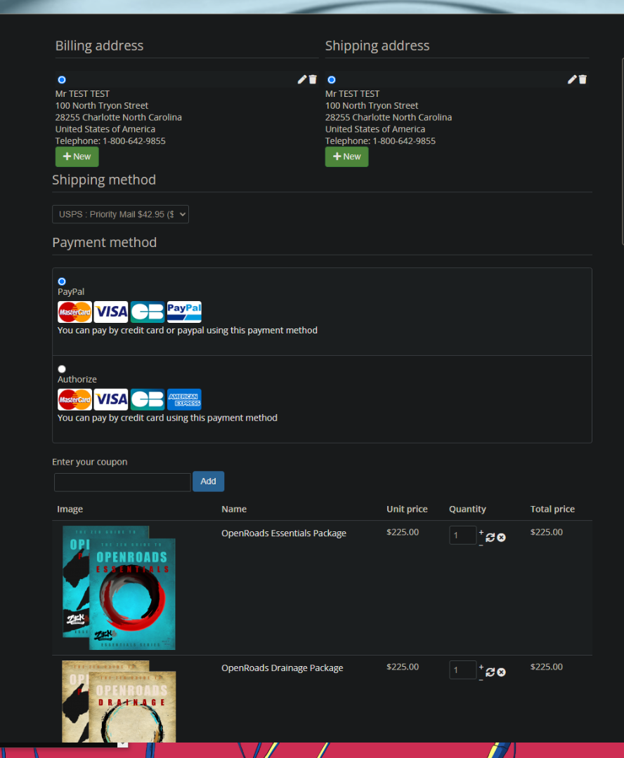

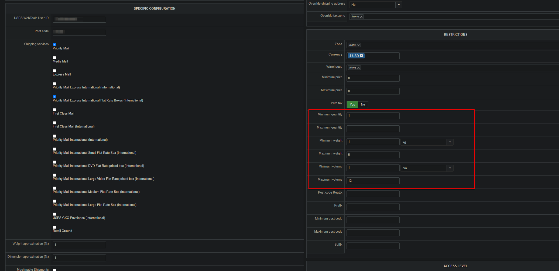

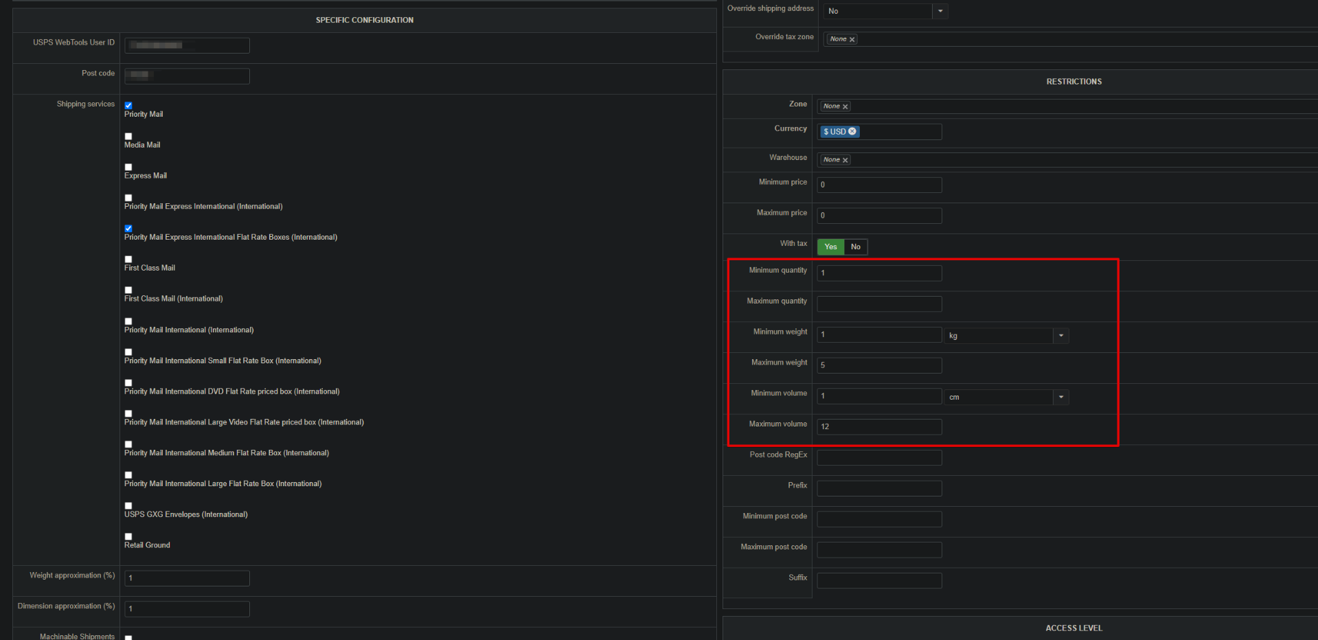

4 years 10 months ago #336593
Your issue were coming from restrictions on your USPS shipping methods which were preventing it from being used (cf. attached screenshots).
We removed your USPS shipping method restrictions, and it seems to be working fine now.
Kind regards,
Mohamed.

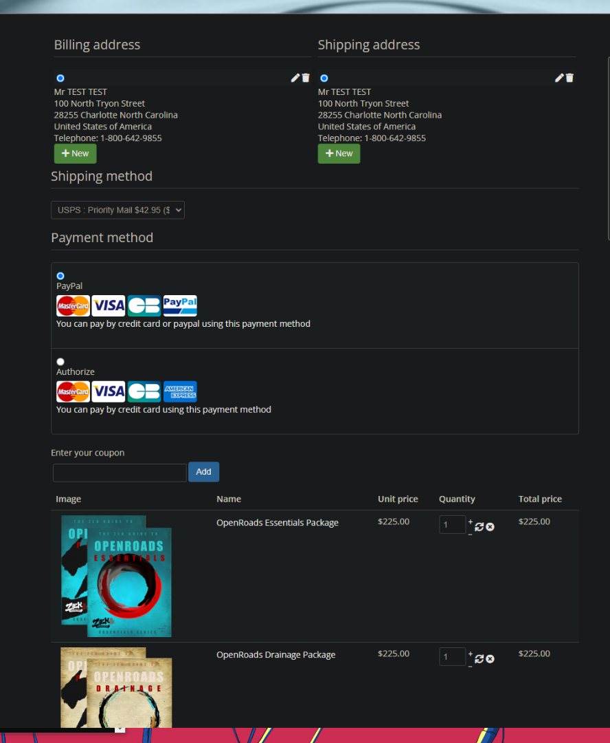

4 years 10 months ago #336715
Thanks support, it is working now.
