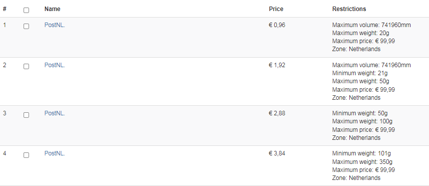

Screendump below is my shipping setup.
One sticker/decal is about 3 grams which would result in € 0,96 shipping cost.
How ever, because of the envelope the weight will be 70 grams (which I put on the product) and that results in € 2,88 shipping cost.
Now if someone wants to order 2 stickers, the weight will become 2*70 gr = 140 gr and € 3,84 in shipping.
I can however fit 10 stickers in one envelope easy and shipping would be €2,88.
Using dimensions will not help as all 5 shipping methodes are for the same dimensions.
Hope this clarifies better.

If you are using Manual shipping methods then the solution will be simple, you can either consider that a sticker will wait 3gr and adapt your minimum / maximum weight option through your shipping method configuration page, or consider that a sticker will wait 70gr.
Then, you'll just have to calculate how many stickers can be sent using every shipping methods and properly define their minimum / maximum weight.
I think it would be the best solution as their is actually no option to tell that a product will weight 73g for the first product and 76g for 2 products.
