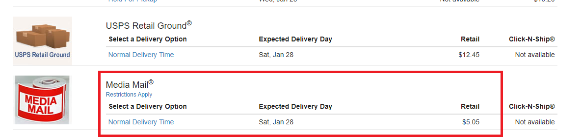

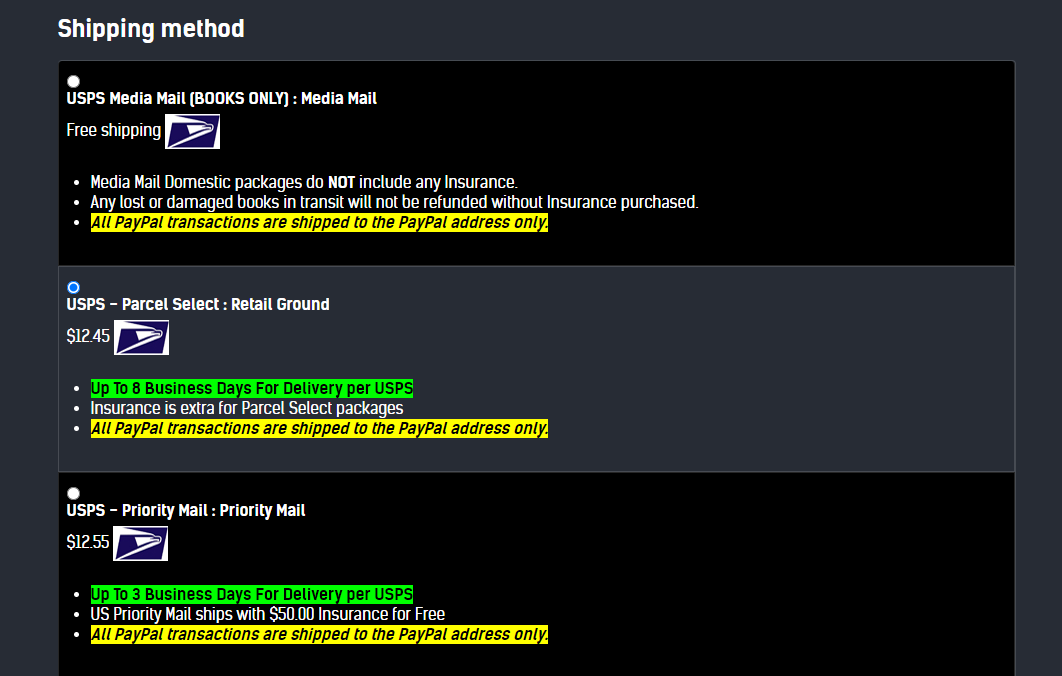

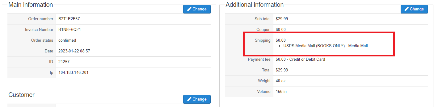

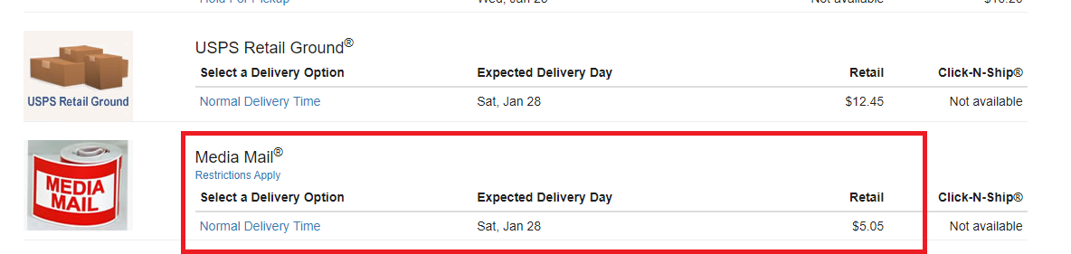

For years, my Media Mail option has been working just fine...this morning however, suddenly Media Mail comes up as Free Shipping, so now I just lost all profit on an item and it's costing me to ship this piece. I have not changed anything in Hikashop at all for about 2 months now
Can anyone tell me why this may be happening? I just logged into my test site, tested several other books, and all are coming up as Free Shipping when using Media Mail...so something has definitely happened.
I double checked with the US Postal Service, and they still show Media Mail as being active, even though there has been many price changes that went into effect as of today, January 23rd 2023.
Images attached are of the order in the backend, then on the site as a customer, and then from USPS for the actual charge it should have been.

This means that the USPS API provided a Media service without a "Rate" value.
It could be a bug in the USPS API following the changes they made.
To prevent that, what you can do is to add the code:
if(isset($rates[$mode]) && $rates[$mode]->shipping_price < 0.01) unset($rates[$mode]);
after the line:
$this->addRate($rates, $mode, $parcels, $rate, $currency, false);
(2 places) in the file plugins/hikashopshipping/usps/usps.php
It will prevent displaying any free shipping USPS shipping method on the checkout.

Thanks. So looking into it, I found that USPS indeed send the "Rate" with a 0 value. However, It also sends a "CommercialRate" with the shipping fee. I looked online for more information about this, and it seems that merchants can negotiate with USPS to get lower fees which are labeled as "Commercial Rates" and that's apparently what this is.
The USPS plugin so far was only taking into account the "Rate" value. So, I've made a patch to be able to use the rate based on what USPS provides and it seems to be working fine on your website.
I suppose you must have recently talked to USPS to lower your shipping fees and that's why you got that issue as the plugin never supported this, and it's kind of strange to send 0 for the Rate when there is a commercial rate instead of just providing the smaller fee directly in the same variable of the API.
Anyways, the patch is included on our end. So you can download the install package of the latest version of HikaShop on our website and install it on yours to get it for your live website.
