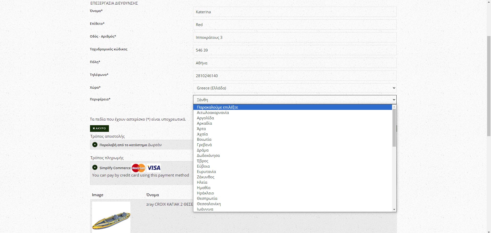

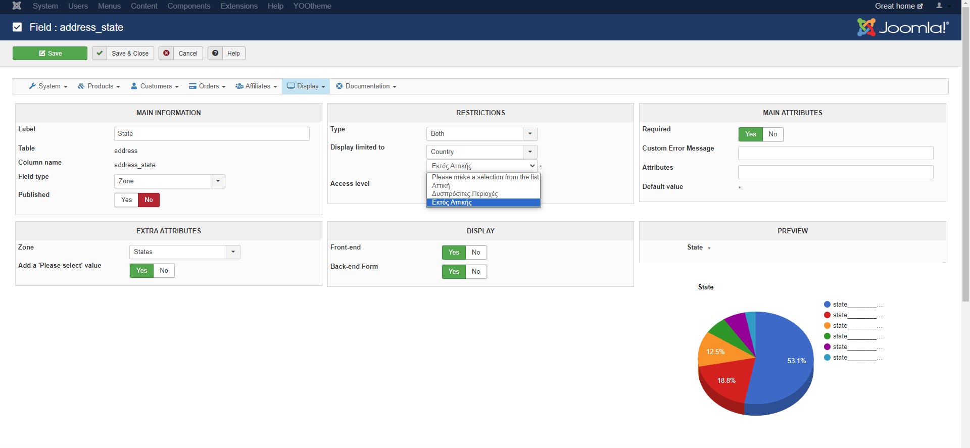

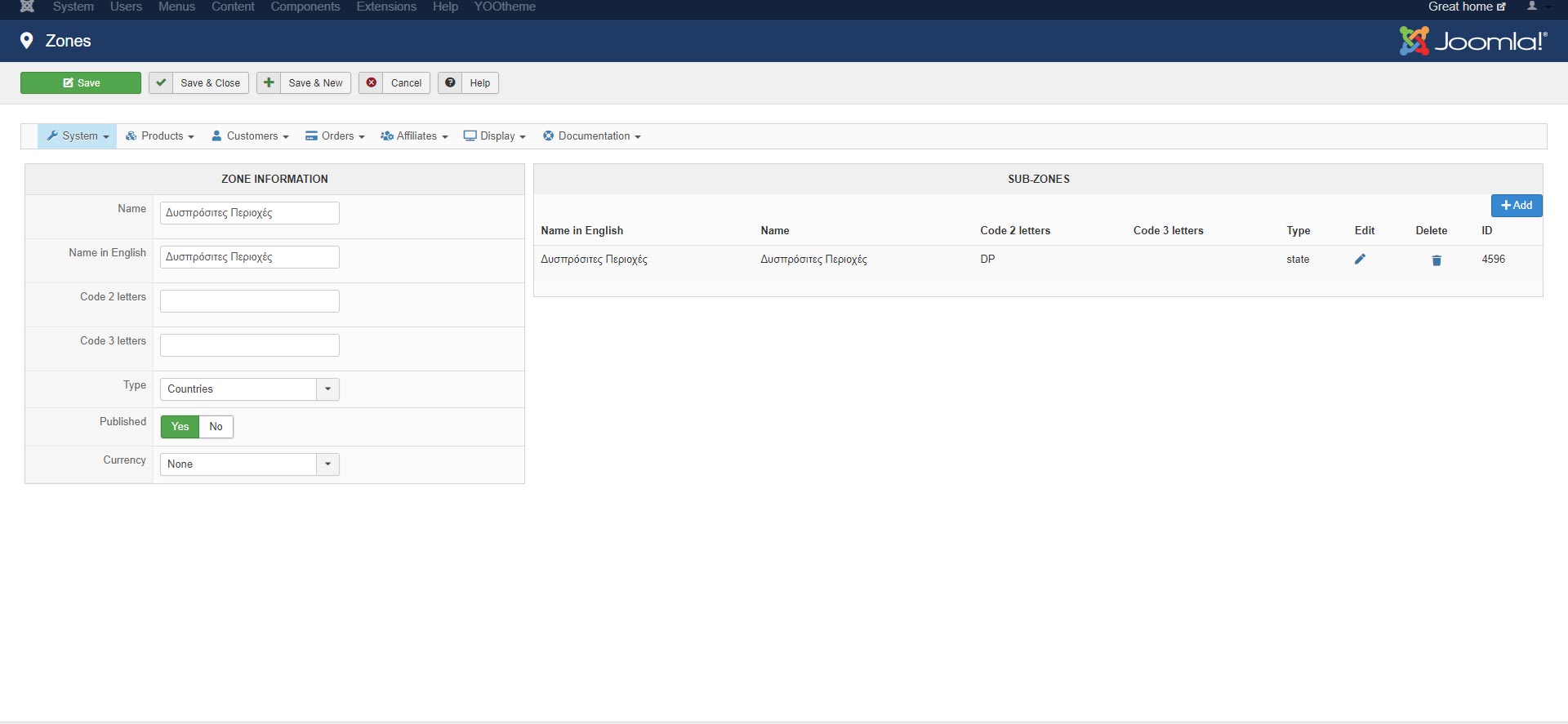

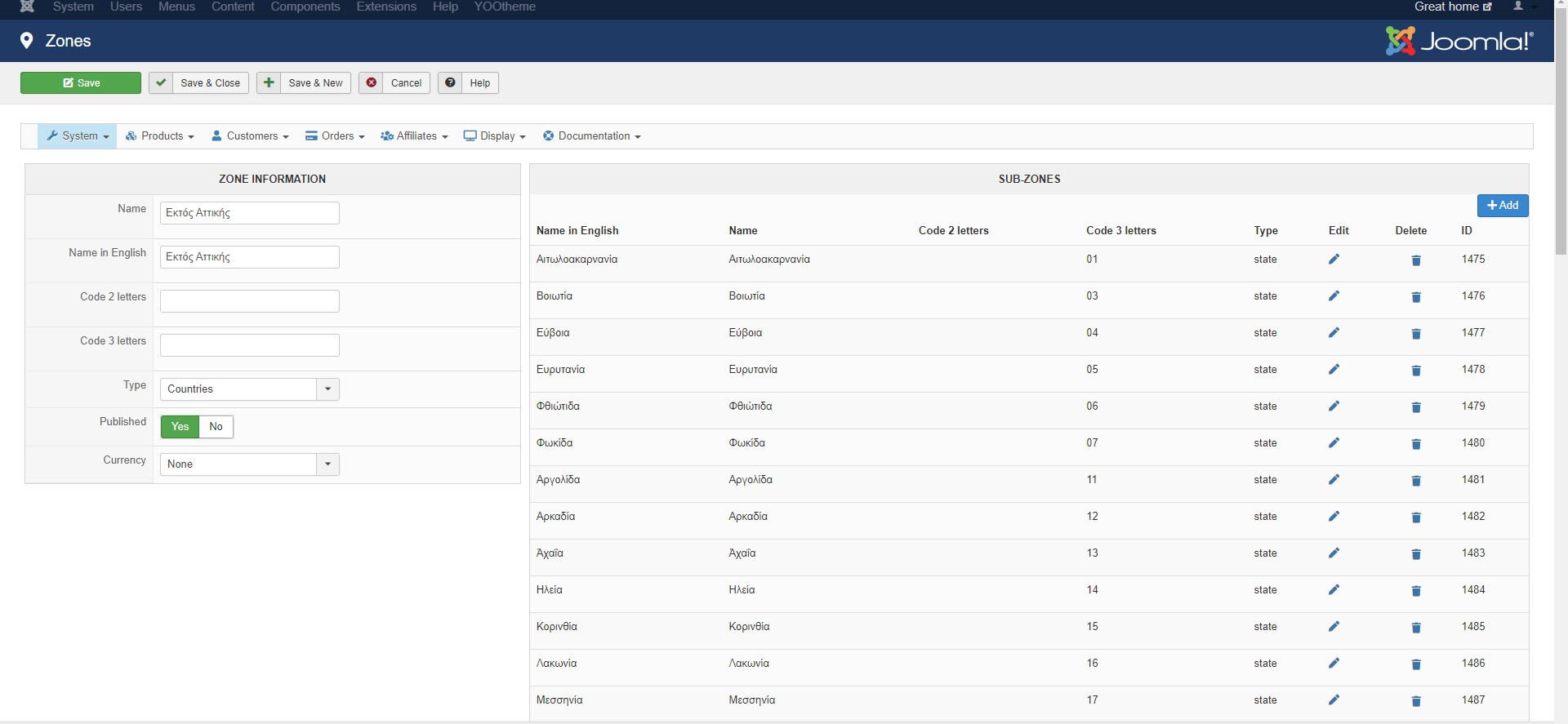

Hello!

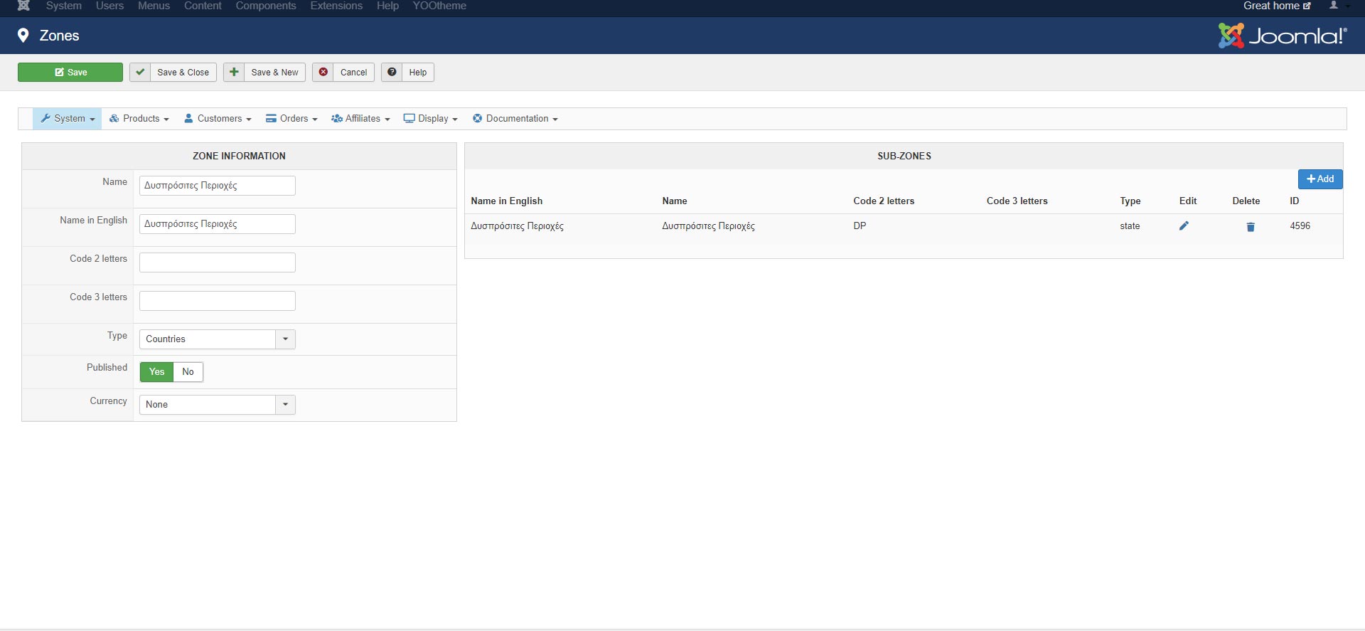

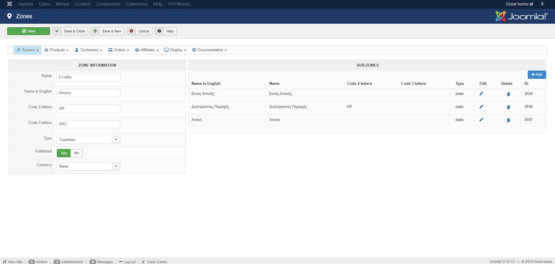

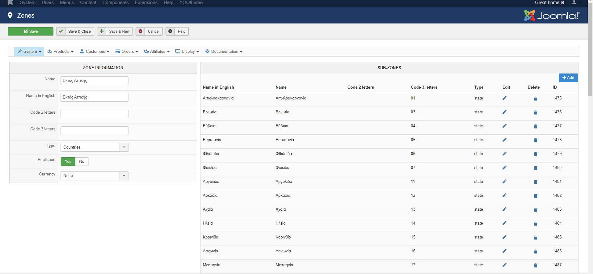

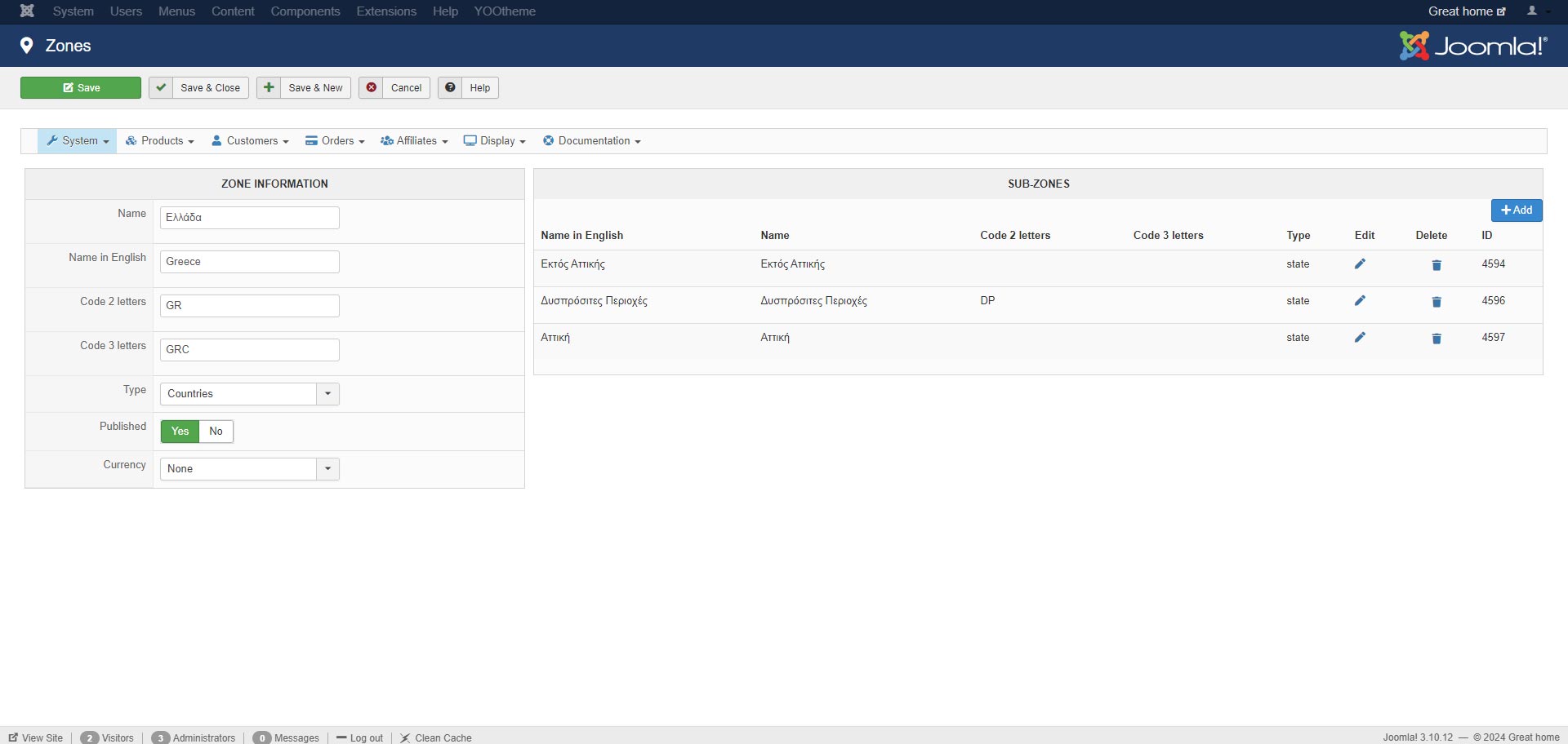

I created 3 country zones cause i need to devide Greece in 3 shipping zones.
So 1st is Attiki, 2nd is Islands and 3rd is all Other cities.

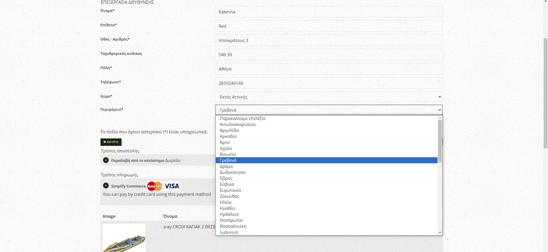

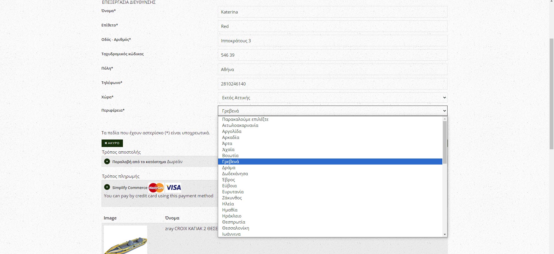

What i want to do is to be able to select first the "country" Islands and then another dropdown that is "Display limited to" country will appear and there will be the list with all the islands. This dropdown applies only for islands. Basically the other countries have only one state.
For all these zones i will have different shipping cost per kilo. For example, if the customer selects Islands and then Crete, they will see the Crete shipping cost.
So i created the countries, the states and the custom fields for that but if i select Attiki for example i still see the shipping cost of the Islands.
How can i fix that?
Thank you

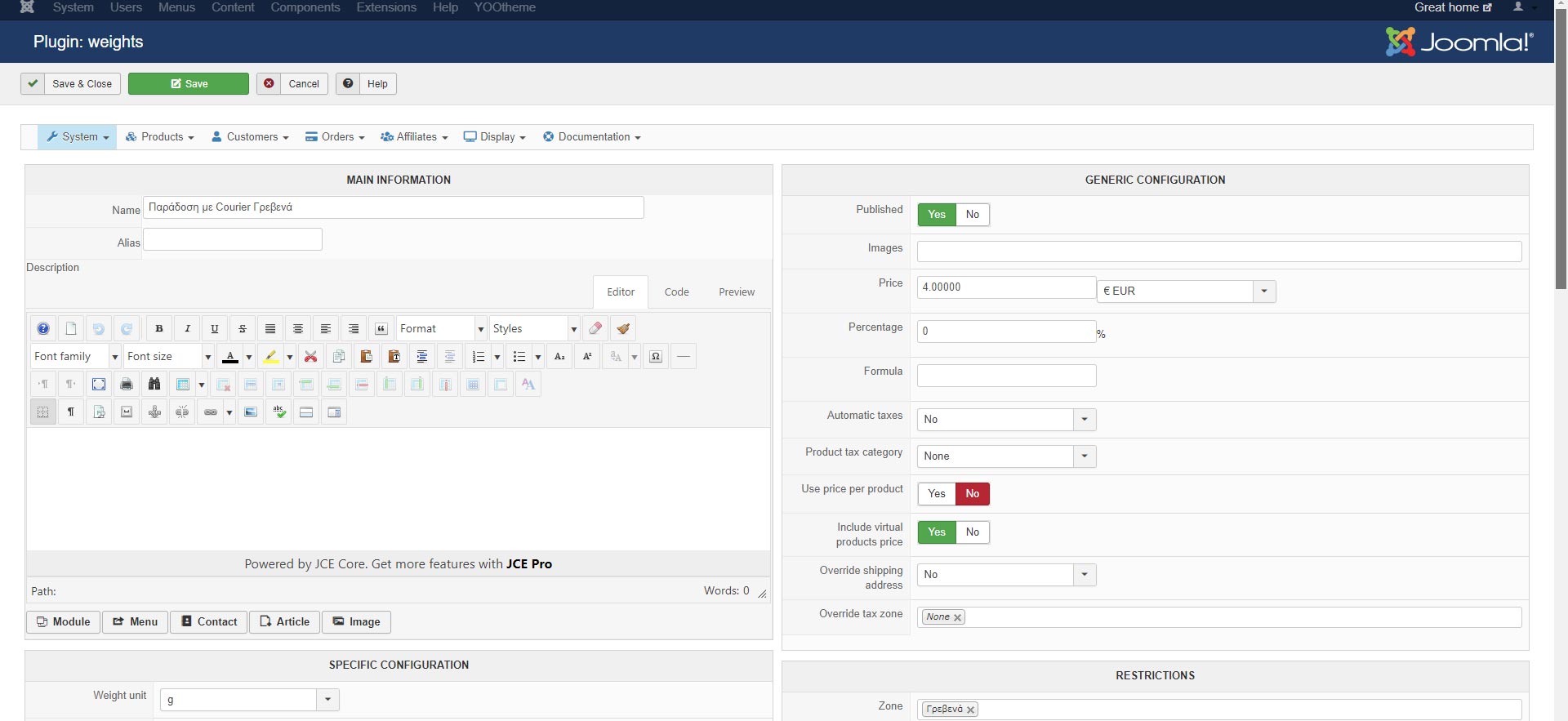

Also, if the switch of shipping method doesn't work, then the problem would be with the shipping methods. You didn't provide screenshots of their settings though so I can't check what you did there.

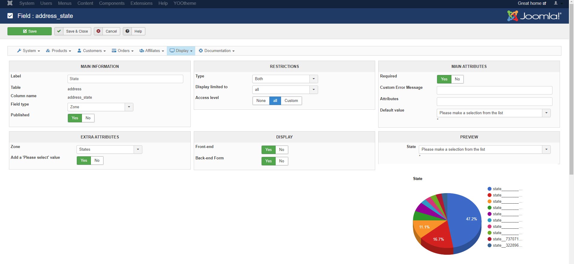

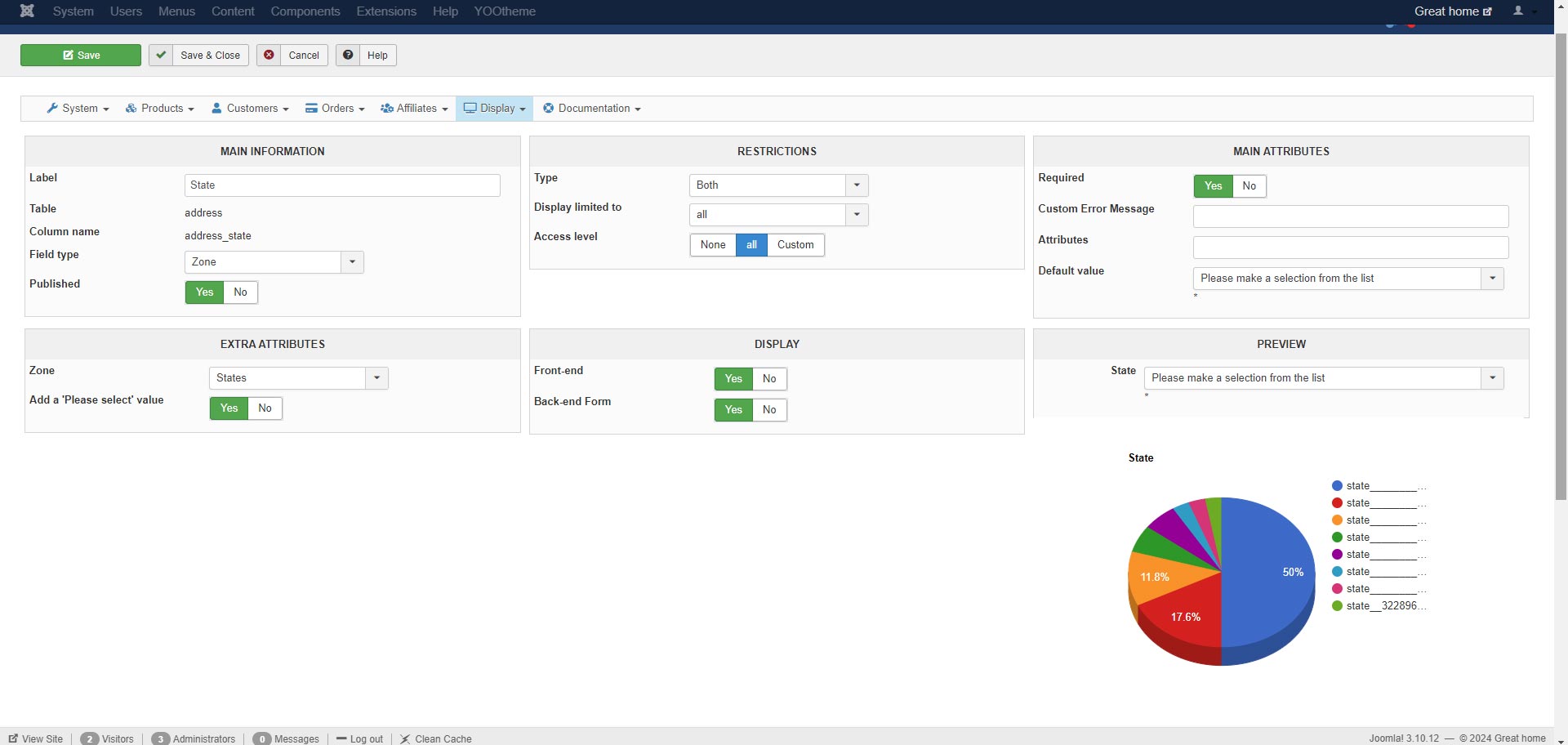

2 years 6 months ago #359123

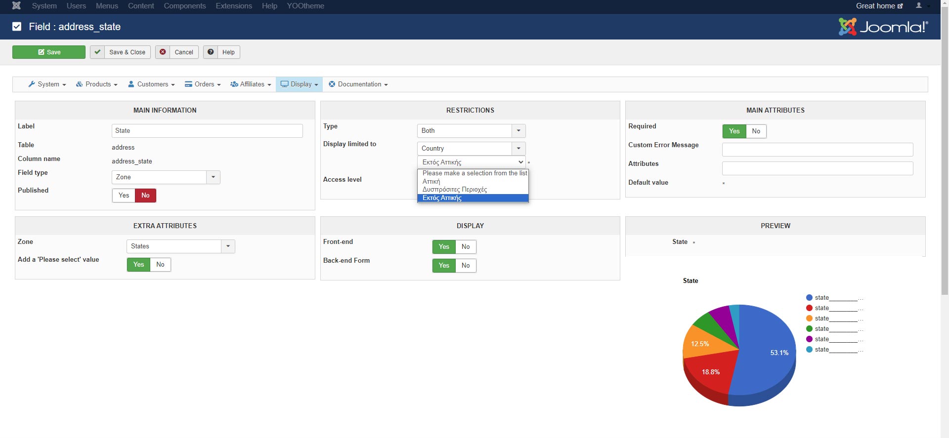

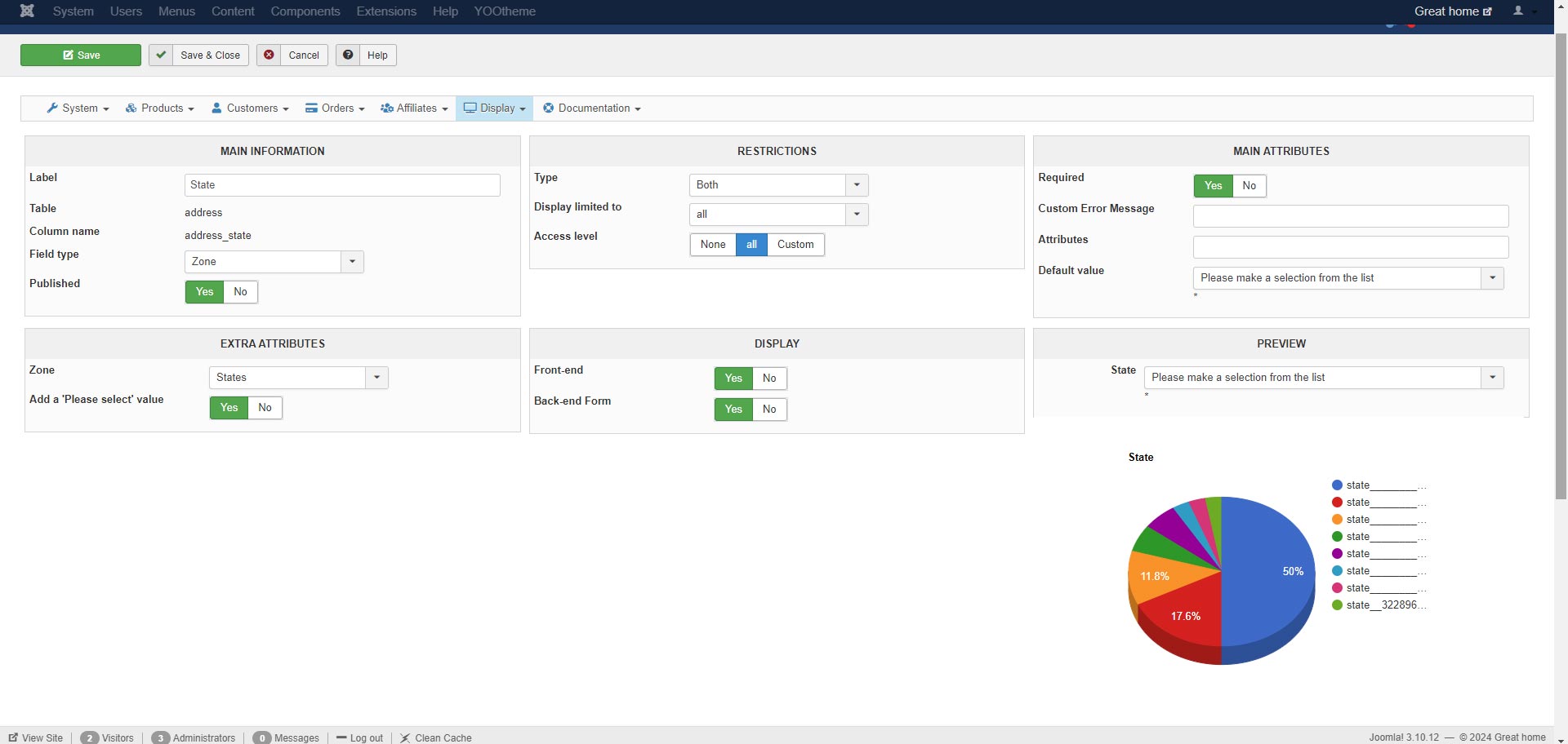

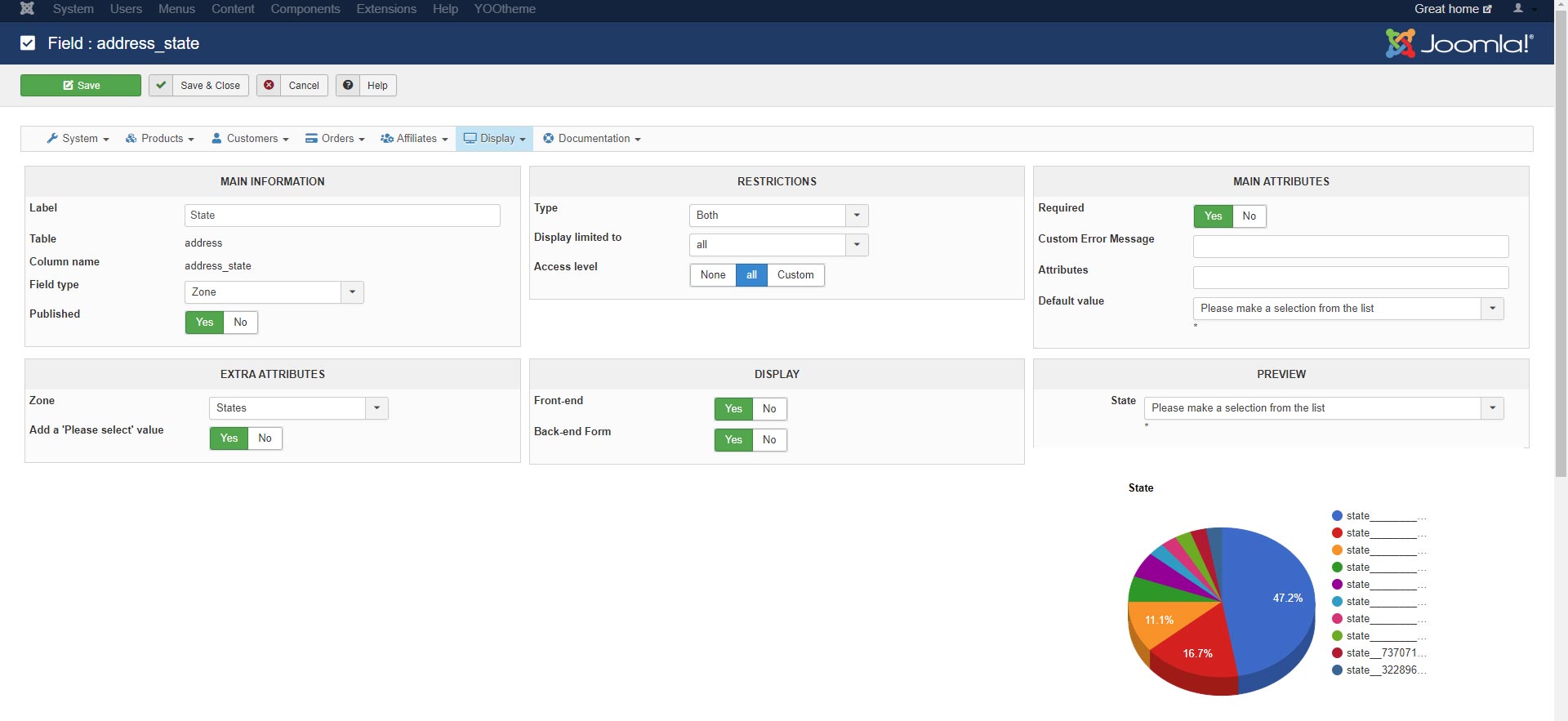

I think there is a problem with the way you set this all up.
If I look at the data of the shipping address of the user account you provided, I can see that the address_state is set to Έβρος even though the country is set to Αττική
That's because since you restrict the display of the address_state to only the Εκτός Αττικής country zone, when you select another country zone, the state field is hidden, and its value is not taken into account to update the address, and thus the old value is still in the database, even though you don't see it. And when the shipping methods system selects the shipping methods, the address_state takes priority over the address_country.
I think you need to remove the "display limited to" in the address_state field so that it is always displayed. That way, it will refresh based on the selected country, and it will overwrite the address_state in the database each time you save an address.
It will prevent this situation where the shipping method selection system thinks the address if for another zone than what you can see.
I've made the change for you and it seems to be working fine now.

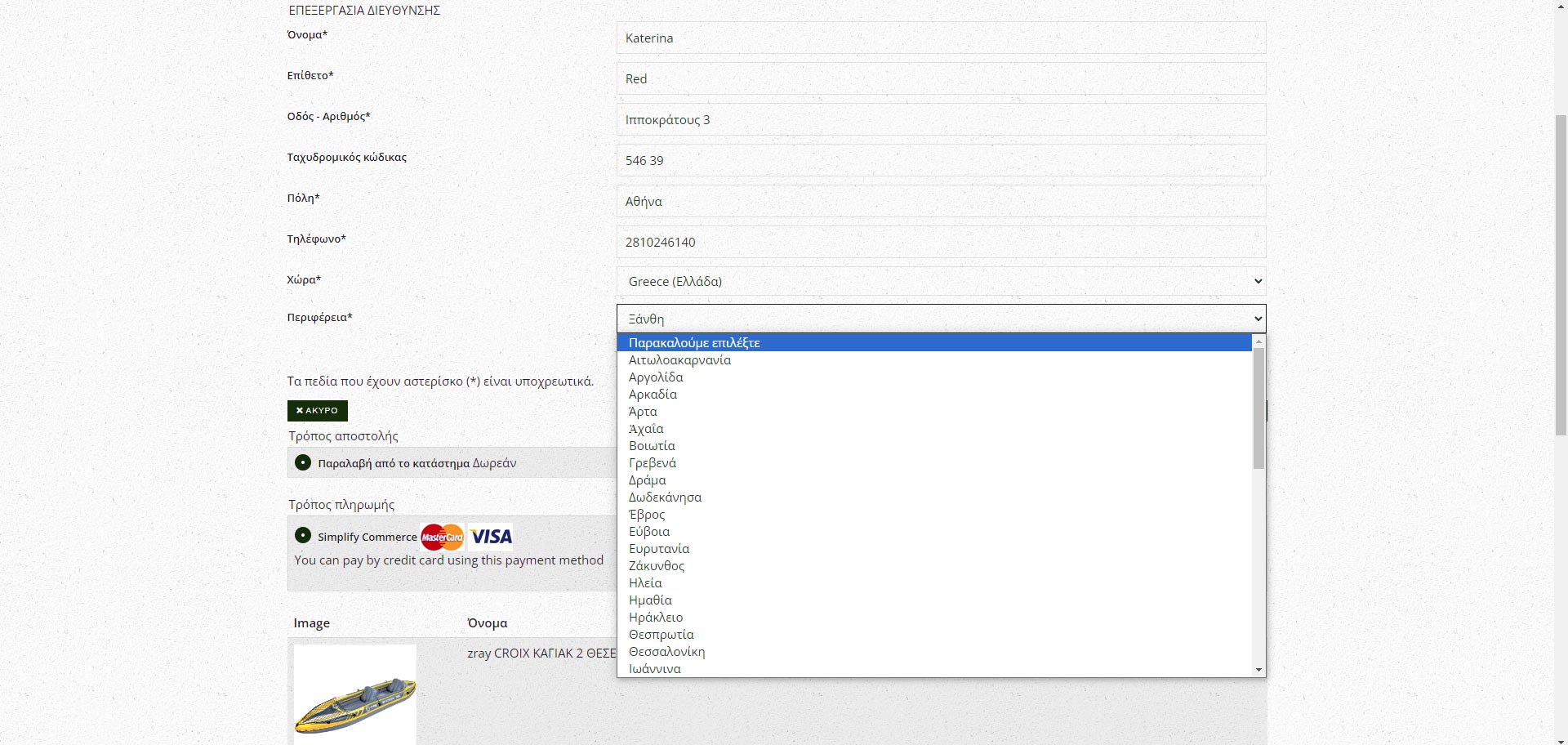

I made the 3 countries states and i published Greece again and i added the 3 states to Greece but on the address page it shows all states that were there before. It seems very complicated to make this work!

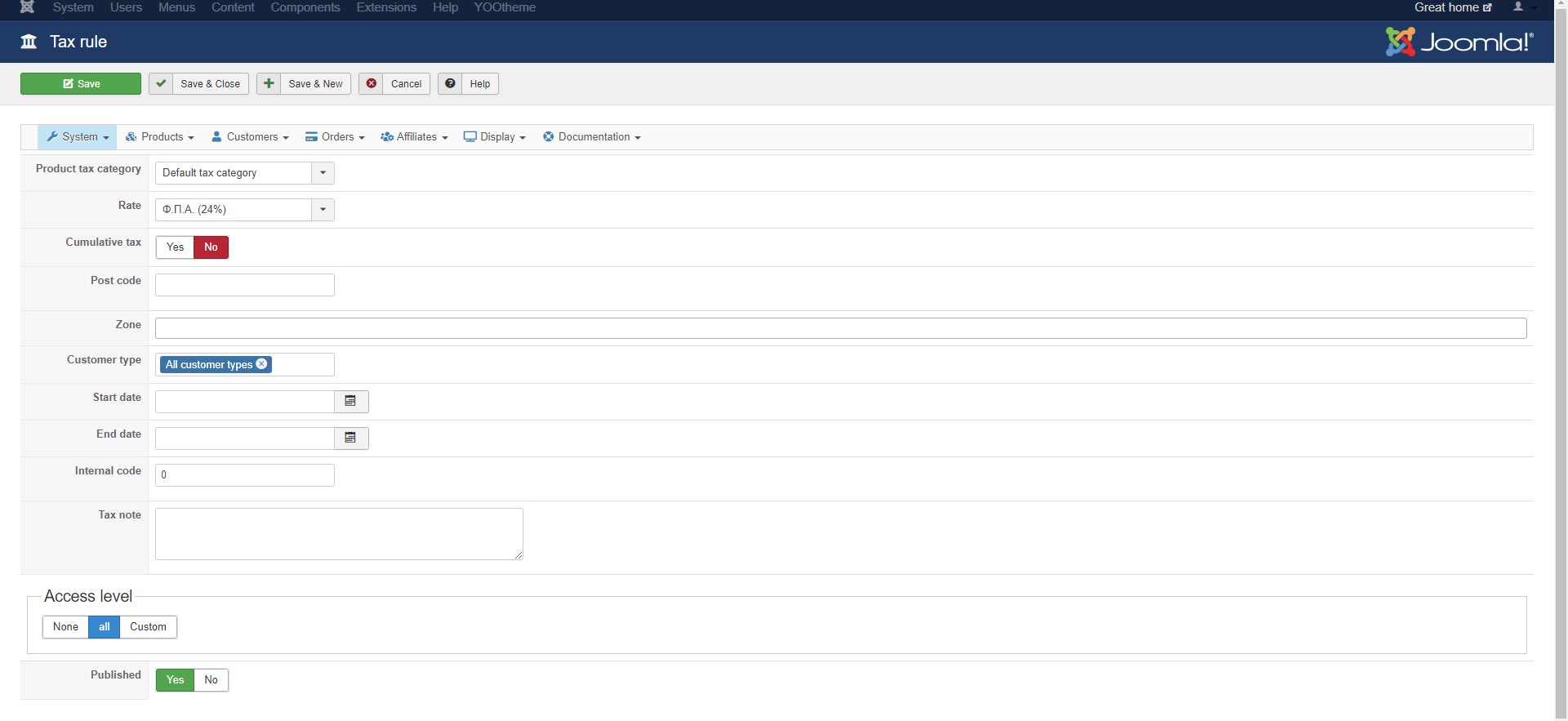

The thing is that i need Greece as my main tax category so isn't there going to be a problem if i disable Greece?
Thank you

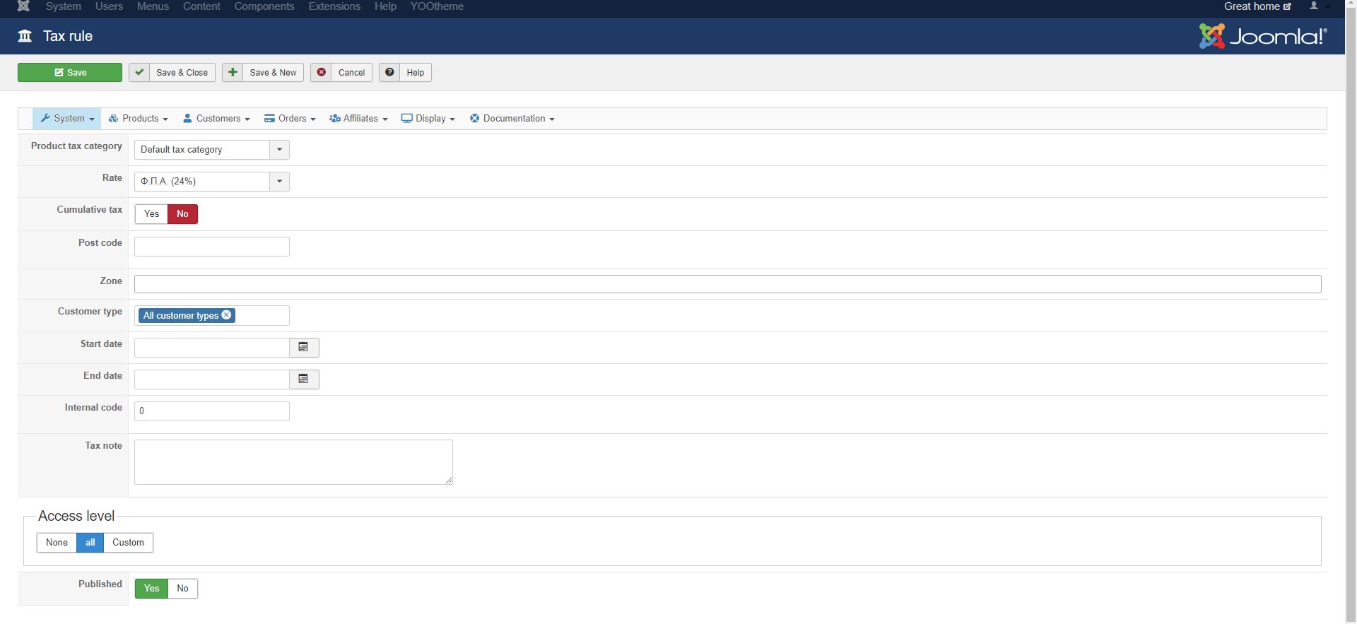

It depends.
Are you selling outside of Greece or only to Greece ? If it's only to Greece, you don't need a country selector for tax calculations.
You can just have the tax rules without a zone restriction and it will apply to everyone.
What payment method are you planning on using ? Some payment gateways might require the country of the user. In that case, you need to keep Greece in there.
In that case, the approach you have with changing the zones won't work.
Instead, I would rather recommend to use post codes in your shipping methods to restrict the shipping methods to different areas of Greece.
In fact, that might be a viable solution even if you're not constrained by your payment gateway.

Hi!

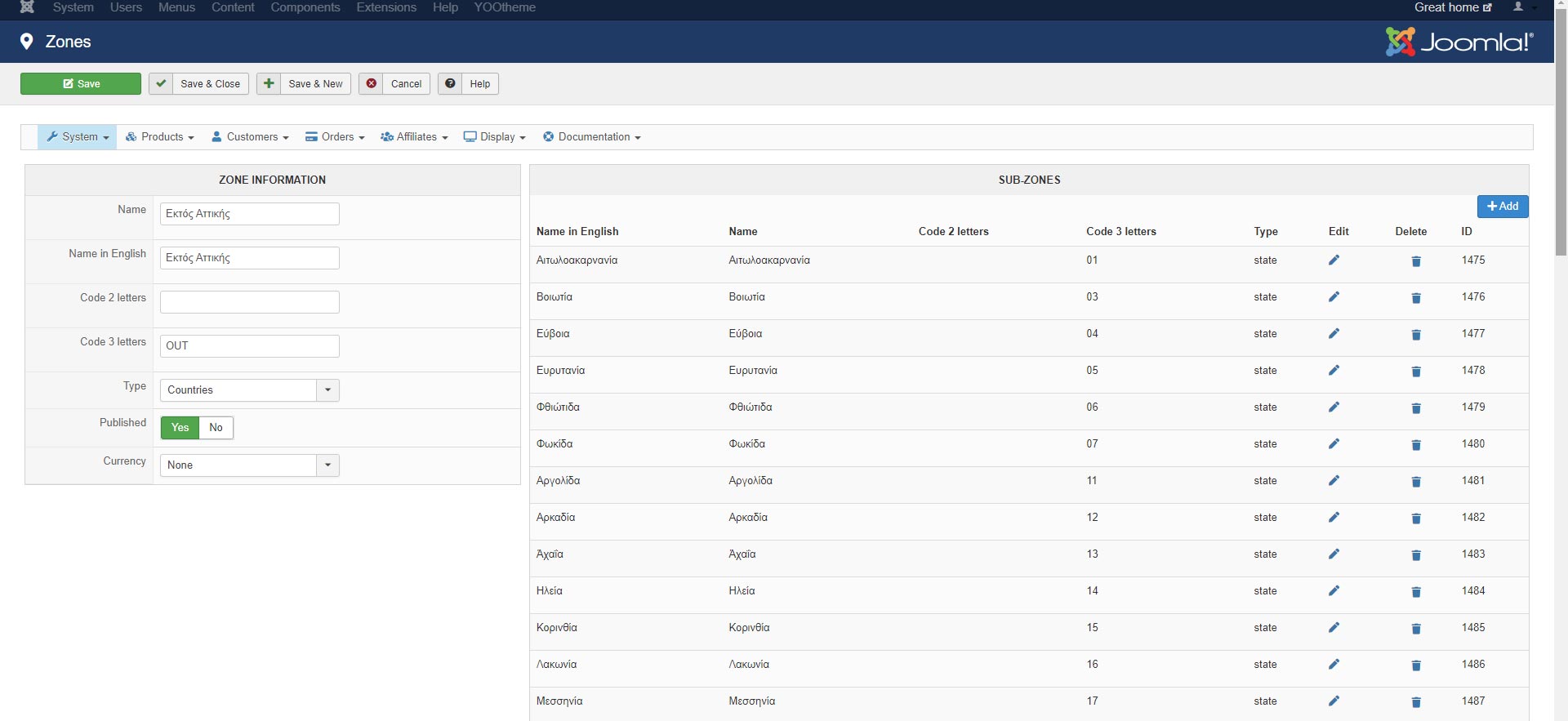

I'm selling only in Greece. Okay so i removed the Zone Greece from the tax category right?
I changed everything back to how you had it in the first place, but still it does not work.

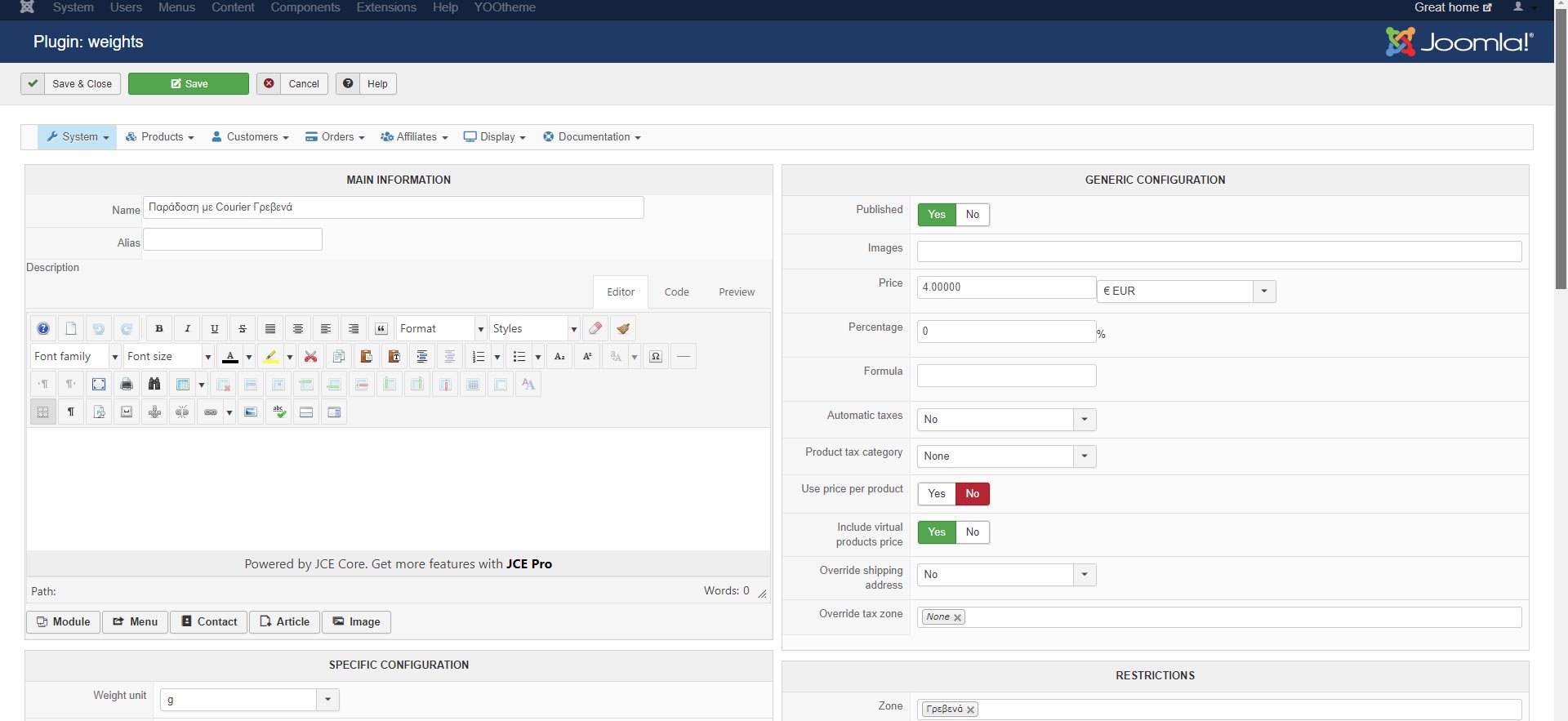

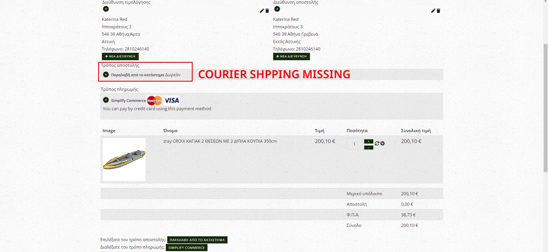

No courier shipping methods are displayed, i set up a courier shipping method for each state of the country "Εκτός Αττικής (other cities)" and 2 courier shipping methods for the other countries.
I go to checkout and i see no courier methods there.
Thank you

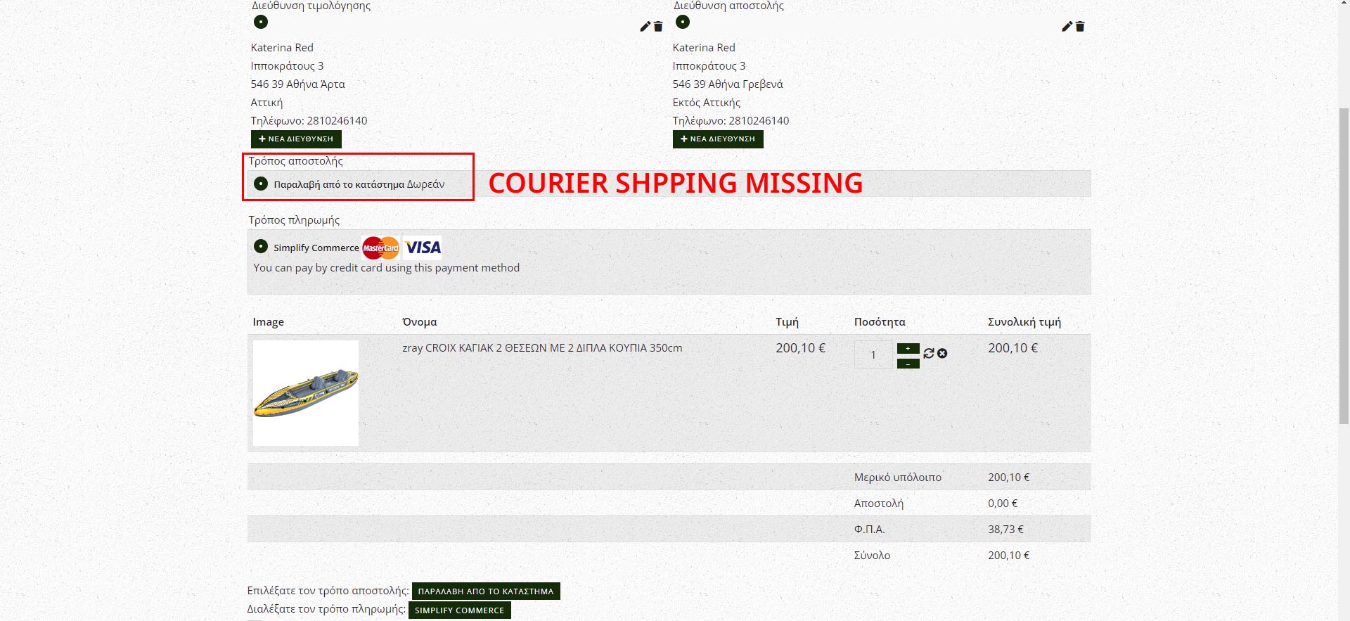

As far as I can see, it works:
i.imgur.com/iOlwE9z.png
i.imgur.com/gEmDSBR.png
i.imgur.com/6G28Hbf.png
i.imgur.com/RkaZVh4.png
You can see on my screenshots that I changed the country/state for my shipping method, and each time, I got another courrier shipping method.
I'm suspecting that you forgot that you need to validate the shipping address by pressing the "OK" button before the shipping methods selection area is refreshed. Could you please check ?

2 years 6 months ago #359193
I checked from Firefox and it does work yes. So it's probably cache on Chrome.
Thank you for help nicolas!
