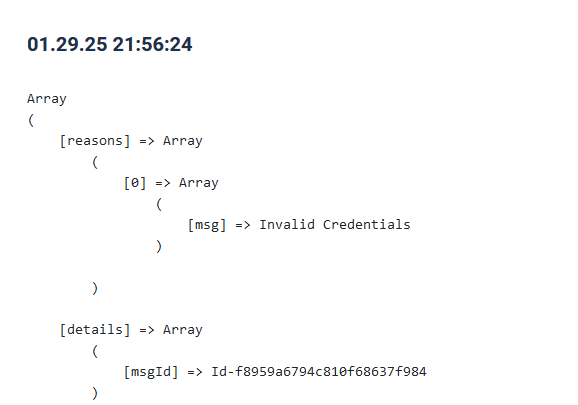

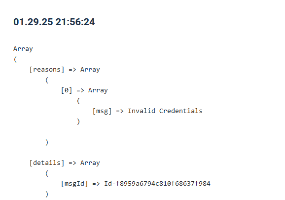

1 year 7 months ago #365447
Thank you :-) :-) :-) It seems from the logs that something is wrong with the credentials......I'm investigating
