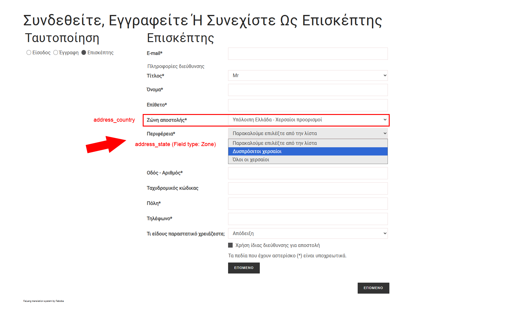

Hi!
There are about 9.000 locations in my country that are hard to reach for the courier company and they have specific prices.
I need to add all these locations in my shipping methods but there are too many to do it manually, is there a faster easier way?
So my checkout page would have to be like this:
1. Select Country: Greece's hard to reach locations (from dropdown field)
2. (when selecting Greece's hard to reach locations) Select location: blabla
Thank you

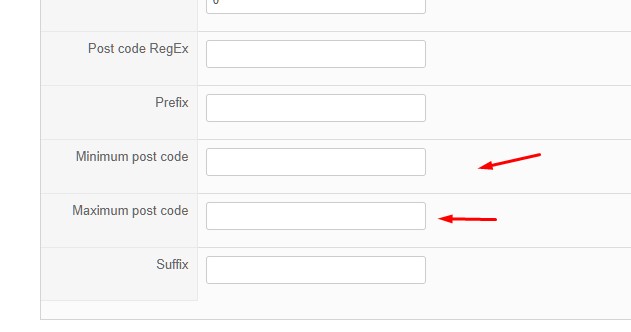

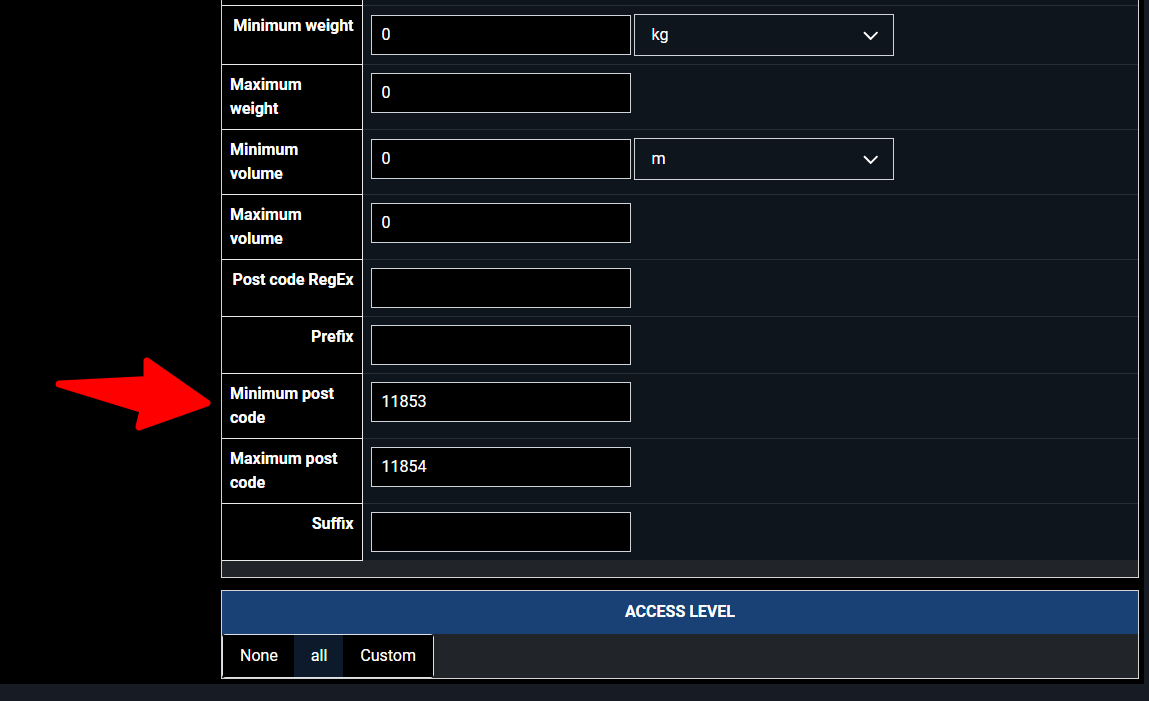

7 months 6 days ago #370333
Hello Nicolas!
What about if we set the the "Minimum and Maximum Post code"
Does hikashop trigger that case?
I tried with no success
Thank you
  • Posts: 1184
  • Thank you received: 13
7 months 6 days ago #370335
No I was wrong Nikolas . It works.
