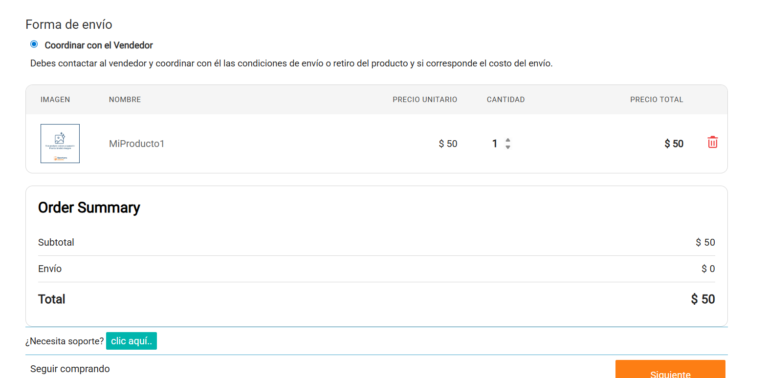

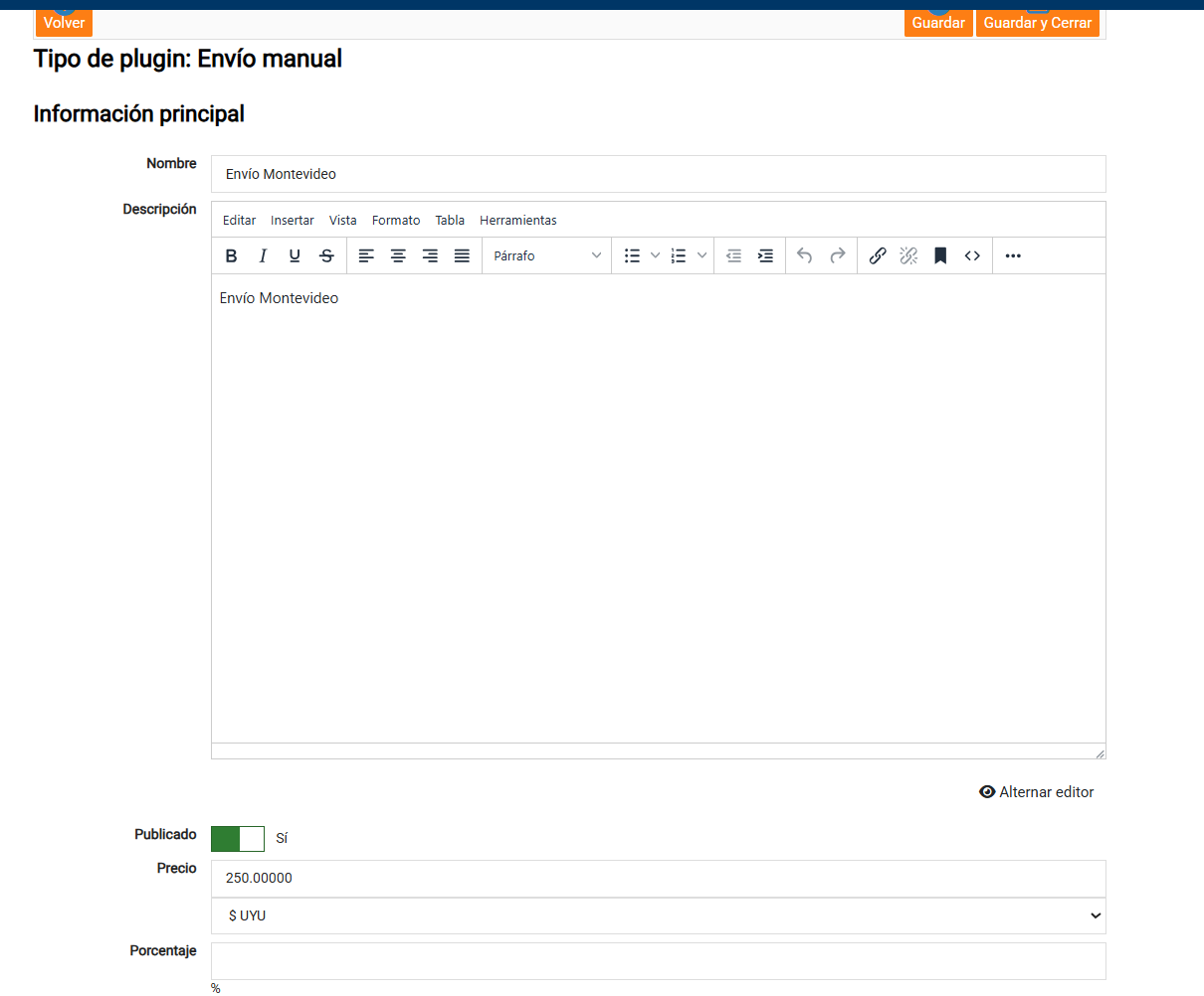

The problem is that I can't get it to work that way. I'm sharing some screenshots to make it clearer.
In the shipping methods settings in the admin panel, it's set up as you indicated: payment method with no assigned seller. You can see it in the screenshot MetodoEnvioGenerale.png.
In the seller's shipping panel (front), the shipping method is configured by the specific seller, as you indicated. You can see it in the screenshot EnvioDelVendedor.png.
But at checkout, only the general shipping method is shown, contrary to what you indicated, which is that the seller's shipping method should be displayed. You can see it in the screenshot EnvioEnCheckout.png.
Do you see anything I need to correct?

1 month 3 weeks ago #371348
Can you please use the "contact us" form to send us an access to your website so we can check the shipping methods?
The method from your second screenshot should be available during the checkout (according to our past conversation and the settings you're using).
