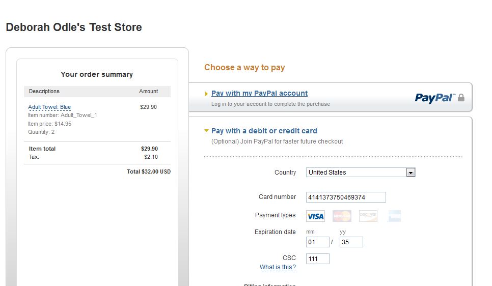

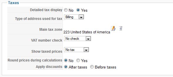

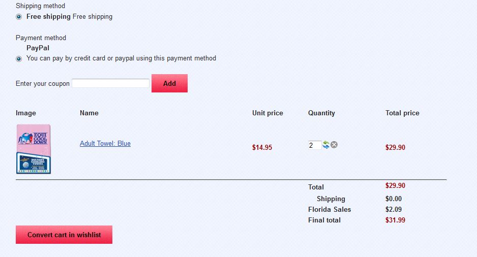

I'm having an issue where I have taxes set to NOT round in the configuration, but when the amount is sending to PayPal, the taxes are being rounded. Paypal then rejects the order because there is a discrepancy in the amount. Here are some screenshots:
Tax Configuration:
Price in Shopping cart in the step prior to sending to PayPal:
Price showing in PayPal:

I think it's actually logical. You send the details of the order to paypal (I guess the tax is 2.099) which will round it and get 2.10.
So it does not correspond to the total you also give. Two solutions to avoid the problem:
- Enable the round feature of Hikashop
- Do not send details to paypal (it's an option in the Paypal payment method plugin)
i hope this will help you.

Thanks much! I chose to enable rounding and I think it works fine.
