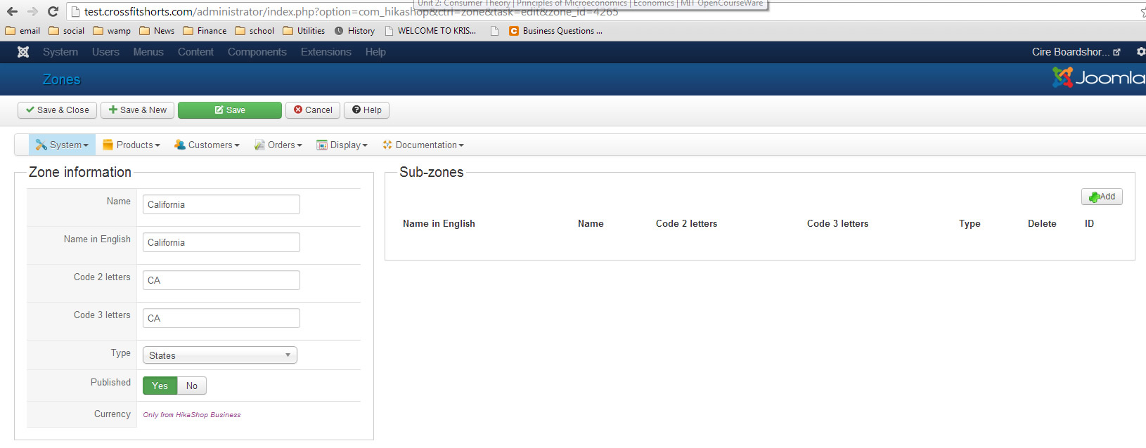

11 years 11 months ago #148522
The solution will just be to :
- Go to your tax configuration page "Hikashop->System->Taxes"
- Set the "Zone" option of your tax configuration screen to CA

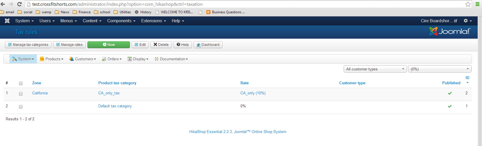

11 years 11 months ago #148618
Mohamed Thelji,
Thank you for your reply. I've already done that and it does not seem to work. please view the screenshot attached.
Am I missing something else?

11 years 11 months ago #148649
In your tax rule, you selected the product tax category called "CA_only_tax". This means that the tax will only apply to the products in the tax category "CA_only_tax". I suppose that all your products are in the tax category called "default tax category" which is why you don't see the tax on your products.

  • Posts: 44
11 years 10 months ago #148747
nicolas,
THANK YOU! Your answer solved my problem.
