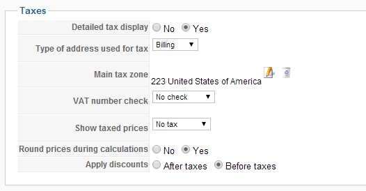

12 years 4 months ago #149964
The solution will be to change the value of the "Apply discounts" option through "Hikashop->System->Configuration->Main".

12 years 4 months ago #150107
Mohamed Thelji wrote: Hello,
It is set up that way..

12 years 4 months ago #150179
That's only half of the problem.
The taxes on coupons are calculated based on that "apply discounts" option AND based on the "tax category" option of the coupon.
So you have four different combinations of these two options which will result on different tax calculations in order to do what you want.
So try the different combinations in order to suits your needs. You should definitely find a combination you want.
