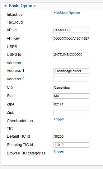

I personally made the TaxCloud implementation for a customer and gave the plugin to the HikaShop community under the GPL license.
The TaxCloud plugin is working fine for all my tests and all the test my client did. It is currently used in production for his website and he does not have any specific troubles with Paypal.
The plugin communicate with the TaxCloud platform if you use a valid TaxCloud API credentials.
It allows it to get the values of the tax for the products of your cart and it set the taxes to the products, like if it was a fixed tax in your HikaShop configuration.
I don't know how you configured your Paypal plugin but I recommend you to remove the option to send the content of the cart, it can generates some troubles.
Paypal does not have to calculate the taxes for you because HikaShop and the TaxCloud plugin already did.
If you want a capture of my test configuration, I put it as attachment. I just used my TaxCloud and my USPS test accounts.
Even today, as long as I use a US address in my customer address, the TaxCloud plugin does his job so I really don't understand why in your side, the TaxCloud plugin won't communicate with the TaxCloud platform. The API system is made to let everybody use it to get some tax prices, as long as you have a TaxCloud accounts (credentials).
