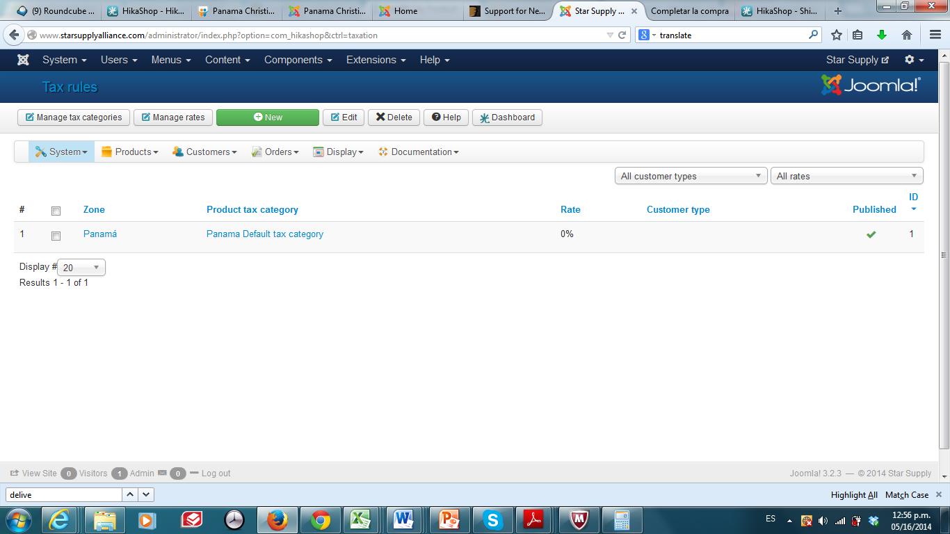

1. The tax category screen - as you can see the tax rate value is 0% . How do I change this?

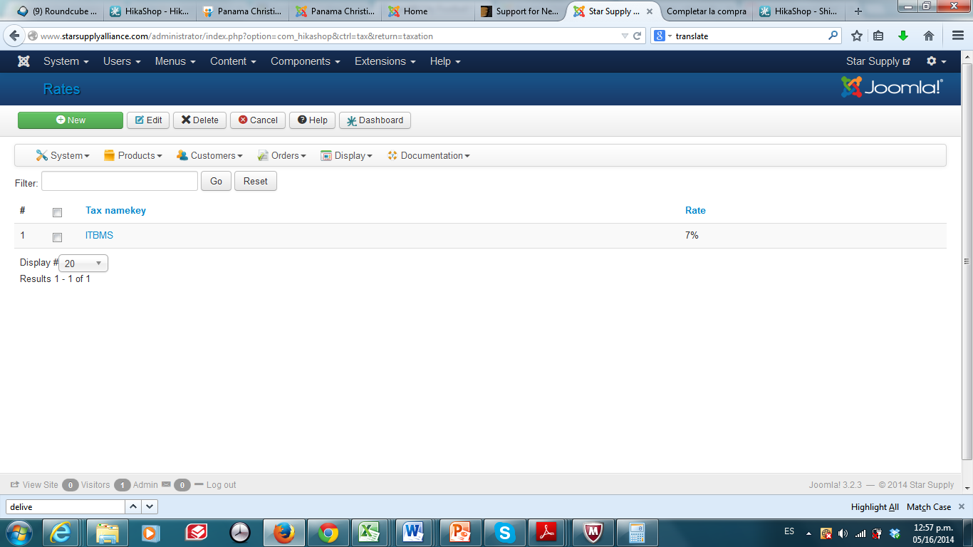

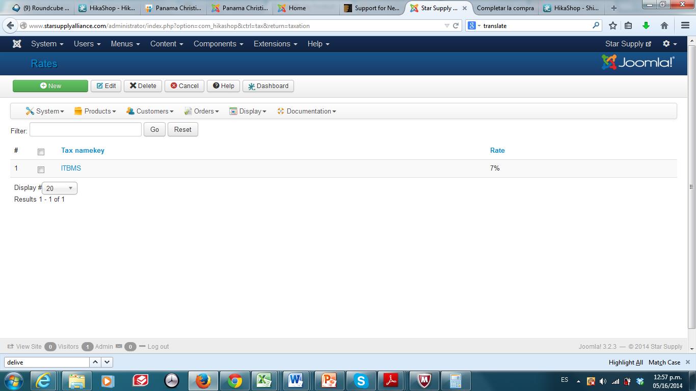

3. The manage rates - with one rate of ITBMS set up

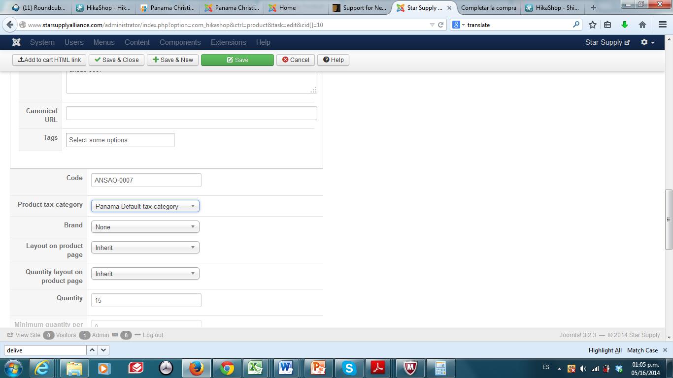

4. The Product management screen - Which tax category do I select - at the moment I have two options
- Panama Default Tax Category
- ITBMS
to work with the tax configurations set up?

  • Posts: 86042
  • Thank you received: 14174
12 years 2 months ago #156145
Edit your tax rule (check the checkbox on the left of the tax rule, click on the edit button at the top) and select your 7% tax rate in it and then save. Then it should work.
