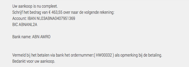

Hello, going through the forum I could not find a message containing my problem that quick, so I decided to post it.
I try to sell subscriptions with a certain value.
The price set for each subscription is with tax, I have created four subscriptions with different rates, all including tax.
When I try to buy a subscription and select a payment method like bank transfer I get to see a message that tells me that I have to transfer an amount of money with taxes calculated again.
Subscription costs € 395,- tax included. Buy it by bank transfer, it will cost € 463,55.
Surely there must be something set wrong somewhere, but I can't seem to find it.
Maybe you can help me out here.

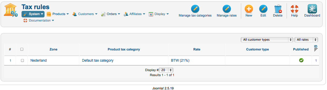

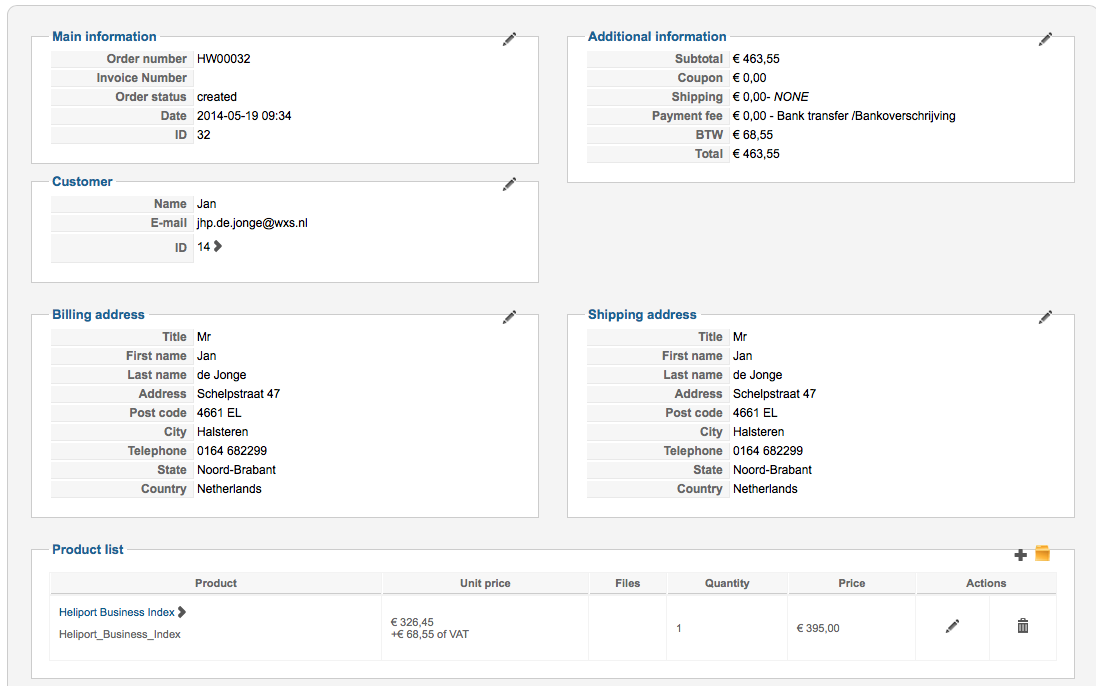

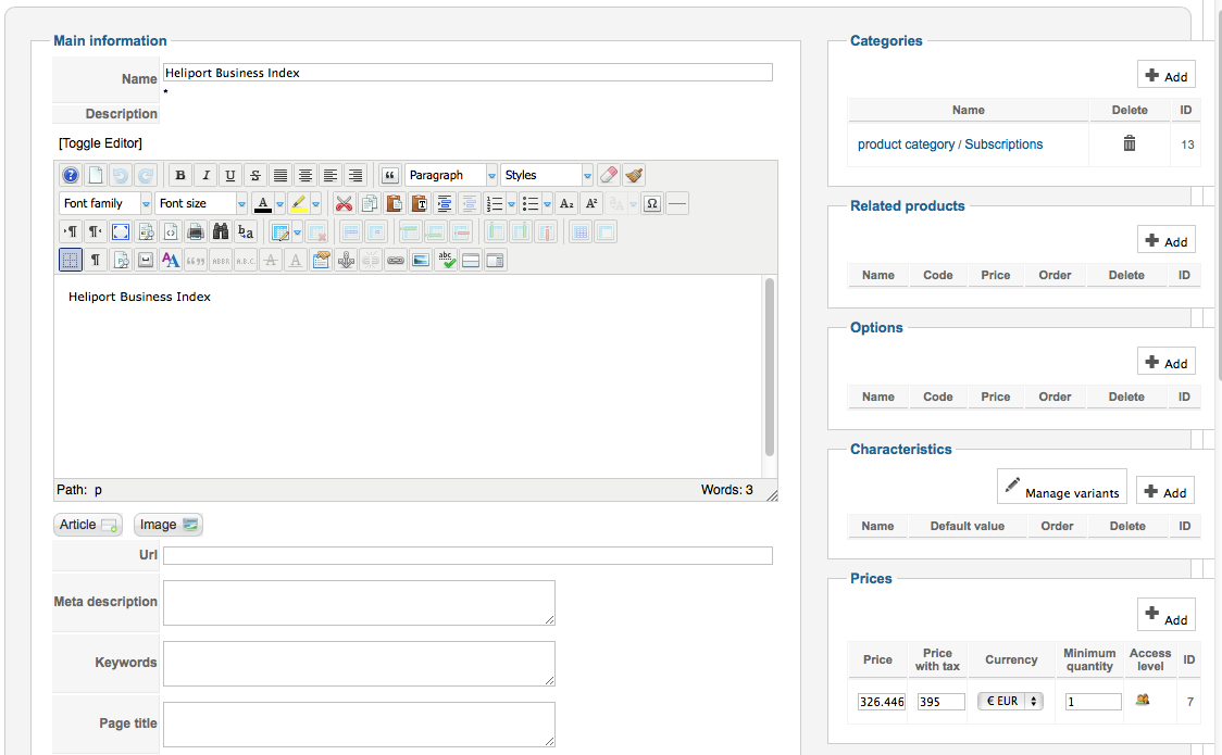

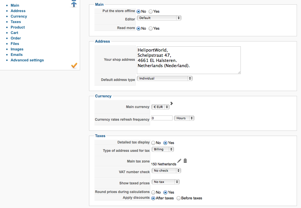

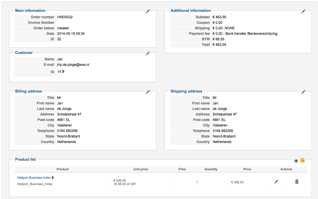

  • Posts: 7
12 years 2 months ago #156351
Indeed, I agree, somewhere the 21% tax is applied twice. But where....?
I provided you with some screenshots from the backend.
I do agree as well that one can have many ways of configuring the taxes.
But I am confident that together we will be able to solve the puzzle.
Looking forward to hear again from you.

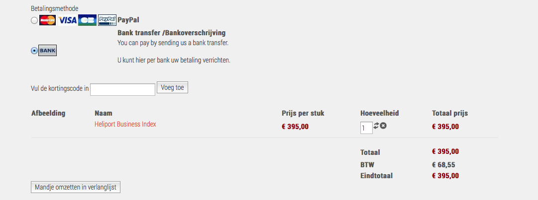

  • Posts: 86042
  • Thank you received: 14174
12 years 2 months ago #156381
Looking at your screenshots I can see that the final total in the checkout is 395, tax included.
And in the order, the product price is correct as well.
The only issue seems to come from the order_full_price field of your order which apparently adds the tax twice.
First, I would recommend to update HikaShop to the 2.3.1. Your never know, that could be a bug (although I don't think that it will change anything).
Second, I would recommend you to check whether you modified any code in HikaShop, overriding some views, or modifying directly the code somewhere ? Or if you added/enabled additional plugins which could affect the price (like the TaxCloud plugin, the donation plugin, the HikaShop tax calculations override plugin, etc) via the Joomla plugins manager.
Try to revert your changes, disable the plugins, and test with a new order to see if that helps.

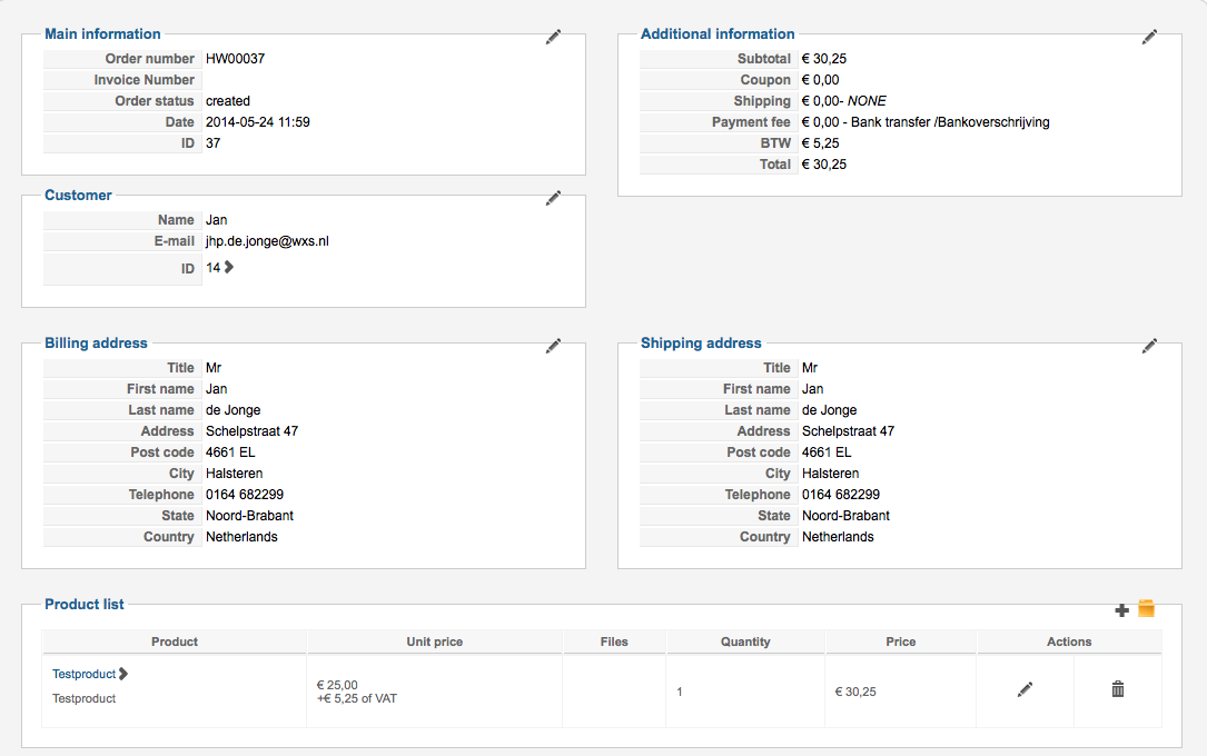

I have created a testproduct environment, apart from Akeeba Subs.
Now, as you can see in the attached screenshot, the price is calculated in the right way.
€25 + 21% = € 30,25
You should draw the conclusion that it has something to do with the connection with Akeeba Subs...
In Akeeba Subs there is a price for the subscriptions as well, along with tax rules...
I find it so strange that apparently no one has had this problem before, hard to believe as well though.
