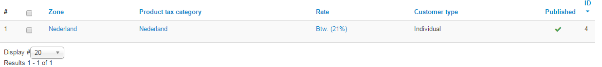

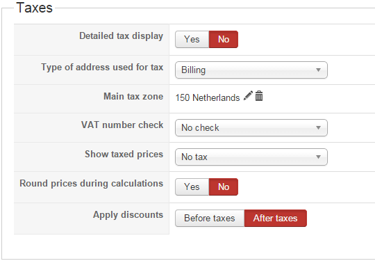

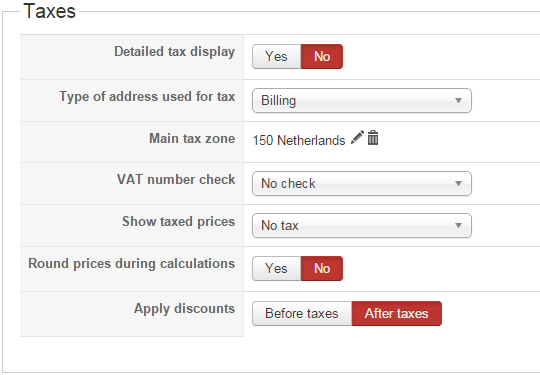

For my webshop I use the combination of Calcbuilder and Hikashop to calculate the product prices, calcbuilder creates a new product after each calculation and therefore it's not possible to set a default tax group on the products.

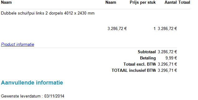

I tried to apply the tax rate of 21% to all products in the checkout but it won't work in any of the ways I've tried, see my attachments for my Tax settings (BTW = VAT). The order e-mails are showing prices with and without the tax but without any rates so the proces are the same (see scrnshot).

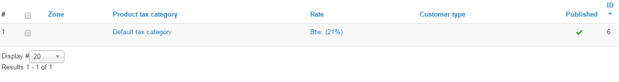

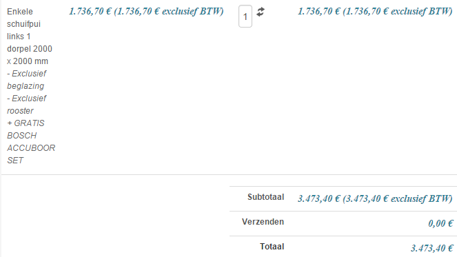

11 years 9 months ago #177767
hello Mohamed,
Thank you for your reply, I've changed the Tax rues to: Netherlands - Default Tax category - 21% - all customer types.

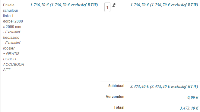

It didn't solve my problem, the problem will show when I put the 'detailed tax display' function on, see the attached screeshot.
Screenshot: The price with the added tax is supposed to be 1.736,70, so that one is correct, but the price without the tax is the same amount and no tax is displayed in the subtotal.

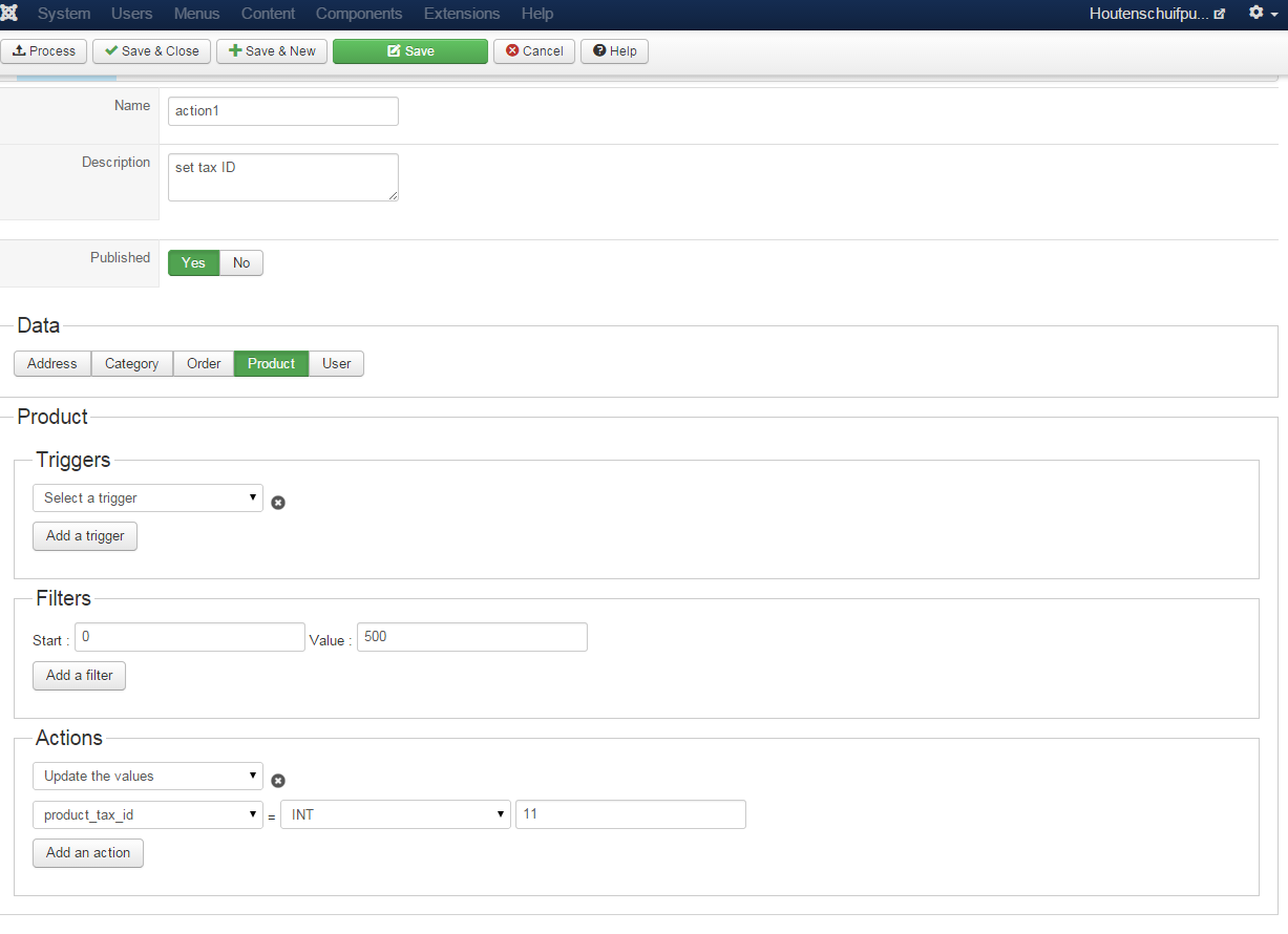

11 years 9 months ago #178059
To set the default tax rule to all the products, you can potentially do that via the mass actions.
Please backup your database before anything.
Then via System > Mass actions, create a new one with the "product" data, then in the action select "Update the values", "product_tax_id" = INT and the id of the desired tax rule. You can find it in System > Taxes.

11 years 9 months ago #178242
Mass actions should set the correct tax category to the products, so apply the tax.
Are you sure that you have set a correct value ?
Please give us a screenshot of your mass action settings and your tax rules, tax categories listings.

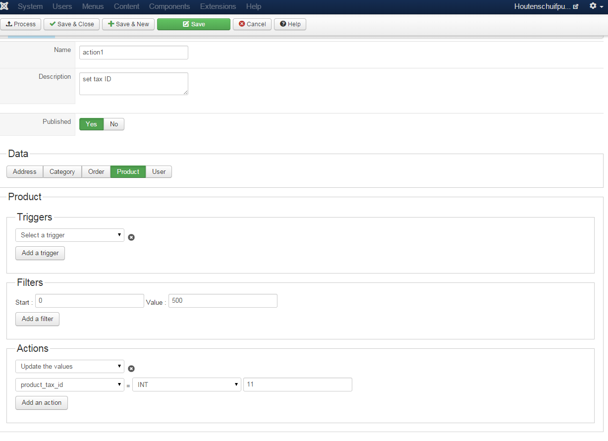

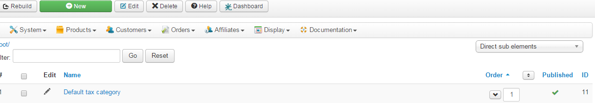

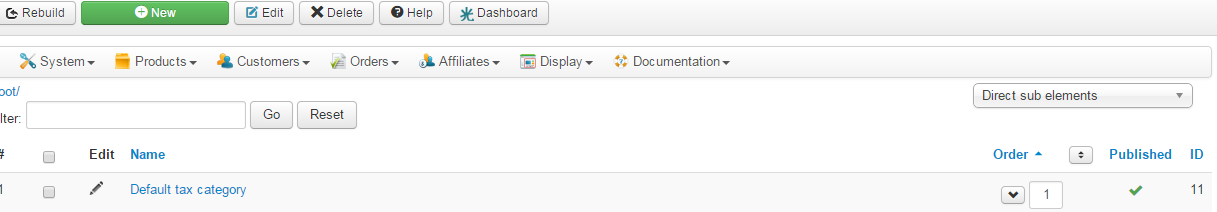

  • Posts: 14
11 years 9 months ago #179303
Hi Xavier,
Something worked with the mass action, if I have several products in my shopping cart and I execute the mass action the right taxes will be applied on these products. But when a product is created by Calcbuilder the mass action isn't automatically executed (even I work with the triggers). So the mass action works fine, but not at the right moments.

11 years 8 months ago #179436
In the screenshot, you don't have selected a trigger, so the mass action will never be executer unless you click on the proceed button.
So please select the desired trigger in the triggers list.
