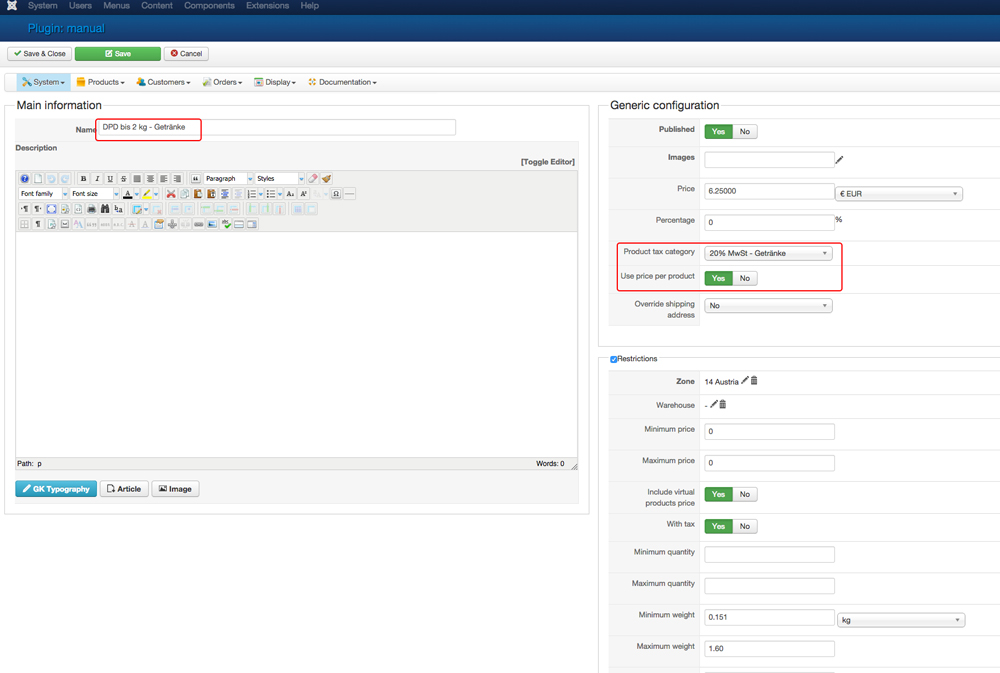

The solution will be to create 1 shipping method for each product tax category, so you'll just have to :
- Create 2 shipping methods with different "Product Tax Categories" and with the "Price per product" option set to YES
- Go to your product page and block the shipping method that you don't want to use for this product. (and do it for each products)

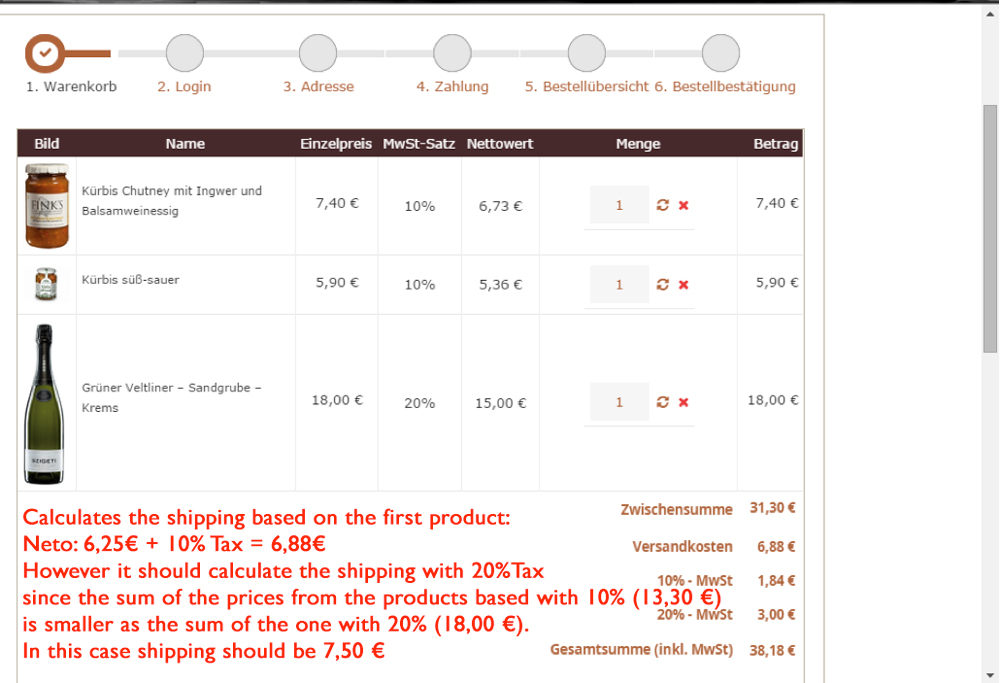

I noticed that I forgot to mention that my shipping table is "product weight" dependent. So here is what I did:

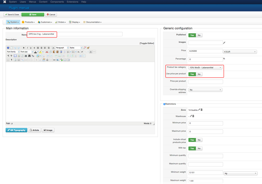

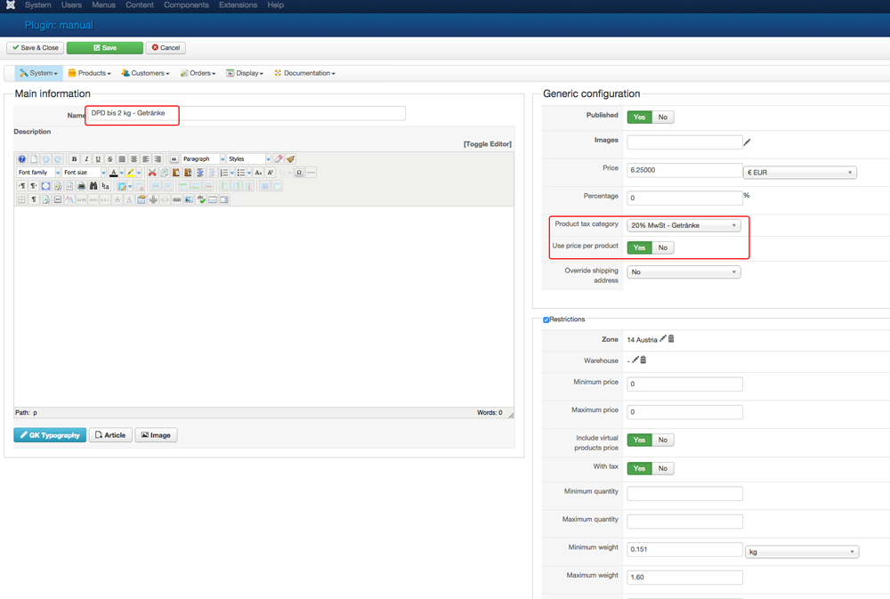

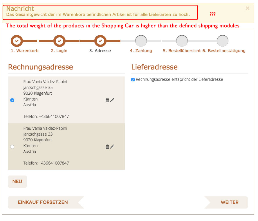

1) I duplicated all my shipping modules and set one for 10% and another 20% within the same weight range. I also set the "Price per product" option to YES. I did this for all of them. See pictures: shipping_set_up.jpg & shipping_set_up_2.jpg
2) I tested with three products: 2 with 10% (Food) and 1 with 20% (drink).
a) On the first try, I only worked with shipping until 2kg. So I blocked the other weight range NOT corresponding to the product tax. So it looked like: product 10% - shipping 10%
My shopping car look like shown in the picture: wrong_shipping_cost.jpg
In this case the module calculated the shipping based on the first product:
Neto: 6,25€ + 10% Tax = 6,88€
However it should calculate the shipping with 20%Tax
since the sum of the prices from the products based with 10% (13,30 €)
is smaller as the sum of the one with 20% (18,00 €).
In this case shipping should be 7,50 €
If the product with 20% was in the top, it would calculate the shipping with 20%.

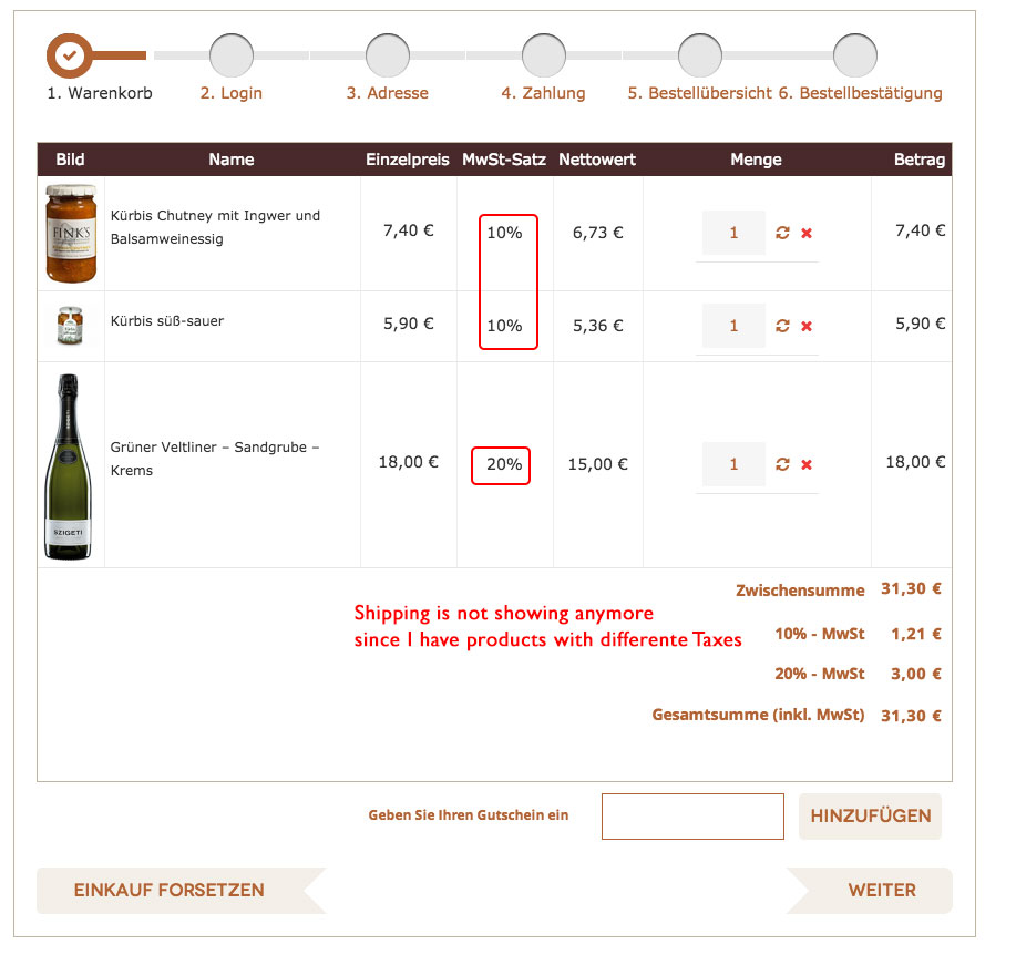

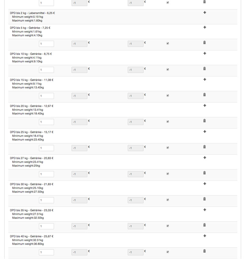

b) On the second try, I worked with all the shipping modules with all the shipping limits. In this case I blocked all the shipping method that didn't correspond to the product tax (shipping_list.jpg)
This is when everything went wrong. No shipping was shown anymore (no_shipping_shown.jpg). When I went ahead with the order, I couldn’t oder at all (cannot_buy.jpg)

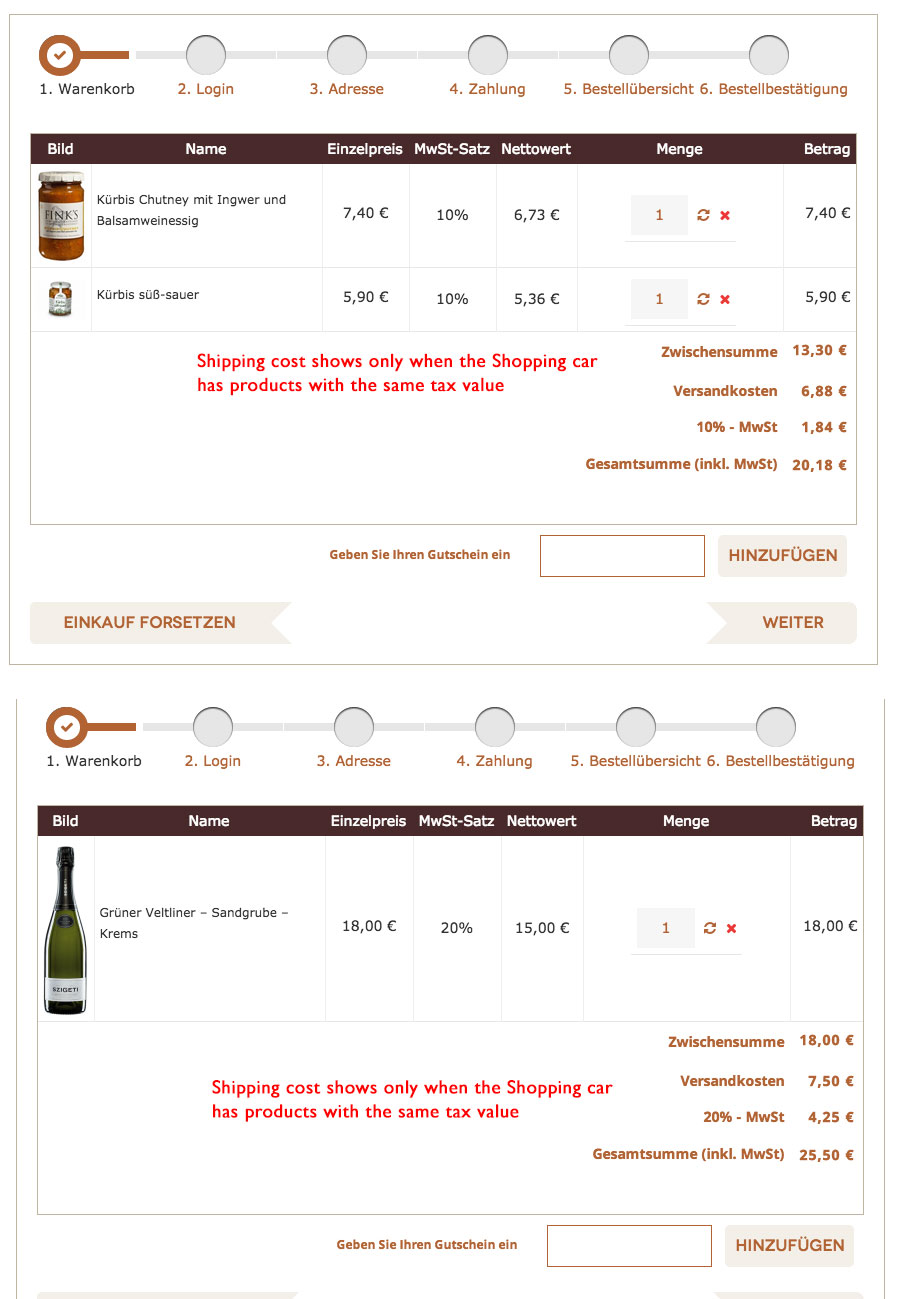

Then I tried to have only group with the same taxes (can_only_calculate_one_tax_group_per_order.jpg) and the shipping cost was back there. So it mean, that in this case it will only work if the products in the shopping car have the same taxable value :-(
