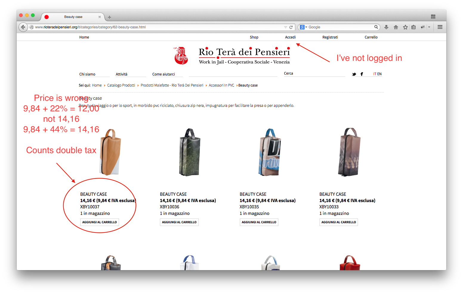

-- url of the page with the problem -- : www.rioteradeipensieri.org/
-- Joomla version -- : 3.3.6
-- PHP version -- : 5.3.29
-- Browser(s) name and version -- : Firefox 33.1

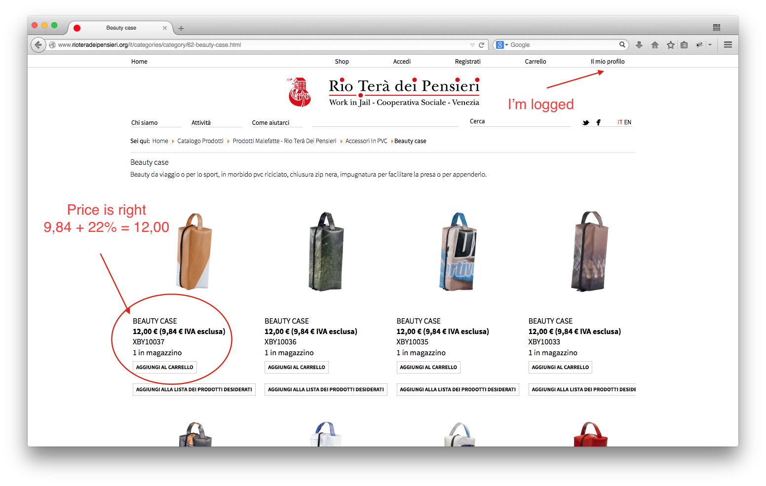

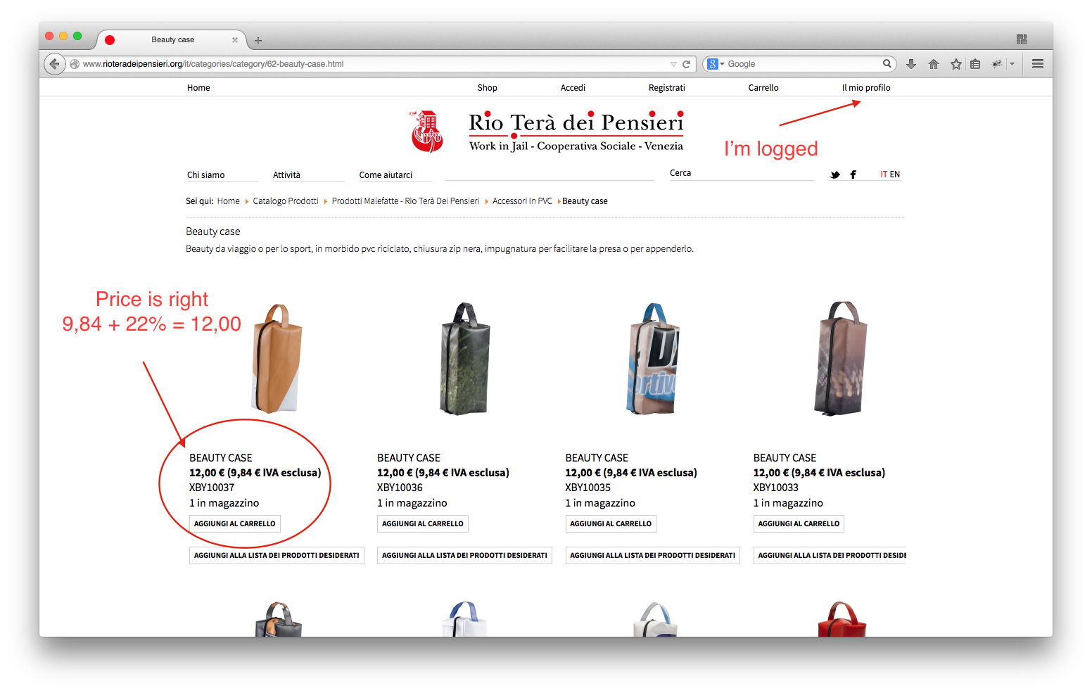

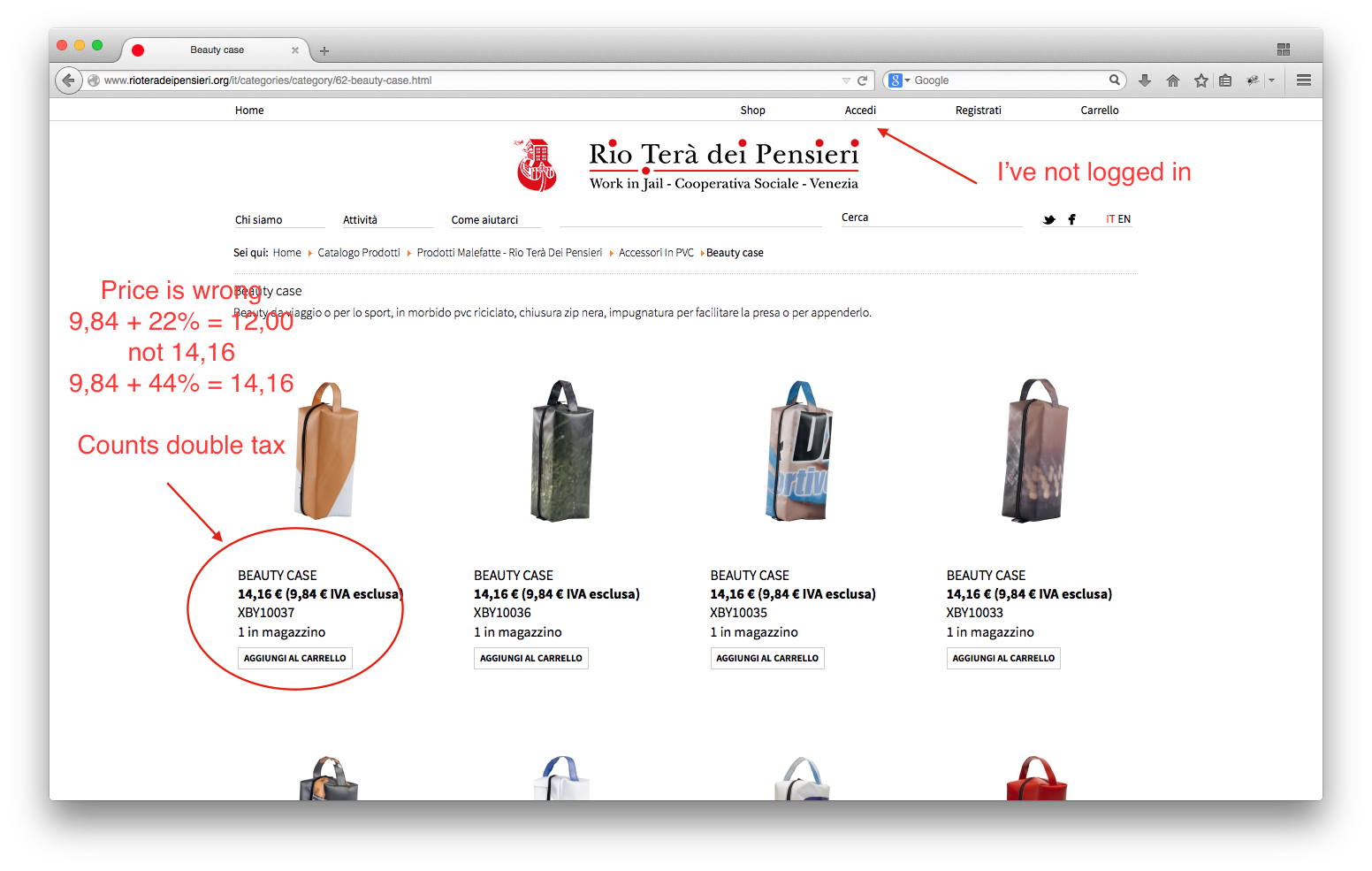

I've this issue.
The system counts in wrong way the product's tax. I.E. If I'm not logged in joomla the tax is right, but if i'm not logged in joomla the system counts double (in Italy tax is 22%, it counts 44%).
I've just tried to use default display view, but I think that the problem is before.

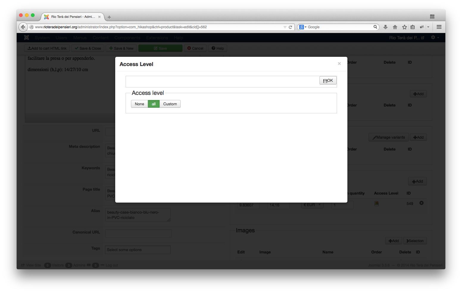

I didn't set any ACL in price setup.
I've attached screenshot to explain better the issue.
Can you help me.
Thank you
Antonio

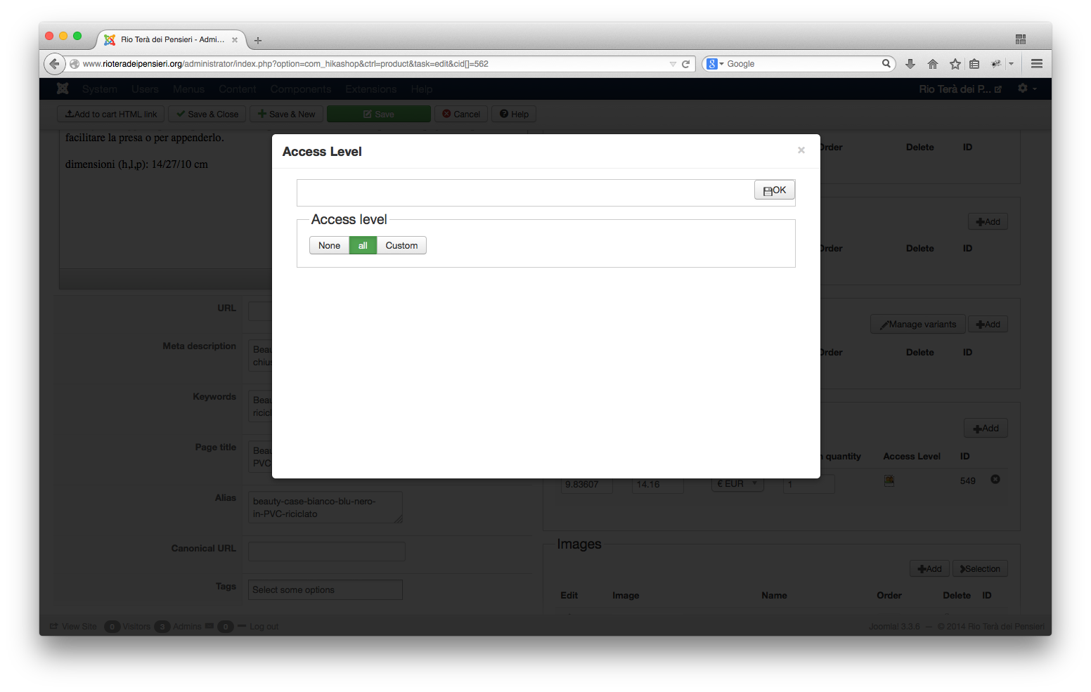

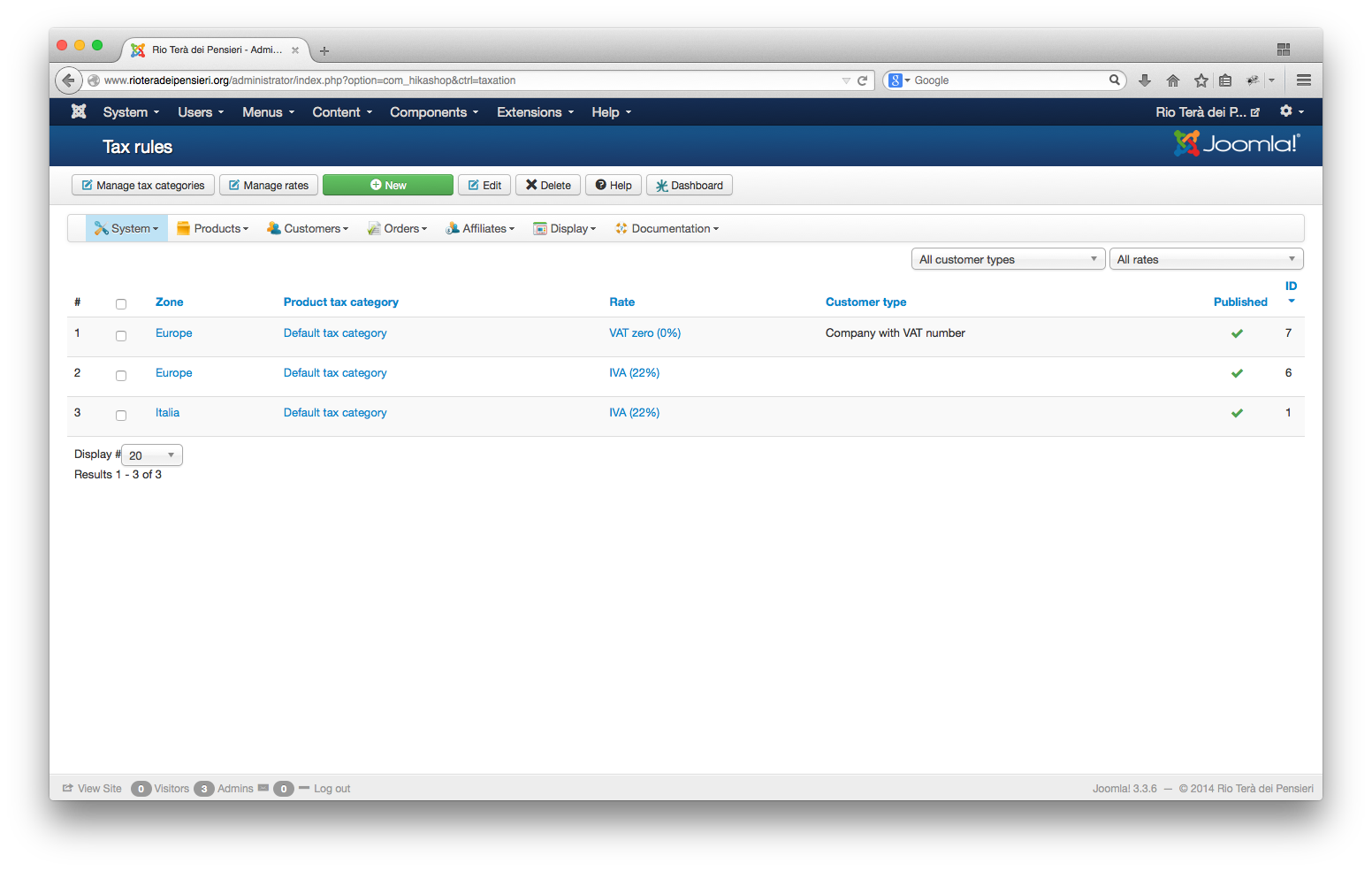

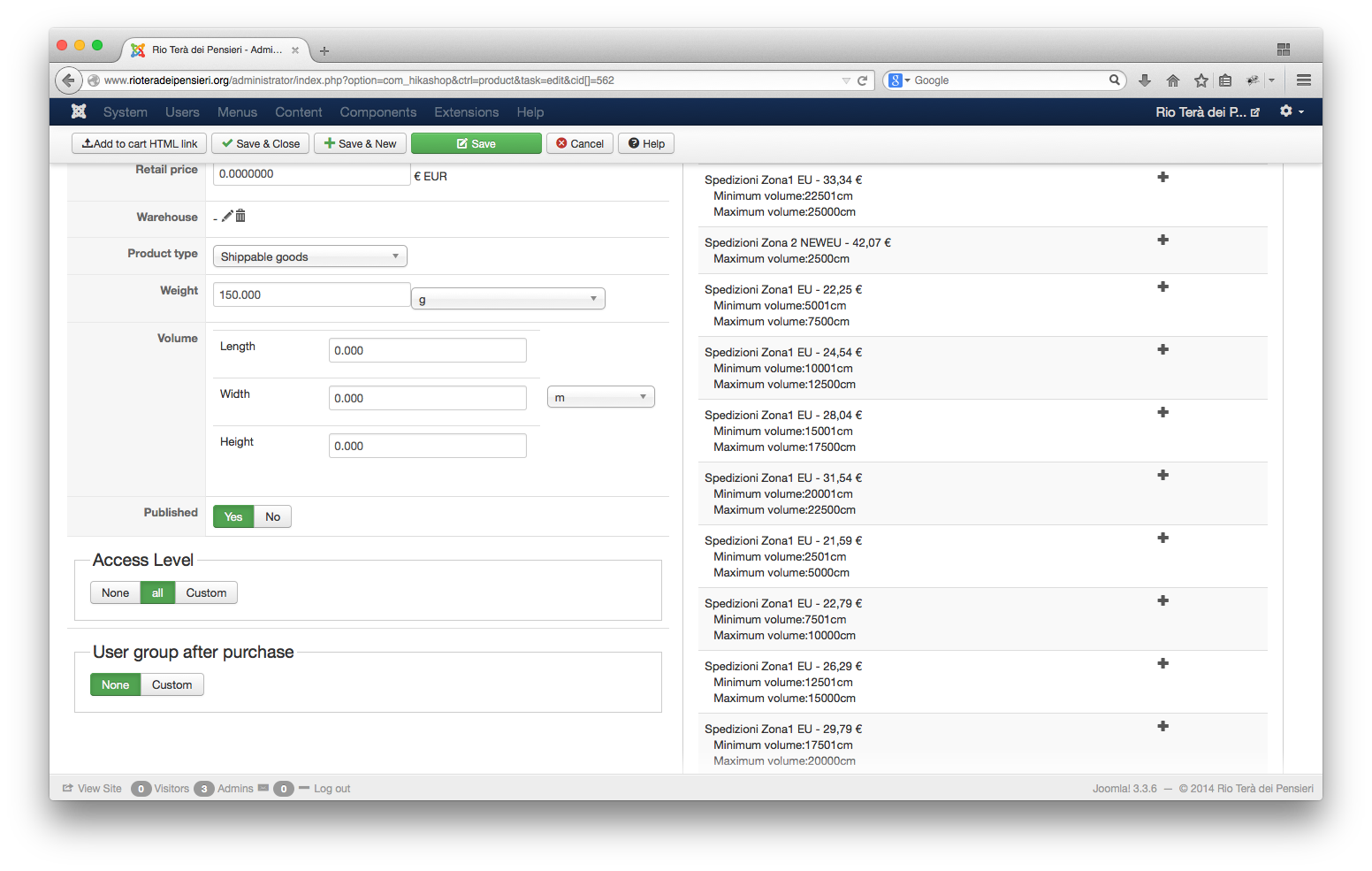

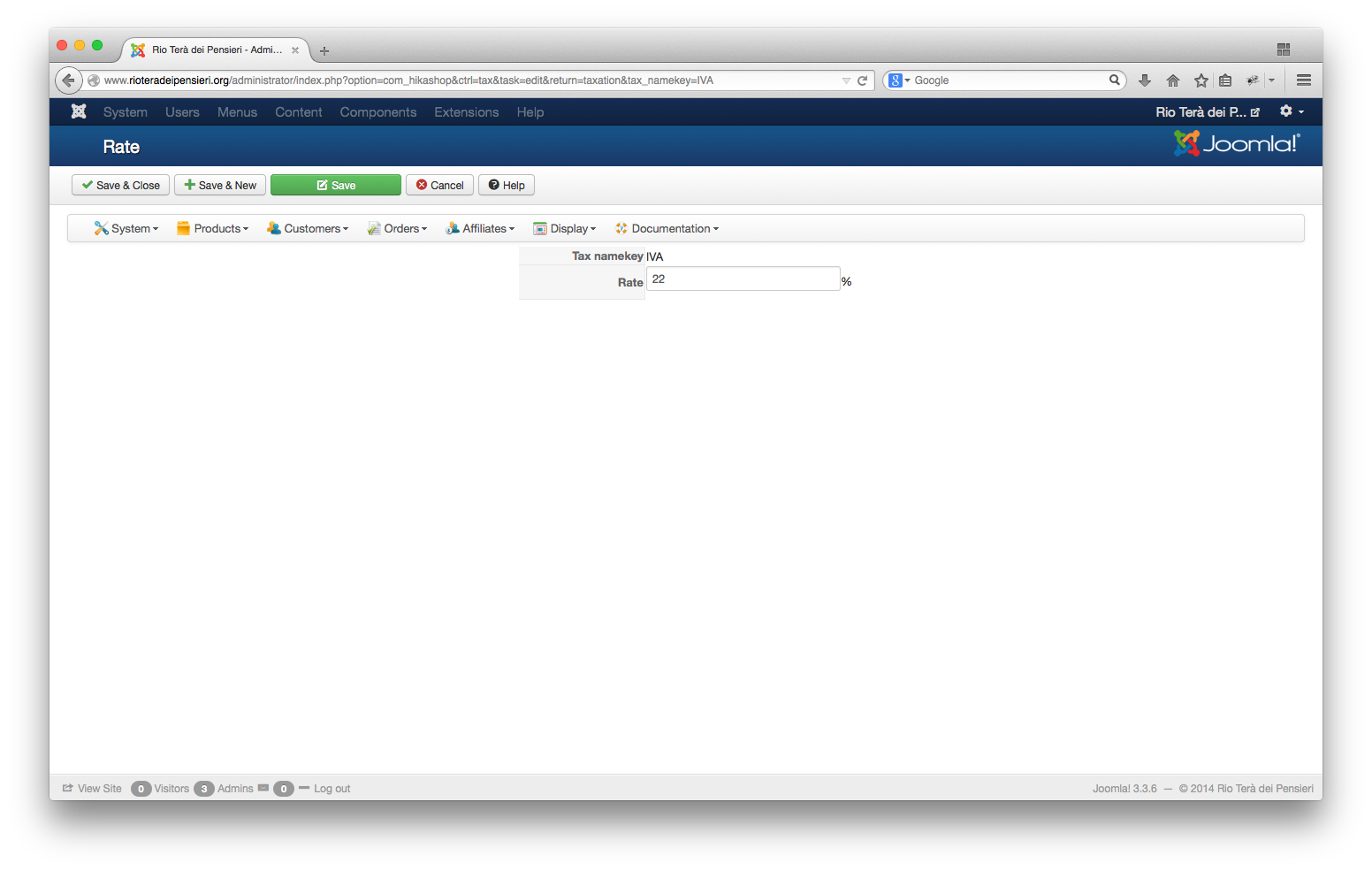

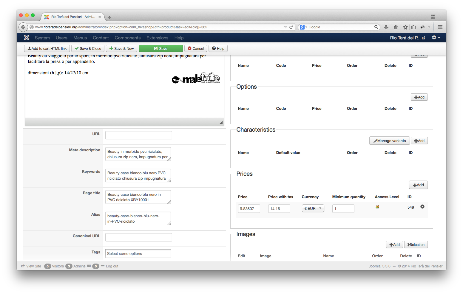

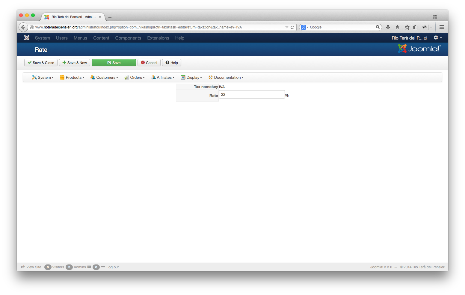

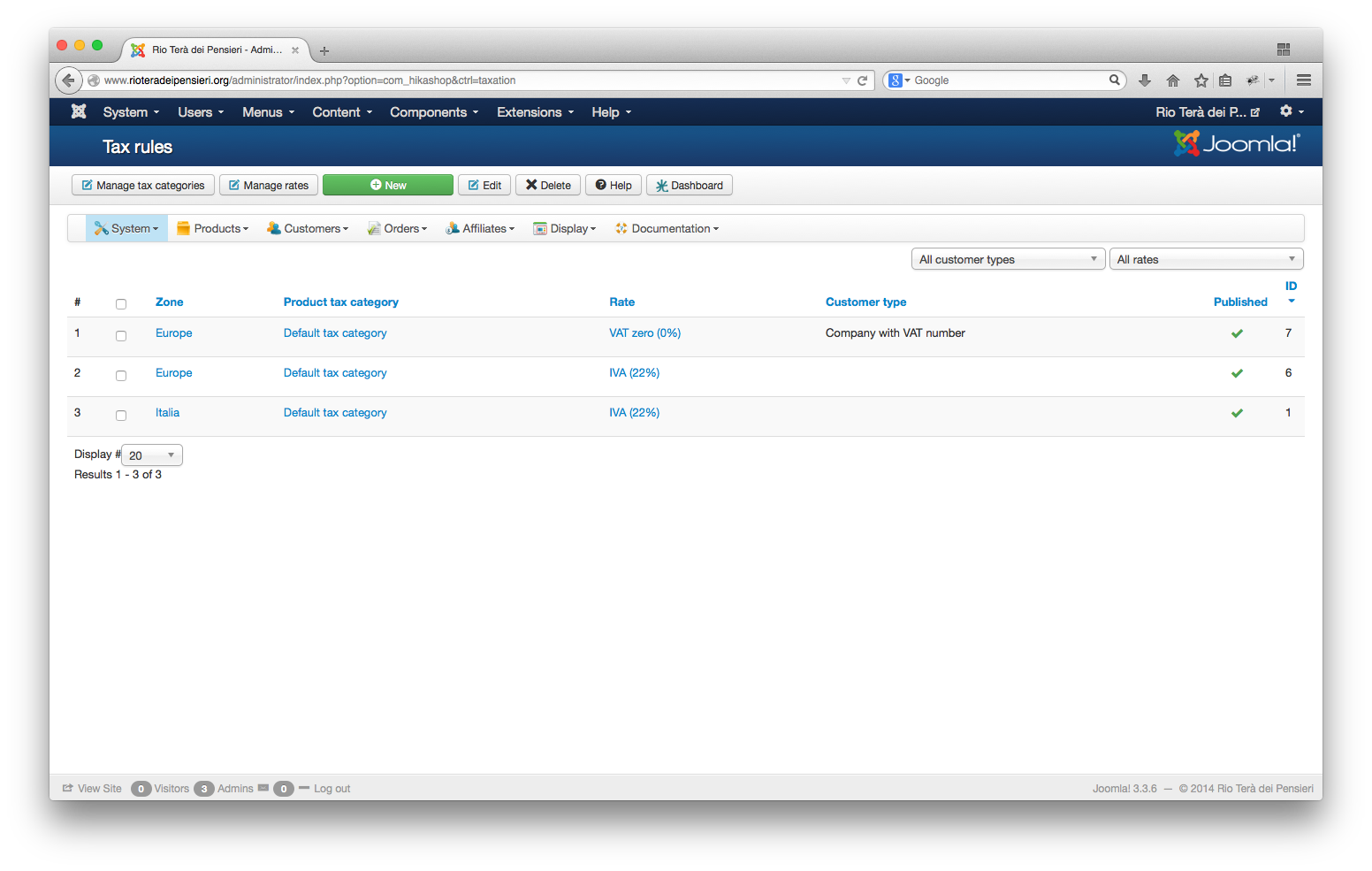

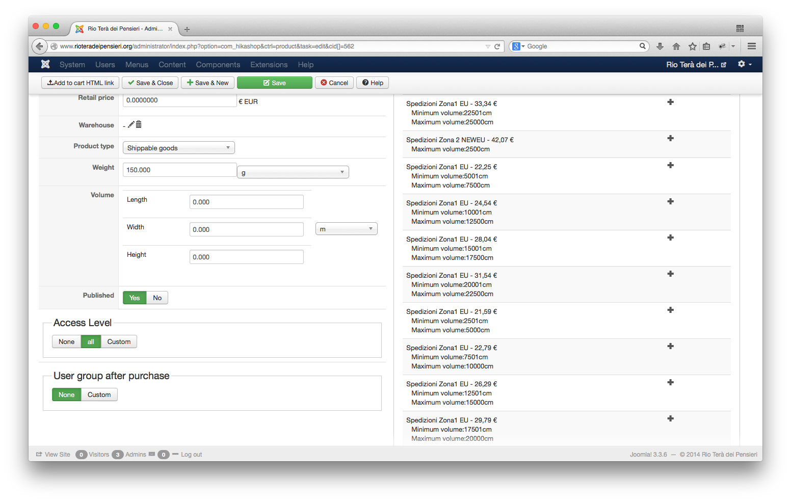

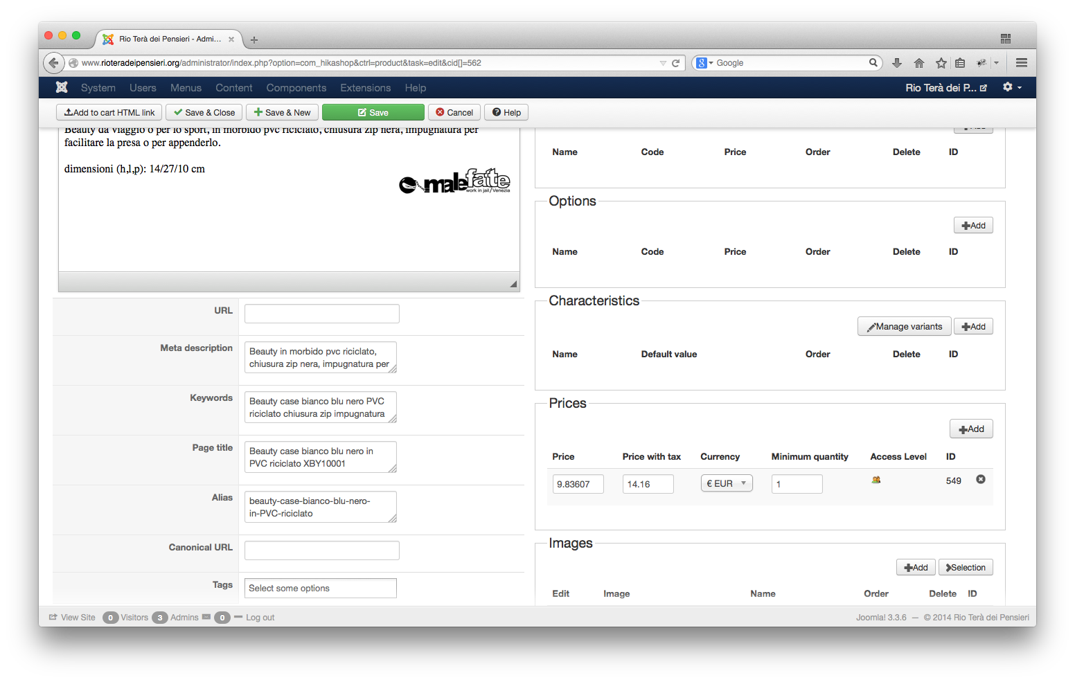

Can you show me how did you configured :
- Your product price
- Your taxes
Through some screenshots ?
Thanks.
  • Posts: 15
11 years 8 months ago #182080
Yes of course,
In attachments.

11 years 8 months ago #182086
You should unpublish the "Italia" tax.
The following user(s) said Thank You: 42bit
  • Posts: 15
11 years 8 months ago #182191
Ok, It works well now!
Thanks for your support.
Antonio
