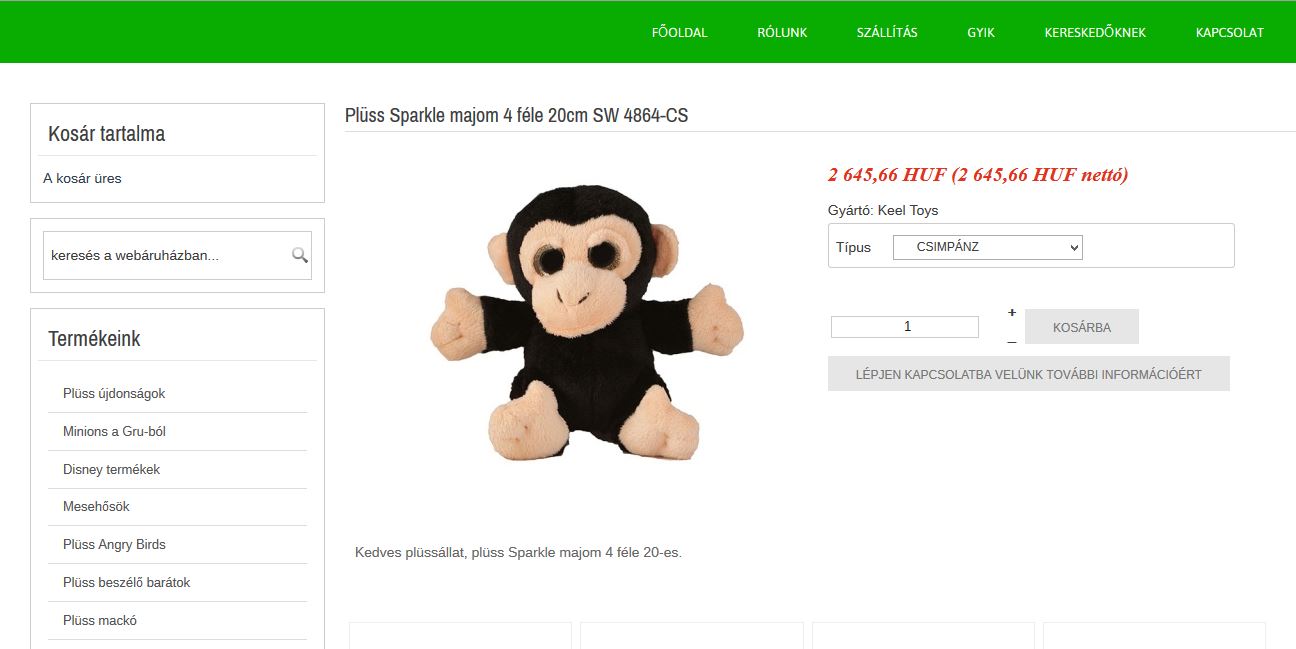

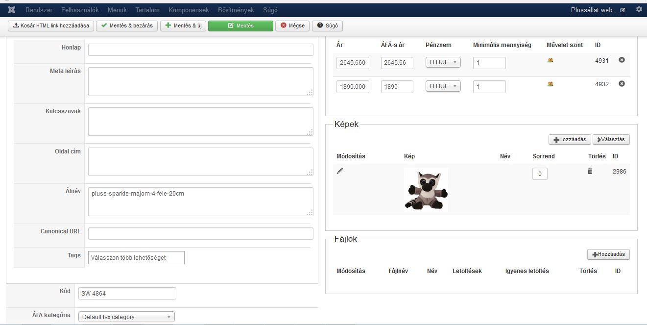

  • Posts: 10
11 years 5 months ago #193405
This is the problem (attachments)
The price excluding VAT

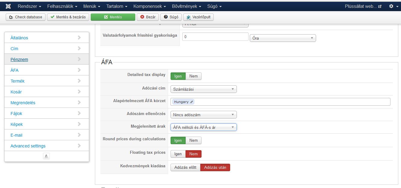

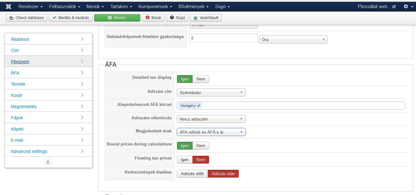

  • Posts: 26381
11 years 5 months ago #193407
i.e. if the my customer is selling an item for 1000 euro I don't want this to change with VAT. I need all items to show the same price no matter what the country he's from.
You can do that by turning on the "floating tax prices" option of the HikaShop configuration.
@zsenya : Please re-download HikaShop 2.4.0 and then re-save your configuration for the setting "main tax category" in the HikaShop configuration. There was an issue with the first version of the package where the setting store the zone namekey instead of the zone id.

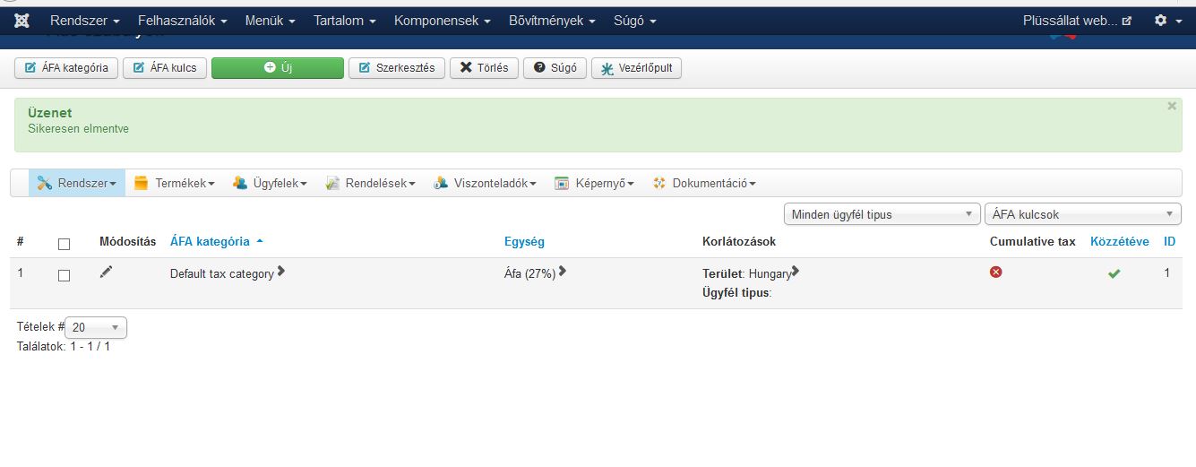

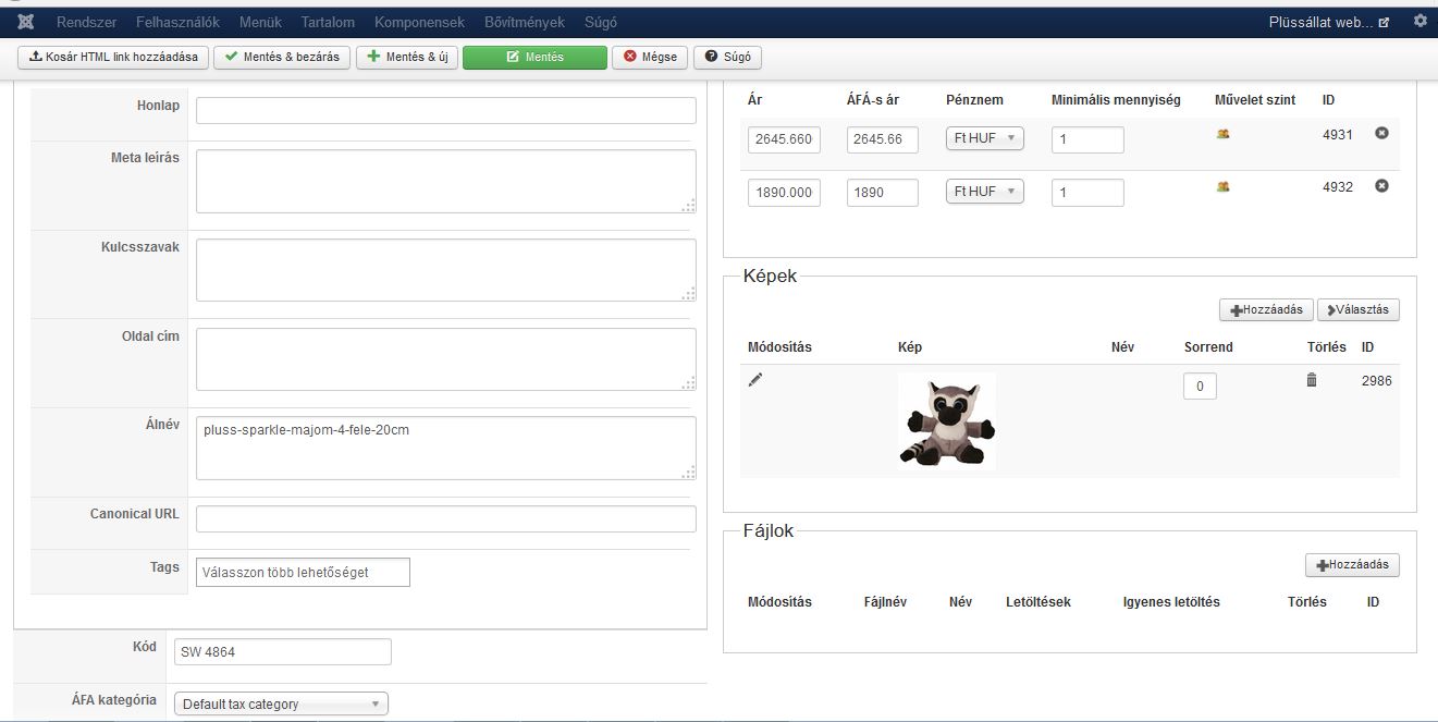

  • Posts: 86042
  • Thank you received: 14174
11 years 5 months ago #194584
Make sure that you select a tax category in your products. And make sure that you delete the "customer type" selection of your tax rule.
It will then work properly.
I've done it for you for that product and it is working:
/plussallat-kategoria-lista/product/2214-pluss-meduza-narancs-25cm
