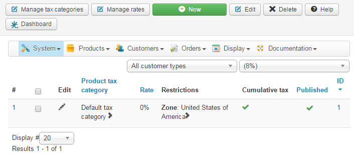

UPDATE: Looks like I fixed the problem by setting "Cumulative tax" to "Yes" in SYSTEM>TAXES

The cumulative tax option allows you to have several tax rules apply at the same time to your products price.
So I suppose that you had several tax rules setup, and one without a tax rate, or with a tax rate of 0% was found and used over the other tax rule that was set with the 8% tax rate.
Activating the cumulative tax setting of your tax rules allowed the system to actually process both tax rules for the prices and thus you got your prices taxed with both 0% and 8% (or something similar to that).

Thanks for your reply. Actually I only have one tax rule set up. I don't understand why switching to "Cumulative tax" fixed the problem.

It's probably a side effect of the fact that you don't have a namekey for your tax rate and a 0% tax rate for it.
