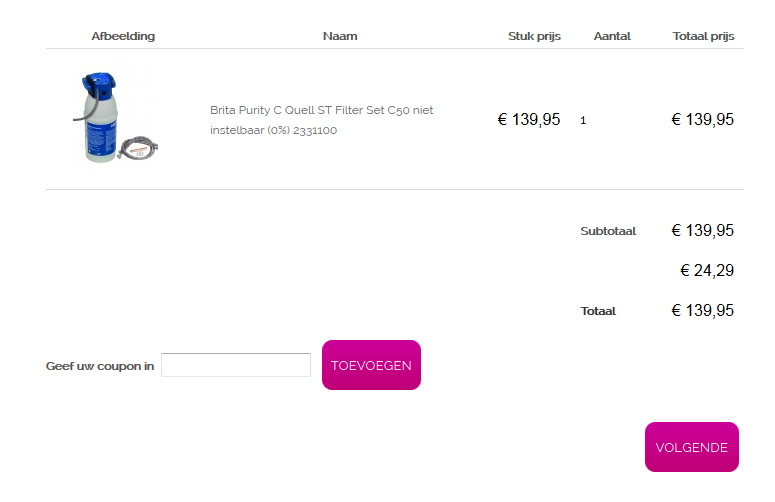

Dear Hikashop,
On my checkoutpage, i can see the VAT amount, but in the column before it, i dont see the text "vat".
I looked into the language files, but i dont see anything strange there. It happened directly after a clean install.
The website is under construction, so i only can provide a screenshot.
I have made multiple webshops with Hikashop, and I have never ran into this problem.
Thanks in advance

This means that you created a tax rate without a name.
Go in the System>Taxes menu, click on the "manage tax rates", create a new tax rate and this time enter a name for it.
Then, edit your tax rules via the menu System>Taxes and change the tax rate to that new one and that will fix the problem.

Thanks for you quick reply.
It works fine now, problem solved!!!
Tnx!
