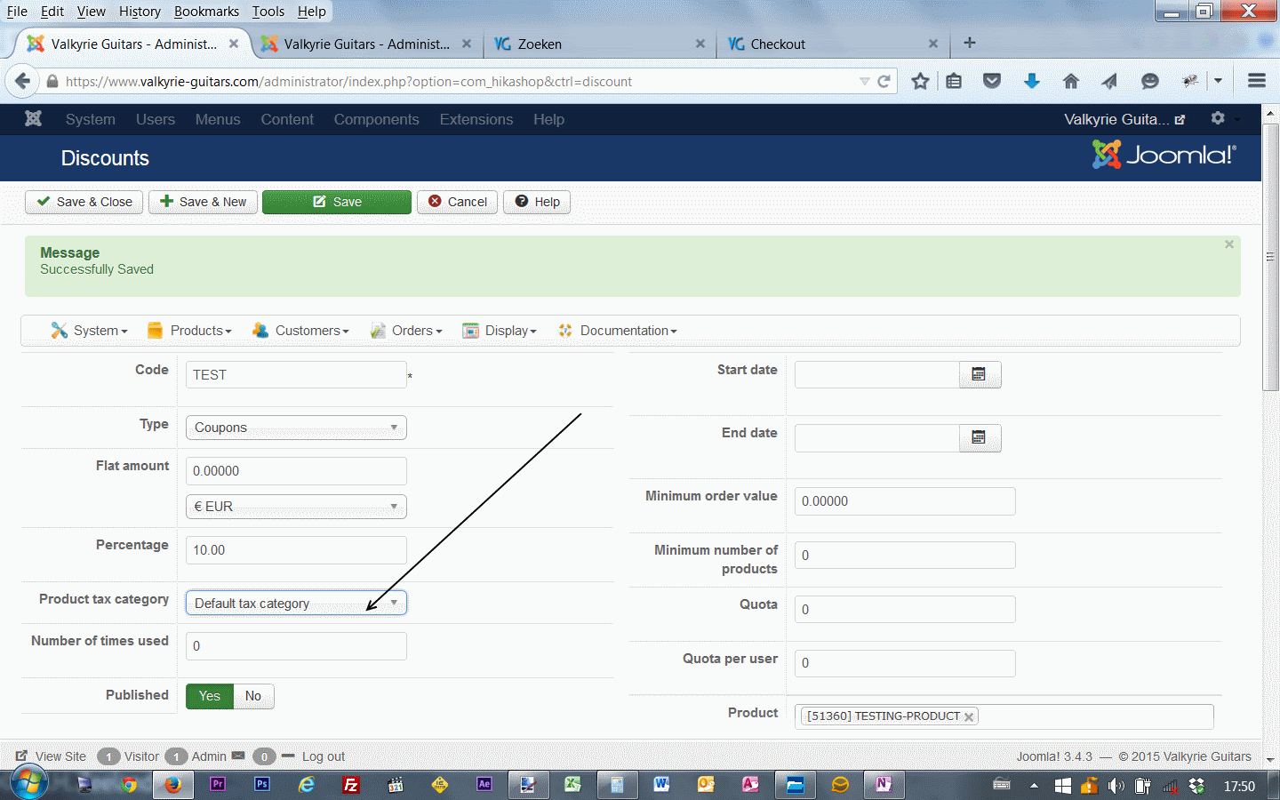

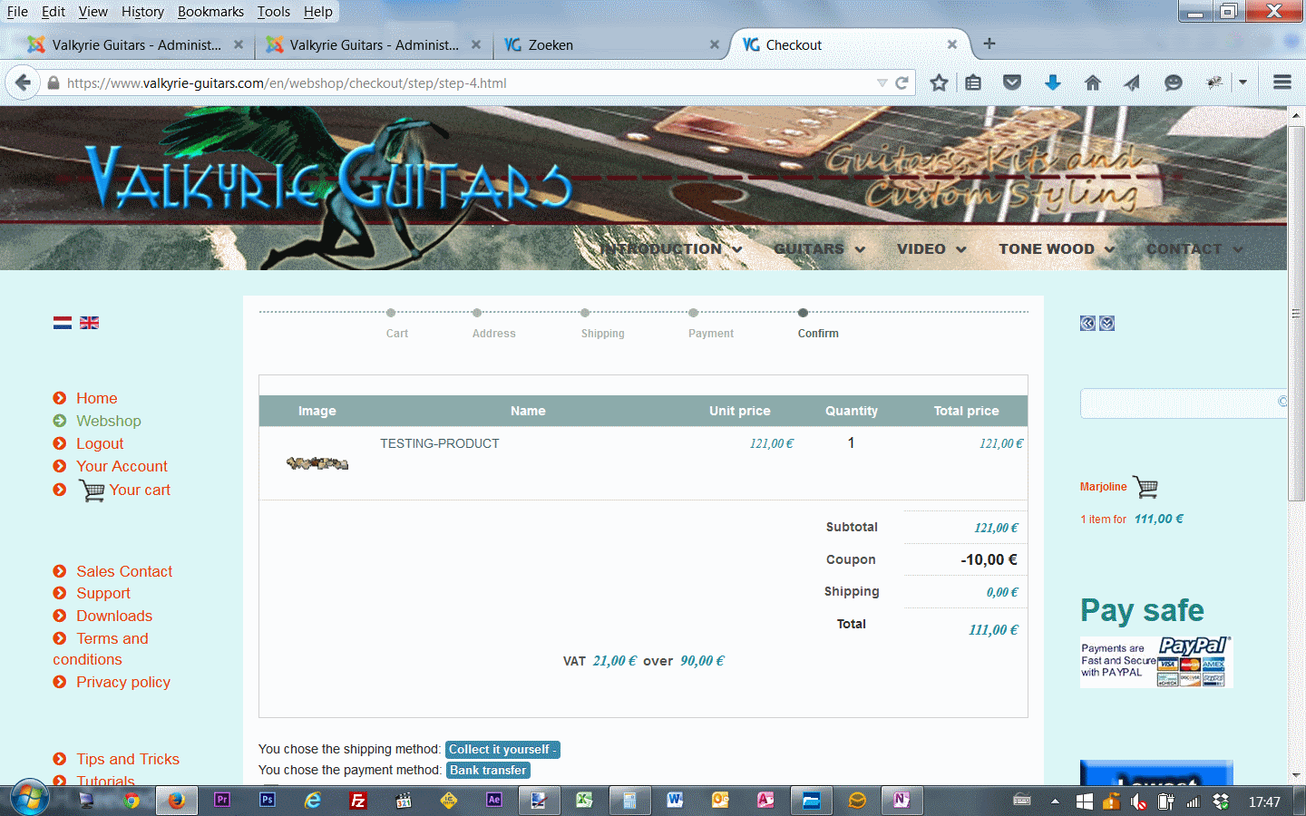

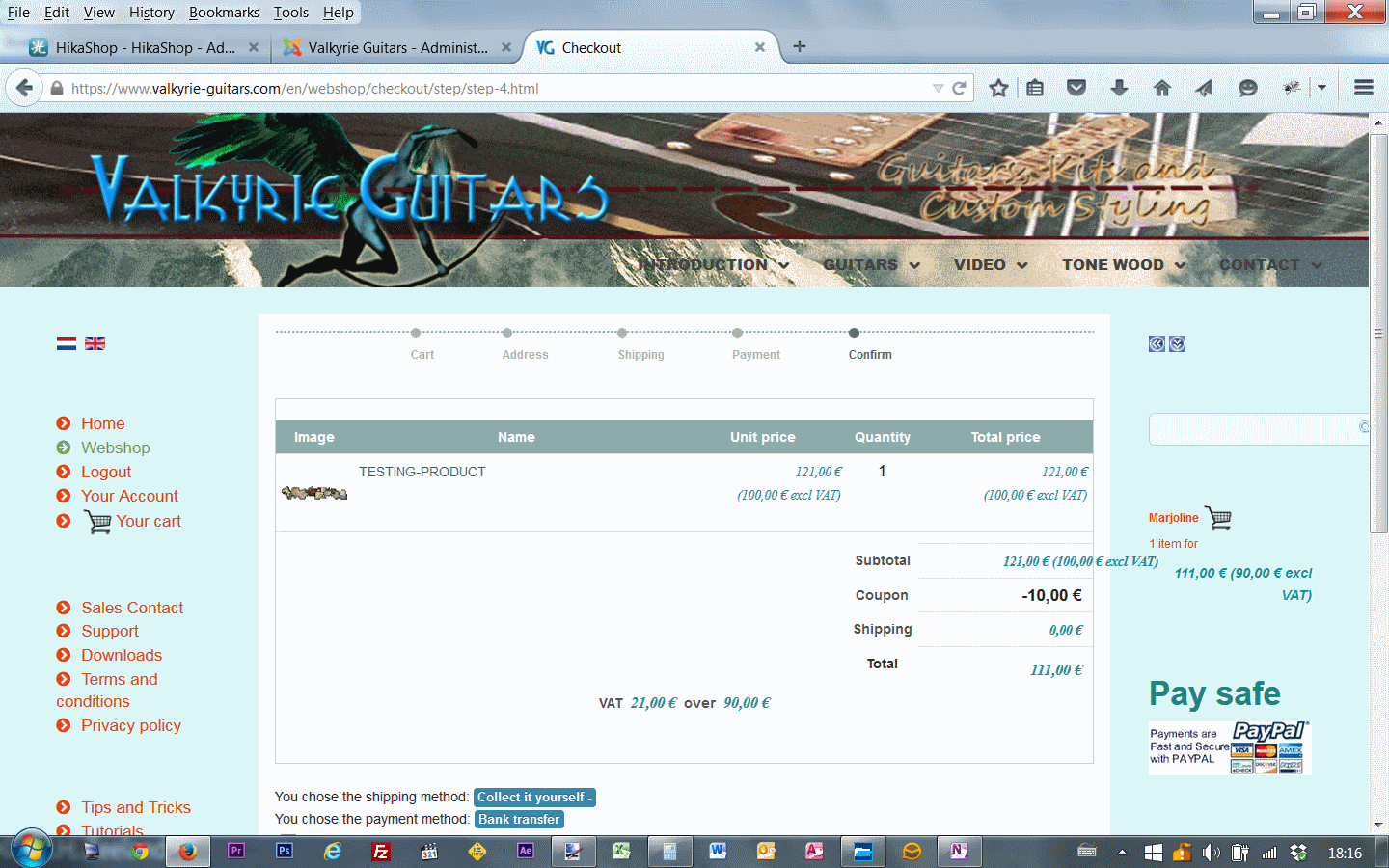

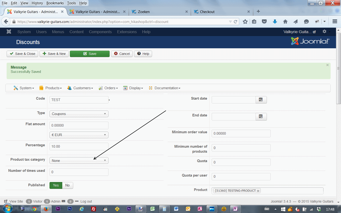

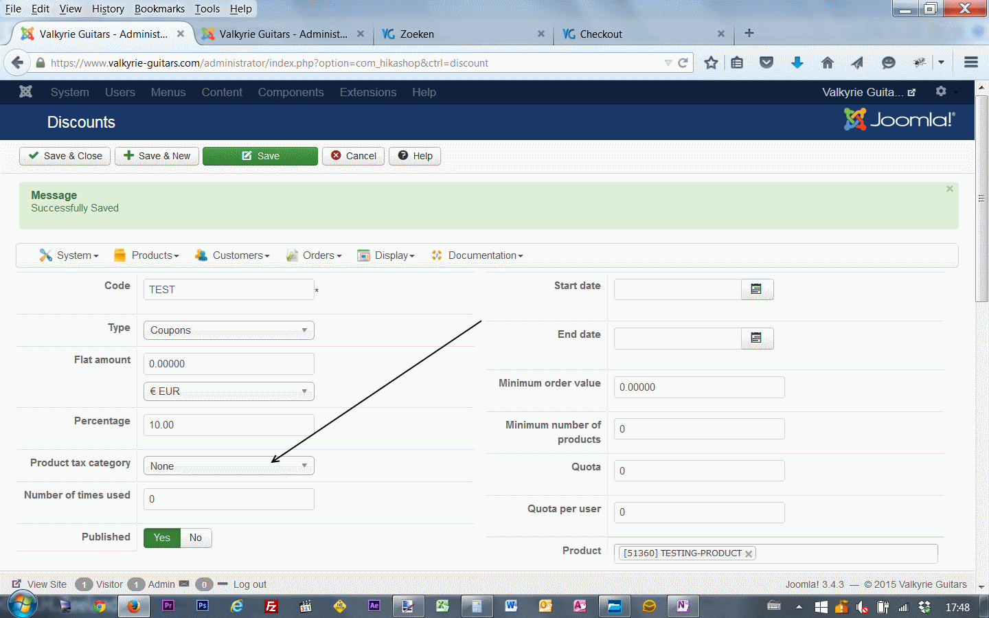

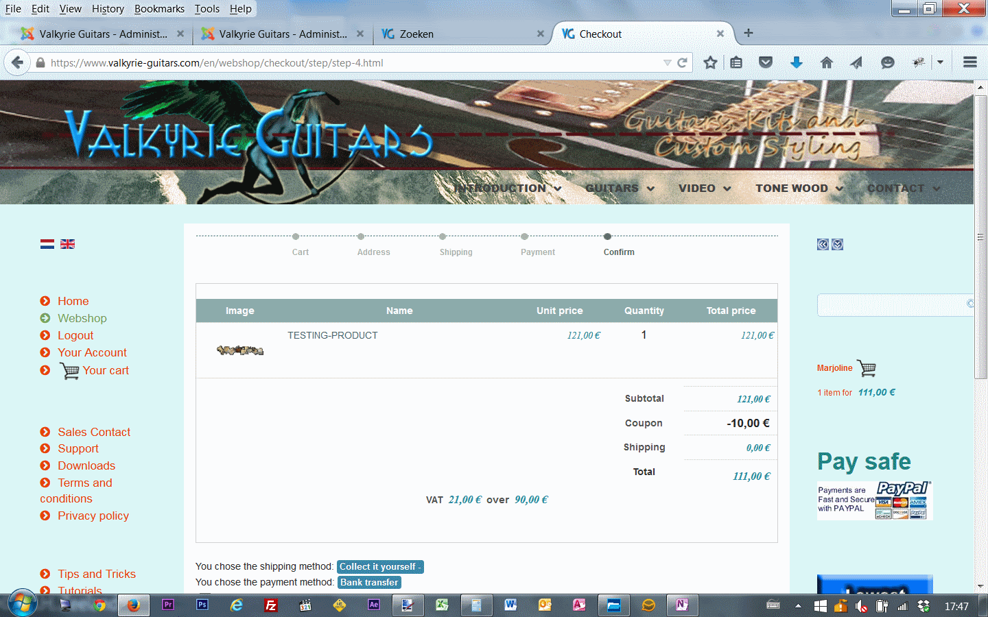

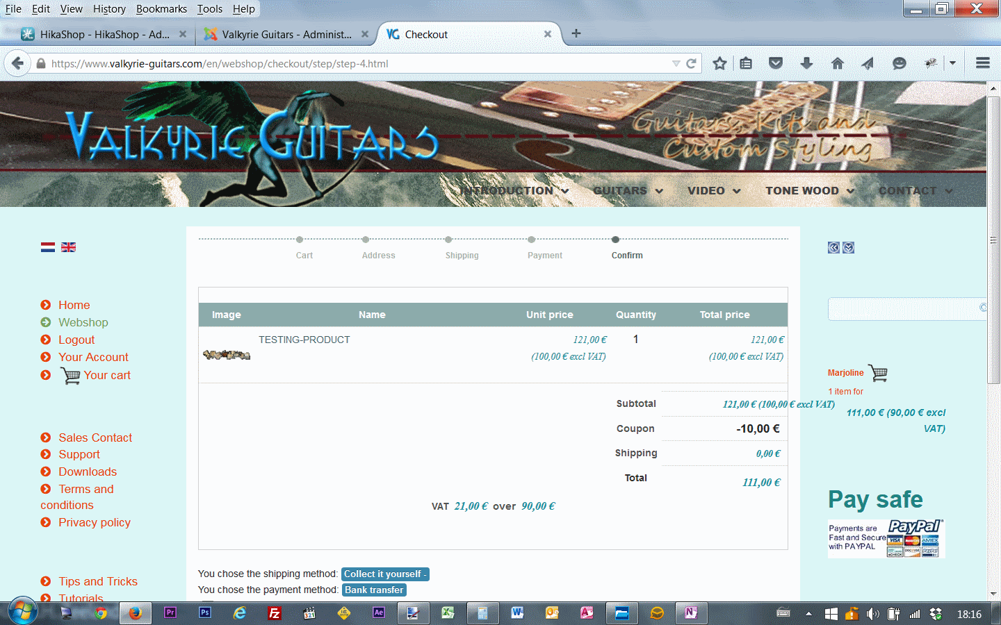

Right now we have discovered however a problem with the tax calculations. Our is set to 21% for the default. This works well without coupons. When someone uses a coupon, the calculation is strange. It presents as a calculation of 21€ of tax on a base of 90€ where the tax percentage is 21%.

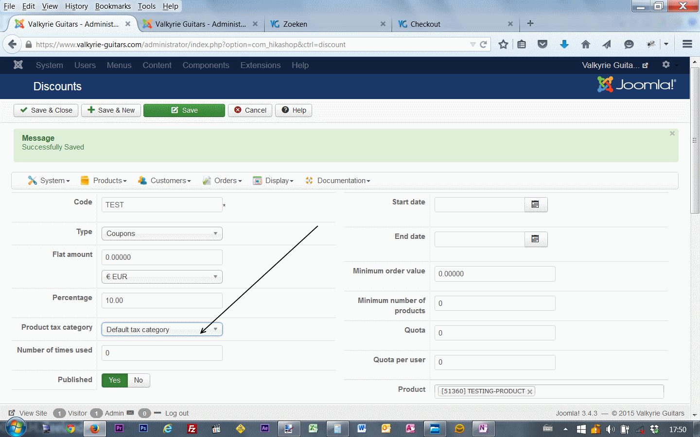

This happens regardless of whether the tax for the coupon is set to "None" or "Default tax category".
See the images attached.
Perhaps somewhere we do not have the right settings, I did see that there had been other questions about this on the forum. And I followed up the advice I found there. It did not resolve the issue.

You want to select the tax category of your coupon, and you also want to change the "apply discount" setting of the HikaShop configuration.

Sorry, but this is a response I have seen given before on this forum. I had already checked this out. But as mentioned above, I found that this happens regardless of whether the tax for the coupon is set to "None" or "Default tax category".
And the calculation should still not be wrong on the front end, this is inexplicable to the customer. 21€ tax on 90€ when the tax rate is 21% is silly, any customer can see that.
It is a 10% discount but regardless whether the discount is before tax or after tax, Hikashop always turns it into a 10€ discount. So 10% of 121€ = 10€ and 10% of 100€ = 10€.

I change the coupon code to use the "default tax category".
And I made a simple test :
pasteboard.co/2gHA9Z6m.png (with default view)
pasteboard.co/2gHMAsNf.png (with your view override)
Prices without tax :
* Product - 100 €
* Coupon (10 %) - 10 €
* Shipping - 7€
Prices with tax :
* Product : 121 €
* Coupon (10 %) - 12.1 €
* Shipping - 8.47 € (7 * 1.21)
Total : 121 - 12.1 + 8.47 = 117.37 €
Taxes : ( 100 - 10 + 7 ) * 21% = 20.37 €
Thus ; about the " over 97 € " which is displayed in your cart. As you probably noticed, that information is not displayed by the original HikaShop view ; it is something that your view override add.
And that information that you display does not include the shipping (97 € = 100 € - 10 €)
Which explained why you think that the VAT is incorrect because you do not include all elements in your processing.
More than that, if your coupon does not have tax ; the taxes will be 21 % of the original price ( 100 € ) because the coupon will remove 10 € but it will not remove taxes.
To conclude, I didn't see any problem with the HikaShop processing but your view override does not display the most appropriate value for the "over ..." because it does not include the shipping and it also include the discount provided by coupon without vat.
So, if you really want to display that information, I suggest you to not look for a value in the HikaShop variables, but to process it or to deduce it from the VAT value.
