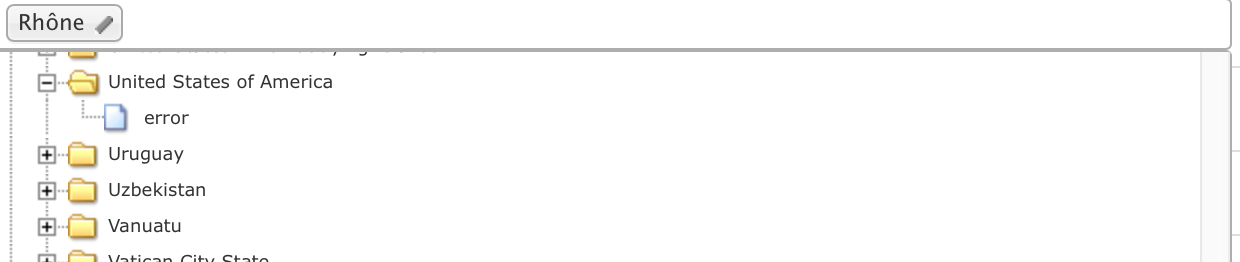

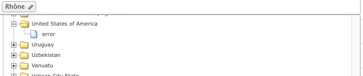

10 years 2 months ago #240065
When I click on any of the country's zone for example: United States, the folder opens but with an error. It doesn't show the complete list of the states. It is showing error

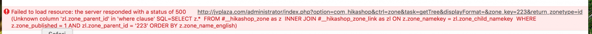

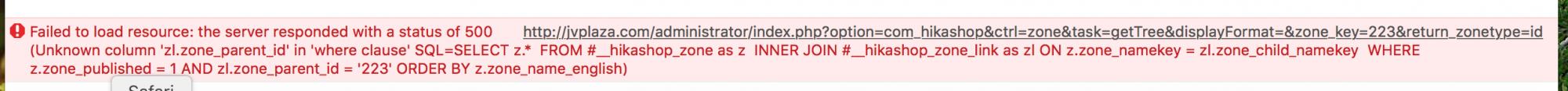

  • Posts: 8
10 years 2 months ago #240383
This is what I got. I don't
know if this is what you meant. I attached the image

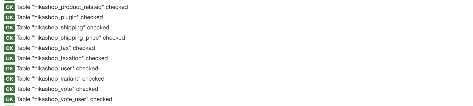

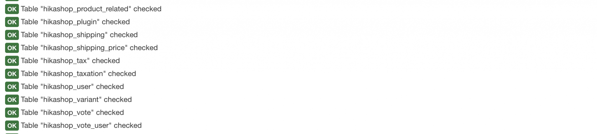

10 years 2 months ago #240414
Can you :
- Go to the page "Hikashop->System->Configuration"
- Click on the "Check database" button
And then try it again to see if that solved your issue ?
Thanks.
  • Posts: 8
10 years 2 months ago #240476
still have the same problem :pinch:

I checked the current code and we do not have any(more) "zl.zone_parent_id" in HikaShop.
