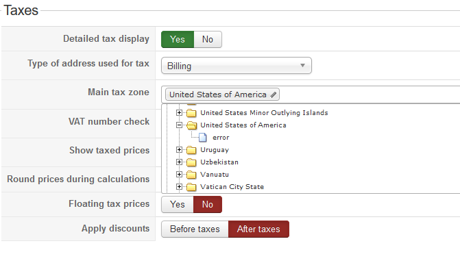

Hello, I am selling goods worldwide and need to set up 10% tax for Australia only. So, site must work in a following way - all users sees prices with tax, but then if user do not select Australia as a country at checkout - tax will be excluded from the order price.
I set up tax 10% and it is working correct when I set this tax for all countries, but when I set restriction (Australia) - all prices becomes without tax until the moment when user enters his country. I've tried to set default country by setting default value for country field, but this didn't help. Could you please help me?

You have to set the option "Main tax zone" in Configuration > Main > Taxes to "Australia".

I can not select the state

Type a few letters of the state in the input box and it should display the name of the state in the dropdown below so that you can directly select it.
