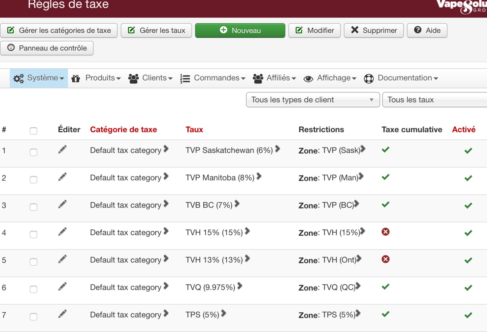

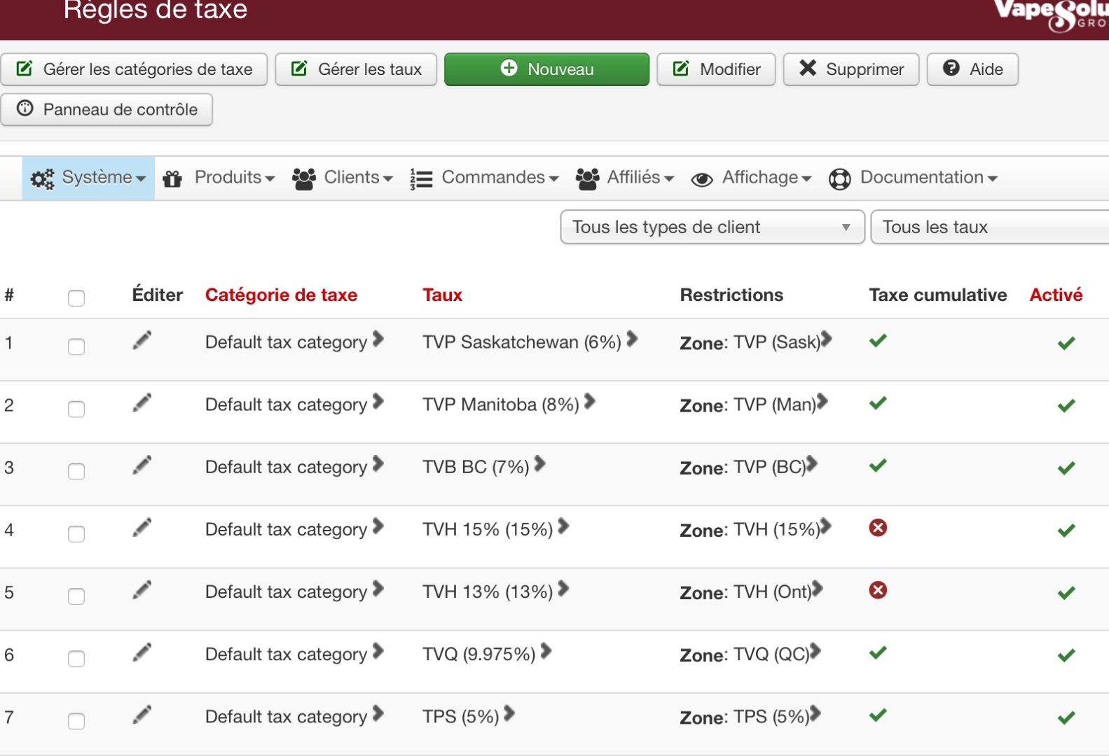

10 years 2 months ago #242021
Make sure that you have the "cumulative" setting turned on on both your tax rules. Otherwise, only one tax can be applied at a time.

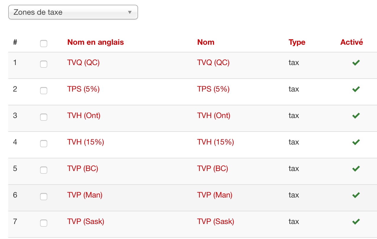

Hi Danny this is the setting i'm using for our store hope it will help you a bit
So we've used those setting to implement those hellish little Canadian money grabbers :-)

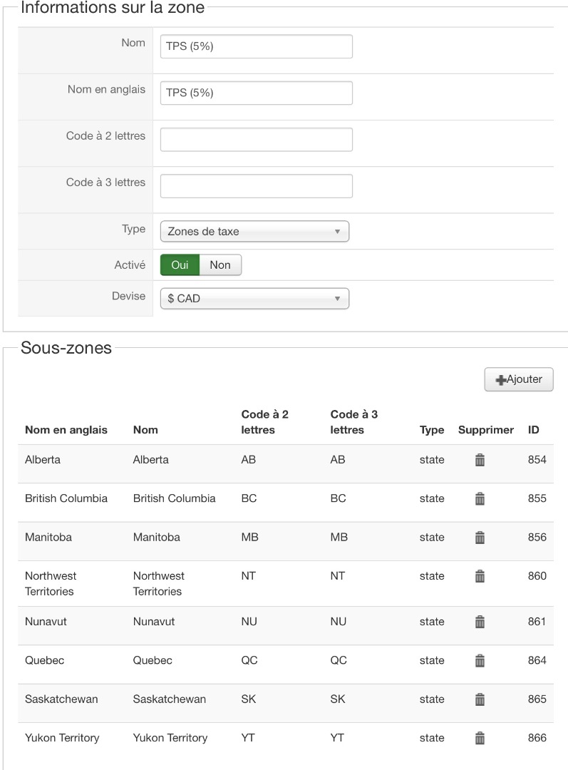

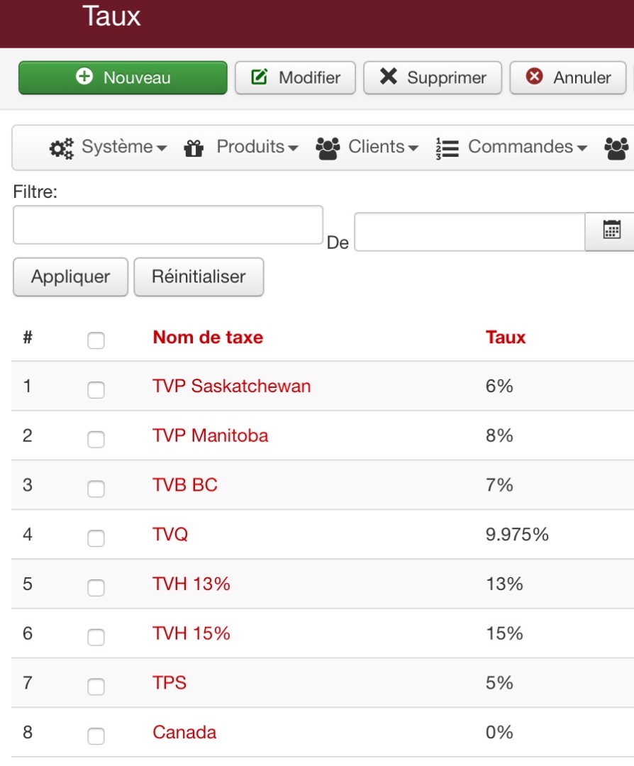

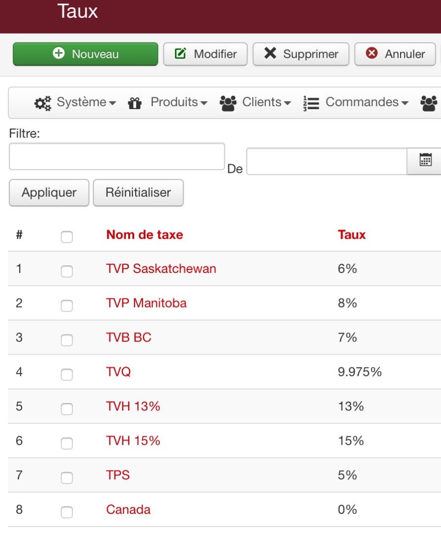

Step 1
Create the the taxes rate (Always start by GST then the other ones)
system > taxes > Manage rates (see image tax-rate) (Save first then creat sub zone(s))

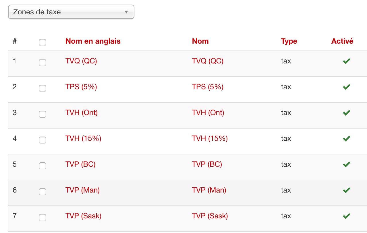

Step 2

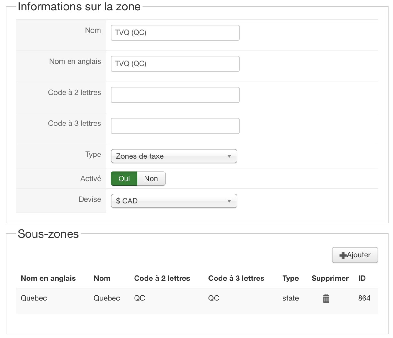

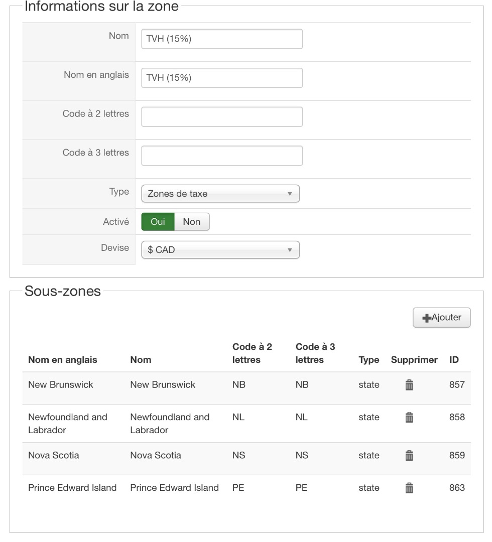

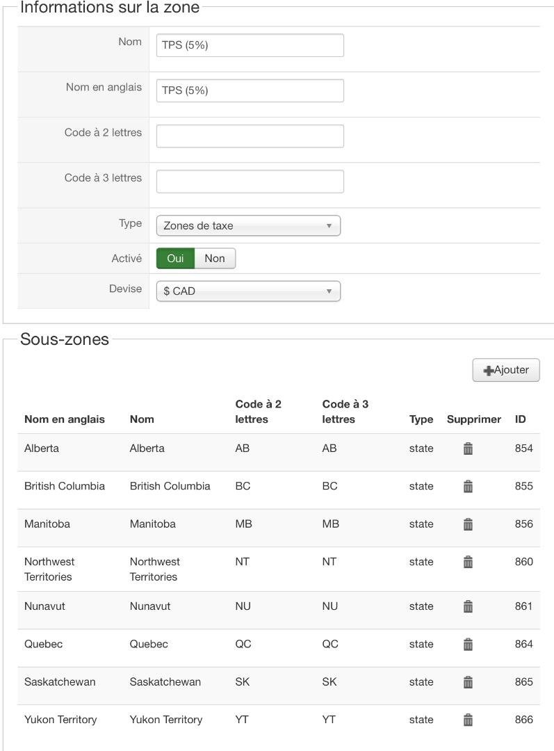

create all the zones
system > taxes > Tax Zone (see image tax zone)

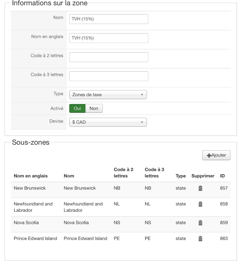

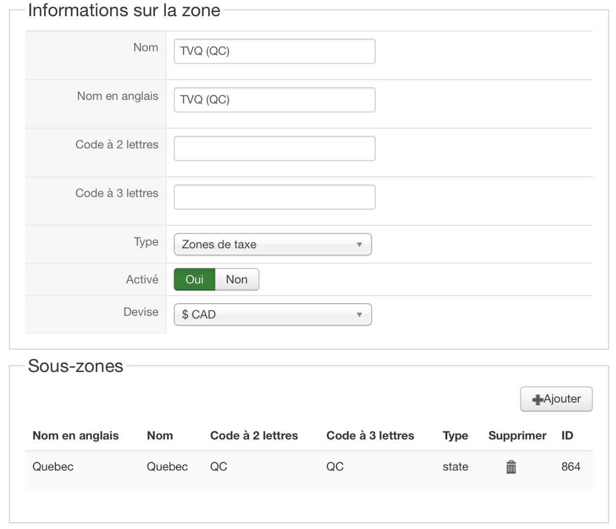

2.b
create the subzone here a few example (and remind Ontario his 13% not 15%)
Step 3
Create the taxes rules (Always first create GST then the other ones)
system > taxes > + new (see image Taxes-rules)
