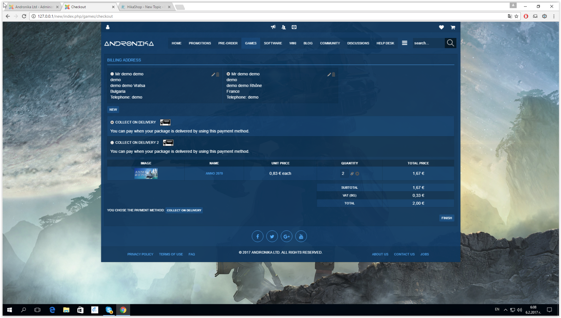

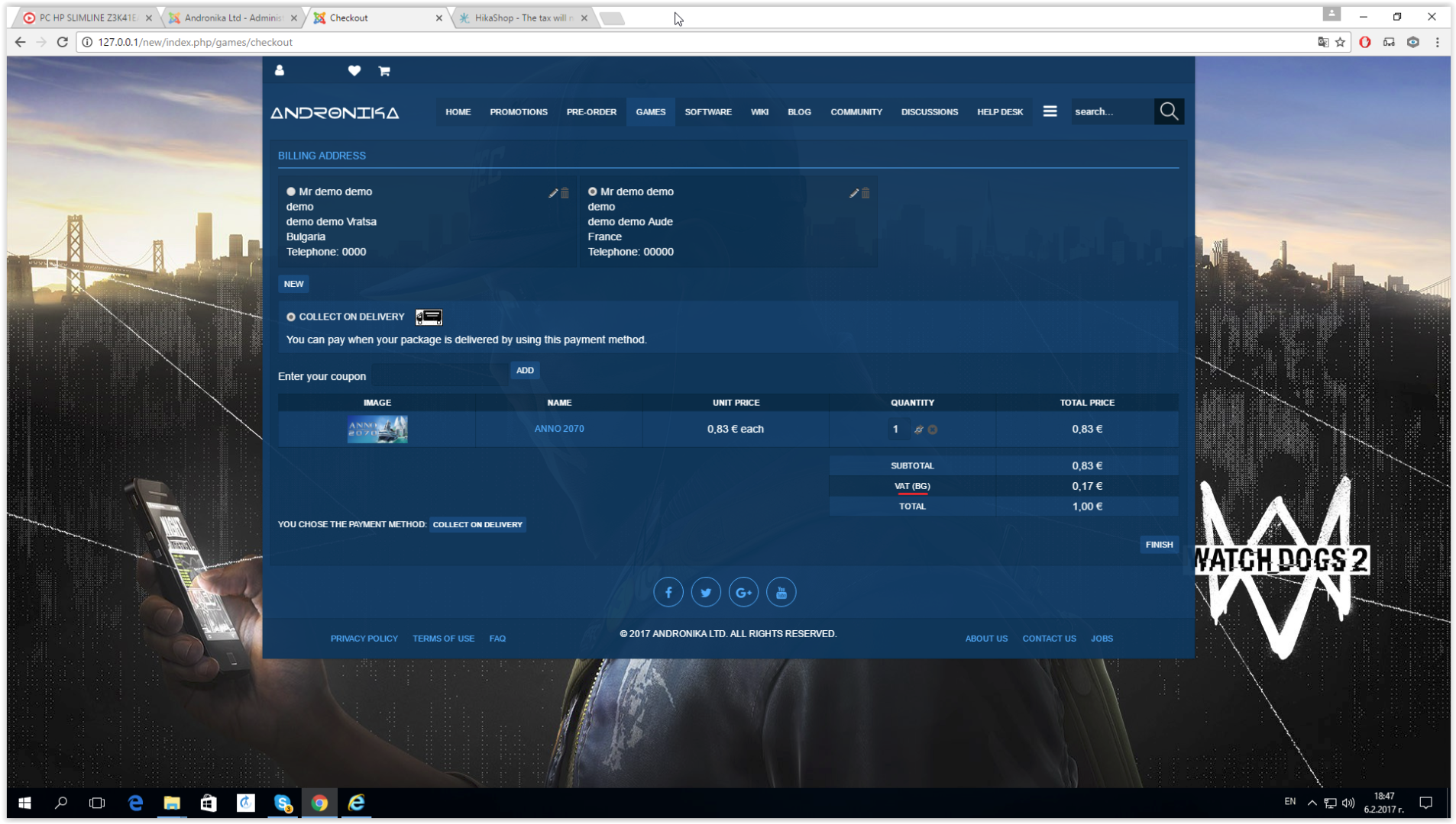

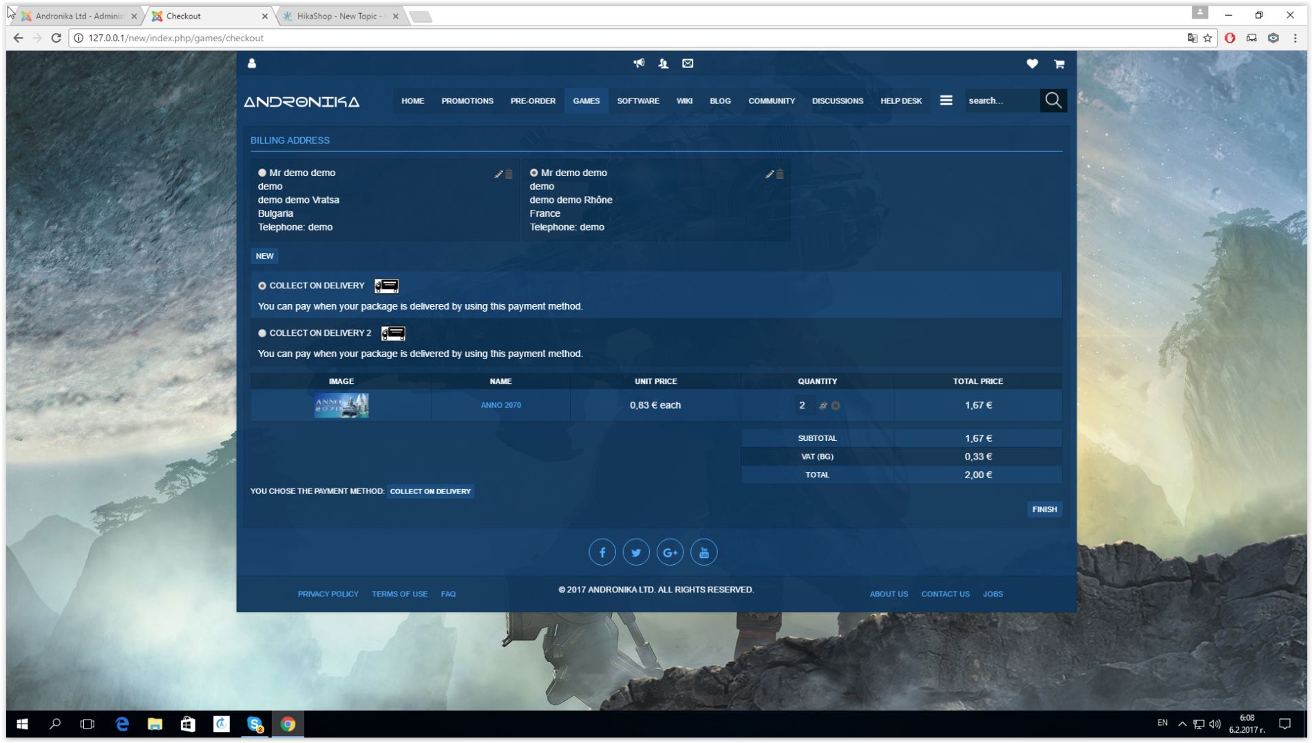

Hi, I found a little problem with the tax. The scenario is this: if a customer has two addresses, one in Bulgaria and one in France - if the default address is in Bulgaria and then select another address in France the tax will not be updated.

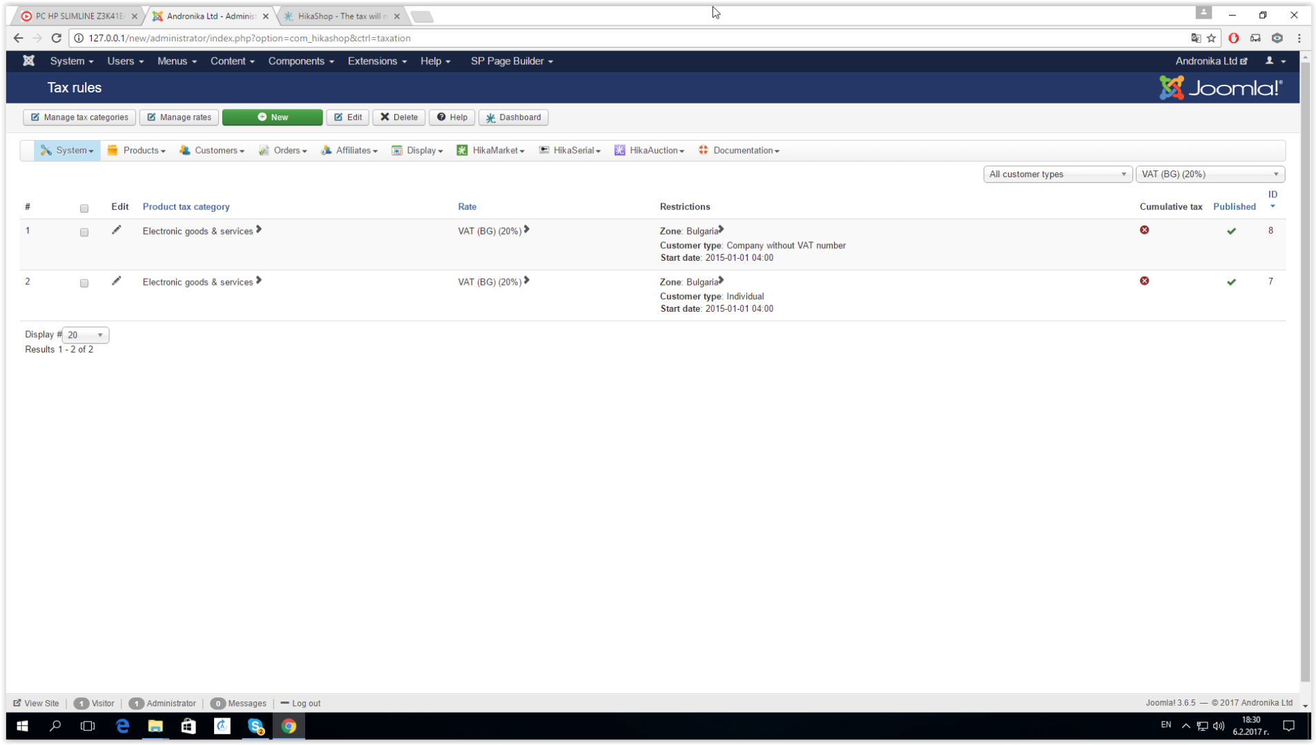

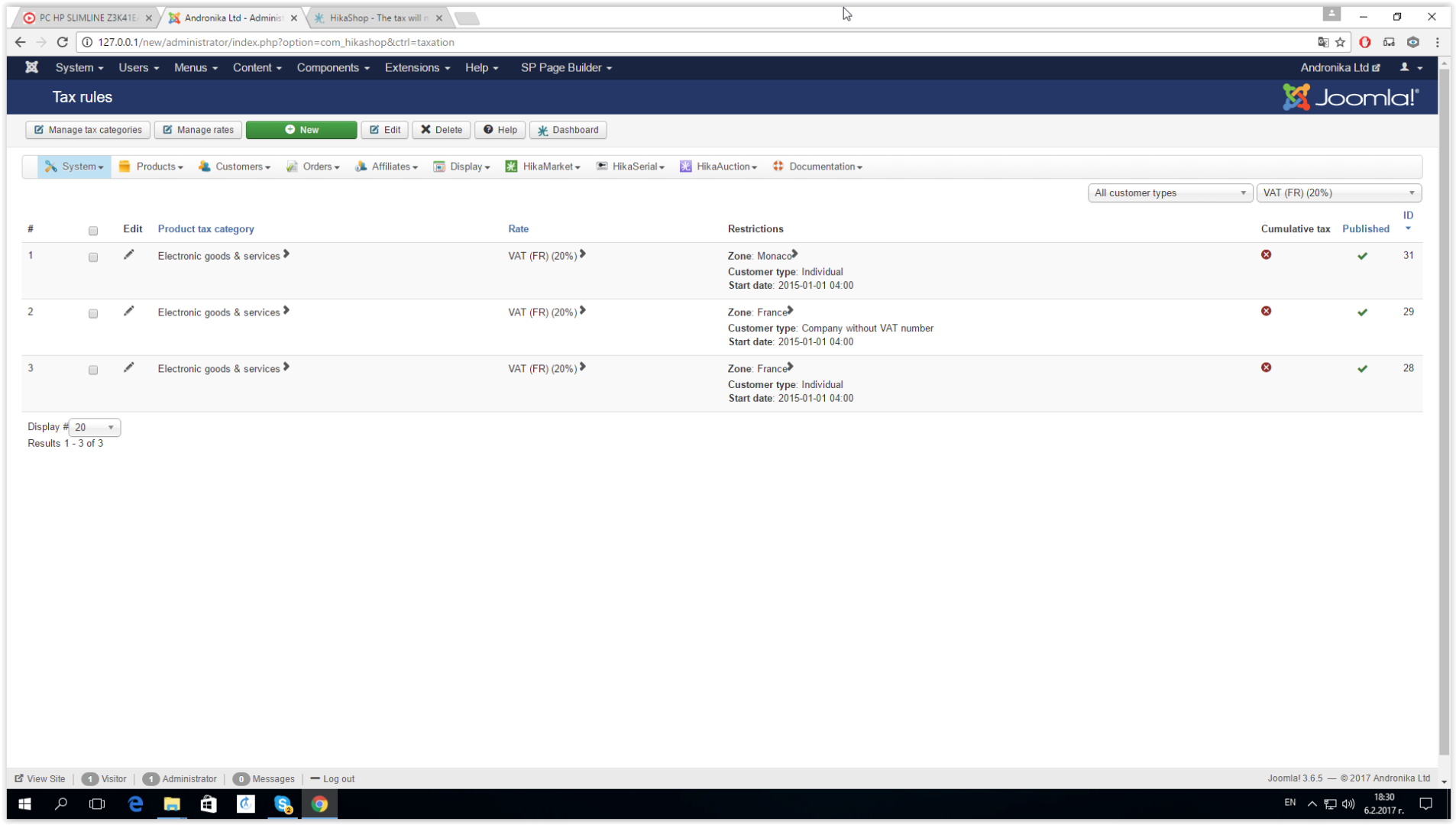

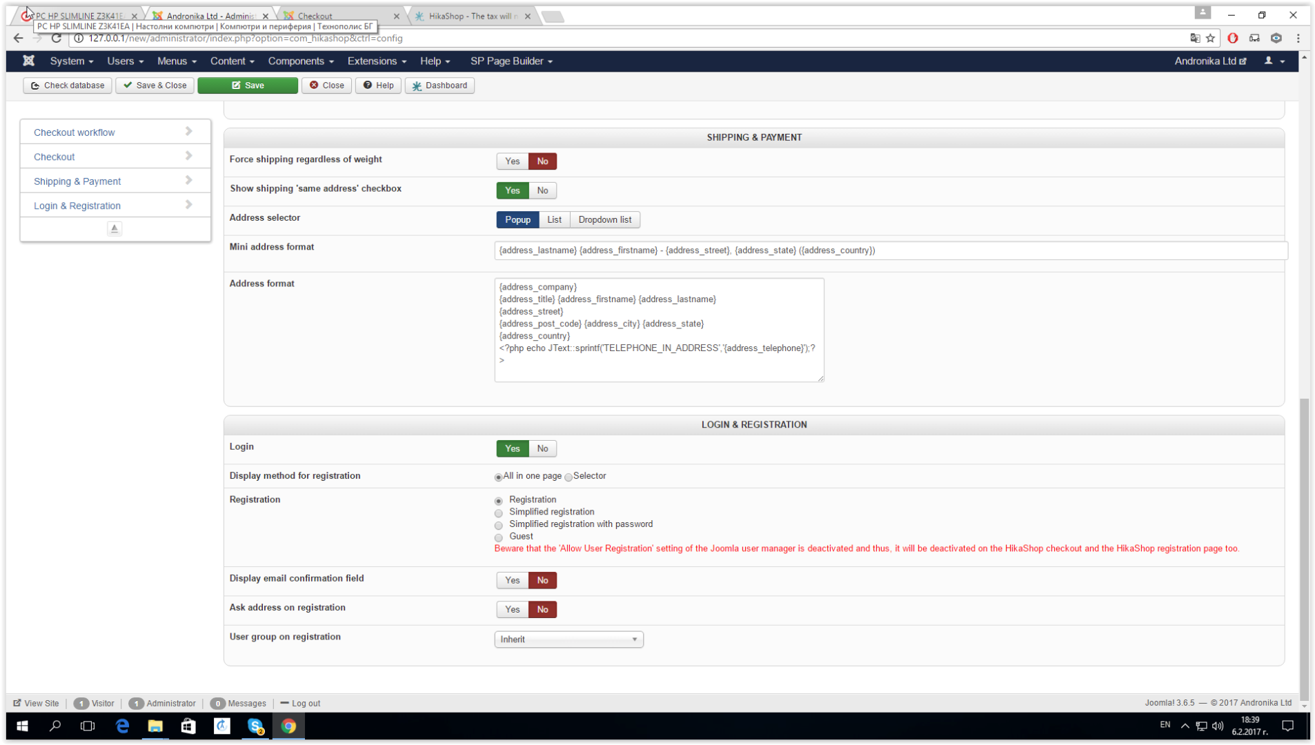

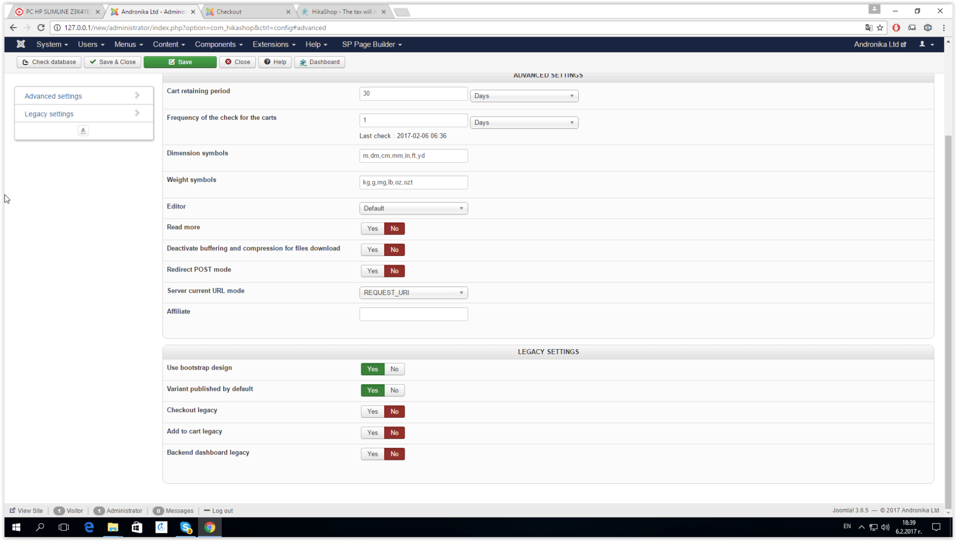

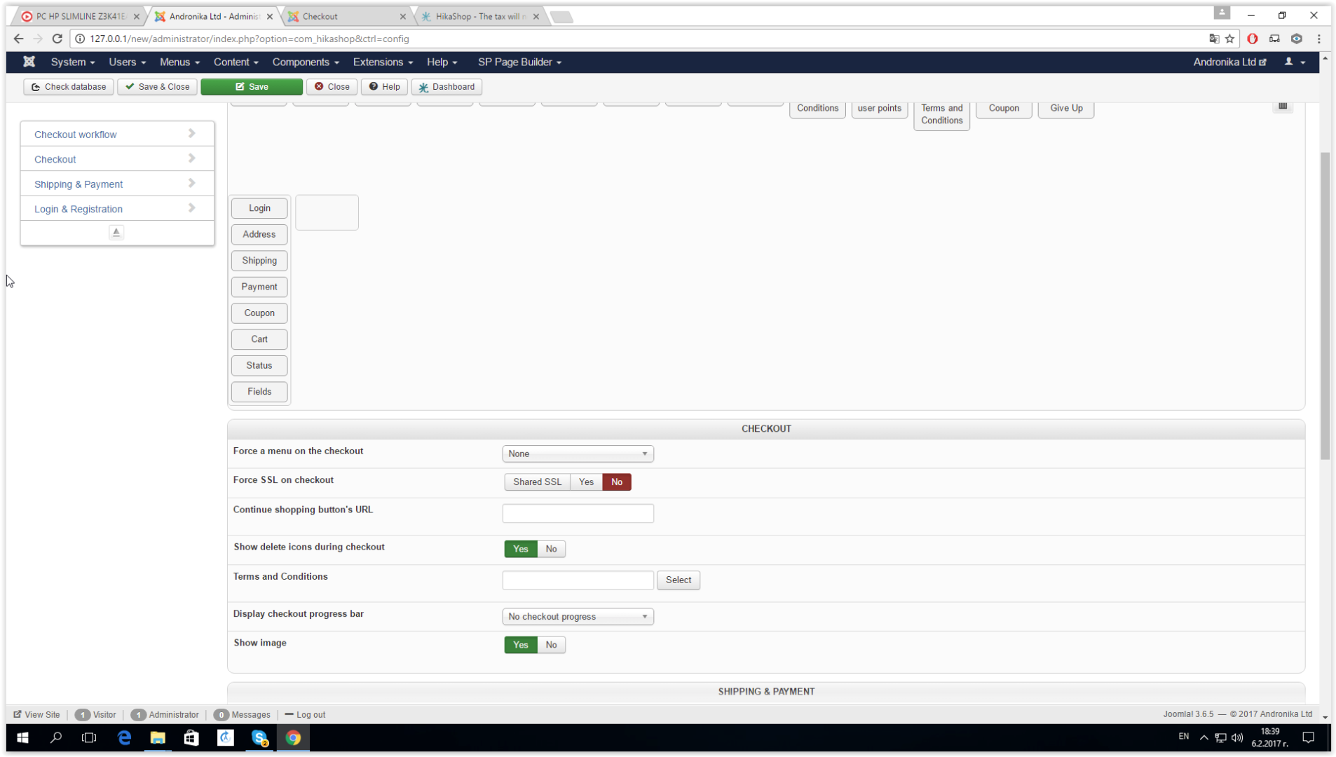

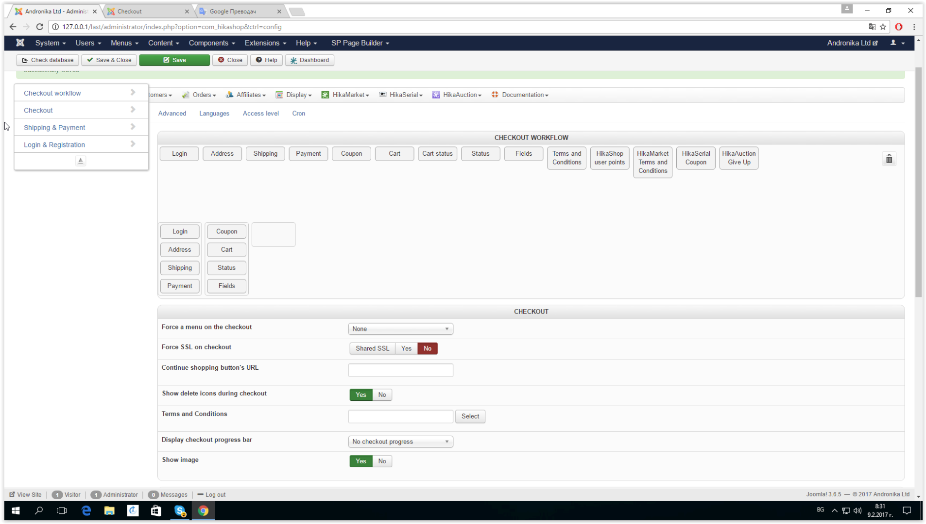

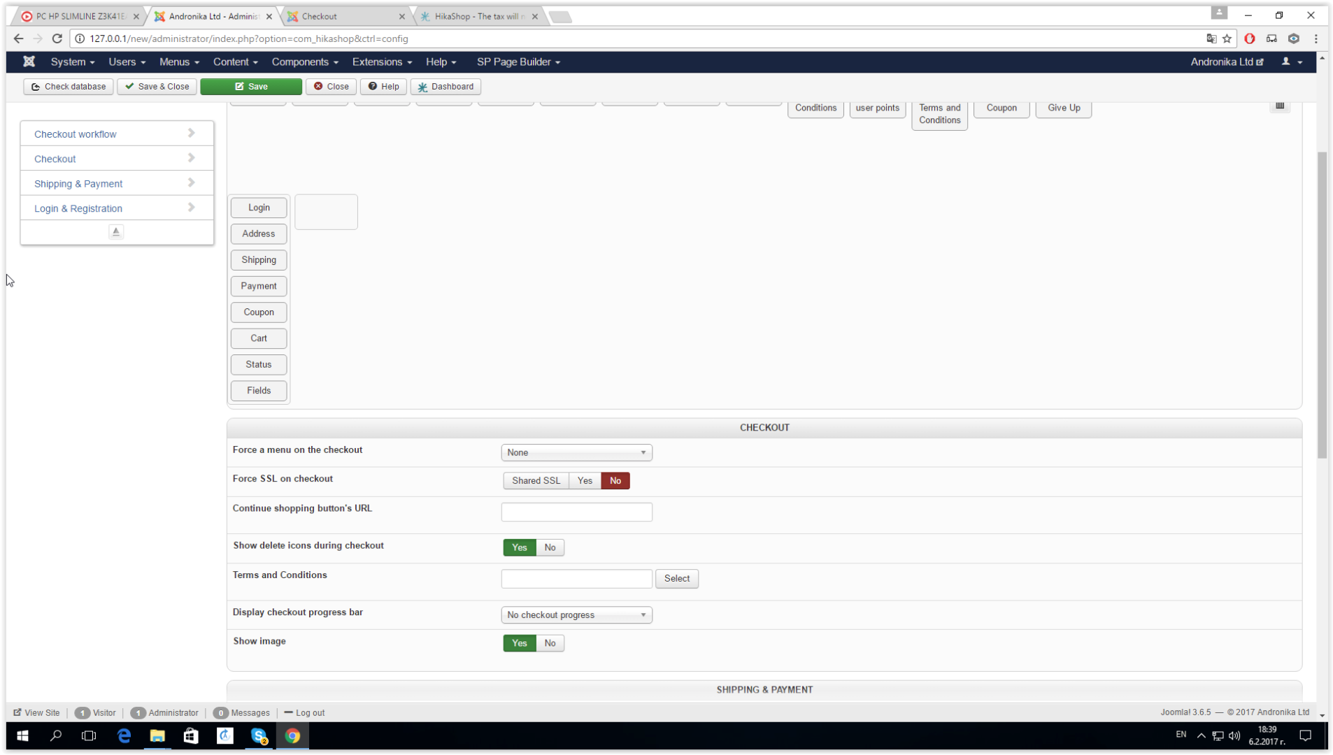

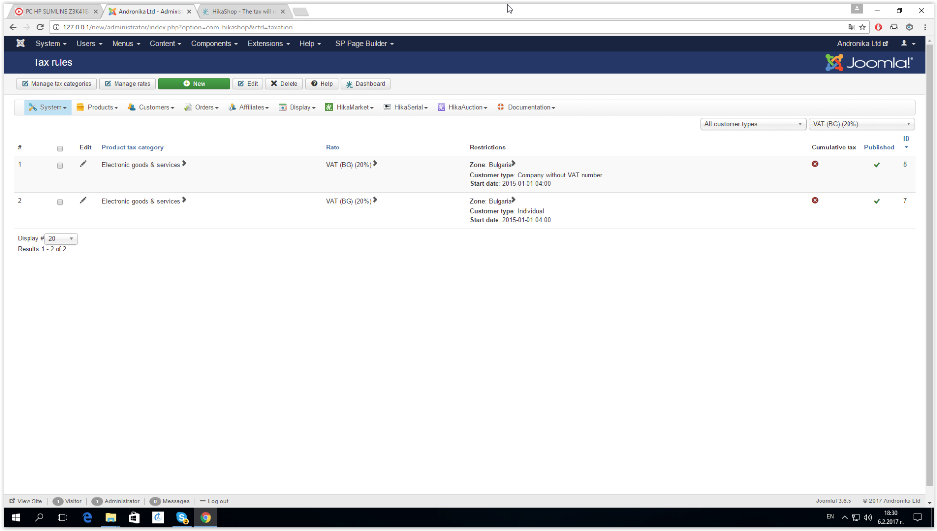

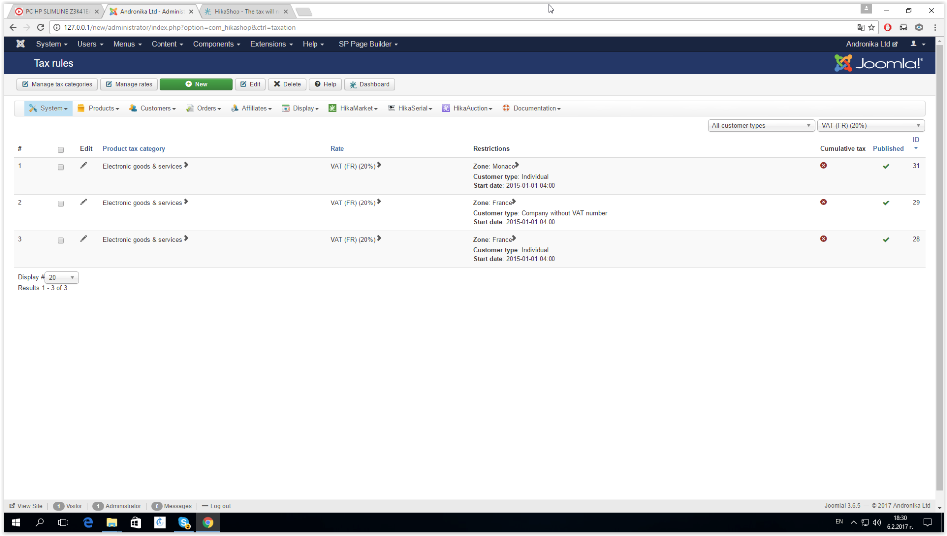

I'm not able to reproduce the problem on my end.

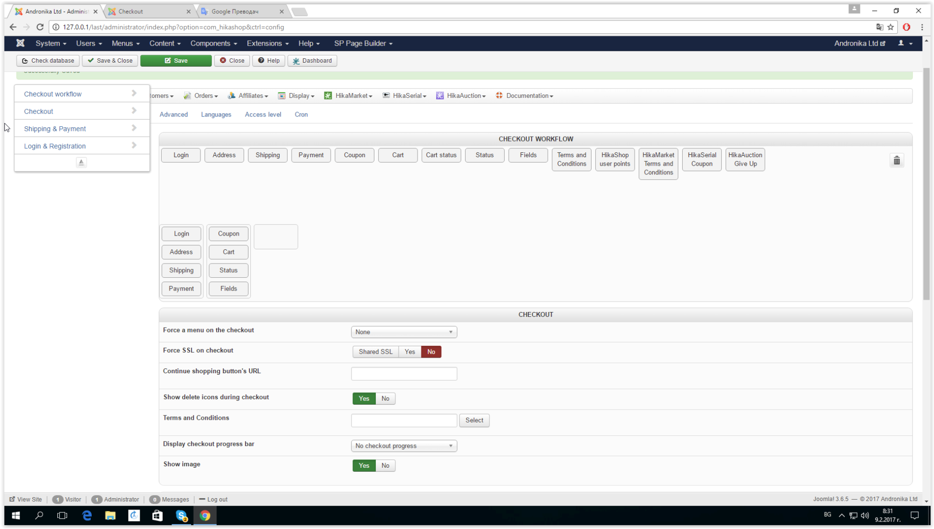

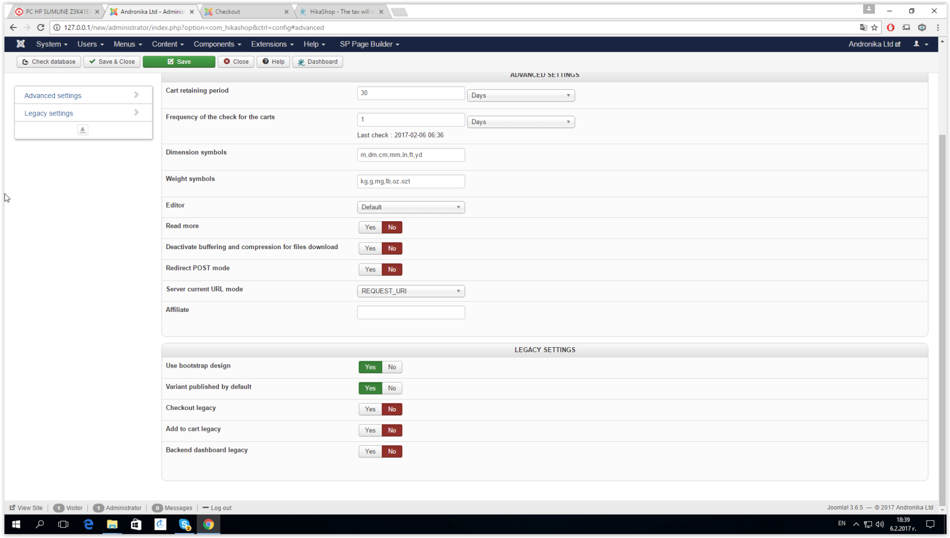

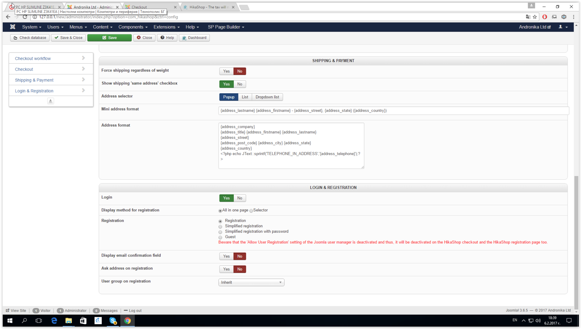

Could you provide a screenshot of your tax rules and a screenshot of your checkout tab and advanced tabs settings from the HikaShop configuration so that we can get a clear picture of the situation and try to reproduce it ?

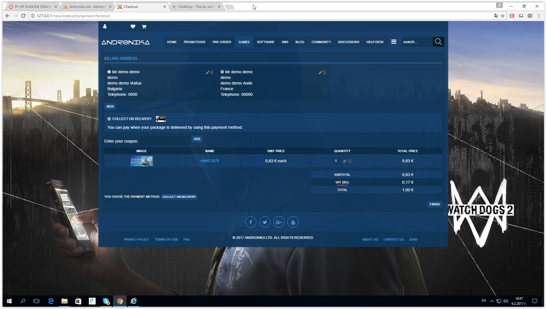

Hi I can confirm that it works correctly. But I have to refresh the page to display the correct VAT.

When you switch the address in France, will actually charge the French VAT, as it should be, although it appears that Bulgarian VAT. If you refresh the page shows what should be (French VAT). In case this is not a bug just not displayed properly VAT which will be accrued if the page is not refreshed.

You have to provide more elements in order to better understand the situation, in your specific case can you provide :
- Your HikaShop version (and build) and same thing for Joomla.
- Your tax rules configuration screenshot
- If possible a Url link to process some tests.
Awaiting news from you.

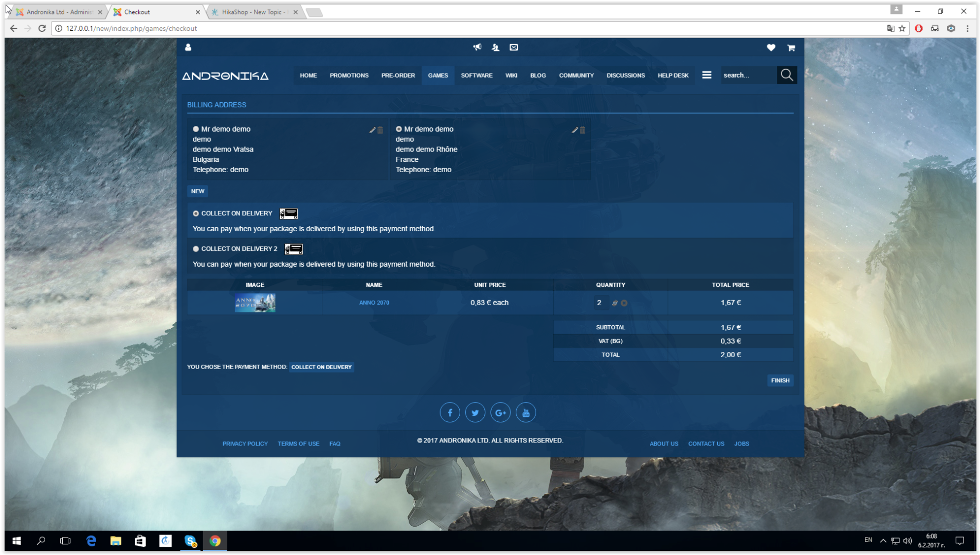

9 years 6 months ago #261761
I did it in two steps and the problem is solved.
