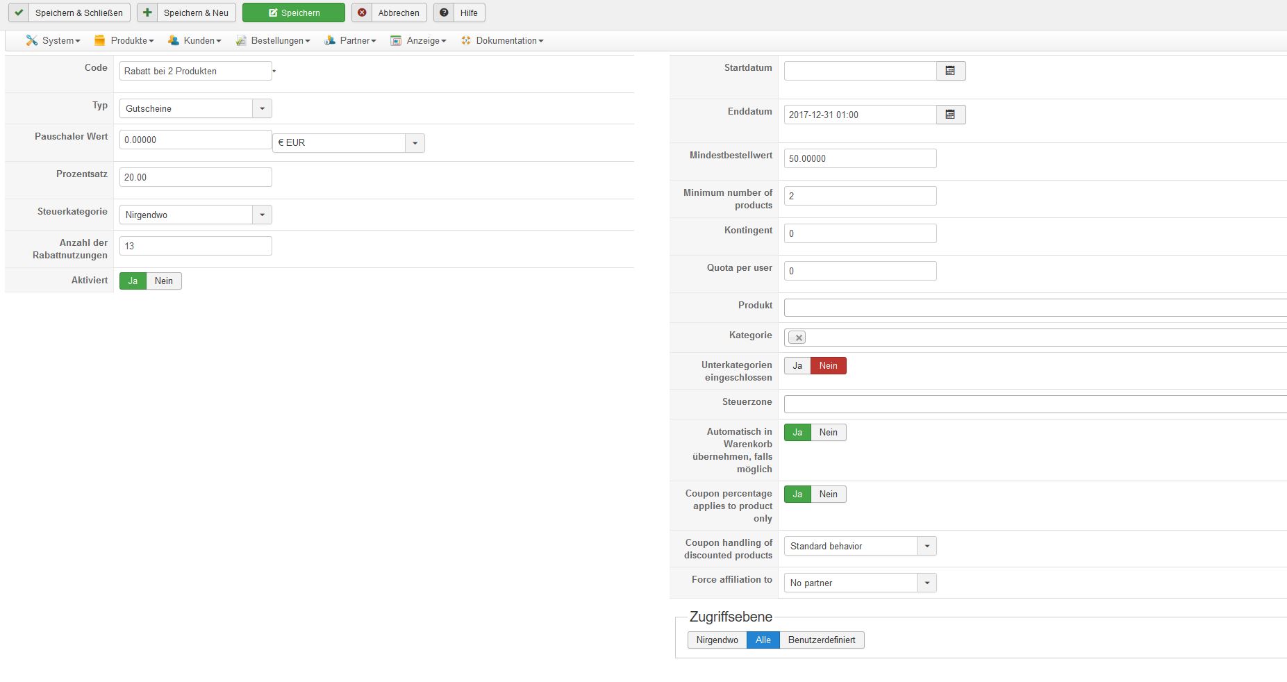

Below are the screenshots:

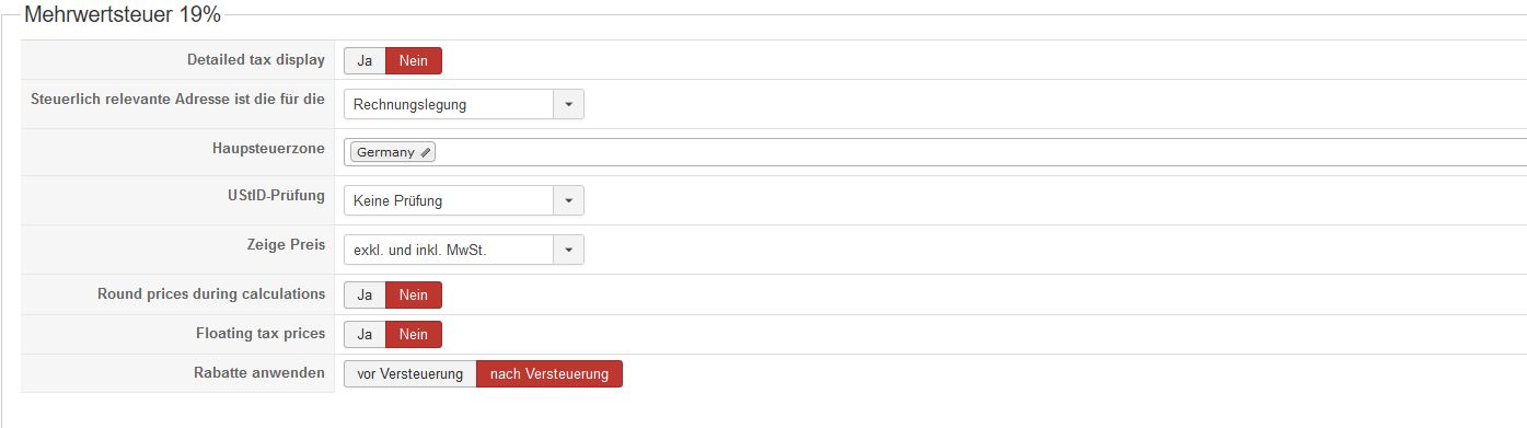

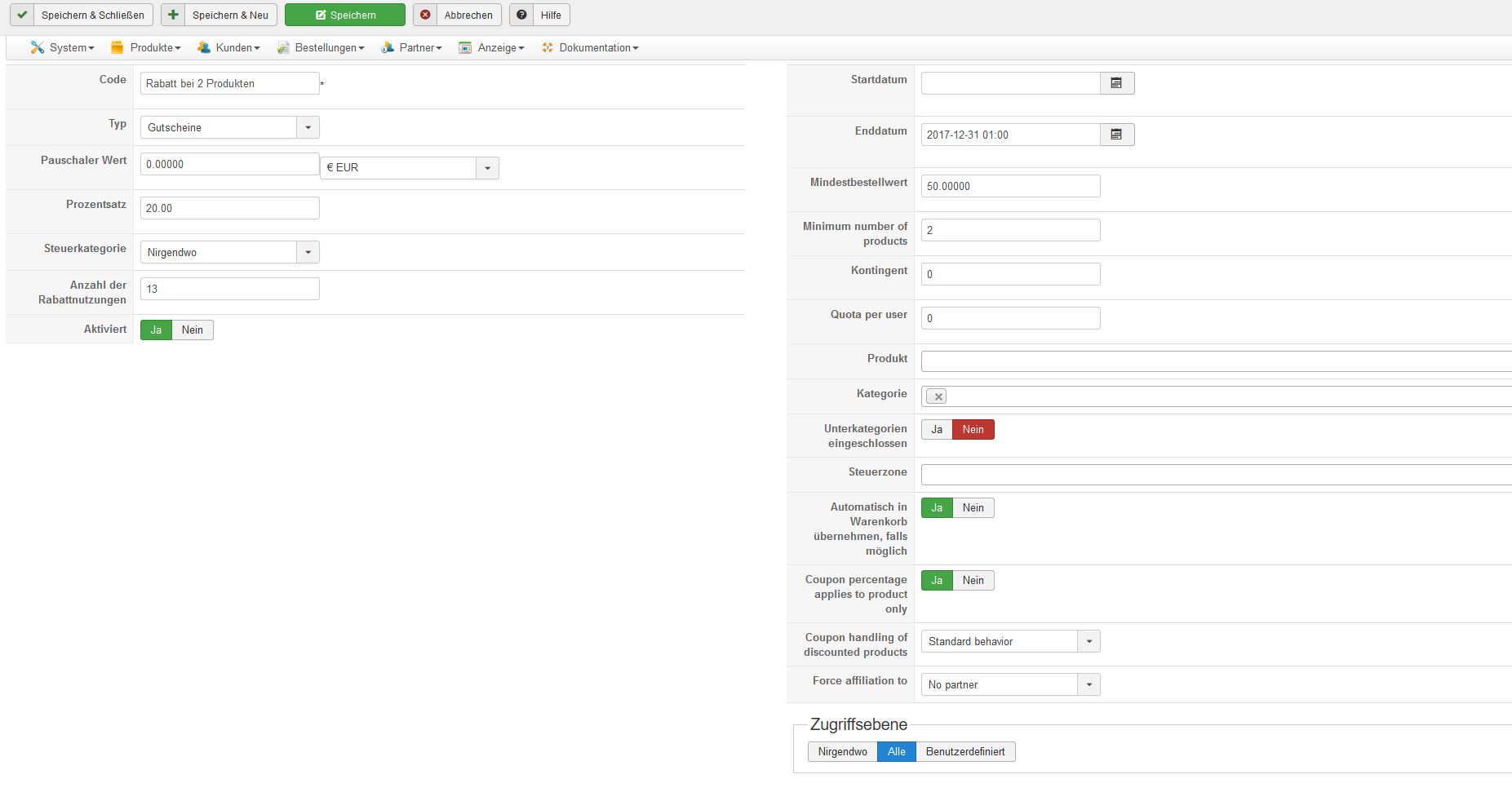

Settings coupon:

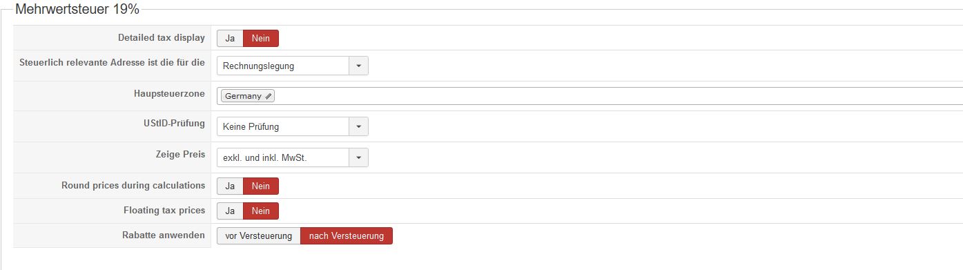

Taxes main configuration:

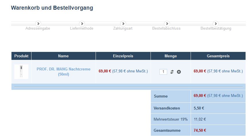

Cart result without coupon:

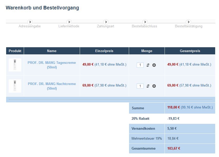

Cart result with coupon:

8 years 9 months ago #283310
Thanks to your elements, I process several calculation and you right it's seems that their something that went wrong.
Unfortunately I'm unable to understand from where come the error... And your settings seems corrects.
But you have to know that we add several improvement specific on Total cart calculation.
And so, can you try to update on a clone/test website in order to see if that solve your issue.
Awaiting news from you.
Last edit: 8 years 9 months ago by Philip.
