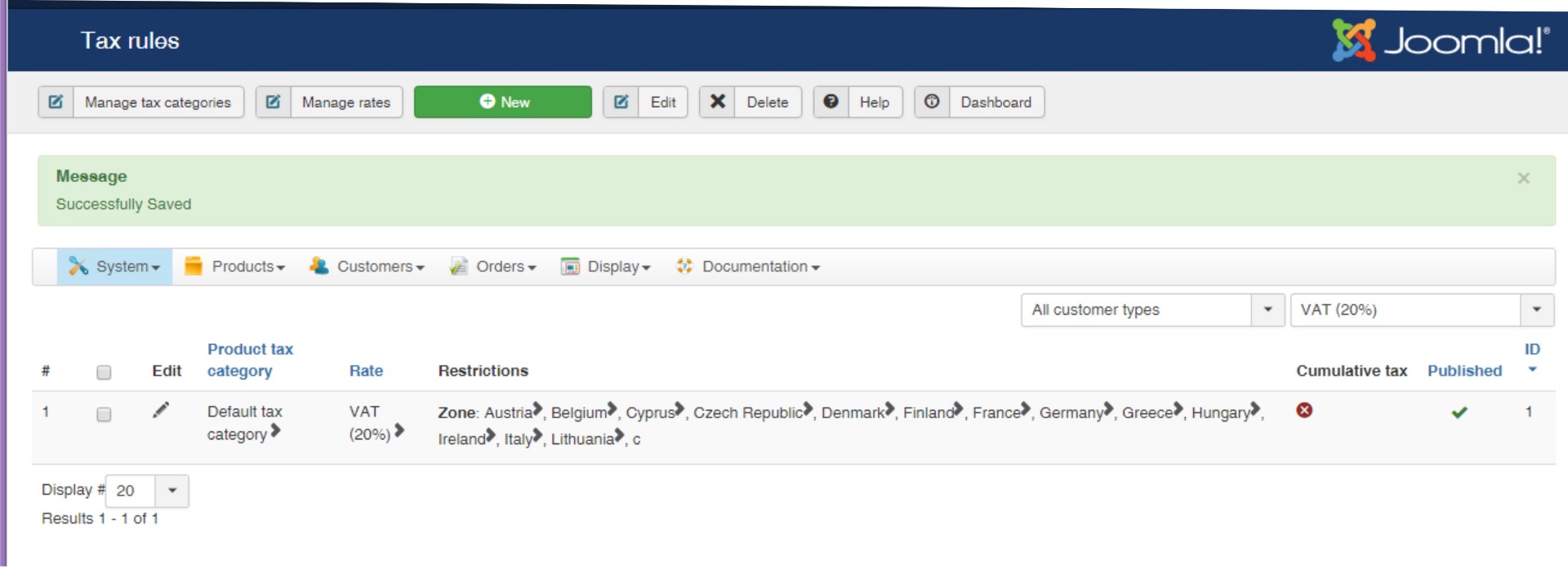

Thank you. My test account has a United States billing and shipping address. It is still coming up with tax included. Here is the screen shot of my tax rule - I was using the tax group Europe, then also tried this method, including each country from the tax group
  • Posts: 94
8 years 7 months ago #287004
Actually, I've changed it back to the full Europe tax zone, as the individuals didn't seem to work correctly!
