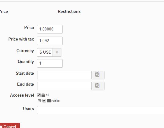

I am not sure how to fix this. Sales tax is 9.2%. When the item is added to the cart and checking out, the tax is not correct. I'm showing screenshots.

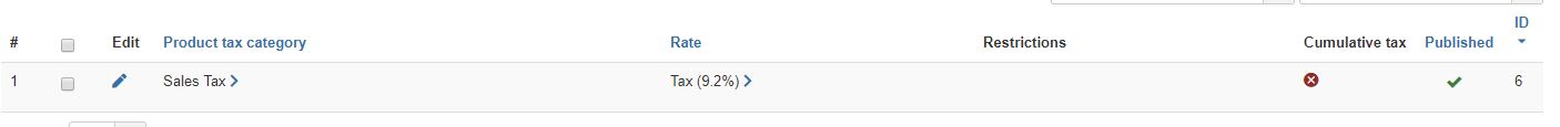

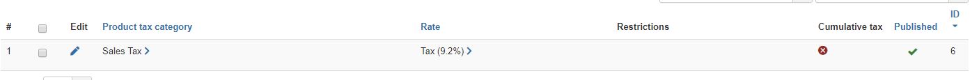

The tax screen is showing 9.2%.

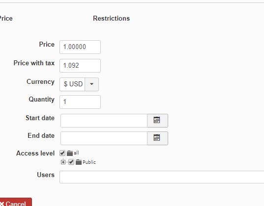

The item price is showing $1 for the item making the price with tax $1.092

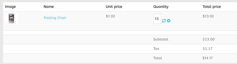

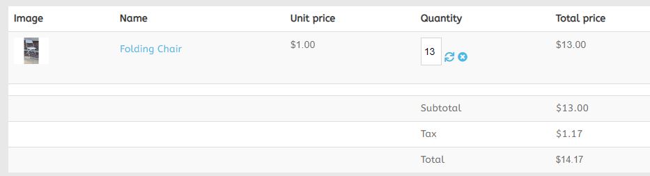

This customer added 13 chairs to the cart and it shows $1.17 tax, but it should be $1.20
How do I fix this?

It's not incorrect. It's just another convention on how to calculate the taxes. For online shops, it's common to calculate taxes like that. And accounting software usually calculate the taxes like you want.
I suppose that you have the "round prices during calculations" setting activated in the Hikashop configuration.
And so, the taxes are calculated per item, then rounded, and then the taxes are summed for all the products.
So it goes like that:
tax for one product: 1 * .092 = 0.092 -> rounded to 0.09
tax for all the order: 0.09 * 13 = 1.17
If you don't want that, then you want to turn off the "round prices during calculations" setting.
