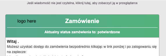

3 years 8 months ago - 3 years 8 months ago #349899 by StudioPrzyLesie
override works - thank you.
Logo
I have a record in the template
Code:
?><table class="w600" border="0" cellspacing="0" cellpadding="0" width="600" style="margin:0px;font-family: Arial, Helvetica, sans-serif;font-size:12px;line-height:18px;"> <tr> <td class="w20" width="20"></td> <td class="w560 pict" style="text-align:left; color:#575757" width="560"> <div id="title" style="font-family: Arial, Helvetica, sans-serif;font-size:12px;line-height:18px;"> <img src="{VAR:LIVE_SITE}images/grafika/polgasket_logo_mail.png" border="0" alt="" style="float:left;margin-right:4px;"/> <h1 class="hika_template_color" style="font-size:16px;font-weight:bold; border-bottom:1px solid #ddd; padding-bottom:10px"> {TXT:ORDER_TITLE} </h1>
but the logo is not showing up.
In the previous template it worked :(
What should be the record for it to work here?
So that the logo is on the same line as the word "Order"
will you help?
Last edit: 3 years 8 months ago by StudioPrzyLesie.
3 years 8 months ago #349903 by nicolas
Try using the full URL of the image, without the {VAR:LIVE_SITE} tag.
3 years 8 months ago #349926 by StudioPrzyLesie
Doesn't display :(
Code:
?><table class="w600" border="0" cellspacing="0" cellpadding="0" width="600" style="margin:0px;font-family: Arial, Helvetica, sans-serif;font-size:12px;line-height:18px;"> <tr> <td class="w20" width="20"></td> <td class="w560 pict" style="text-align:left; color:#575757" width="560"> <div id="title" style="font-family: Arial, Helvetica, sans-serif;font-size:12px;line-height:18px;"> <img src="https://www.polgasket.pl/images/grafika/polgasket_logo_mail.png" border="0" alt="" style="float:left;margin-right:4px;"/> <h1 class="hika_template_color" style="font-size:16px;font-weight:bold; border-bottom:1px solid #ddd; padding-bottom:10px"> {TXT:ORDER_TITLE} </h1> <h2 class="hika_template_color" style="font-size:12px;font-weight:bold; padding-bottom:10px"> {TXT:ORDER_CHANGED} </h2> </div>
3 years 8 months ago #349927 by nicolas
So, in which email did you make that change ?
Do you see the image if you use the "preview" button ?
Could you provide a screenshot of the resulting email ?
3 years 8 months ago #349938 by StudioPrzyLesie
This is an email: admin notification.
Template: alternative_green.
3 years 8 months ago #349940 by nicolas
Can you provide a backend access to the website so that we can check the situation ?
3 years 8 months ago #349954 by nicolas
You added the img tag inside the div with the "title" id but in your template, you've added CSS to hide the images in that div:
i.imgur.com/7px9hlm.png
Remove that CSS or move the img tag elsewhere and it will display in the email.
3 years 8 months ago #349974 by StudioPrzyLesie
Nicolas,
thanks for support.
Now everything works properly.
Tomek

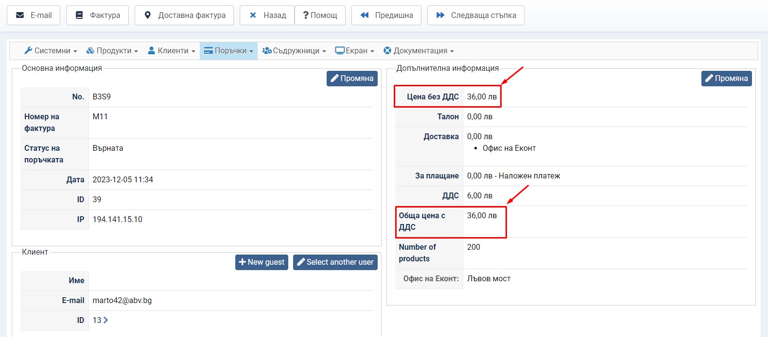

2 years 11 months ago #357161 by marto42
This code not work correctly, a use 5.0.0 busines edition and latest joomla 4.4.1.
But the code of comments before yours work perfect!
2 years 11 months ago #357162 by nicolas
So it's all good for you ?
2 years 11 months ago #357218 by marto42
Yes, everything is OK.

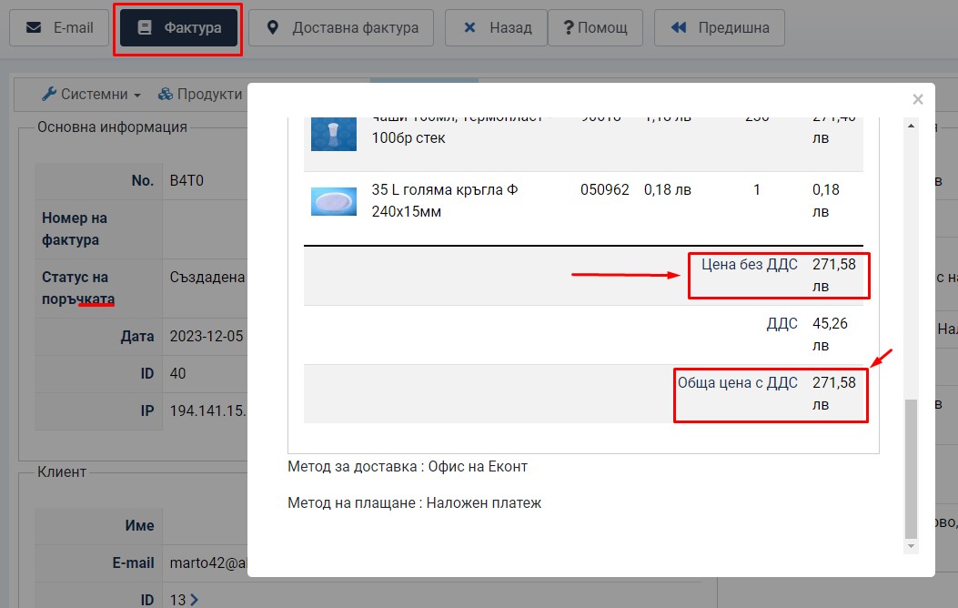

2 years 11 months ago - 2 years 11 months ago #357288 by marto42
please help me for invoice and for order too.
The price is same with and witouth taxes.
I need of some code to edit invoice view.
Please see attachments!
Thanks.
p.s. It is important to me to include it in future version. Thanks!
